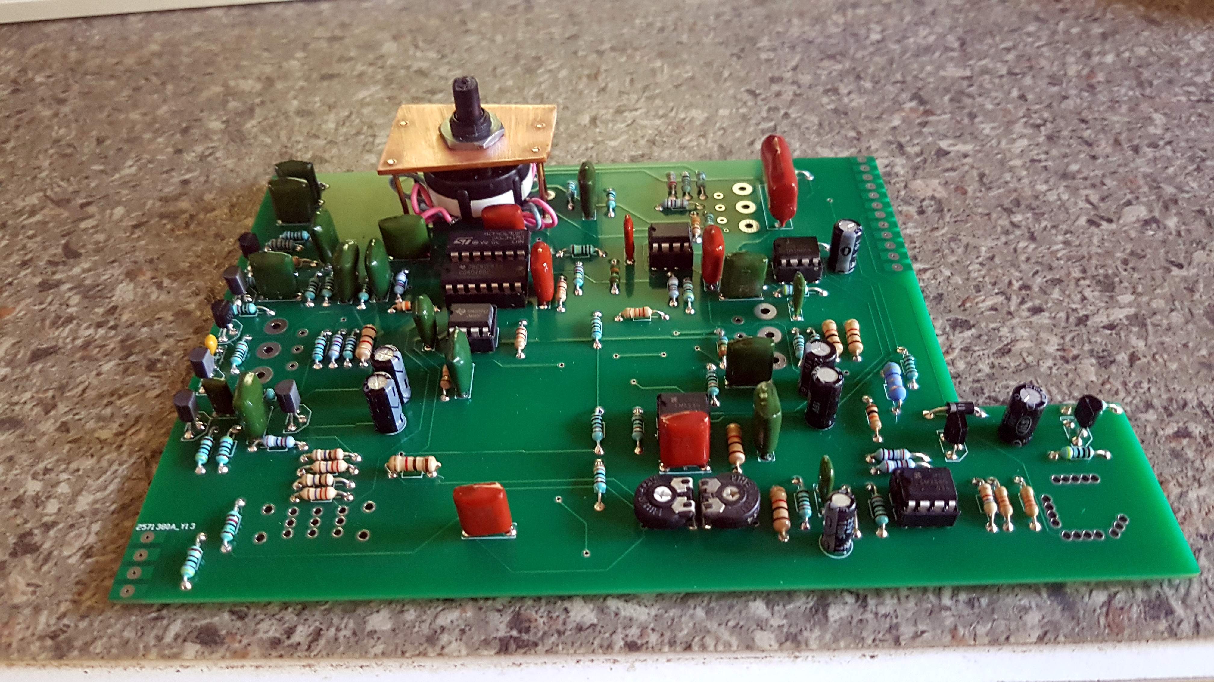

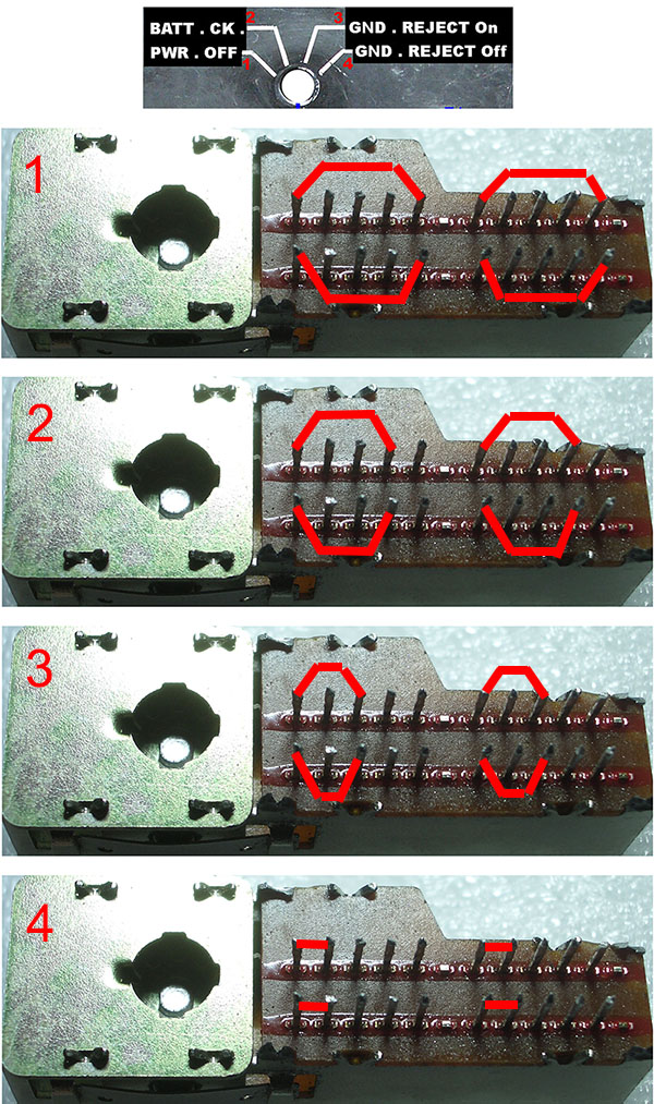

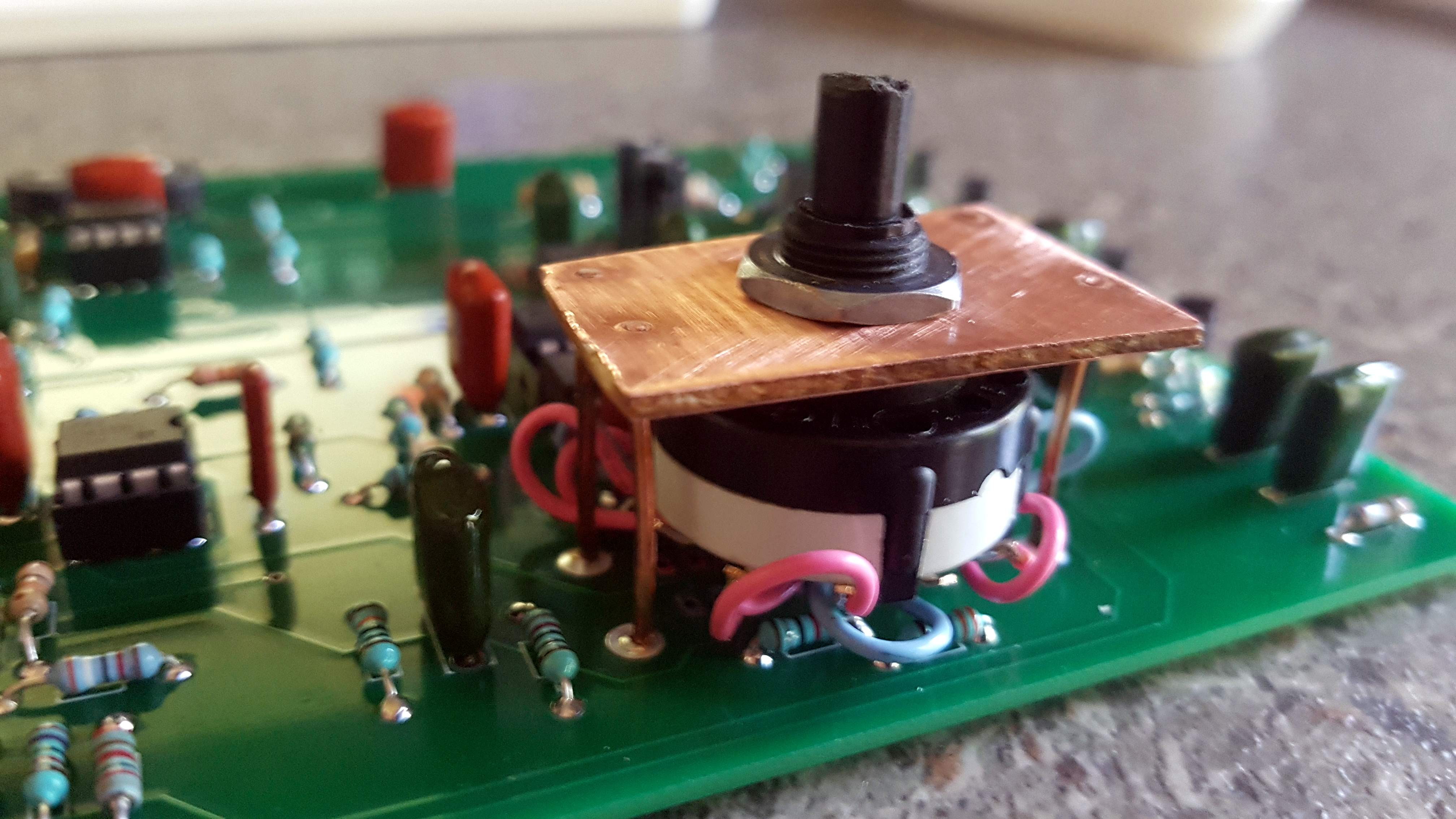

        How to overcome the problem of that obsolete switch with many contacts?
        I did it like this:

          • you need just two positions left
            1. GND REJECT ON
            2. GND REJECT OFF
            use a switch with 2 contacts pairs.
            for power on set a switch. for batt check use any voltage indicator circuit.
              1. GND REJECT ON
              2. GND REJECT OFF
              I did similar. It is 4x3 rotary switch.
              So I have now: Off, Metal, Trace (GND REJECT ON, GND REJECT OFF).
              I don't have only batttery check.
              It can be done on many ways, the battery check. As you said, push button and meter scale voltage indication.

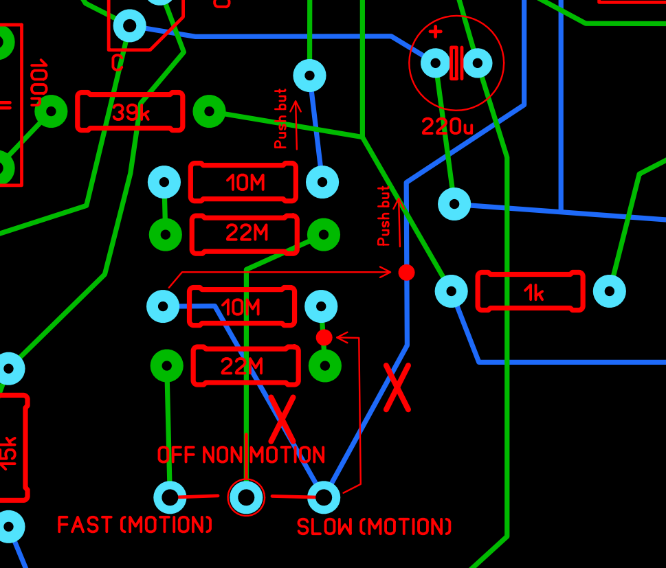

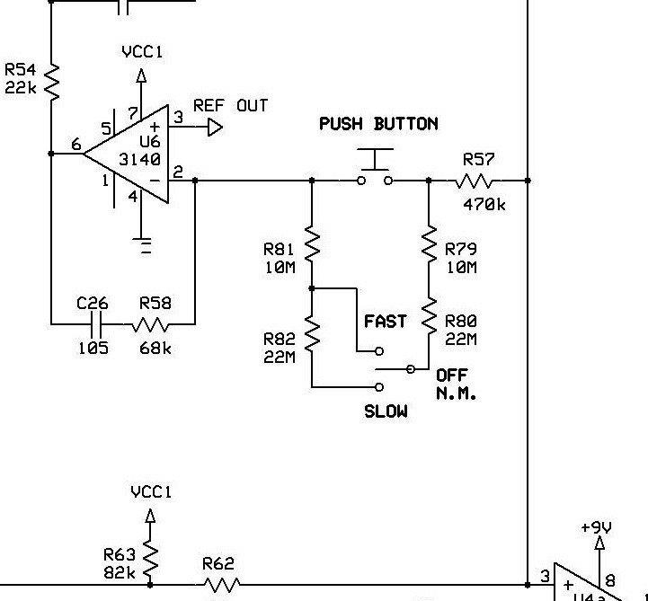

                              • Hi,
                                Is this correct ? :
ID:	412443 Click image for larger version
Name:	TF900 SWITCH.png
