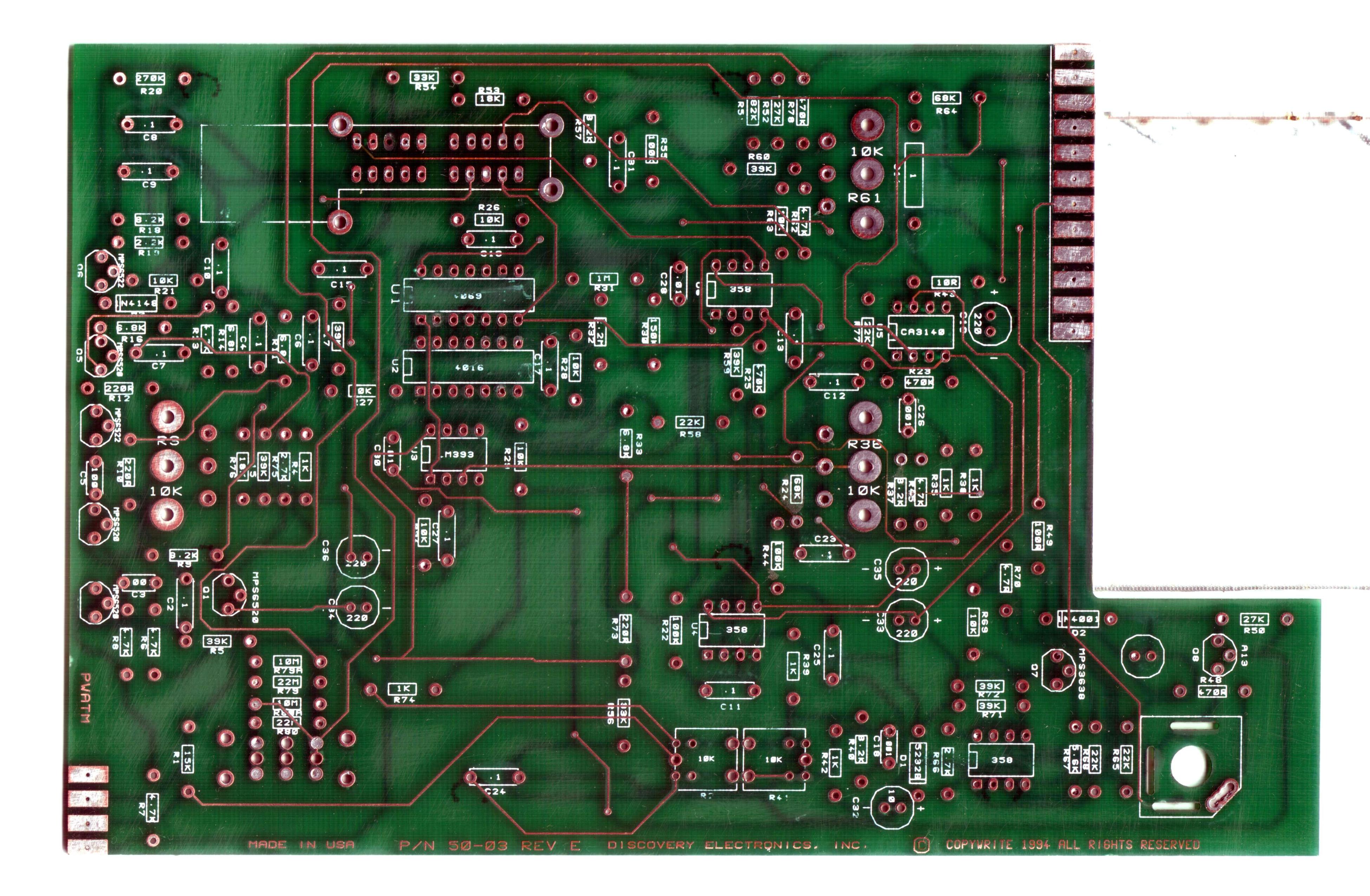

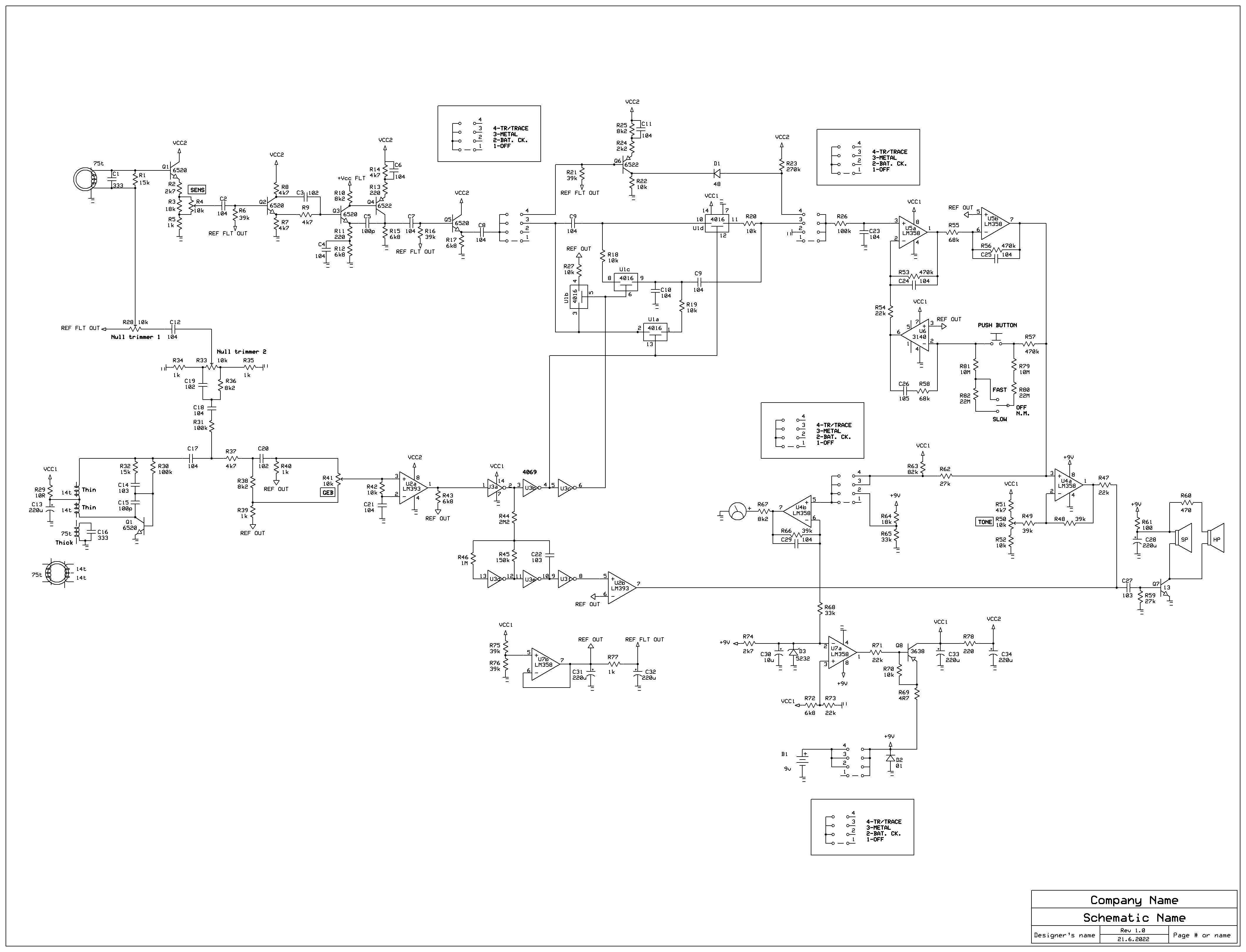

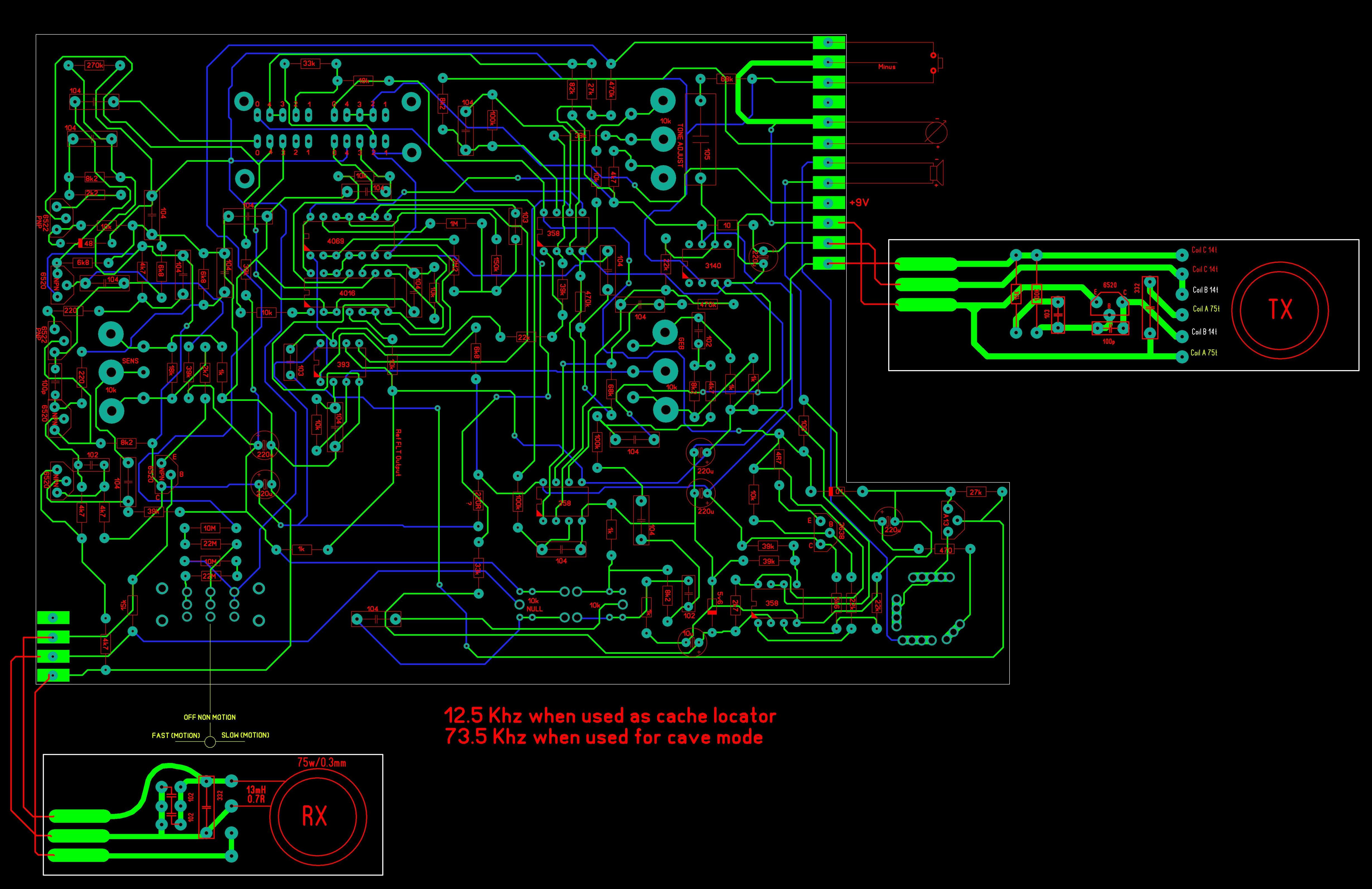

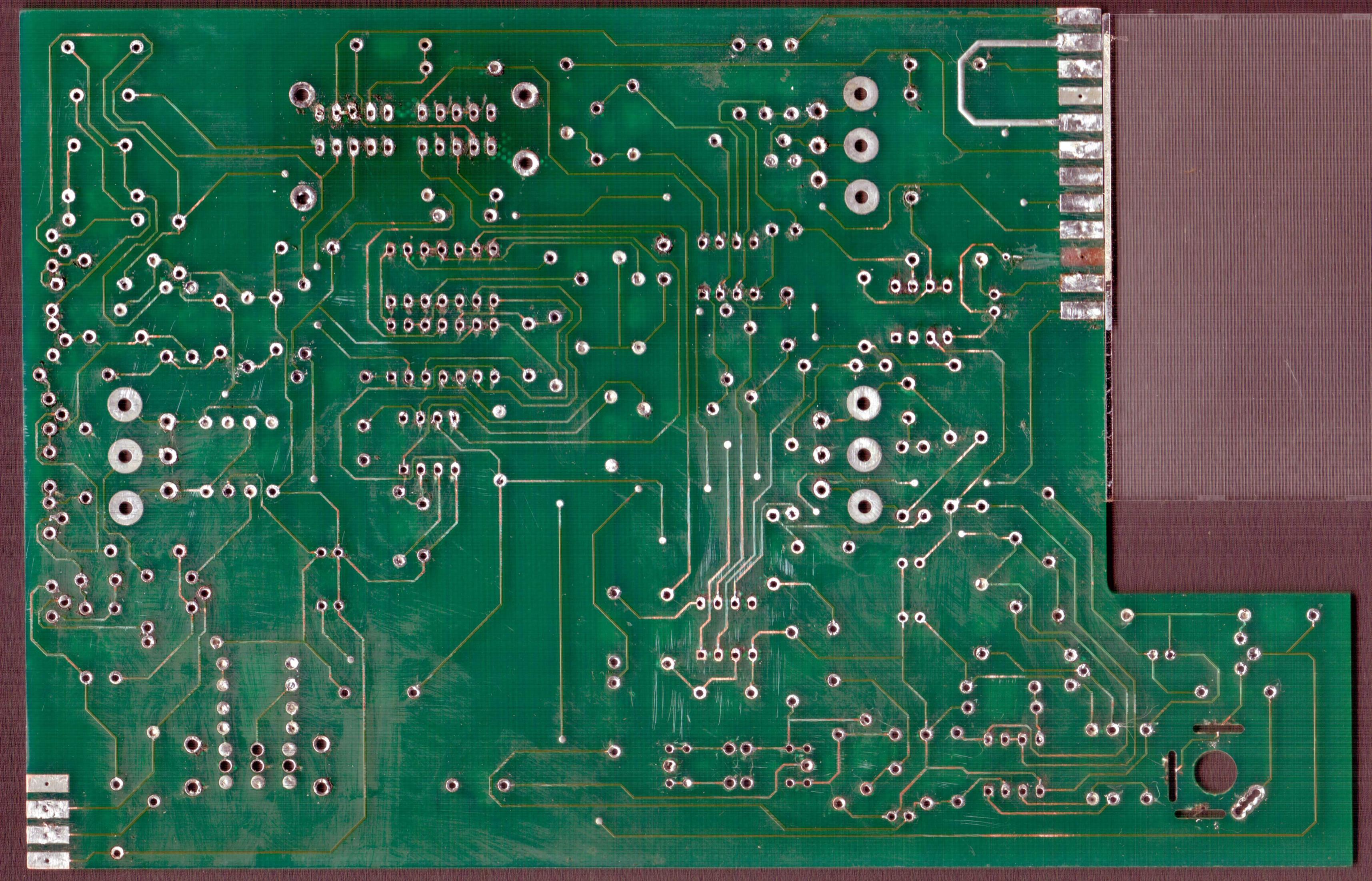

        ... Once I finish TF900 and am 100% sure it is in great shape and working good; I will prepare the documentation for forum publishing, of course...
        Now after all this work and effort, I am 101% sure that I would never publish this work in public.
        But... I already promised I would... and I'm a man of my word.
        Enjoy.
        Who knows why that is good!?
        • I did the similar reversing on TM-808, a while back ago.
          Looking now at this DTF-900 schematic... it looks so obscure comparing to TM-808.
          But! Don't let that fool you!
          In a searching for larger metal masses burried deep into ground; DTF-900 will to the job just right.
          But if I want now to make one of those; I would rather pick TM-808 to make.
          Reality checks; naaaaa... I am to lazy to make any of those now!
          This one is only been here for servicing.
          Now is packed and waiting to be shipped to the owner.
          This all is just collateral in my attempts to make my own fully non motion detector.
          On the other topic i posted White's Coinmaster 5000, reversed too.
          For those interested...

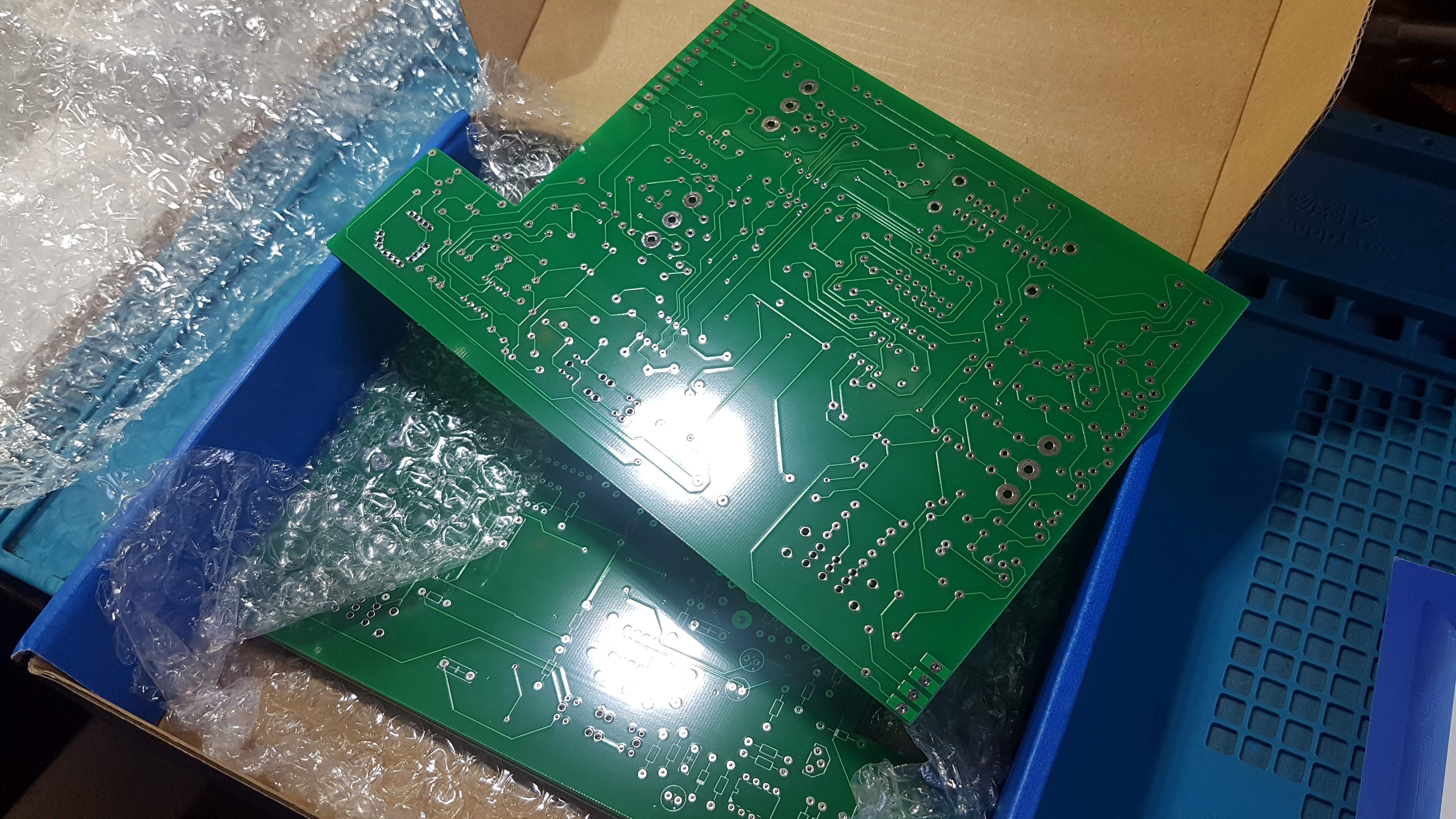

                  • This time was ultra fast; batch of "original" pcbs for TF900 arrived!
                    • nice boards

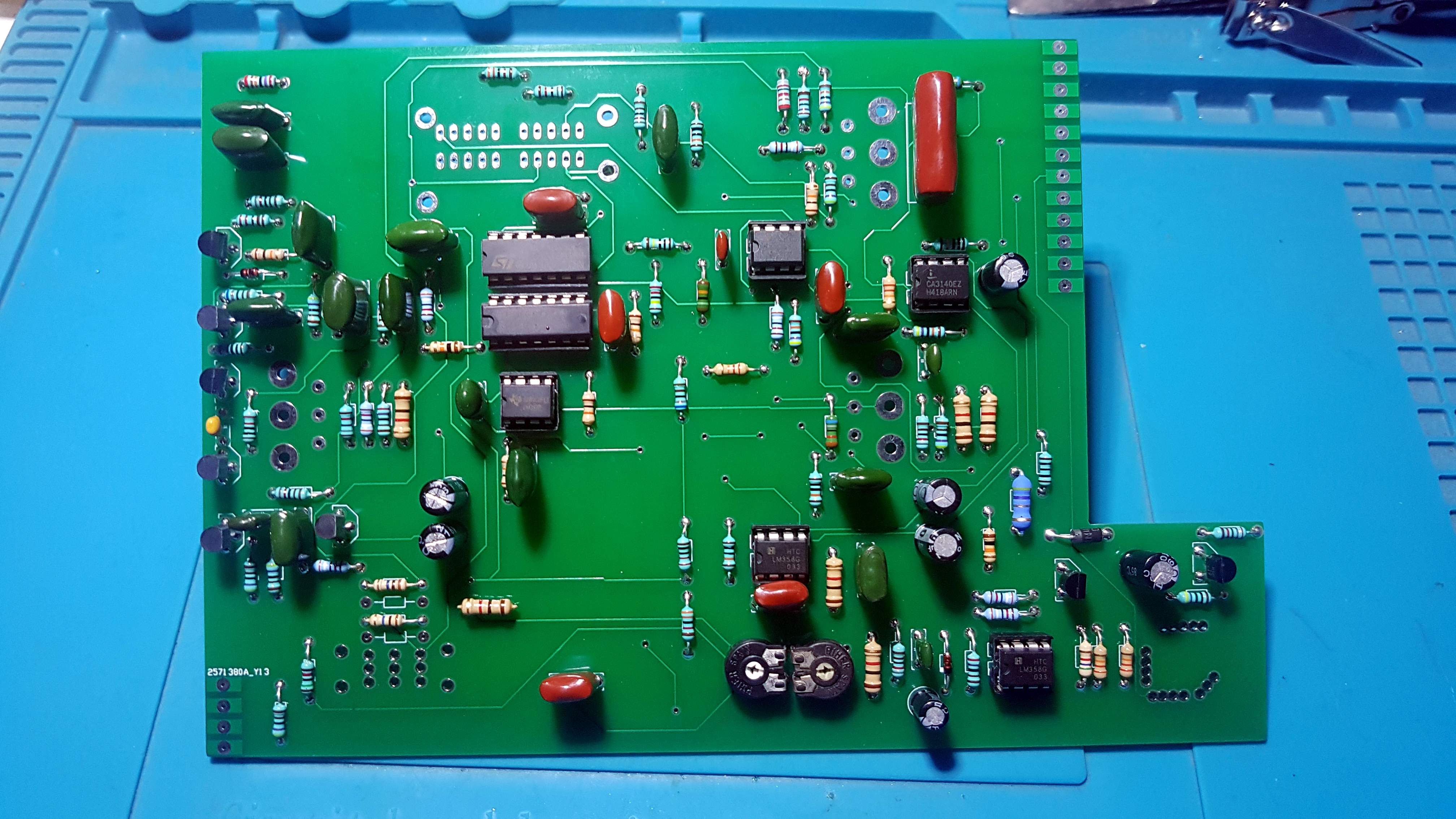

                      • Populating it:

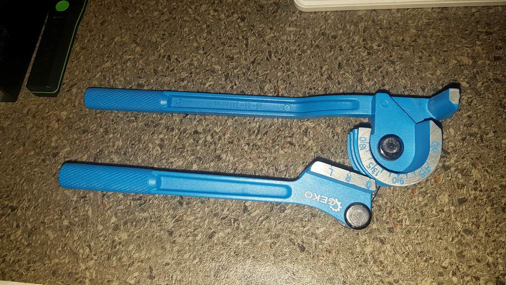

                        • I bought aluminum tubes and rods.
                          And on the ads I also found a hand tool for bending pipes, with 6, 8 and 10mm options.
                          Unfortunately; 10mm aluminum bar is too strong and hard to bend with this tool.
                          The tool is strong enough only for "thin-walled" copper pipes.
                          I only realized that today when the tool arrived.
                          So I'll have to get some professional help from a tinsmith who has professional tools.

                            • Your pcb looks great.
                              Use heat to bend your aluminum
                              • Originally posted by Alexismex View Post
                                You have a lot of bending machine in the web for inspiring you to make one , 30 years ago i make my own machine[ATTACH]57717[/ATTACH][ATTACH]57718[/ATTACH] to bend aluminium profil for making parabolic dish !!! it is not complicated.
                                Thanks!
                                I need simplest one for bending only these rods into "antenna" shape.
                                Will figure out something.
