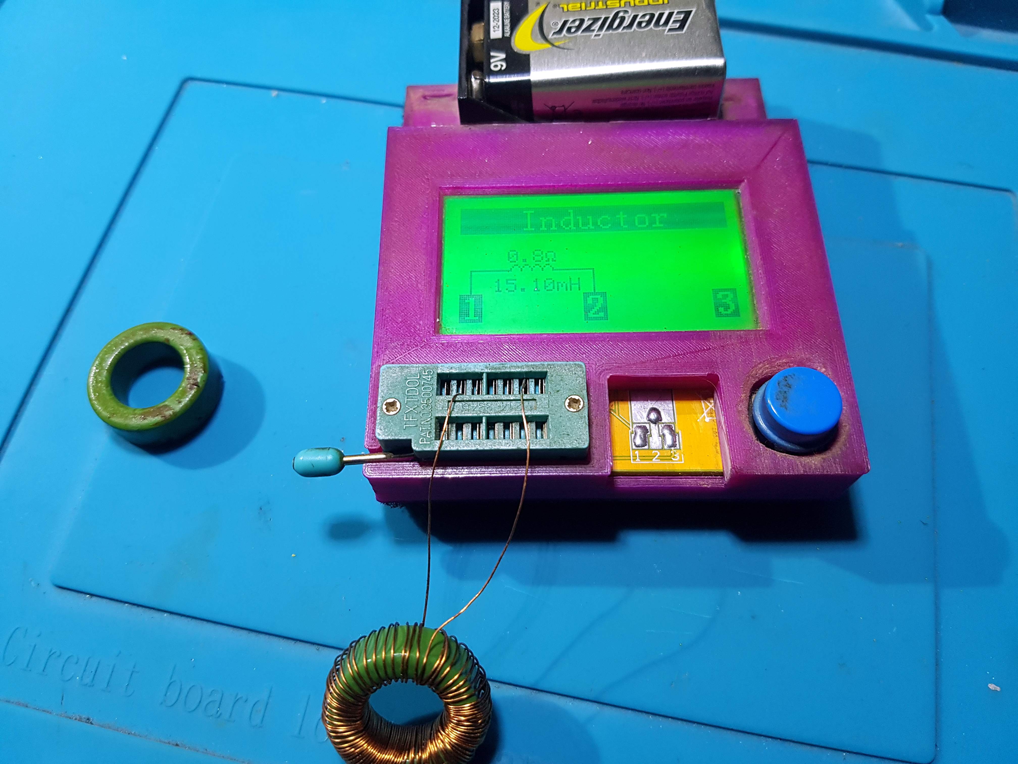

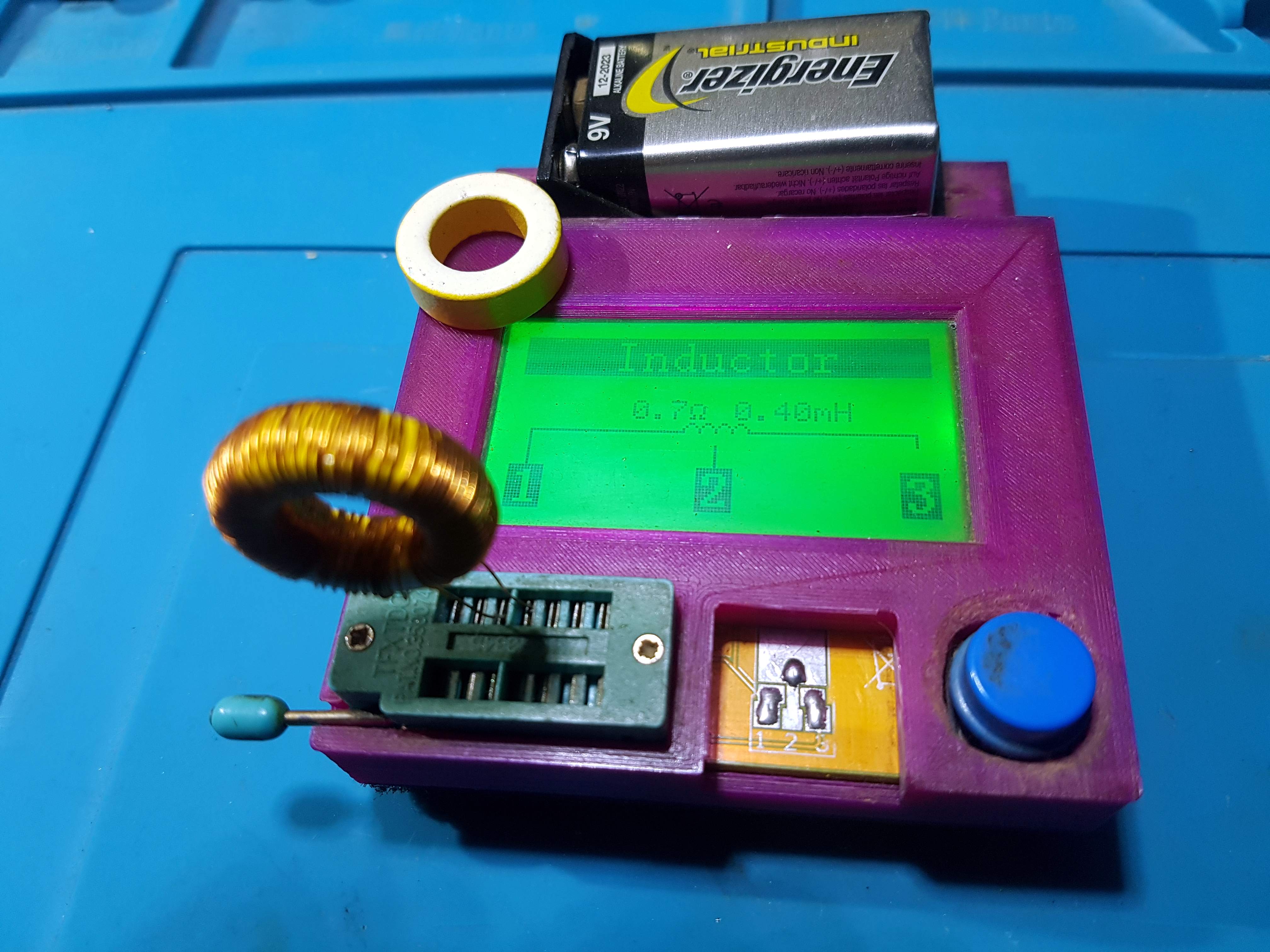

        Okay ... Skippy ... I owe you the most that I got serious for a while and started looking at things the right way.
        Instead of me blabbering on like this ... pictures will say more than words:

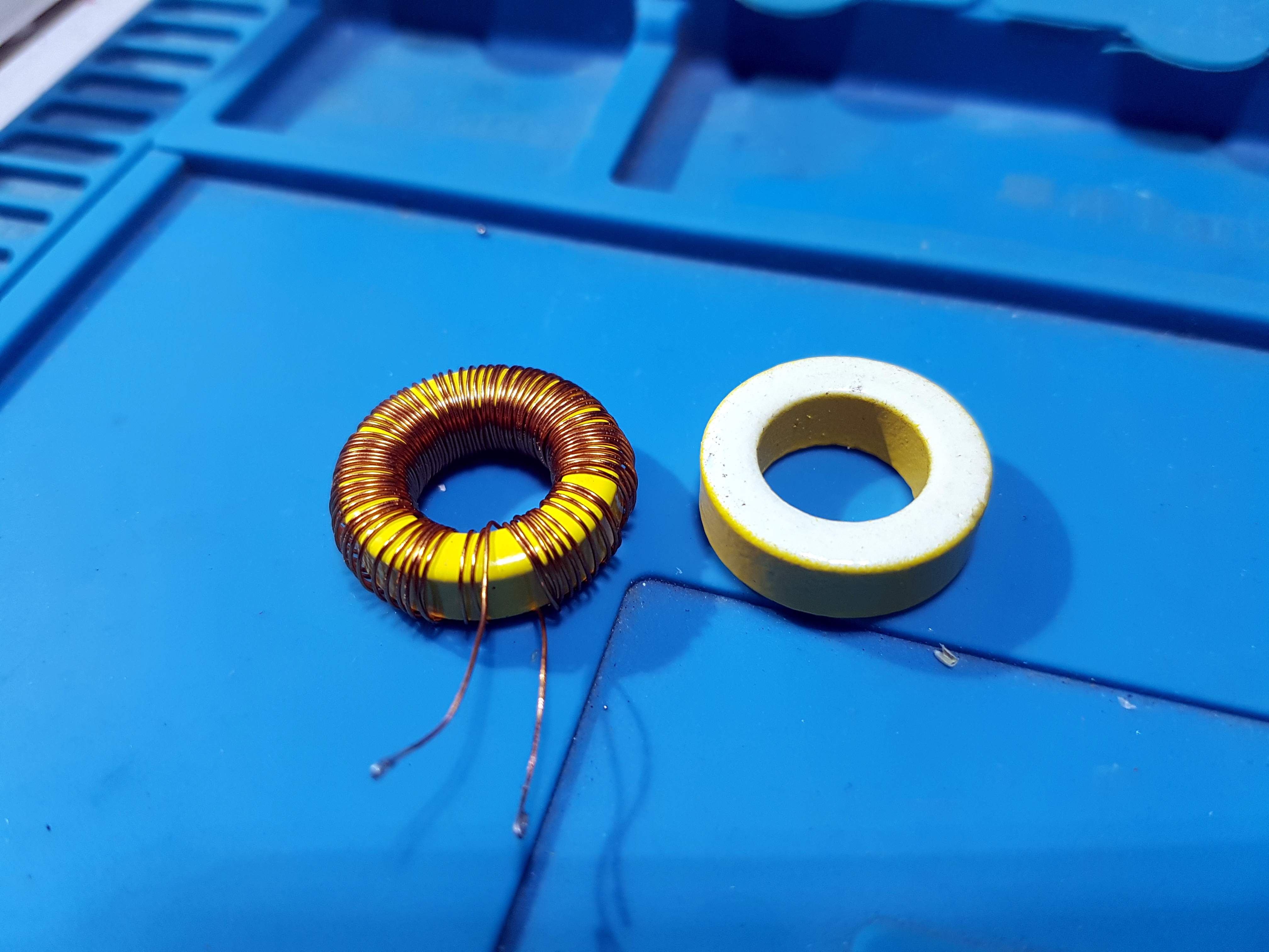

          Hmmm .. that nicely shows the problem with salvaged cores. Based on my experience, the yellow/white cores are powdered iron, likely u = 75 -> 125, good for SMPSU up to 100 kHz, for example, with lots of energy storage capability. Green cores are from common-mode suppression filters, ferrite with u = 5000 -> 20000, but designed to soak up AC energy , not store it efficiently, so they have limited uses.
          If you want to get experimental, at low cost, buy some type '43' ferrite cores, they are the most commonly seen medium-u types, I see some FT114-43 for sale at less than 4 Euro each. You will need +90% more turns than the original, to compensate for the u = 850, rather than u = 3000 that you ideally need. They will need some thicker wire on the TX, to keep Q-factor the same, about +40% diameter, roughly.
          And regarding the aluminium loops : making a good electrical connection at the joint needs care. Abrade the surfaces with clean aluminium-oxide abrasive paper, just before joining. This will remove the Al oxide layer, without contaminating it with anything else.

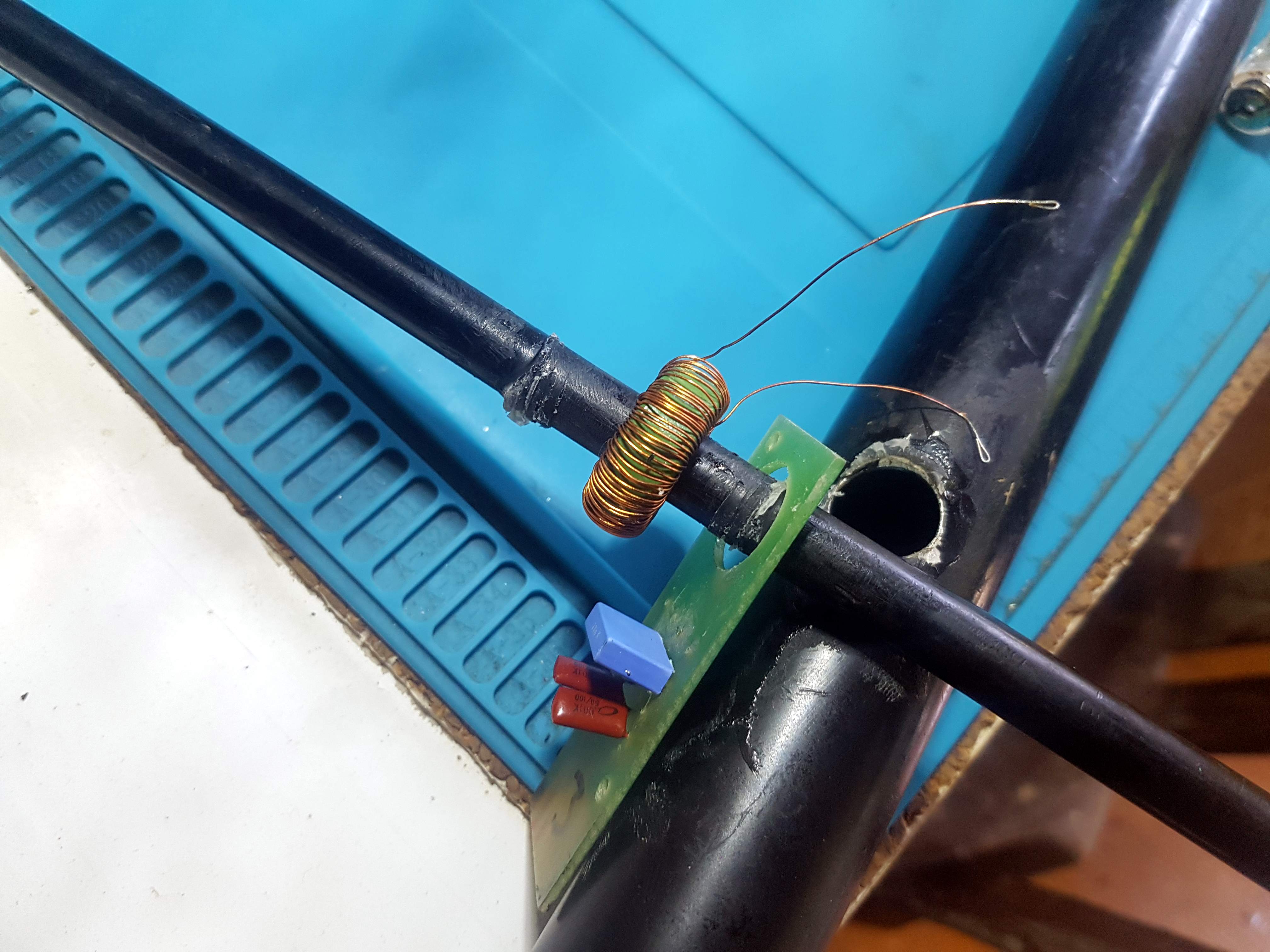

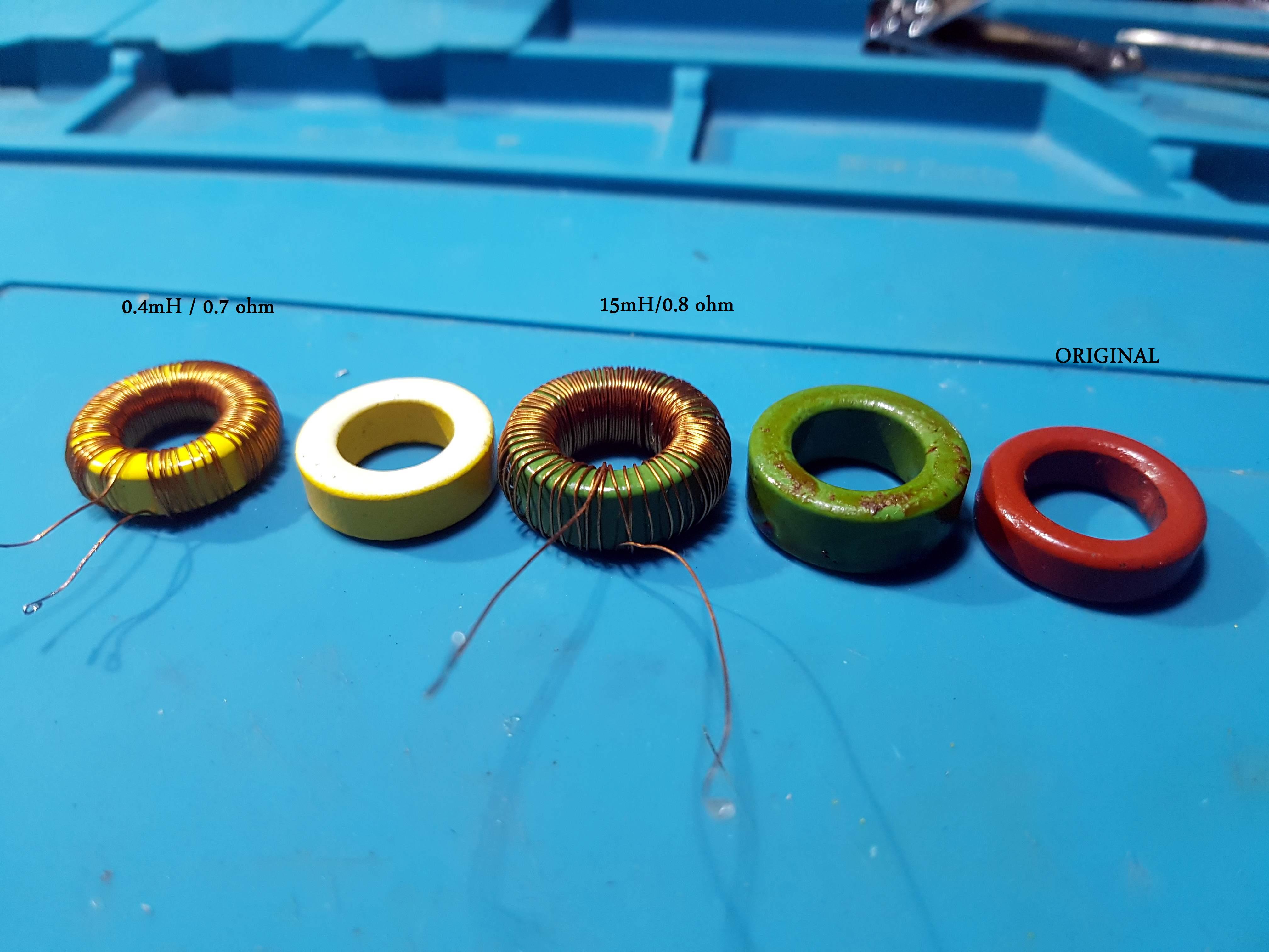

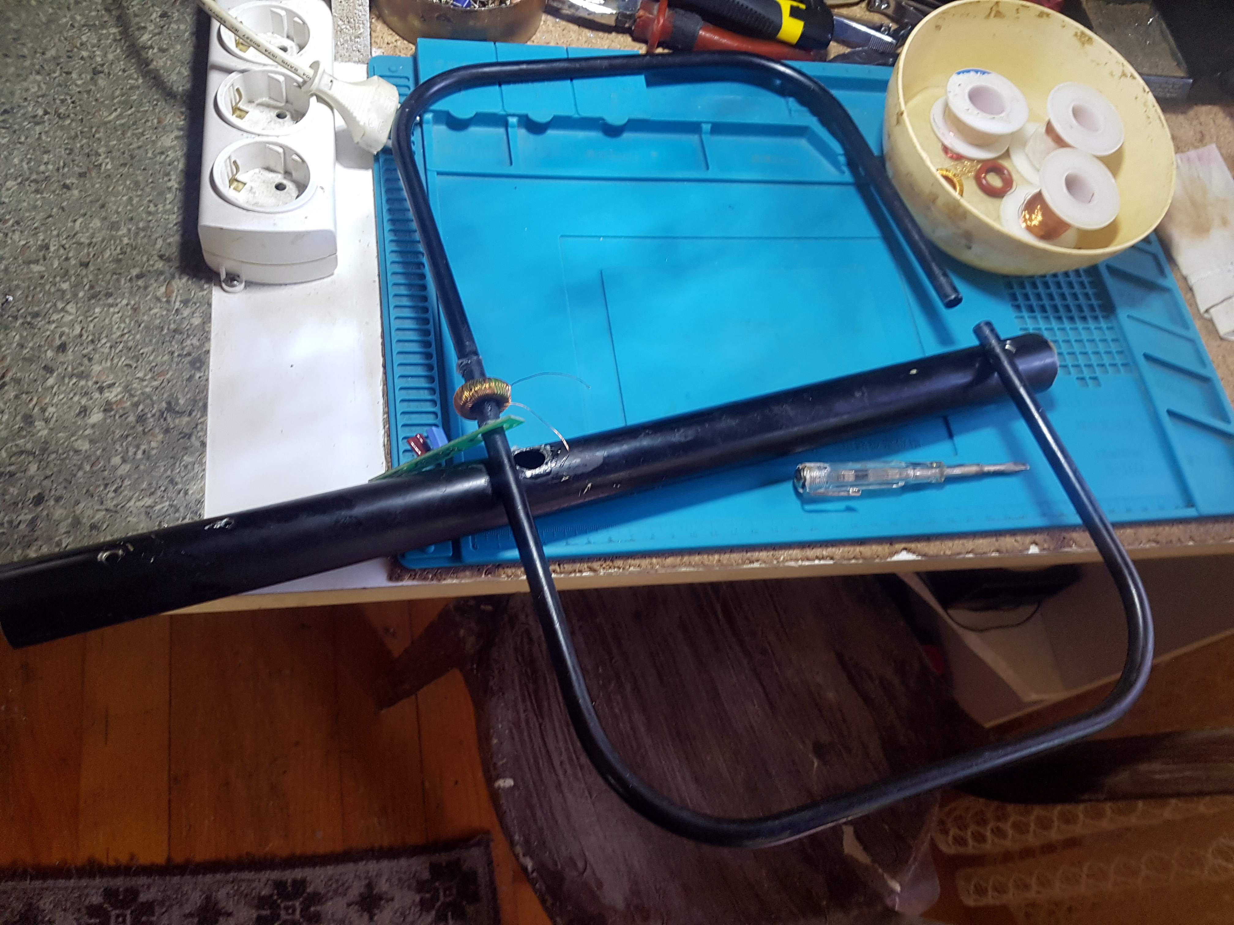

            Skippy, it seems like your "job" here is to constantly worry and upset me ... but in a productive and helpful way, so thank you so much for that!
            Not only will this help me fix this detector; I will also learn something new.
            See; the "antenna" rod that goes through the "shaft" is 9.5-10mm in diameter, I'm not sure, my caliper is not accurate.
            Or is it a difference in metric systems, my caliper measures in mm and shows something between 9.5 and 10mm.
            No matter, let's assume it's 10mm.
            And that's a limiting factor too.
            I can't wind too many turns on the torus, because then the rod won't be able to get through the center of the torus.
            The original "red" torus is 22x6mm and the "hole" is 14mm. So the cross section is 6x4mm.
            So if the rod is 10mm and the "hole" is 14mm, I have 4mm left in total, or 2mm around the rod, free space for windings.
            At the same time, subtract at least 0.5 mm, so that the rod can be easily passed without damaging the wire on the windings.
            That subtraction of 0.5mm around the rod will totally mean 1mm less.
            In that case I no longer have a total of 4mm but 3mm; or 1.5mm around the rod space to the surface of the torus.
            The coil must fit in those 1.5mm. In the case of RX this will not be a problem with this current number of windings.
            Well even in the case of TX this will not be a problem with the current number of windings and current wire thicknesses.
            Any change in the thickness of the wire to more, as well as an increase in the number of windings; leads to a situation where
            it is impossible to pass the rod through the torus.
            Problem, problem!

                  Good to see the true dimensions. It is a type FT87, also known as '42206'. 0.87" OD , 0.55" ID , 0.25" thick.
                  You are wanting an AL value of about 2000 mH / 1000T ( = 2000 nH / T2 )
                  This would suggest a ferrite of type F or T would be correct. u = 3000
                  There is also the possibility of using a thicker version, the FT87-A, but then the cross-sectional area is double, and a lower u ferrite is needed etc etc

                        That's the correct size, just not a correct ferrite mix. Type 43 is medium-u, 850.
                        This is Amidon's version:
                        Ferrite Toroids, Iron Powder Toroids, Ferrite Beads, Split Cores, Cable clamp-ons, Balun Cores, W2FMI Baluns and Ununs, Inductive, power supplies, HAM radio.
                        Type 'F' ferrite, u = 3000, giving the toroid an AL = 1800 mH / 1000T
