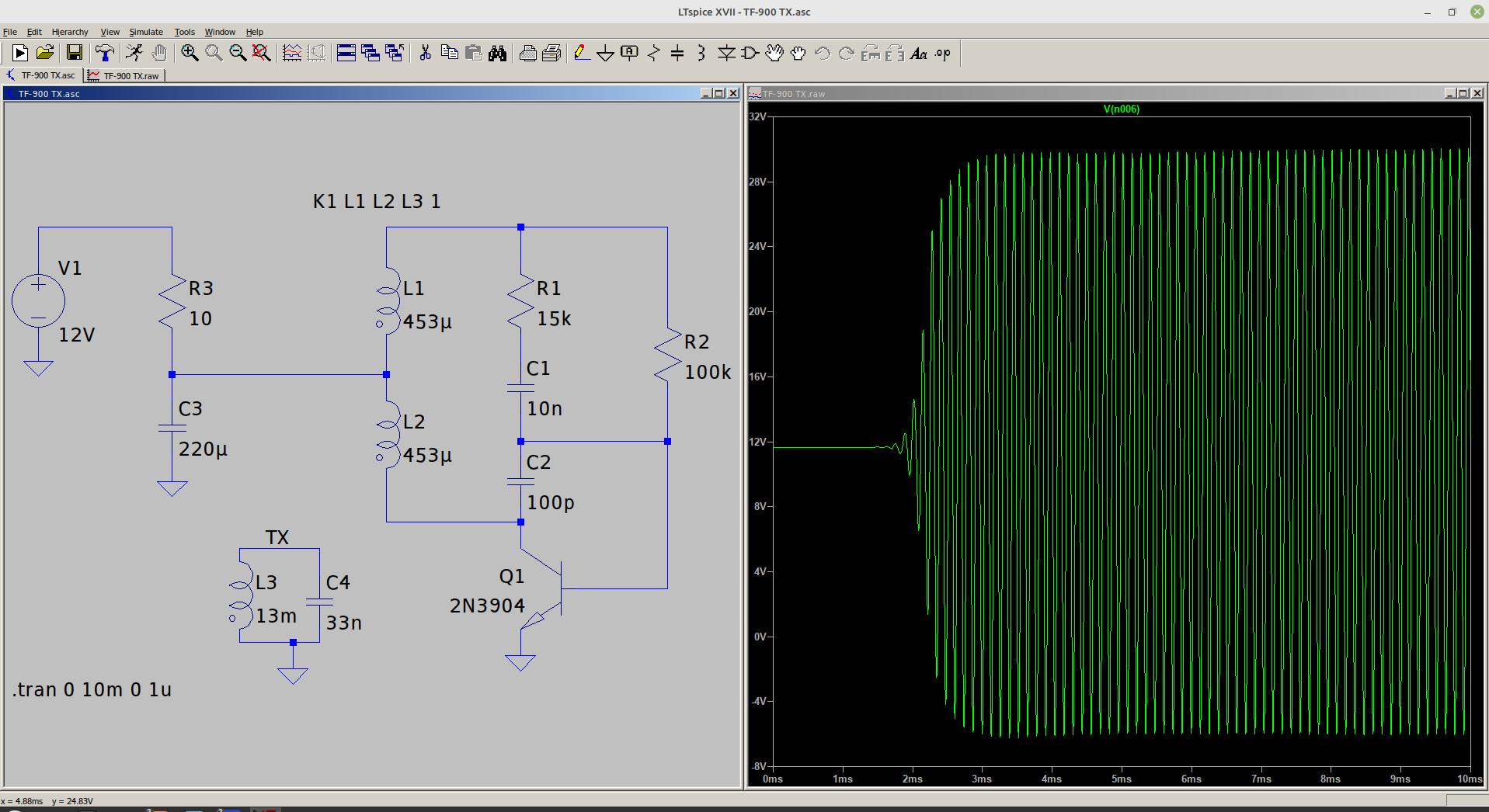

                            LTSpice simulation attached.
                            • #74
                              It would be interesting if George could model the addition of the shorted TX loop. Specifying the resistance of the loop would be tricky ... skin effect would play a part.
                              I'm thinking the loop would behave like adding a parallel resistor across the 13mH/33nF combination,
                              example if the loop resistance = 100 mR, this would equate to 75 x 75 x 0.1 = 560R. on LC .
                              XC = XL = 690R, for comparison.
