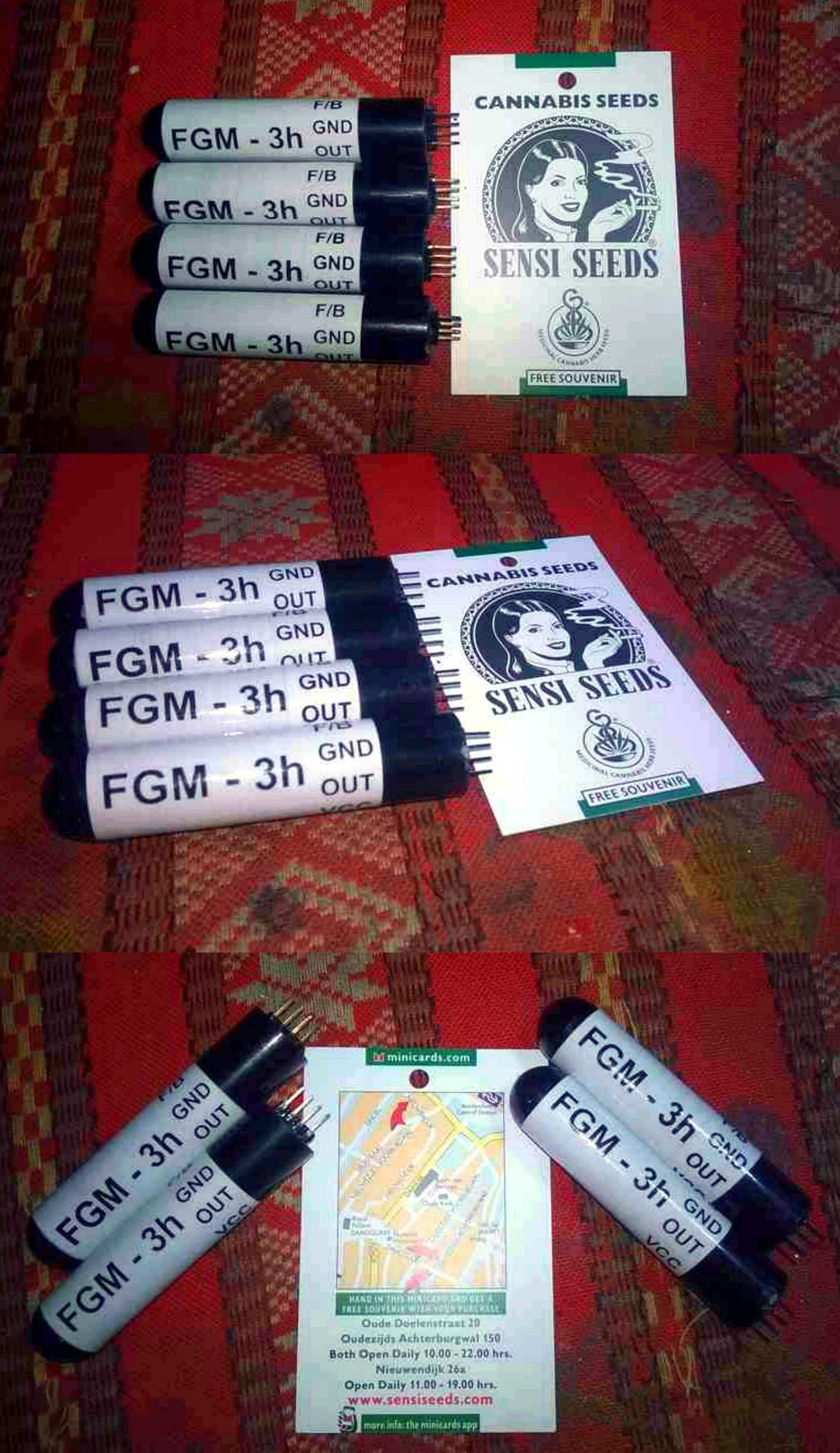

    • Finally arrived 4 sensors from:
      https://www.tutti.ch/de/vi/aargau/ga...389?redirected

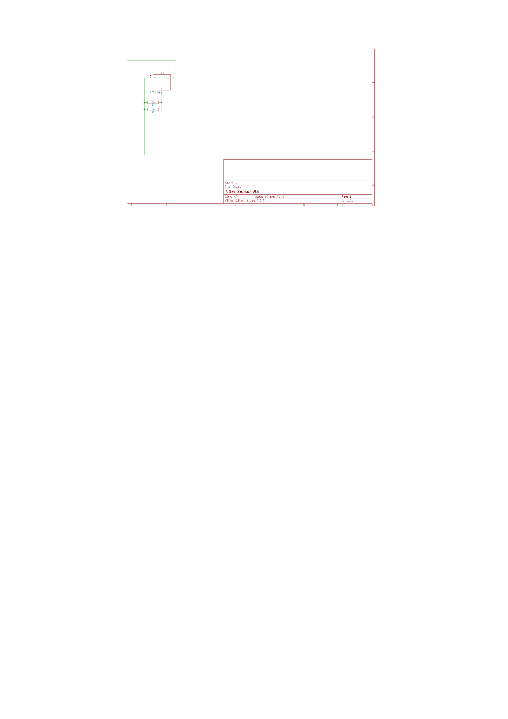

        • I have not found yet a proper schema, I present my piece.
          Power supply with LP2951-3,3V; output from current regulator on the feedback winding.
          Unfortunately, in the image of an oscilloscope on the controller current appeared strong multiple sine wave from your generator (due to a large output resistance of the controller).
          They cannot be block to the ground, because capacitors change the frequency and the amplitude of the generator.
          The reason was a big factor of magnetic coupling M.
          Consequently, I quit my idea to use feedback winding.
