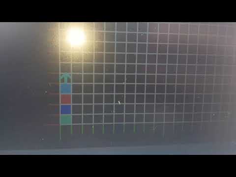

          Make it support .csv. Then it is even greater. I use freeware
          http://www.sussexarch.org.uk/geophys/snuffler.html
          Best Regards
          • At first i did the code to generate csv. Nothing easier than that.
            Later i decided to do my own file format. Encoded. To match only my software.
            But i don't give up from csv too.
            It is very easy to add several formats, code to generate them at the same time on SD card.
            Will see.
            There are too many more important things to finish yet.
            This is growing project. More to come.

              Your software is ok for fast survey and it has 3D. I f you improve it a bit more you will have customers belive me. There are only few geoplotting softwares in the market and they cost fortune.
              • Snuffler is great software, written by great enthusiast and expert.
                But also very conversant and educated for that area of interest.
                I can not compete with that. No way!
                But adding .csv format is easy task.
                Will do.

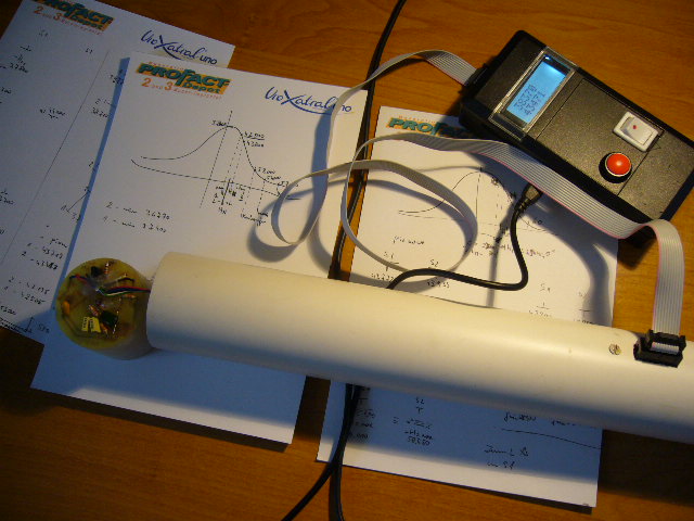

                                My insulation is a sensor inside the hollow cylinder made of polyurethane.
                                All the ends of the tube diameter of 50 mm length 1 m from the Central tube of the vacuum cleaner (tested best stiffness in one axis).
