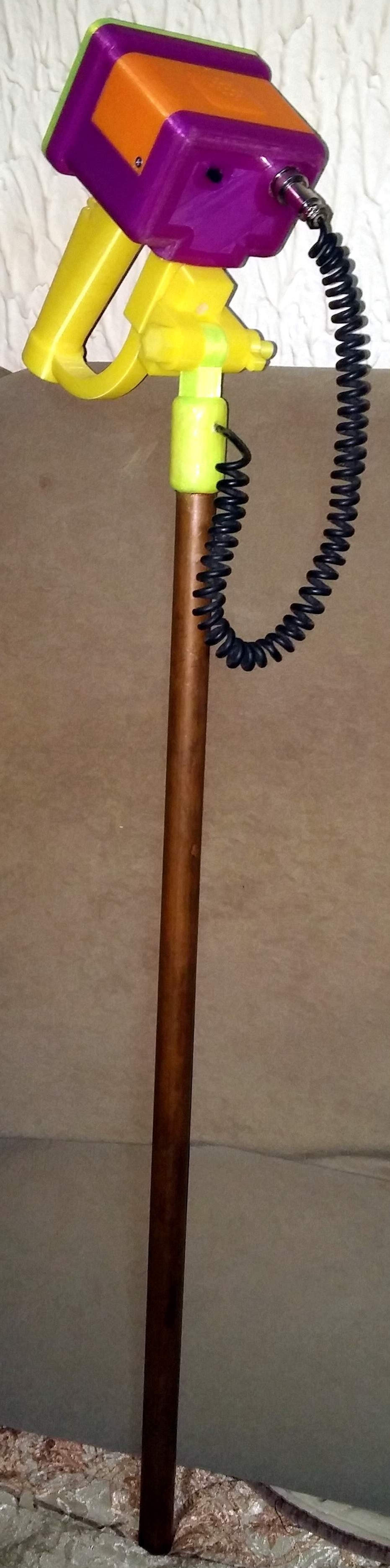

              WHAT TYPE OF TUBE IS IT USED TO PUT FG3 SENSOR IN IT
              THANK YOU SO MUCH
              • Mostly plastic. I try to find strong plastic tubes that don't bend.
                On a couple of occasions I have experimented with non-magnetic steel tubes (they are hard to find, I came across a few pieces by accident) and on a couple of occasions with pure copper tubes.
                A tube of pure copper (I emphasize this "pure" because often various alloys are sold as "copper") has proven to be the best for this purpose, except for the problem of the weight of such a tube.
                Pure copper acts as a "filter" and the sensors work more uniformly and quietly. I discovered this by accident, experimenting.​
                In the pictures below you can see all 3 cases; non-magnetic steel, plastic and copper. (click to enlarge)

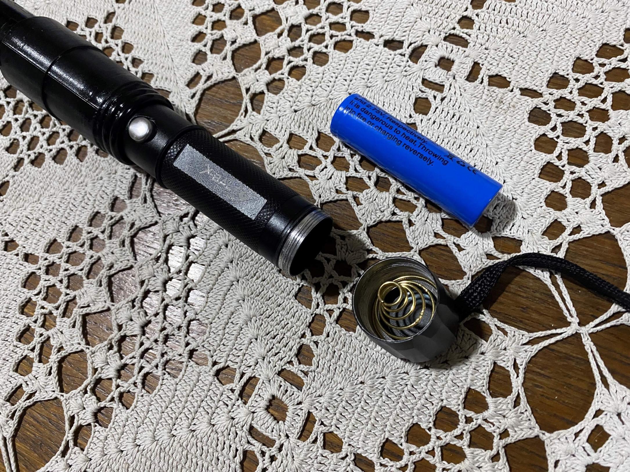

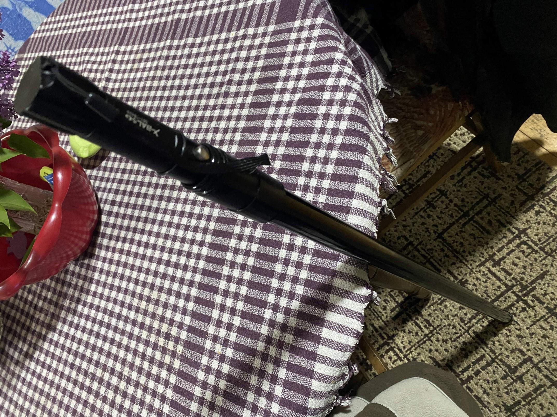

                    • Despite my health problems, for the last few months I have been working intensively on a completely new device that I could also classify as a "magnetometer/gradiometer".
                      At first it seemed to me that I would have an easy job. However, I was wrong.
                      A big and serious job has opened up, which I am now slowly bringing to an end these weeks.
                      The device in question is placed in an ordinary "tube", which will have only one "soft" button for "ON/OFF" and nothing more. Everything else happens in the Android app.
                      There is two-way BT communication.
                      The device will have two versions, a version that will work with sensors that have a frequency output and devices that have a voltage output.
                      The use of existing FGM-3 sensors is possible. For the version that outputs voltage; I specially designed a small accessory, a converter that will be added to the FGM-3 sensor and convert frequency into voltage, very linear, stable and with excellent resolution.
                      And in my plans until autumn, I also have the production of a special "FGM" sensor that will have both frequency and voltage at the output.

                      As for the new device, I had to write almost the entire code from scratch. I added many improvements to the code, more accuracy, more linearity, more options, etc.

                          • Such a skim "test" in the room, armature in the floor, "million" electrical devices turned on, interference on all sides.
                            All this is not authoritative and I just recorded it as a demonstration example.
                            This is just a pinpoint mode with a very low sensitivity setting.
                            The Android application also has a standard 3D logging mode.
                            The metal box on the floor is made of a very thin alloy with aluminum (of course, there is also ferro material in that alloy).
                            Final software settings are in progress.
                            I should finish everything today/tomorrow.
