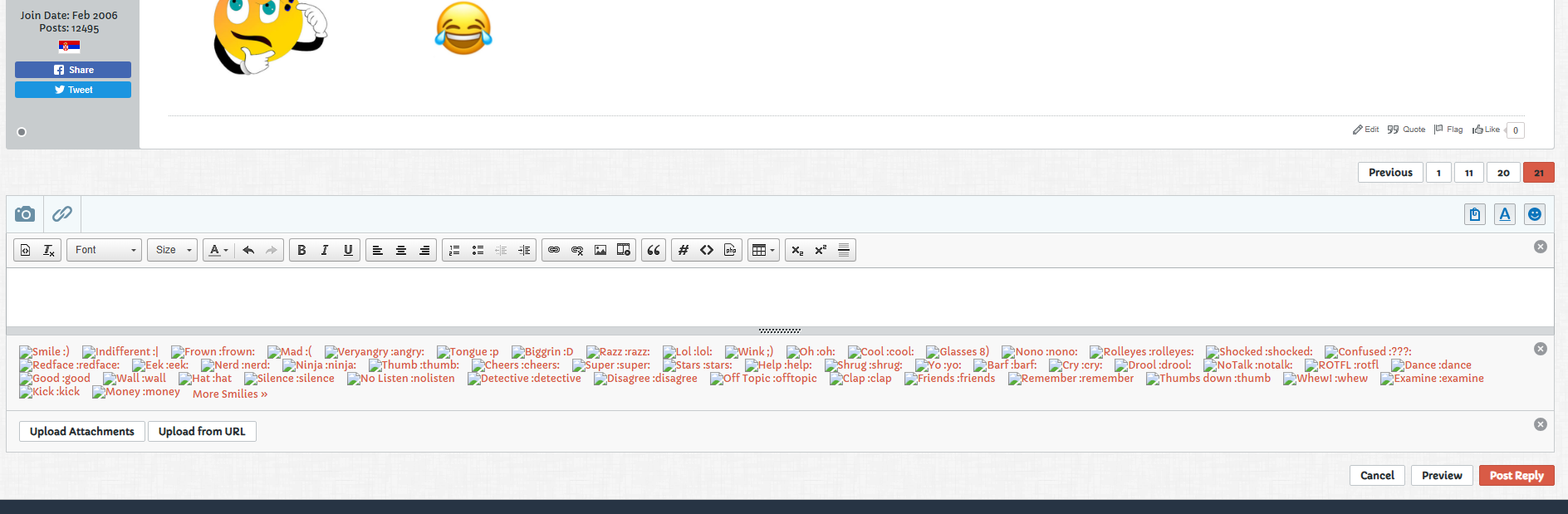

                    • To the admins: guys, the forum is still badly damaged and half the functions are not working!?
                      Any chance of fixing it?
                      This is how I see the forum, I have no chance to use smileys or format the text correctly?!

                      • Yes, looks like all the smilies have gone. Only the words are showing, but no images.
                        I can see them listed in the Smilie Manager but I suspect the actual images don't exist "images/smilies/smilies/".
                        One for Carl to fix ...
                        • Half of them are back... the other half, I don't have. George, did you add these?
                          • Yup!

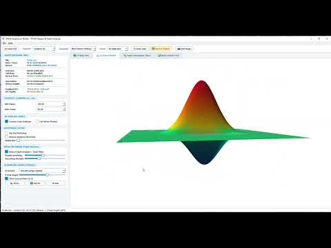

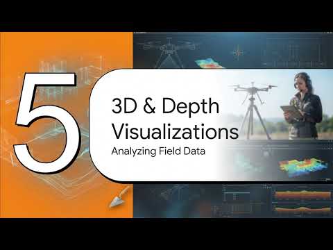

                            • In order to support the project, I also wrote a simpler Windows software for importing and manipulating .csv files from the device:

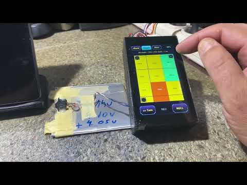

                              • Both on the first video and on the video showing the Windows software; you'll notice the example records named "Tomb" and the "Spear".
                                It is a real shot of an ancient Roman tomb and real shot of the iron spear.
                                The recordings are "embedded" in the memory of the device (as well as several other "Examples") and serve as demonstrative examples of proper terrain mapping.
                                The WS43 file system is organized so that there are 100 empty spaces for new files and several "Examples" files in a separate folder.
                                That folder is protected from accidental and unintentional deletion by the user.
                                ESP32-P4 has 32MB of memory, I could reserve much more than 100 places for files, but I know from practice that even 100 files are too many.
                                After transferring the files to the micro SD card, the user will free those 100 places by deleting files.
