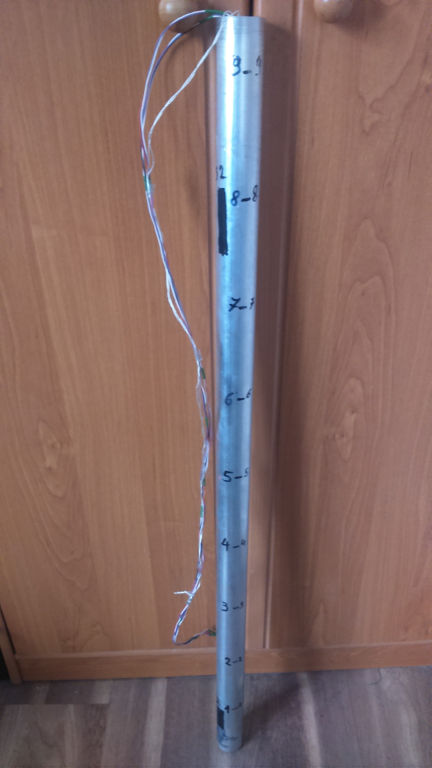

        As for using copper pipe to make sensor setup, more infos...
        Yes, copper pipe with thin walls (not more than 1mm) is acting as sort of "stabilizer" and affects positively sensors behavior.

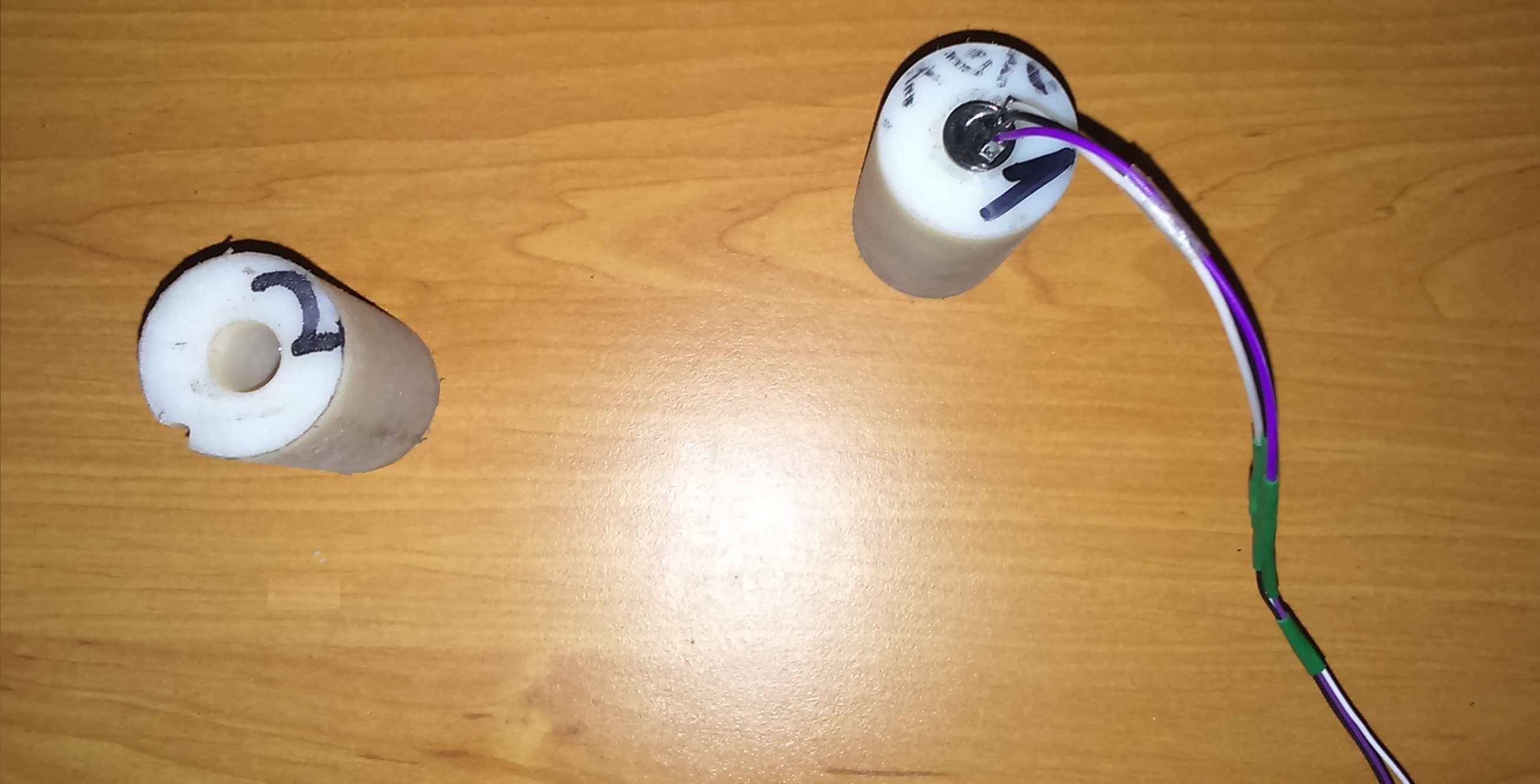

            Usually i 3D print sensor holders which are helping better alignment of sensors in a pipe.
            So those also acts like sort of "spacers" too, against pipe walls.
            If pipe is with 22mm diameter, 1mm thickness; i print 19.8mm outer diameter holders (0.2mm difference to easy put, slide, move and place holder in pipe).
            FGM-3 is 16mm diammeter, so there is a hole in holder, 16.1 to 16.2mm. Which leaves 3.8mm/2=1.9mm clearance from the pipe wall.
            FG3 sensor is somewhat lower diameter and leaves more clearance.
            And there is always possibility to pick pipe with larger diameter and print different holders, to get more clearance.

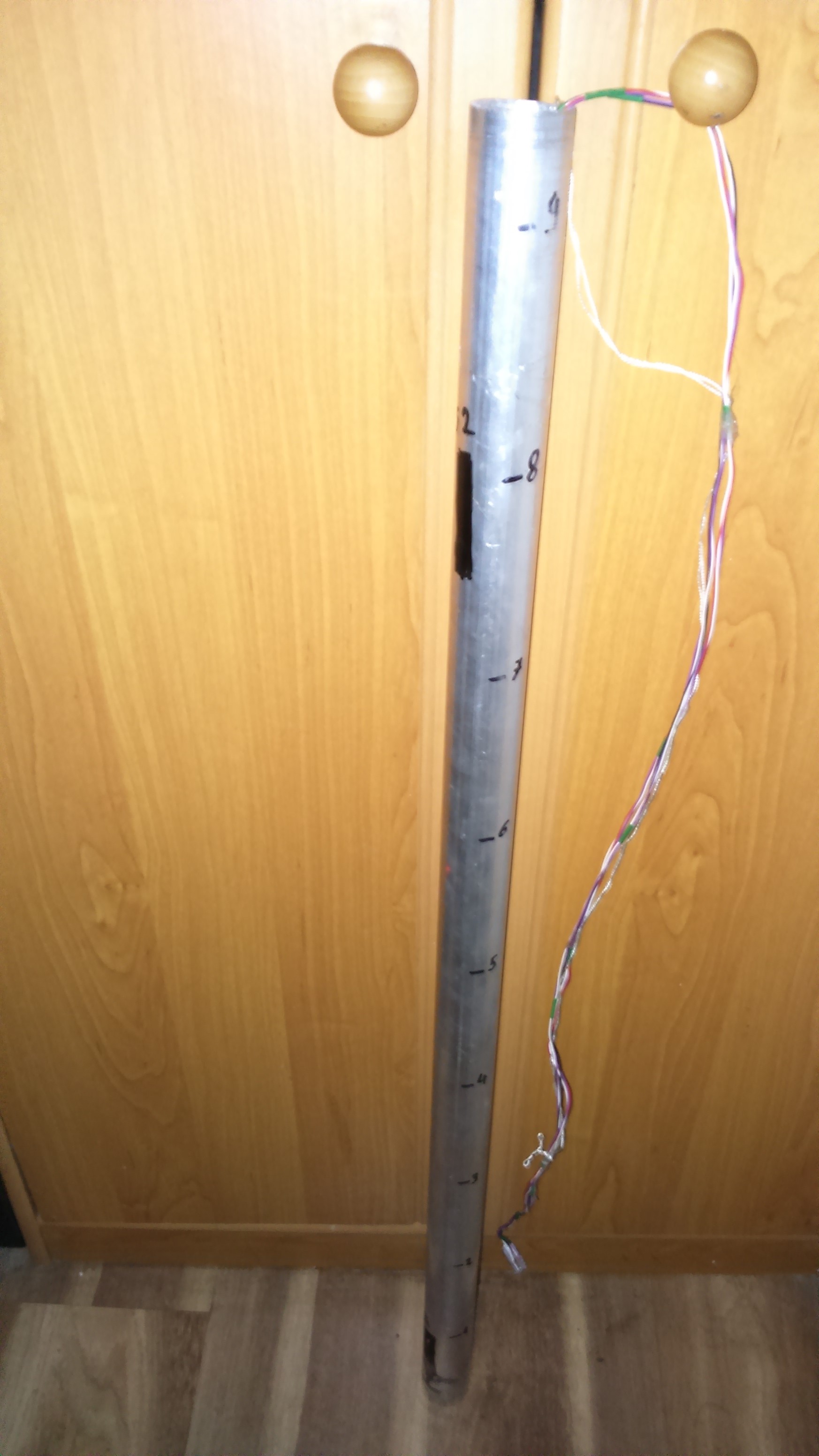

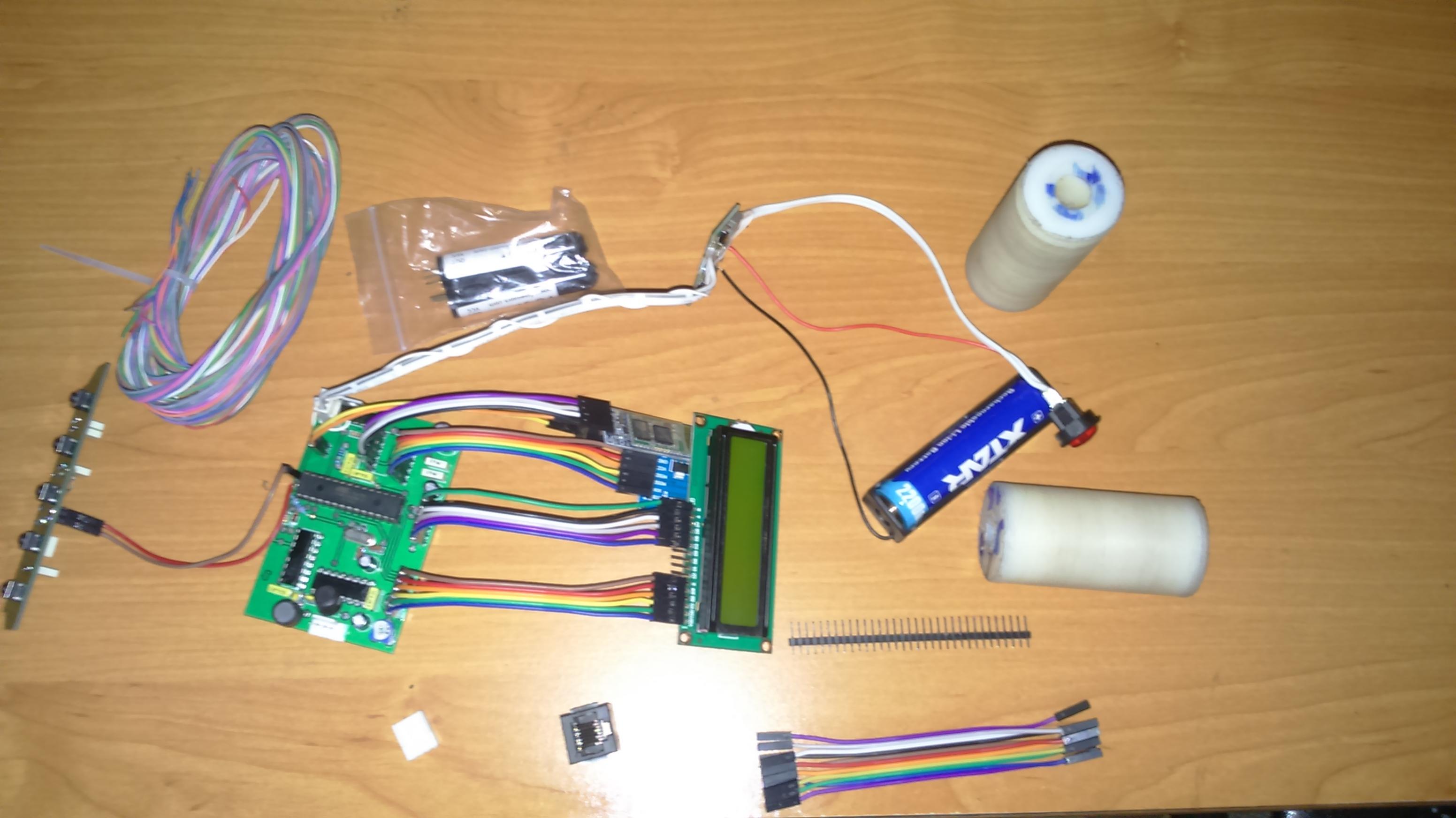

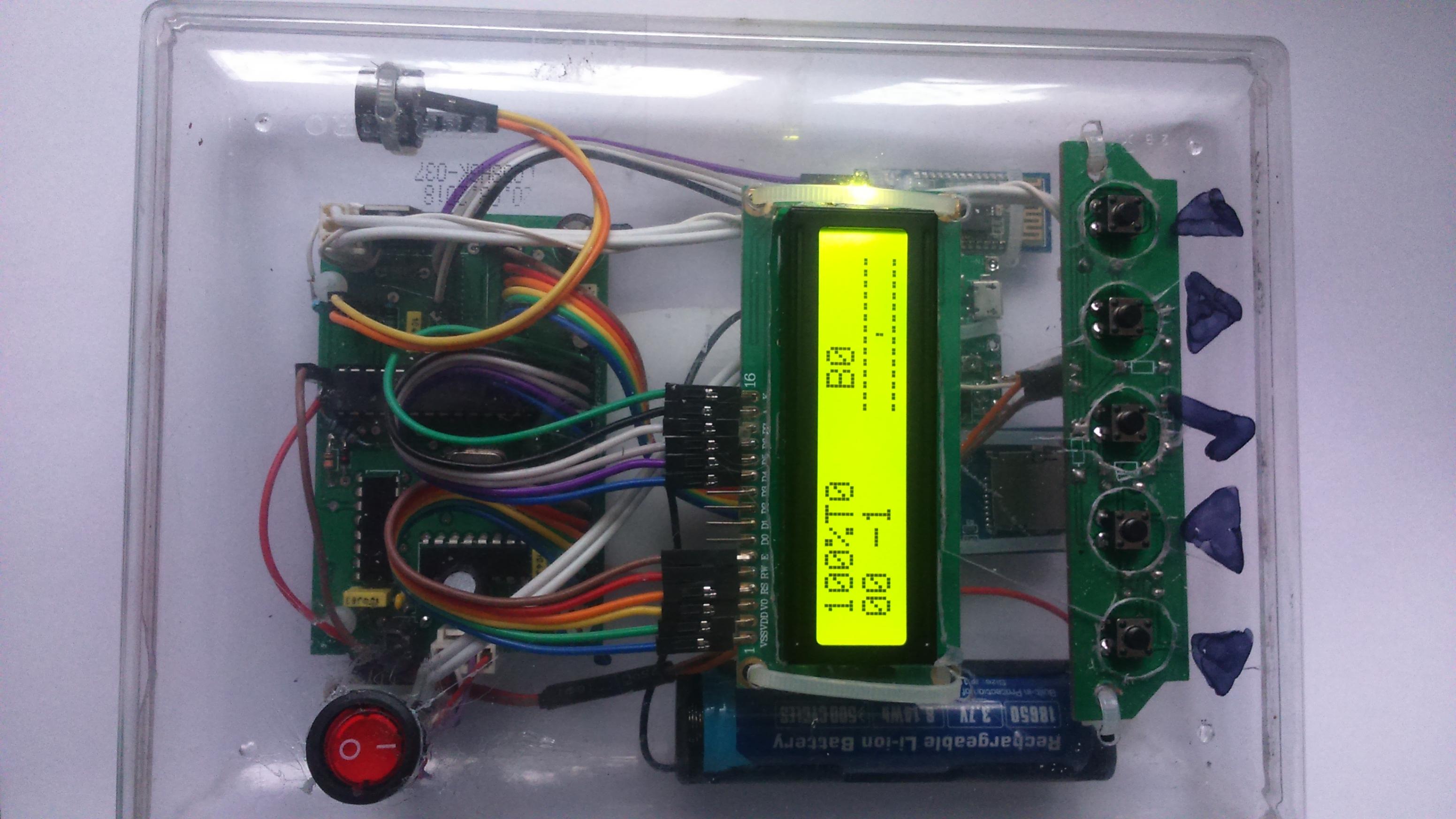

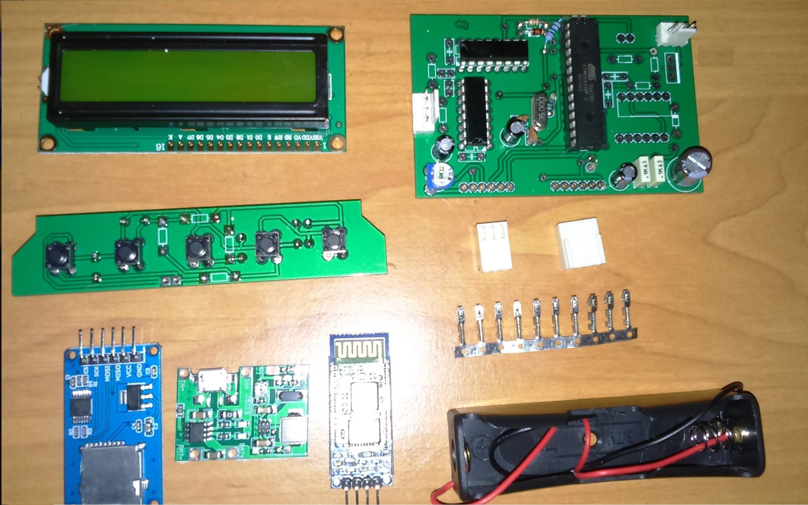

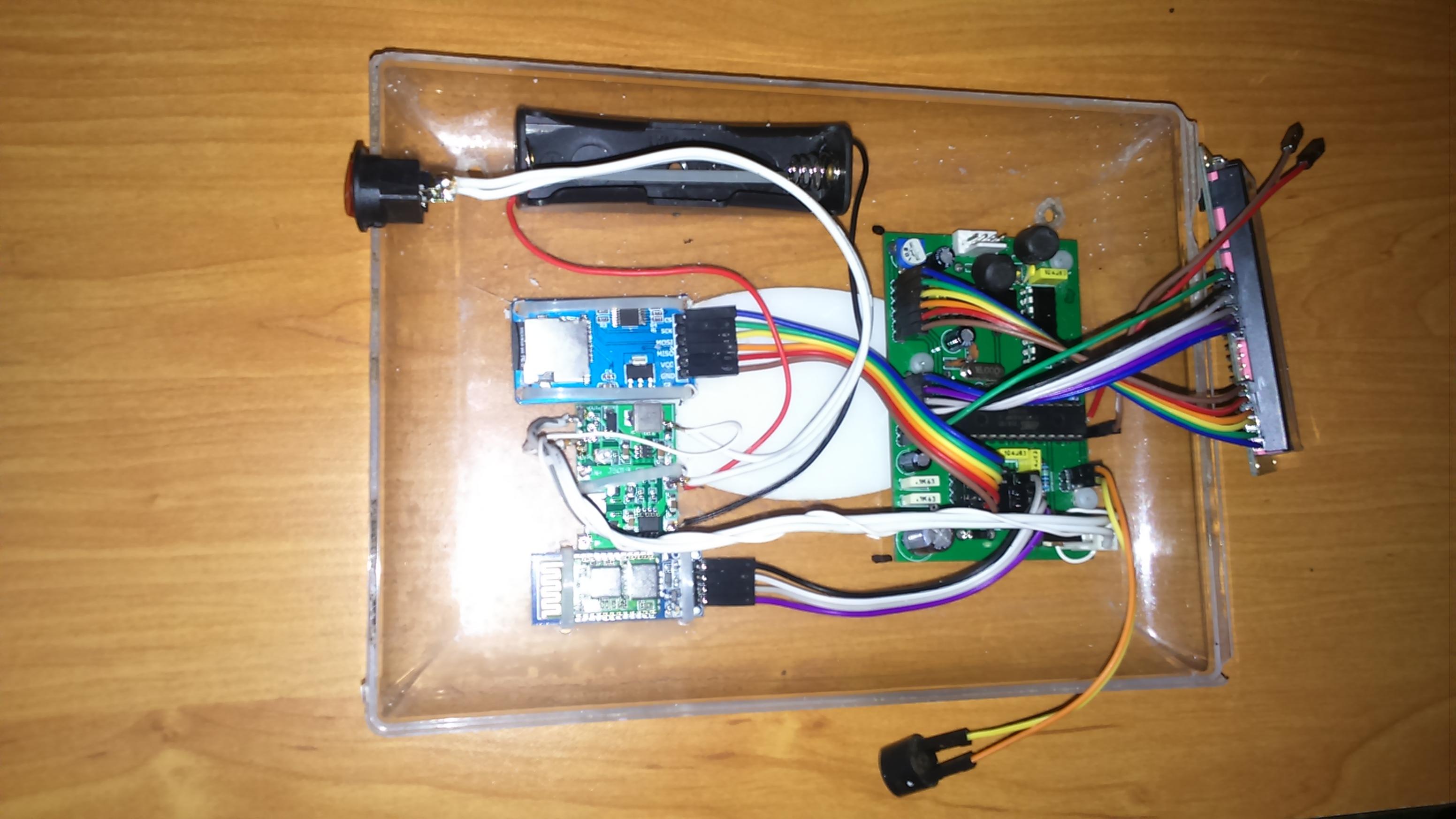

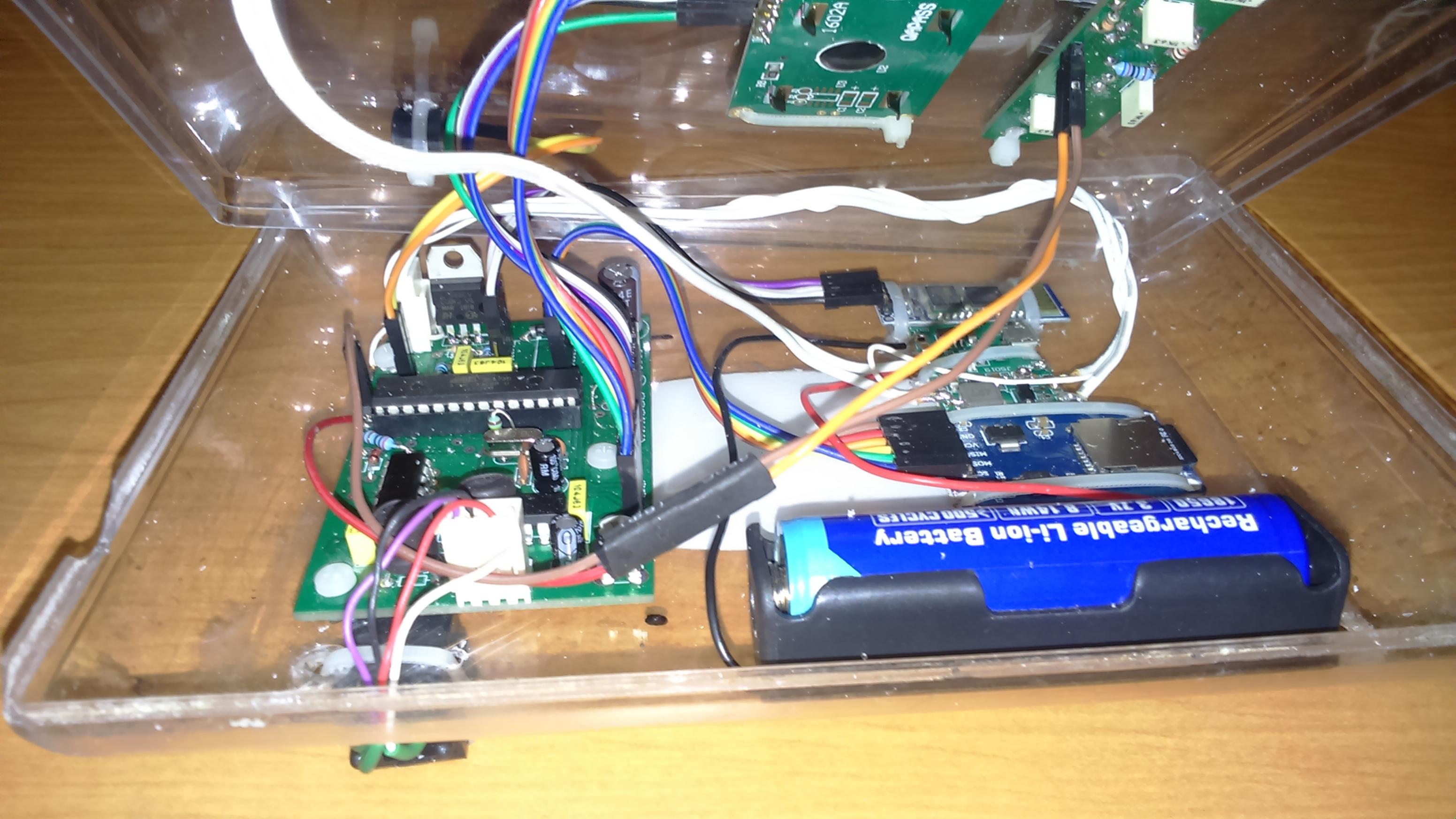

              • Some time ago I bought a KIT from Ivconic. I bought it, I bought some missing elements plus FG-3 + sensors from fgsensors.com/shop and started folding. The electronics box that I had turned out to be too small so I used the ones I had after chocolates 14x19x4cm (terribly weak material for a 1mm case) folded only to run and check if it works. In the field it is better to have it in a box (after chocolates) stiff than everything loosely. Aluminum tube, bushes turned from polyamide, but the sensors on the manufacturer's side turned out to be uneven. On one hand, 11.5mm, and on the other, over 12mm and sleeves had to be lapped with sandpaper. After putting it in a pipe in well-fitted sleeves, everything was arranged nicely in the axis. I used a 0.5mm cable to connect the sensors to the box. After the initial tests, the equipment is very stable and precise. This is my first magnetometer. Technically very good and simple. Aesthetically, this requires a lot of improvement. The box will be smaller and made of 3mm plexiglass. I really liked the colorless housing. I will also replace the cable with another one. The pipe to be painted or I will put it in plastic black. The box with electronics and battery weighs 240g. Aluminum tube 40mm / 3mm, wall 95cm long with sleeves and sensors about 1kg. Another lighter pipe could have been used. Pictures taken right after firing up the equipment as I haven't even cleaned up yet. If I improve the cable and the box aesthetically, I will probably upload photos too.
                I have not seen on the forum that someone from the EU bought and described, and the equipment worth recommending. The program is very well refined.
                Due to customs and taxes, the KIT option was more favorable to me. Due to the fact that magnetometers are not very popular in my country, and I am weak in electronics, Ivconic, two constructors from my country (including mainly Krzysztof from this forum) and a colleague of electronics supported me with my knowledge.
                • I see you made it! Bravo!
                  Next step is to make proper enclosure.
                  But you passed the most important step, it is working and alive, that's good!
                  Yes, i also have the same remark upon sensors.
                  It would be better if those are made in straight cylinder without differences at sides.

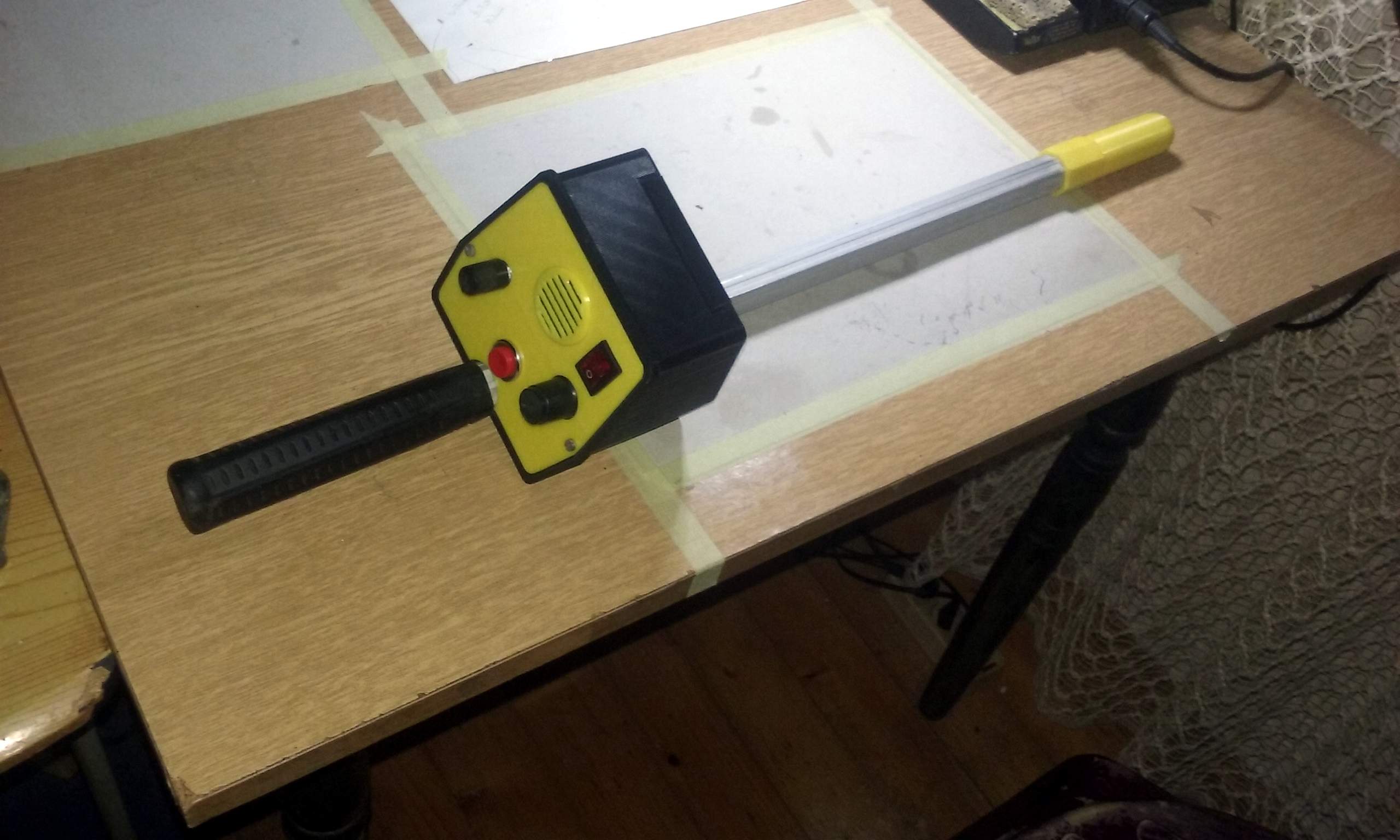

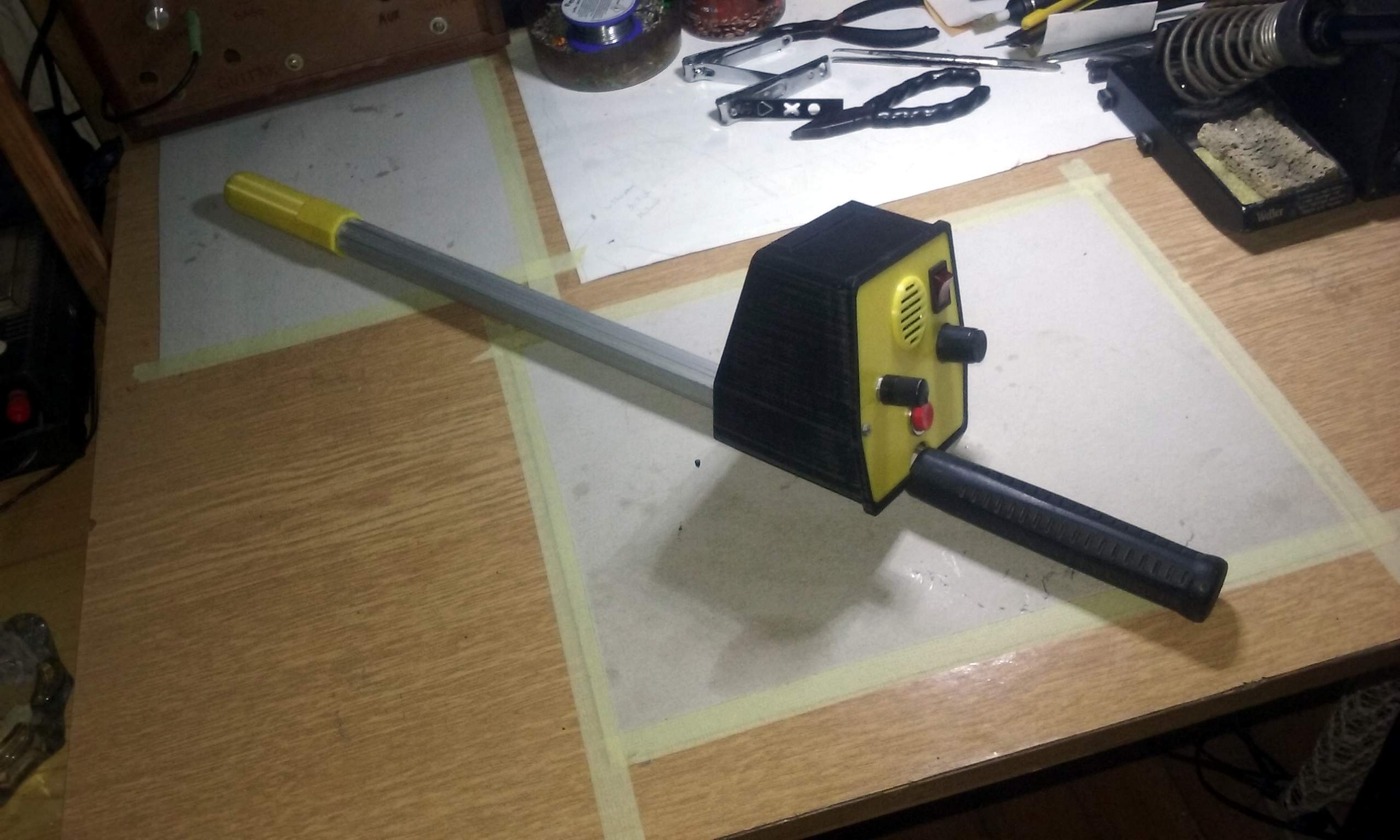

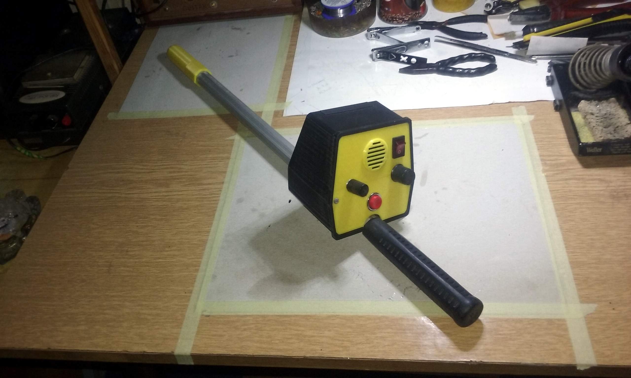

                    • This is my latest "product".
                      Magnetometer probe.
                      Very sensitive!
                      I am amazed!
                      But since outdoor is very ugly and bad weather; i can not test it outdoor yet.
                      It has:
                      Audio volume
                      Retune
                      Sensitivity.
                      uPC based, i wrote different code.
                      Only one sensor inside
                      Very agile and sensitive.
                      Producing two kind of tones; "negative" and "positive" .
                      Many locals here in my country complains on complexity of my main magnetometer product (yoyos, who don't want to read neither 2 lines of explanations in User Manual, same yoyos who expects miracles with only one knob to turn and at the same moment to discover huge fortune)
                      So i made this "probe" for such lazy and limited minded people!
                      (hell of advertisement this would be!!! nobody who read statement from the above ; will certainly not decide to buy it, because if buy it; admits stupidity, am i the duke of the advertisements&sales or what??)
                      I will put nice shiny label on it with brand "El Stupido" for USA market... and "Durak" for Russian markets!

                          • Maybe a little smaller housing and a clock analog signal strength indicator and very good practical equipment. An amazing idea.
                            • Congratulations!
                              For the video, for now, your Mage senses a change in the horizontal lines of the earth's magnetic field forces. After the reset always silent, then it gives a positive or negative deviation depending on the rotation.
                              Give better video with mag vertical setting, then it will signal nails in the floor.
                              Best contraption under the name 'The Mag for Dummies'.
