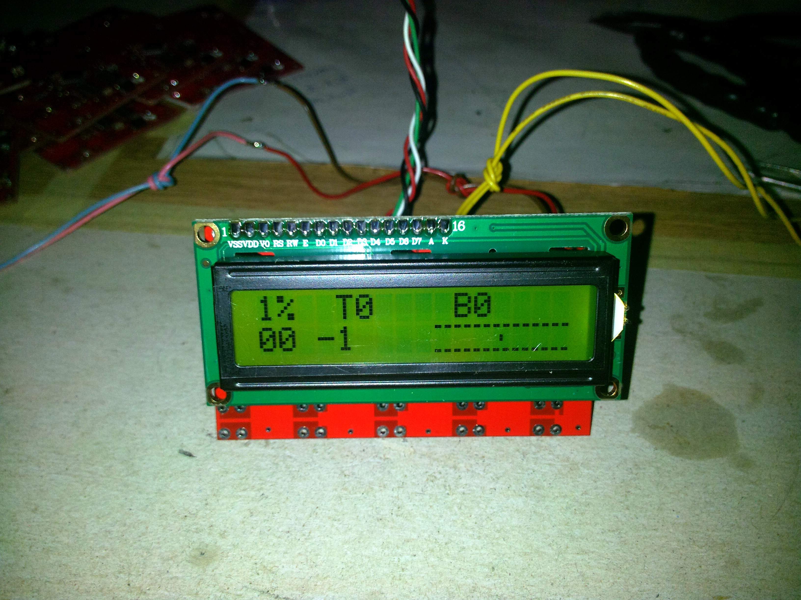

    • Originally posted by Krzysztof View Post
      Congratulations!
      For the video, for now, your Mage senses a change in the horizontal lines of the earth's magnetic field forces. After the reset always silent, then it gives a positive or negative deviation depending on the rotation.
      Give better video with mag vertical setting, then it will signal nails in the floor.
      Best contraption under the name 'The Mag for Dummies'.
      I tested it in vertical position too, but not recorded on video.
      It is rock stable and it detects rebars in the floor.
      Very sensitive.
      The procedure is as follows;
      1) Switch it ON,
      2) It plays the intro,
      3) It plays "negative" or "positive" audio (depends on orientation)
      4) Press Retune once, it takes one "extreme",
      5) Press Retune again, it takes another "extreme",
      6) It is ready for operation.
      7) Any next press on Retune button is just placing present sample in the middle of "zero" ("window" explained bellow).
      Now... how to explain "extremes"? Those who ever had and used White's Eagle, Spectrum, XLT and DFX; will remember functions "Air" & "Ground" balance at start, before detecting.
      This is something similar.
      There is a "window" between "extremes", the silence, no response, "zero" or call it anyway you want. Sensitivity pot defines the width of that "window". Simply as that.
      Simple.
      • I remained only at the vertical position (no interference from the horizontal field).
        Any press on Retune button you can give such code:
        int Ton = map(MLicznik, -1000, 1000, 100, 5000);
        tone(Piezo, Ton, 180);
        Then you have a tone dependent on the signal strength (MLicznik) with the middle around 2600Hz. It's enough for those who have enough sound.
        I use this as an option with continuous measurement.

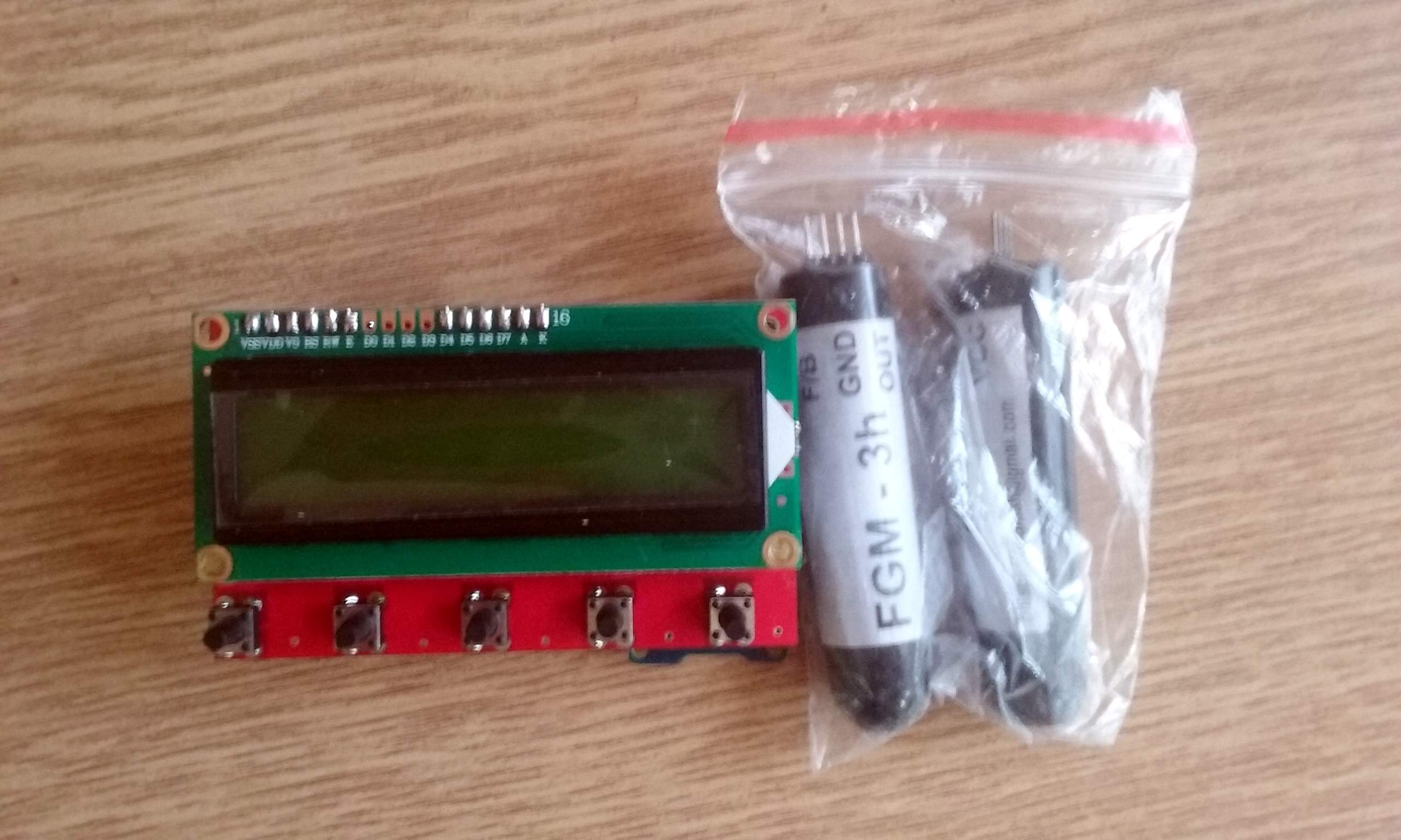

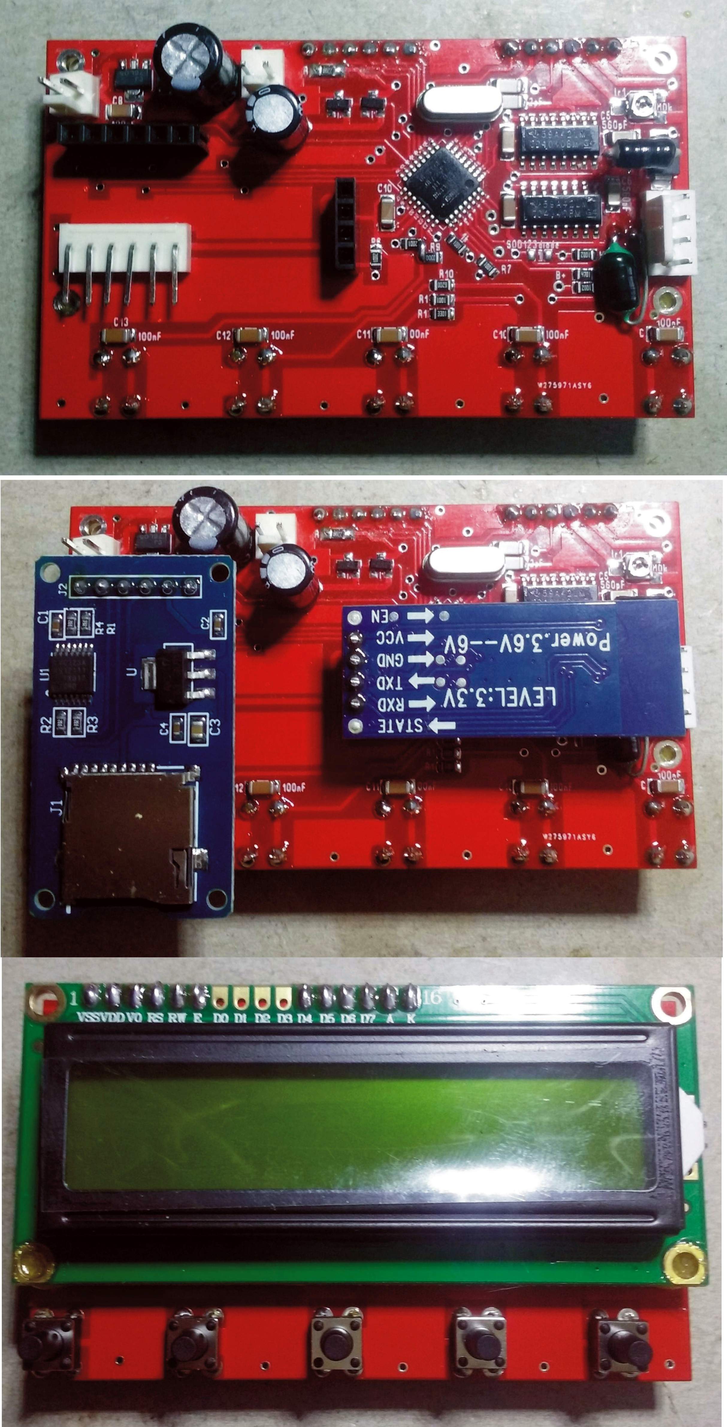

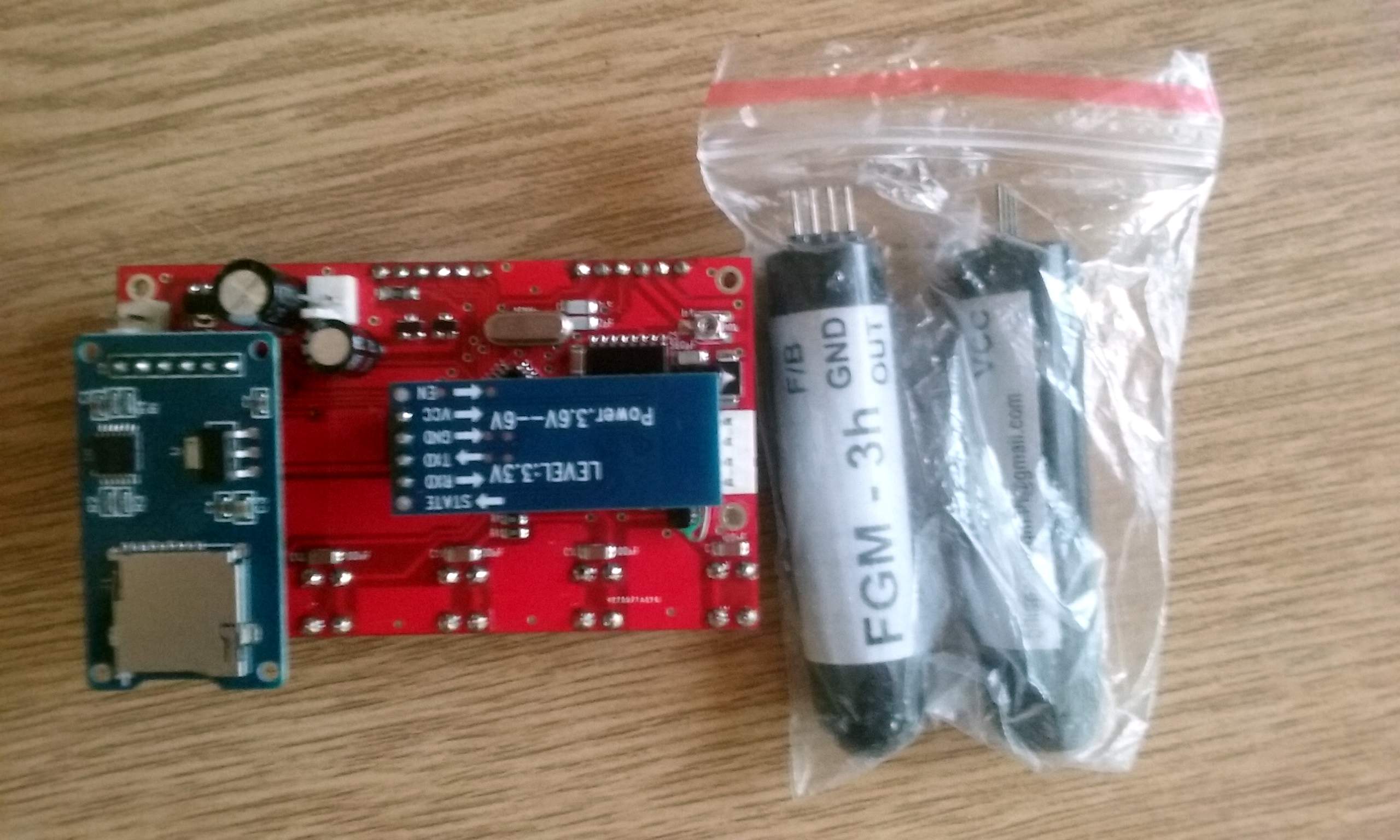

        • Comment

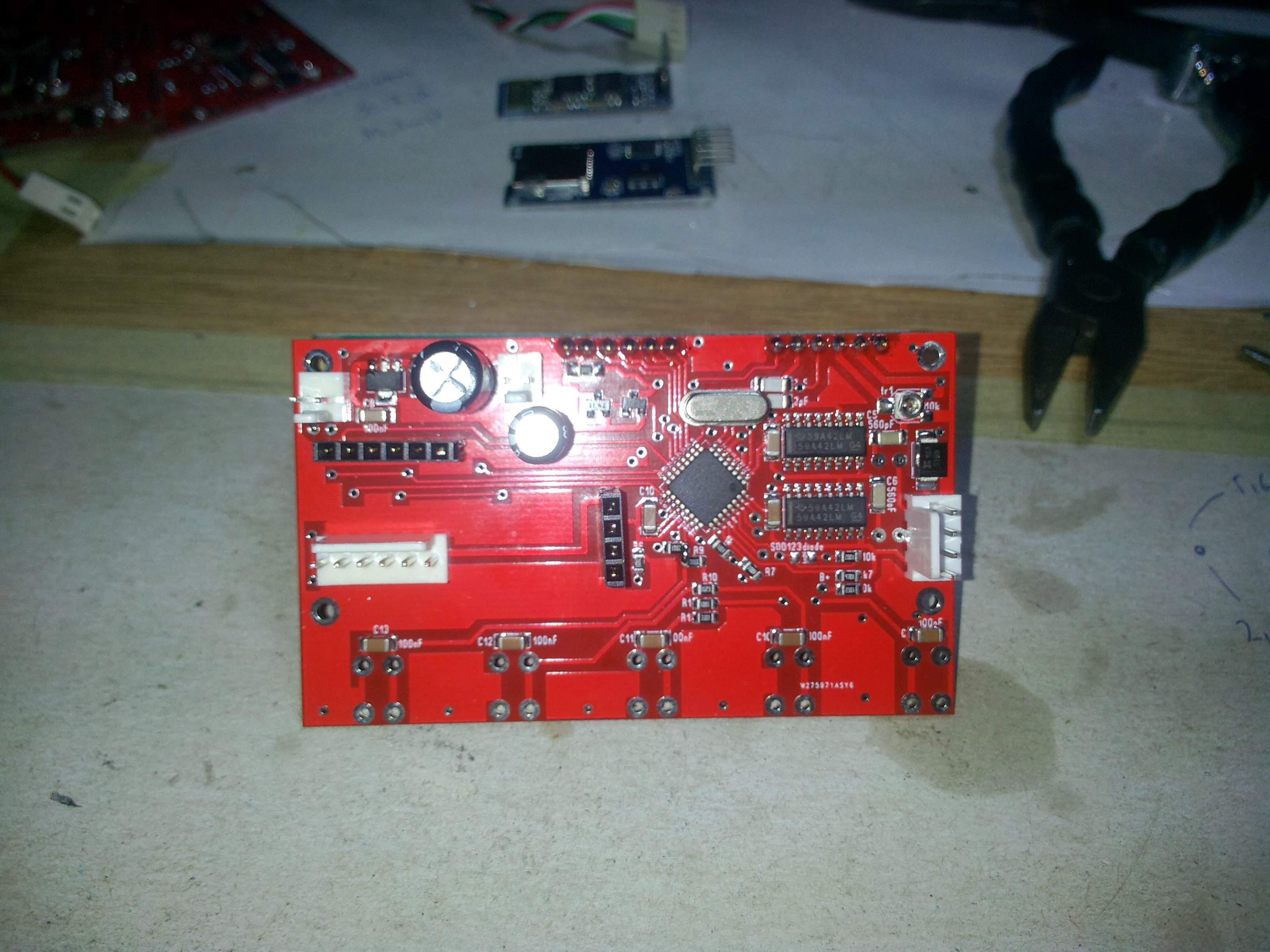

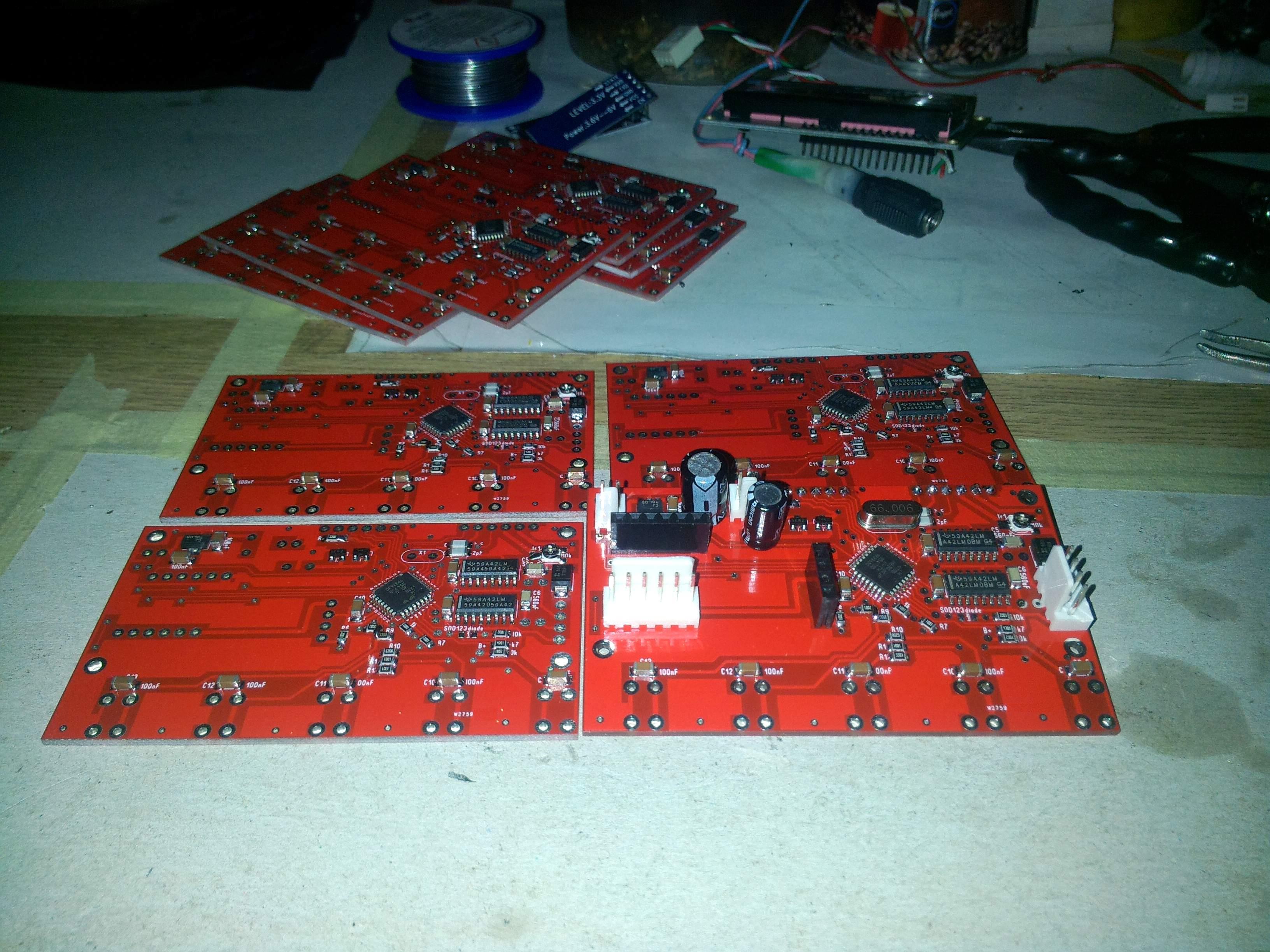

          • Finally after 4 months delay; new SMD pcbs arrived today!
            So now i have in offer also kit in SMD version.

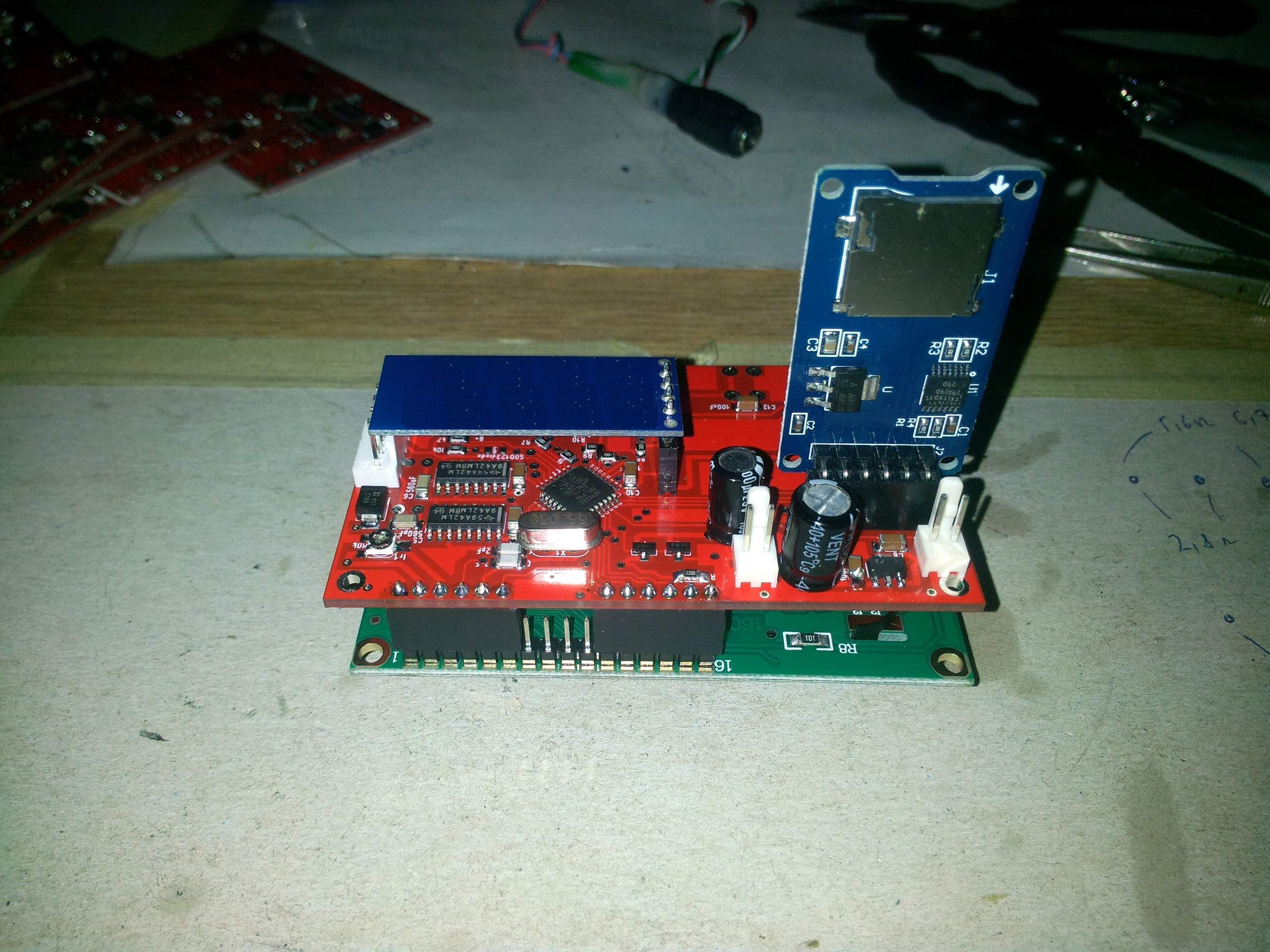

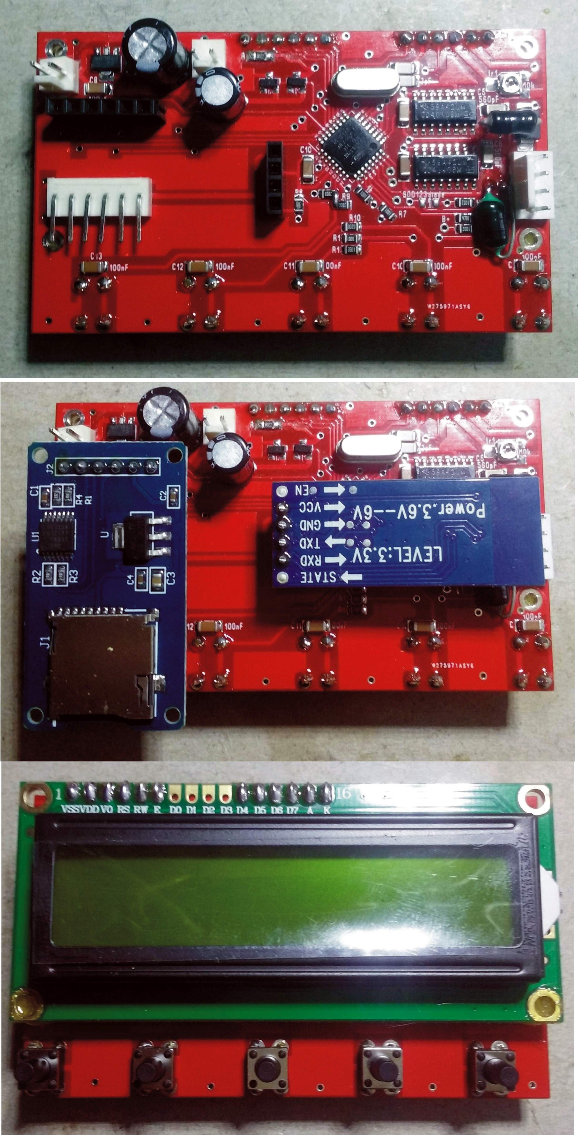

                      • SMD kit assembled:

                            • Modular configurable design, by the customer desire.
                              For example: in case of use with Android application; SD card option is not mandatory, becomes redundant and can be omitted.
                              Since all the logged data can be stored directly in Android storage memory and later transferred (by cable, by BT, by wifi etc) to Windows computer.
                              Data are in the same format and are interchangeable between Android and Windows software.
                              However; SD card presence is also good, acting as "hard disk" with sorted data organization and file system.
                              Data are sent via BT to paired Android or Windows system and at the same time also stored on SD card.
                              Data are kept on SD until user decide to delete them.
                              Each filed exploration can be saved as separate file.
                              During the day user can explore one area and save data into one file, replace to another area and record it in another file etc.
                              By the default i am putting 8GB SD card in the device. But user later can remove it and replace with larger capacity.
                              According to my field experiences 8GB are way more than enough for storing several days on the field.

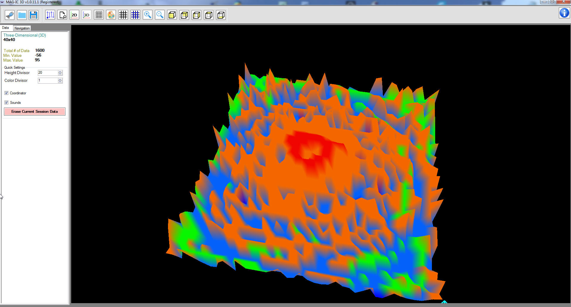

                              Last updated User Manual:

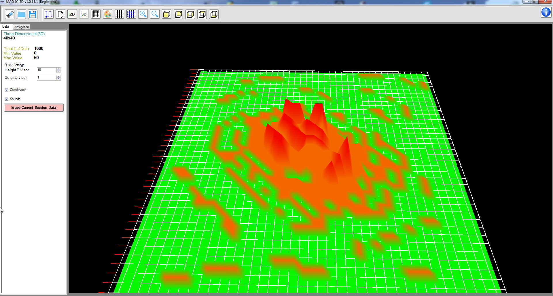

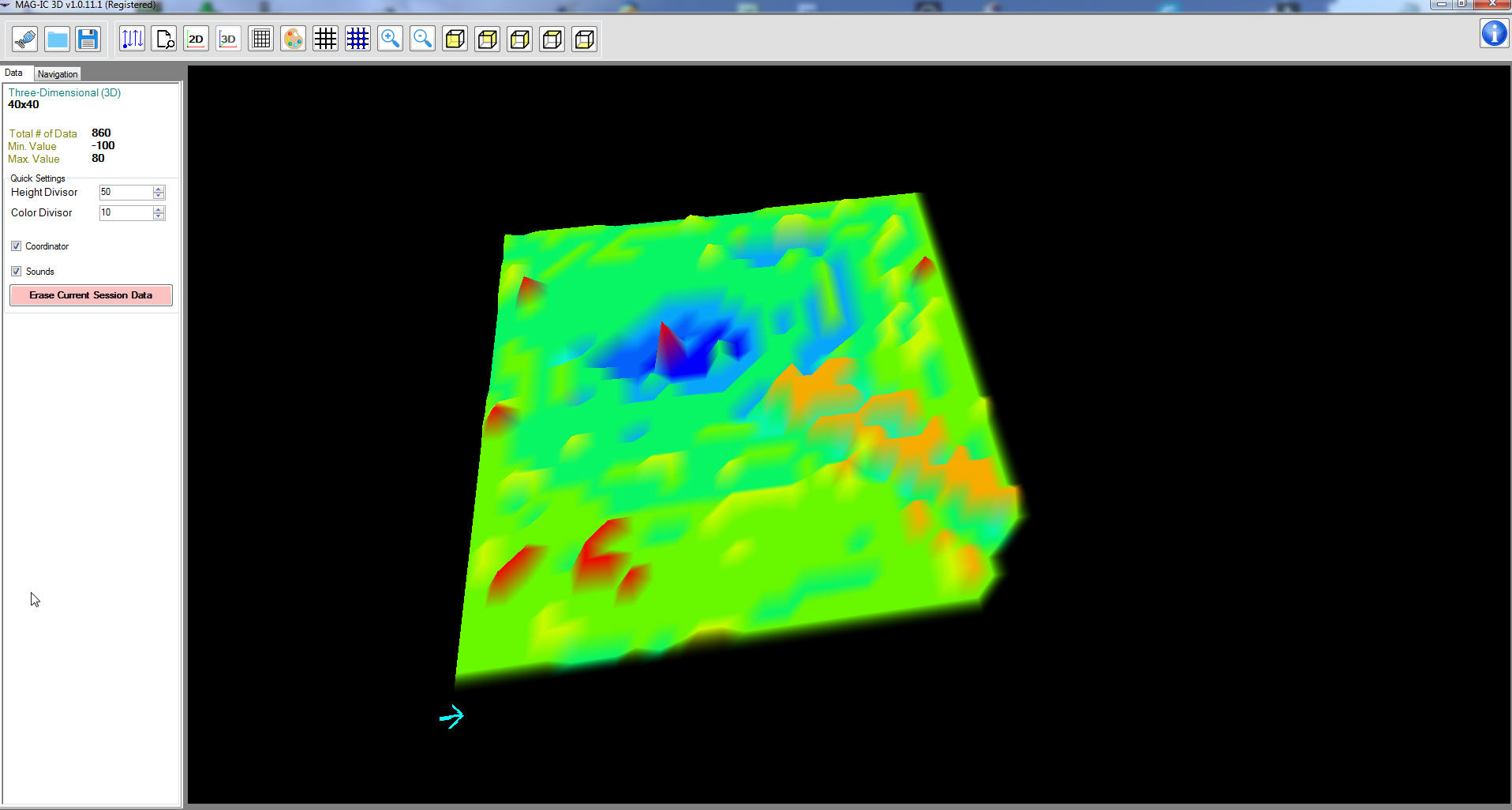

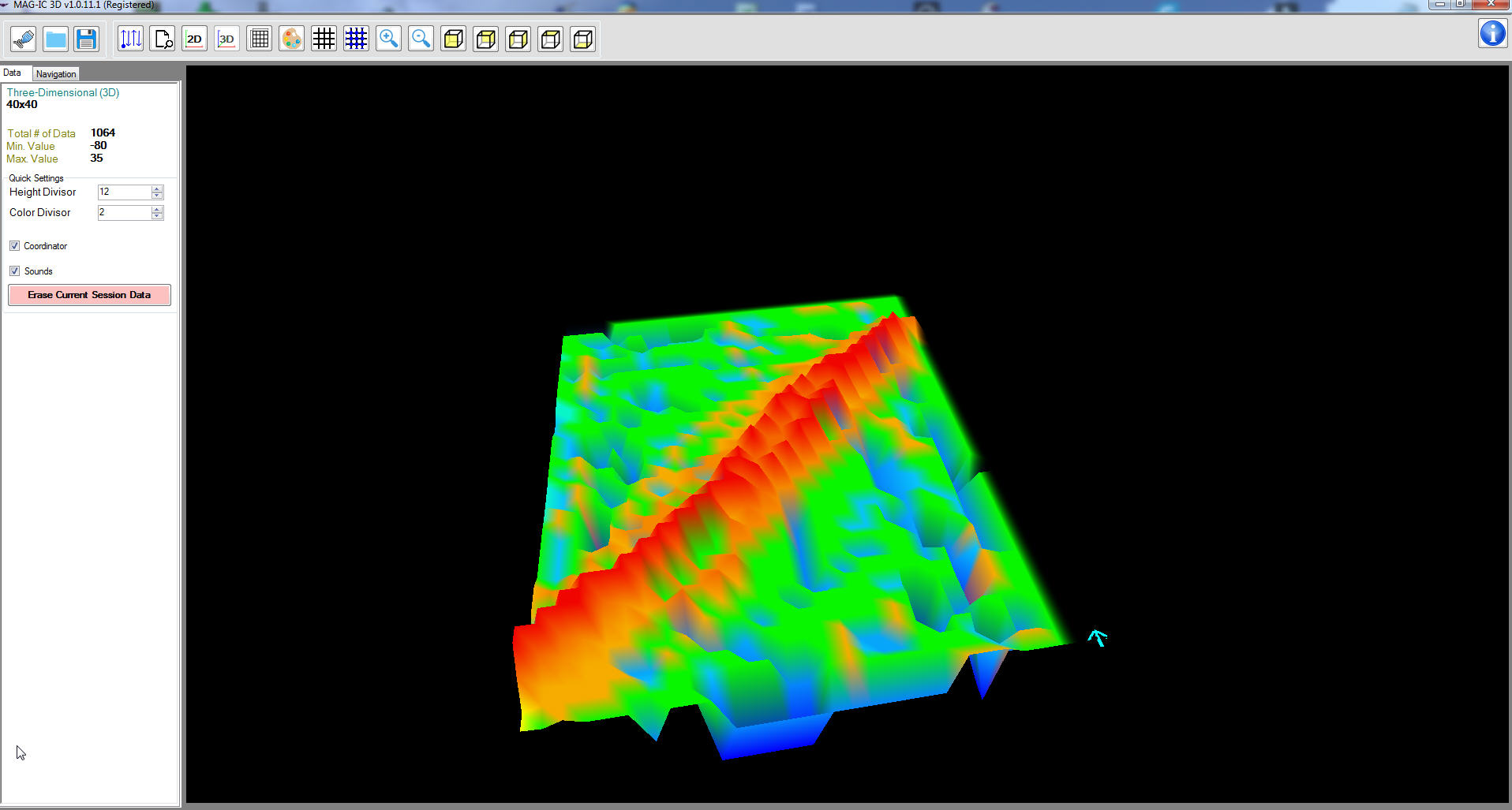

                              • Android and Windows software are complete our own intellectual product.
                                I can also offer repurposing the software for to work with different setups and devices.
                                Any type of logged data can be graphically displayed and processed with such kind software.
                                Therefore this software can be arranged to work with wide variety of data loggers.
                                Also with conventional metal detectors too, providing special data conversion and output format that is needed.
                                Data are encoded and can be read/write/open only by the software.
                                Both; Android and Windows software installations are tied by the accompanying device with special ID key and will not work with device with different key.
                                This option is not mandatory and can be omitted. Or evolved further to more levels.
