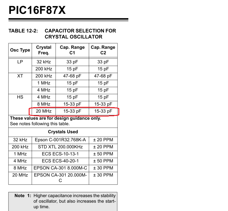

                            I changed the quartz 20MHZ with another and two capacitors 33pF, and even problem. It remains to check the programming of PIC. Before that I will remove the circuit LM35DZ, may be that causes the problem of instability.

                            • According to the parts list and PIC data sheet the cap on the 20MHz XTAL should be 10pF not 33pF.
                              Is the serial data working correctly? All data passing without errors?
                              If so then the PIC's oscillator is probably running correctly.

                                According to the PIC16F87X datasheet page 122 table 12-2, the two capacitors must be between 15p and 33pf (see attached capture).
                                -Yes the transfer of data to the PC works without any problem with 10pF or 33pF (I tried both valeus of capacitors).
