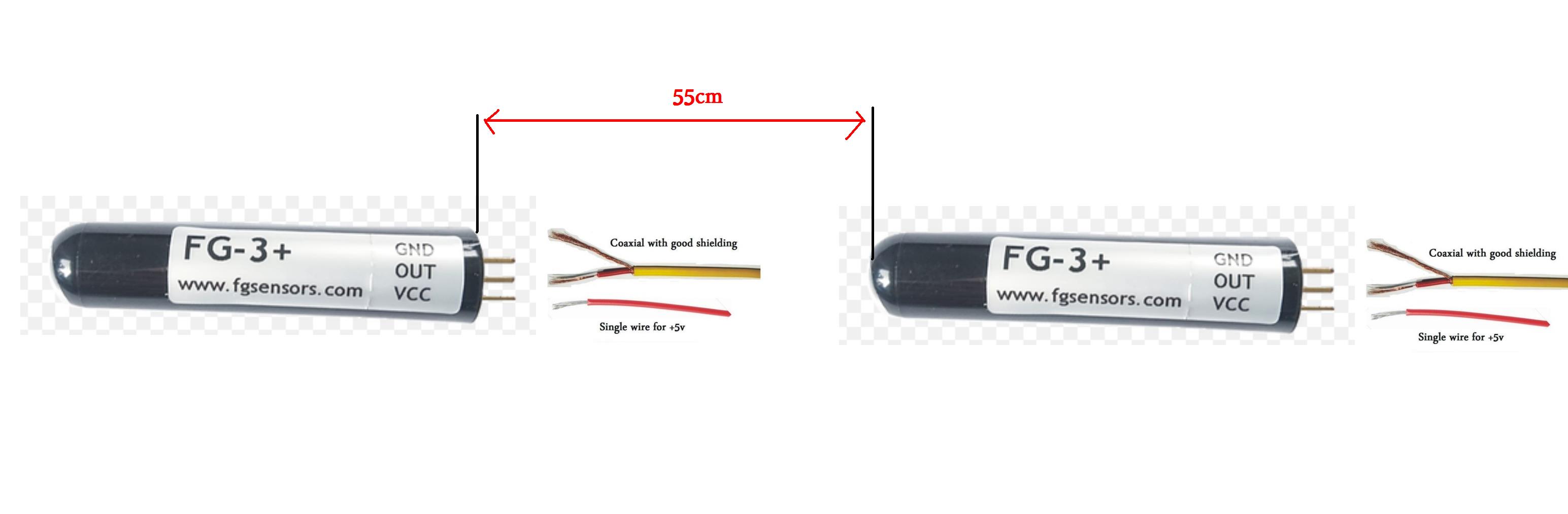

    • When packing sensors in pipe and connecting them with wires; most important thing is to chose proper shielded coaxial leads for that.
      To minimize mutual ringing and crosstalk interference. And to prevent it completely; a low pass filter at the end of leads is almost mandatory.
      On second look; i think you have exactly that problem. Looks like there is a
      crosstalk in your leads.
      Here is splendid and straightforward article on how to overcome that problem:
      • Sensors are providing pretty robust 5v square signals at their outputs with variable frequency in range ~30 to ~100kHz... give or take it few.
        Obviously those signals are not "synchronized" ! LOL
        If leads are not proper; you can only imagine what can go wrong there in the leads, all the way up to 4013.
        One will "trigger" the other and vice versa. Terrible crosstalk interference will occur.
        Good shielded cables, separate for each sensor and suggested low pass at the very end of those cables, put closest possible to 4013 inputs: should improve present situation significantly.

                      You keep insisting on "4-wire... " , "x-wire"....
                      Can't you use simple single coaxial?
                      And than add another single wire for +5v near the coaxial.

                          Thank you, it is the connection of sensors inside the pipe, and to connect the probe to the device what is what I should use?
                          And please, give me an idea for the filters that must be installed near 4013 for each sensor, what are the values of C and R.
                          • Originally posted by amitech1982 View Post
                            Values are in the article i posted.
                            From probe to the device; two separate coaxial + 5V wire.
                            Install filters as close as possible to 4013.
                            • For FG-3+ no need RC filter. It is integrated inside sensor.

                              • Hello.
                                I made an LC filter (L = 6.8uH and C = 560pF) as indicated in the article, all close to 4013. I then attached to the device a single sensor with 3 short threads 15cm in length, but unfortunately, the problem persists, and the frequency reading is still unstable ... I do not know where the problem is.
