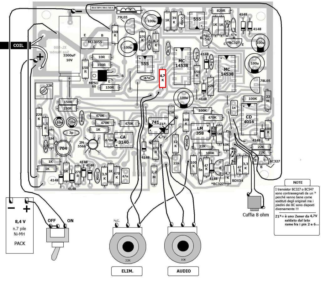

      • I think I will put the vco on hold for a while.....by the way I did try the trimpots aswell but had no affect what ever I did ...

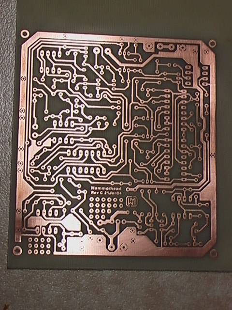

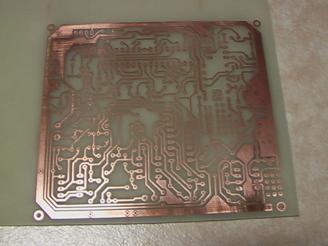

                    • Hi guys I have made the pcb today using the press n peel iron on transfer film then put it in ferric chloride for 10 minutes and heres the result ,I still need to drill all the holes and cut the excess of the board...what do you guys think of it .Porkluvr have you made the hammerhead pi ...Should I do a new post rather than carry on with it here...what do you guys think?
                      • Dang! Looks Good.
                        Yes please start a new thread.!
                        • Originally posted by Micheal View Post
                          Very nice! Be careful drilling the holes. You should have a small drill press for that many holes. And of course, multiple drill bits. Without a press, you will get tired and as the drill bit(s) gets dull you will start to miss the mark. And bits break more easily if you are the slightest bit off from verticle.

                            • Hi guys ...after more fiddling with the XL500 I have been experimenting with the 5K mod which worked really well making a huge difference in sensitivity,I decided to go down to 4.7K resistor and I have got more sensitivity again ...at this stage it works nicely ,I have tried it on coins and a flat small and thin 5mm stainless steel washer weighing no more than quarter gram and it picked up at 7cm which is awsome for this machine.
                              I have tried 3K resistor which is too low and the machine loses total sensitivity...i will keep trying resistors between 4.7K down to 4k and try to find the optimum resistor here and will let you know what the results are.
                              My question is the XL 500 operates quietly at when the Audio knob(which is really the sensitivity knob) is turned up until the there is a tone.As the knob is turned for more sensitivity then at maximum sensitivity which is just before when the tone is just audible everything is sweet .But just after that point turn the knob anymore and then you are increasing this tone louder (similar to a gain or feedback affect)which overides the sensitivity ,so you have a loud tone with no sensitivity at high tone level....why does this happen.I have tried removing the LM358N so there is no tone and what is going to happen and the result was just the buzz from the current is audible to see if the problem is before the final stage and the affect is still there any ideas on squeazing more sensitivity out of this machine.There must be other things to look at besides the 4.7K that can be modded ...help wanted with this

                                5k was the best I could do on the mod, I think all machines have a few variables in the manufacturing process.
                                Any more Sensitivity is going to come from the Front End and Sample Amp I think.
