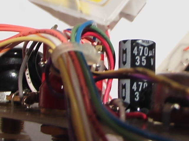

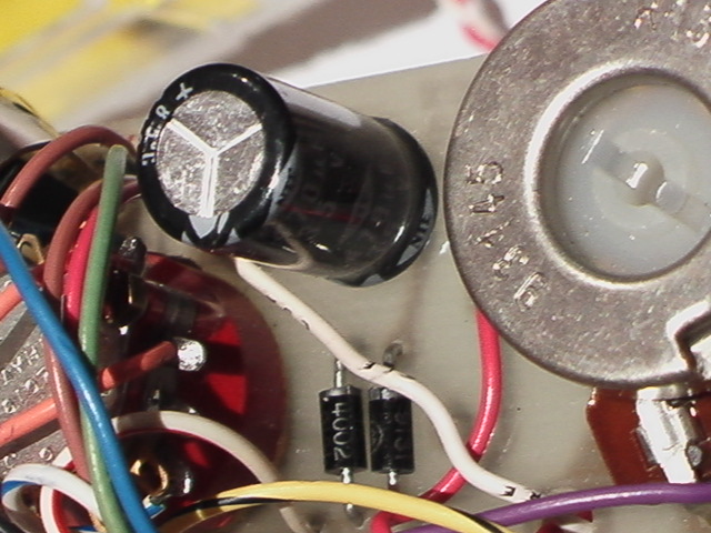

            • there is no power on anything on the main board...however on the little board which has the on /off discrimation and threshold pots on it has power from the battery ...because this is where the power from the battery leads into but any wire that connects from this little board to the main board carries no power (no pwer going to main board),so I am thinking that the damage might be restricted to this area (little board) and there isnt many parts on on the little board so I will change what ever parts there is and hope fully this will fix it...I will post some pics so it helps.

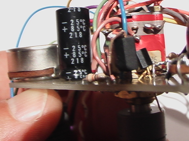

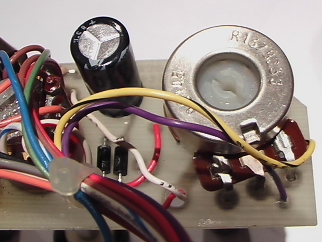

                • I am not that experienced at that but like I said none of the wires that go to the main board have power so the culprit has to be on the little board as far as tracing it Im using my multimetre to pinpoint the problem and it looks like it could be the 470uf 35v cap(althuogh it looks healthy and there was no pop when the ACCIDENT occured and other than that I dont know how to check caps with a multimeter) but im not sure and I also think it might be the on /off switch because there is no voltage coming out of it but once again Im not sure and I hope it isnt the switch because I cant find the same one anywhere on the net .the other parts that I am suspicious of is 2N3904 along with the NSDU45 because these have show+9V and a few times unexplanably dropped to +2.2v and I dont know why ,so I will replace these an see how it goes and the wierd thing is no part looks like it is fried but the smell is there...
                  But logic tells me it has to be one of the parts on the little board (as in the picture)
                  • more pictures
                    • Just a guess but probably a semiconductor is at fault, not a filter cap or switch. Diode or transistor most likely, maybe resistor but less likely to be only a resistor. Please don't start yanking out parts willy-nilly.
                      Do you have a digital multimeter, and does it have a diode test function? It is more difficult to (or impossible) to accurately check components in-circuit but you can often locate open or shorted semiconductors using the diode test mode of a digital multimeter.
                      Do you know how to check diodes and transistors with a multimeter?
                      A large capacitor (or other component) connected to a diode make it impossible to get a good reading so you may need to unsolder ONE lead of the diode (or cap). That is an often used technique for in-circuit troubleshooting - to unsolder one component's lead, which effectively isolates that component (if it's a two lead component.
                      There is always the possiblity of one part taking out another so if you think you've found the fault be sure and trace the board and check other connected components.

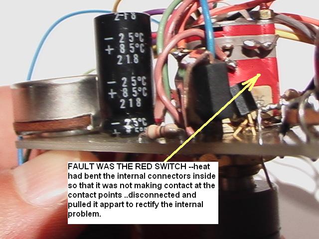

                          • Thanks gentleman for coming to the rescue problem is fixed.Thank goodness nothing was burnt out.I traced he problem ,it was in the red on/off swich on the little board.I pulled the switch apart bent the contact points inside back in shape so that contact was being made and then put it all back together and soldered everything and presto.The xl 500 is back to life
                            Thanks for your assistance guys (and thanks for the diode check lesson)...... now I can carry on with the VCO experiment.

                            • heres the switch
