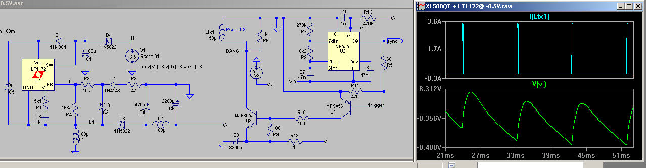

  • Micheal, you should look at the VCO schematic I drew in LTspice and compare against the perfboard you constructed. Maybe I made a mistake transcribing into Eagle, or maybe you made a mistake in wiring. In any case I'm glad a whole lot of time and energy wasn't wasted. But we haven't learned anything because the problem remains unsolved.

    • the 2 parts to remove to achieve a mono tone front view

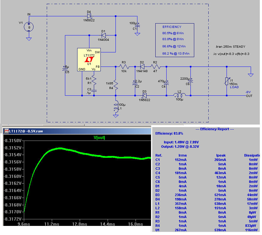

      • Here is a variation of a power supply I plan to use. The main difference is that I changed R4 to produce 8V instead of 10.5V as in
        my original circuit. Although I show efficiency report numbers, they may not be accurate. They are what LTspice calculated, but then
        LTspice reported 97% efficiency for a 14V input which I highly doubt. So I "tested" at 13.5V input and got a more believable 88%.
        LTspice's power efficiency calculator will sometimes make measurements at the wrong time and produce incredible results.
        If you don't like wasting 15%~20% of your battery power for a regulator, then maybe you'll prefer your tx voltage dropping steadily
        throughout the battery's discharge cycle? Take your pick.
        I added a a filter section to make a pi filter at the output. Although the output is not rock steady I prefer a pi filter to a linear regulator
        because there is less power loss and I figure the output is steady ENOUGH. I think so, anyway. This is not the crown jewel of

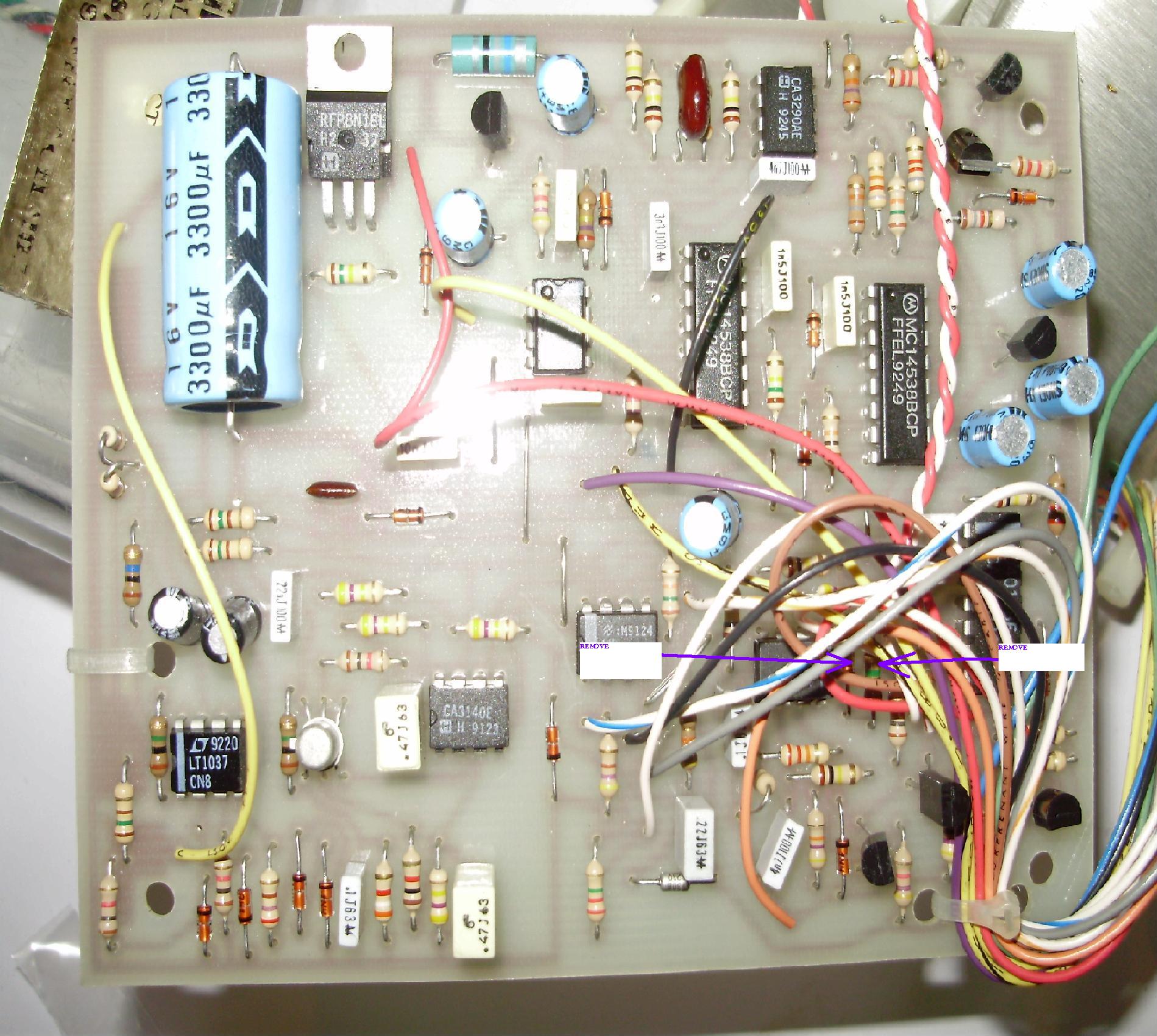

        • I have attached a picture of which ones to remove and add jumpers to...please let me know your opinion and the other question ..is it safe for the ciruit to run on direct 9volts from the battery without the voltage being dropped down by the regulators .
          • Originally posted by Micheal View Post
            Huh?
            NO.
            I do not think you can safely run from 9V without having some way to adjust the TX pulse width intelligently.
            You are going too fast for me. Do not remove the regulators, that would be very bad. (OW!!!)
            Step back and take at look at what you're doing (you are scaring me). Without an oscilloscope and some more technical knowledge you are in very dangerous territory messing with the power supply.
            Without having a schematic and PCB layout for YOUR model there is high likelyhood for error unless proceeding VERY carefully. Good communication is important.
            I'll have some information tomorrow. It's too late today. I need to crash before getting too technical and making a mistake .
            SLOW DOWN. THINK things through. Don't get over-confident.

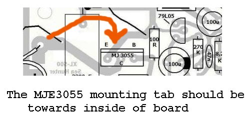

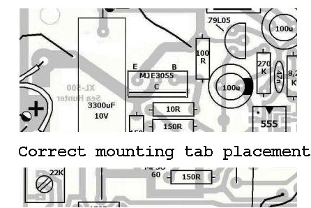

              • Possible mistake in parts placement diagram
                Micheal, I have compared the picture of your board against Homefire's parts placement diagram. I think that the FET in the picture was installed backwards. Here's why:
                I made an incorrect statement very early in this thread; that if an IRFxxx were to replace MJE3055 then it must be reversed 180 degrees. That was incorrect. I appologize.
                Another issue is that the parts placement diagram shows the MJE3055 power tab towards the edge of the board. After looking at a MJE3055 datasheet it appears to me that the parts placement diagram is wrong in this respect. The power tab should be shown towards the inside of the board. This may have been partly the cause of my getting the pinout relationship wrong... but I should have know better. The power tab is shown backwards, RIGHT?*
                I would like to point out that I still believe that any coil driver replacement should not be attempted without having a scope handy. Installing an FET in place of the MJE3055 will result in a different pulse width driving the coil (hence, coil current will be different) and will also require the damping resistor value changed. Also, drive requirements for BJTs and FETs are somewhat different so more parts besides just the MJE would need replacing.

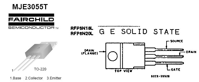

                    ...the one on my machine is RFP8N1NL and it is in the same way as the first drawing you show ,that is the heatsink is on the boards edge side .
                    Is that a typo? It looks like RFP8N18L in the foto. I think they have modified your board layout compared to Homefire's. They turned your part around! Check it out. The tab IS wrong in the parts placement diagram but on your model's board they have reversed the pads and that component's orientation! If we were looking up from the bottom of the board then the tab would be correct, but we're not.
                    http://www.datasheetcatalog.com/data...MJE3055T.shtml
                    No big deal, except that I was looking at that PPD picture and comparing with IRF640 pinout when I made the incorrect assertion that IRF and MJE pinouts were mirror images. (Stupid me.)

                      • I tried the VCO again ...and I just cant get it to work...Can be kind enough to mark where the 5 wires have to go on the photo of the board I have provided please ...I have gone through the VCO board and it seems to be as your diagram.Without faults.But just can get anything to happen.I feel that I am not connecting the wires to the correct locations on the board.If you think you know locations please mark the locations on the photo I have provided earlier this will be much easier for me to understand.
                        Also the photo that I have provided previously above that has the remove indications on them are the parts I have removed so that the xl 500 has mono tone and it is working as such perfectly(thanks to you porkluvr).
                          Simply put, I can't easily follow your fotos and trace out your board when I don't have an accurate schematic. I would prefer the board in front of me; those pictures wont do. I would need higher resolution pics.
                          I pointed out on the schematic where to make connections. I will try to explain.
                          Start with ground. Ground would probably be a fat trace running around the edge of the board. The (+) side of the large electrolytic should connect to it. Look on Homefire's schematic and find it on your board. Ground is where you would connect the black probe of a voltmeter to make voltage measurements.
                          (+5V) Look at the schematic and see where +5V is. Find the LM741 pin 7 and CA3140-7 (also LM358-8 and LT1037-7) and use a voltmeter to confirm +5V on those pins. Then look at the bottom of the board and trace back to the voltage regulator LM78L05. You should be able to read the part number on the regulator. LM78L05 Pin-1 is +5V regulator output.
                          (-5V) Find LM741 pin-4 and CA3140 pin-4 (also LM358-4 and LT1037-4) and use a voltmeter to confirm -5V on those pins. Then look at the bottom of the board and trace back to the voltage regulator LM79L05. LM79L05 pin-3 is -5V regulator output.
                          I make mistakes so you should download LM78L05 and LM79L05 datasheets and double check what I said. Actually, saying pin-1 or pin-3 is meaningless unless you know where to start counting from - so please get the datasheets and take a look.
                          So we have three of the five wires, right? Try to find connection points for those three wires as close to the regulators and their output filter caps as possible. After you locate a good tap-in point you should drill a small hole, (make sure you don't drill into a trace) insert wire from the top of board and then solder underneath. This affords some strain relief. Or, maybe you can find jumper wires on top of the board to solder to.
                          For the VCO input locate your CA3140-6 (the output) follow that trace and the resistors until you come to the LM741-3. You should probably solder in the mid-point, to the junction of the two resistors and capacitor between CA3140-6 and LM741-3. They may have changed your circuit so keep your eyes open. I doubt it, but maybe.
                          VCO output should be at the end of the 47k resistor that connects to the LM358-7. You would need to disconnect the LM358-7 because that WAS your sound oscillator output but is no longer.
                          Sorry, but I had trouble following your fotos. If you need more help, I need a clearer pic. Send to me directly by email.
