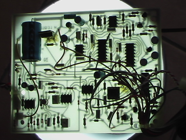

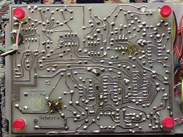

    • #92
      Is this what you need? The one I'm working with!

          Micheal's board has LT1037 opamp, CA3290 dual comparator, and RFP8N18 FET so it doesn't match any schematic seen here so far. (But it does use 2N5566 dual FET.)
          • #95
            Must be the later version! The 500 and 200 use Bipolar transistors.
            I'd like to see how that was set up!
            • #96
              Thanks homefire ,that picture is not the is not the same board as mine.Anyway I have tried to wire up the vco and it didnt work,so I am thinking that I didnt get the connection places right...(very rugged circuitry ....still working fine if you know what I mean).
              The other thing was whilst I had the lm1458 in the board I tried out some air tests and the results were that it was fine but I wasnt sure if it was doing any damage , so back in went the 1m358. All the connections are as you told me ...but Im not sure with the input and output signal...I will take a picture so you can see ...The wiring is temperory wiring not soldered could that be the cause...

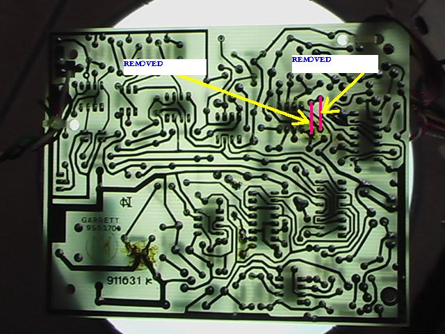

                  I think the better on the gold was the resistor mod.
                  I worked on the XL 200 and 500.
                  Pulling in the sample sees the gold better fer sure.

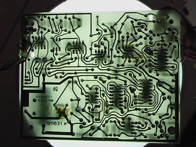

                            • heres some more pics
                              • To get the mono tone these are the 2 resistors that were removed ...Faint target signals are muche better to hear now.(thanks to porkluvr)
