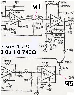

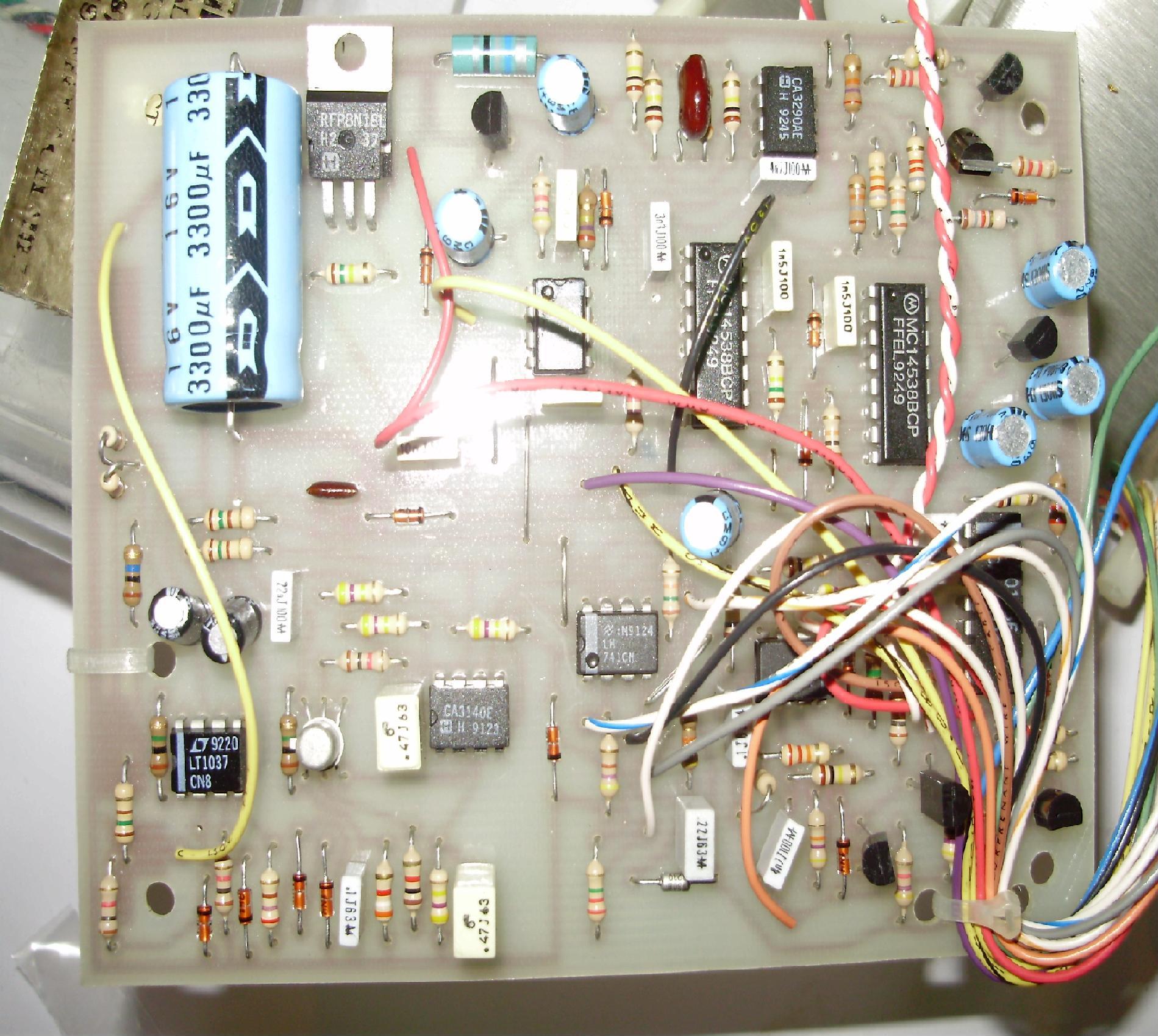

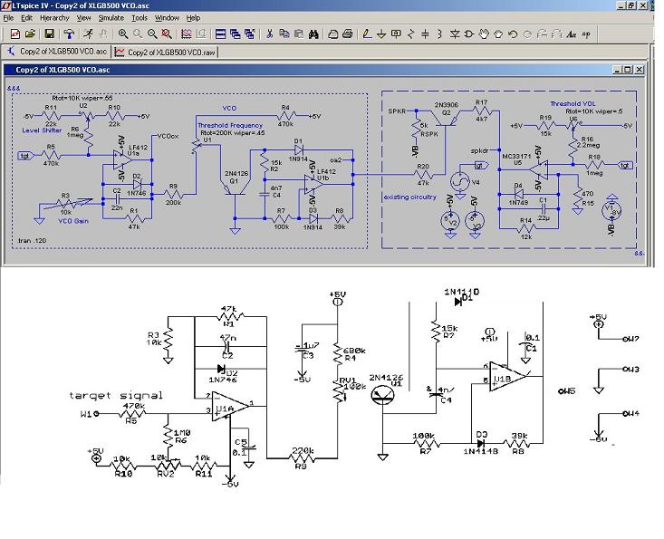

. The connection end will probably need to be left flying. Be careful not to rip the resistor from the board. It this works you can remove the LM358 (and solder the resistor end back on the board) but don't do so yet.
