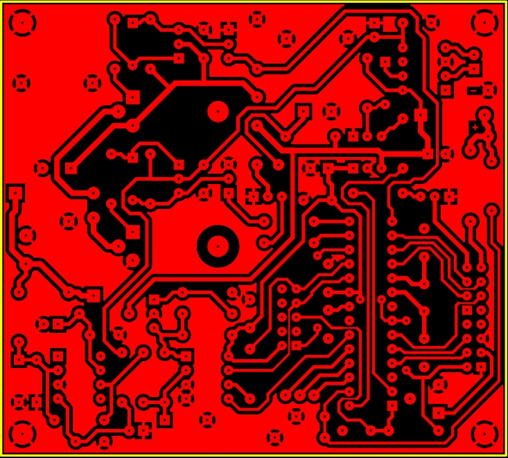

    One more Chance PCB - sandwich of two pieces: http://c2.at.ua/3m/L/Metal/Metd-4-.jpg
    Link with layout file: http://c2.at.ua/load/avr/impulsnyj_m...zhki/17-1-0-62
    • #62
      Originally posted by Waikiki_Sweep View Post
      As I can see from picture it is Chance layout from DesAlex. It is smaller, one side, easy to make PCB. I have etched one.
      Only my problem was that lay file was printed a couple % smaller so 28 pin controller hard to fit in it.
      Probably Sprint or my laser printer were wrong. Better check dimensions before etching.
      You can download all files including "Chance layout from DesAlex.lay"

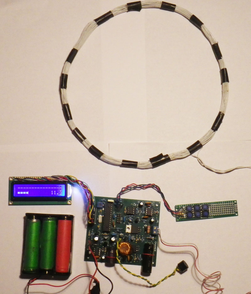

        Just build a Chance PI.
        Software version: 1.2.1.
        First impression:
        Device looks interesting. I have tried it with pretty lame coil - just a AWG 24 vinyl insulated wire.
        But even with that lame coil sensitivity is good. Also I can clearly hear difference by sound between USA 25c, 10c, 1c, 5c.
        Gold and platinum rings all falls close to USA 5c range with steady middle tone. Big chunks of iron have a low tone.
        Disappointing with small iron pieces: hair pins, paper clips, beer caps. They plays like music box changing tone widely so you have no idea what is it.
        I have tried to replace that lame coil with some better shielded and connected by coax coils but they work even worse.
        Sure I have to make a proper coil as described by author and I will try.
        But something tells me if I shield that original coil or use coax it will work bad.
        So now I need a time to learn what I can squeeze from Chance PI because my goal is make it waterproof and search in ocean. (If possible.)
        Because I expect salt water will force me to shield coil anyway and to use coax or that conducting environment will act like a shield that changing properties with every wave and trigger falsing for sure.
        I was dreaming for a target ID detector for salt water for a long time. I remember I have purchased Garrett AT PRO for that purpose but sold it because simple VLF is useless in salt water.

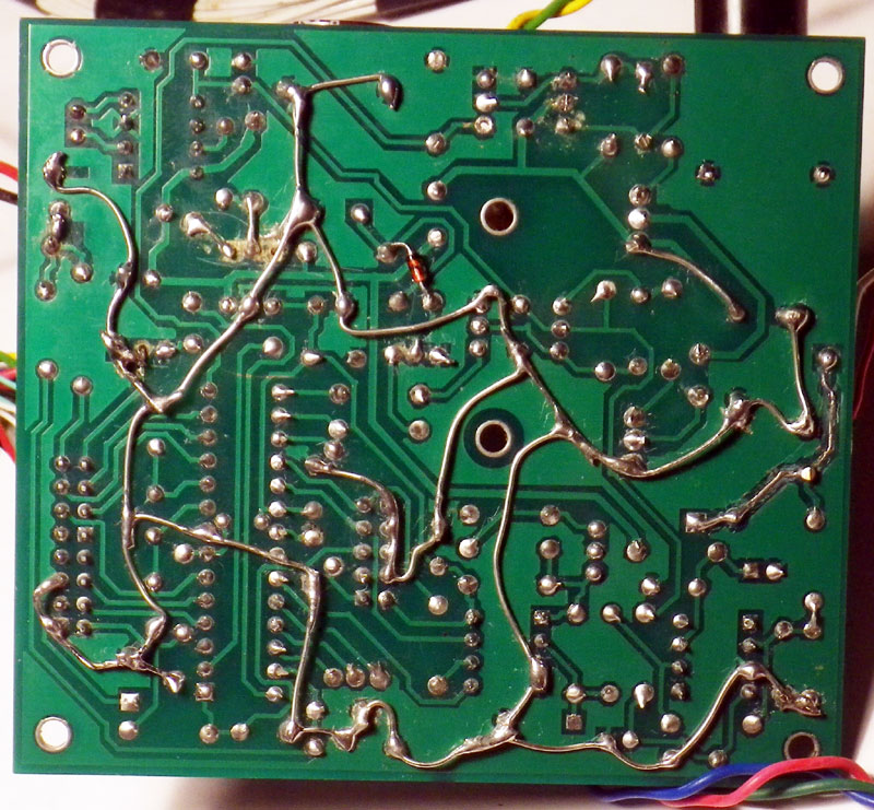

        When building Chance I had two major problems. First was absence of ground layer on my PCB so I have added a lot of jumpers.
Name:	Jumpers were added to fix Chance PCB with no ground layer.jpg
        Also couple times I have replaced transistors damaging PCB a lot because of pin-out of substitutes. Finally I got original A733 and 2SC945 from eBay.

            That "lame" coil on photo Click image for larger version
ID:	339554 that I have used to test Chance has a parameters:
            8.5" diameter
            25 turns of AWG 24 (0.5mm) solid vinyl insulated wire.
            325 uH inductance.
            1 Ohm resistance.
            390 Ohm dumping resistor was used for that coil.
            Looks like it is pretty close to required parameters so Chance works relatively good with is.
            Sure it has more interwire capacitance than reqiured by authors design but vinyl insulation provides some spacing reducing that capacitance a little.
            Probably with proper dumping resistor and correct set of Guard interval Chance can work with different coils too.
            I will try authors design coil soon.
            Thanks for advice, RG62B/U I must have.
            Also I can see that Chance can work even if case with PCB is close to coil. So for example for "diving" version cable can be very short.
            I remember that Surf PI was falsing and oscillating if PCB was close to coil.
            Why not to get that chance to differentiate by sound tone between concrete steel rods and stainless steel Rolex-es underwater?

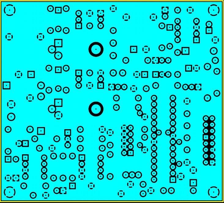

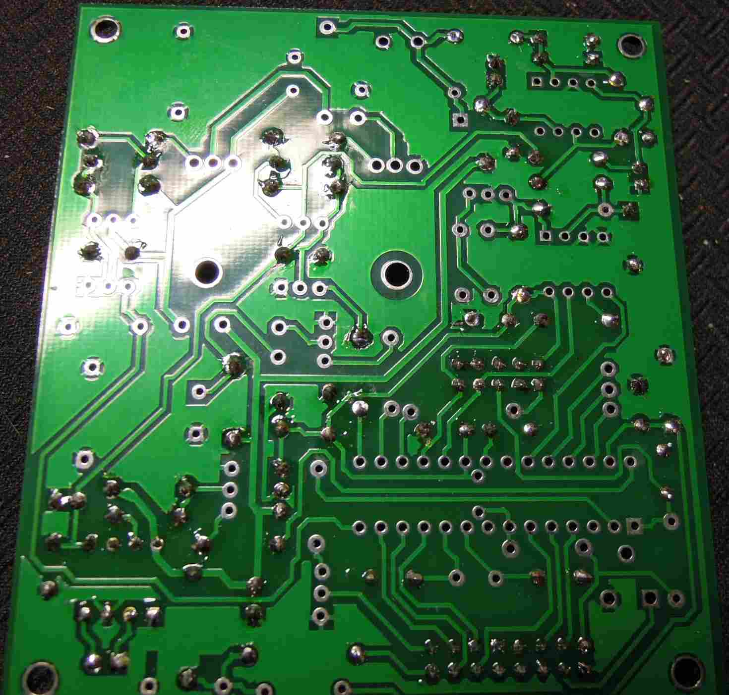

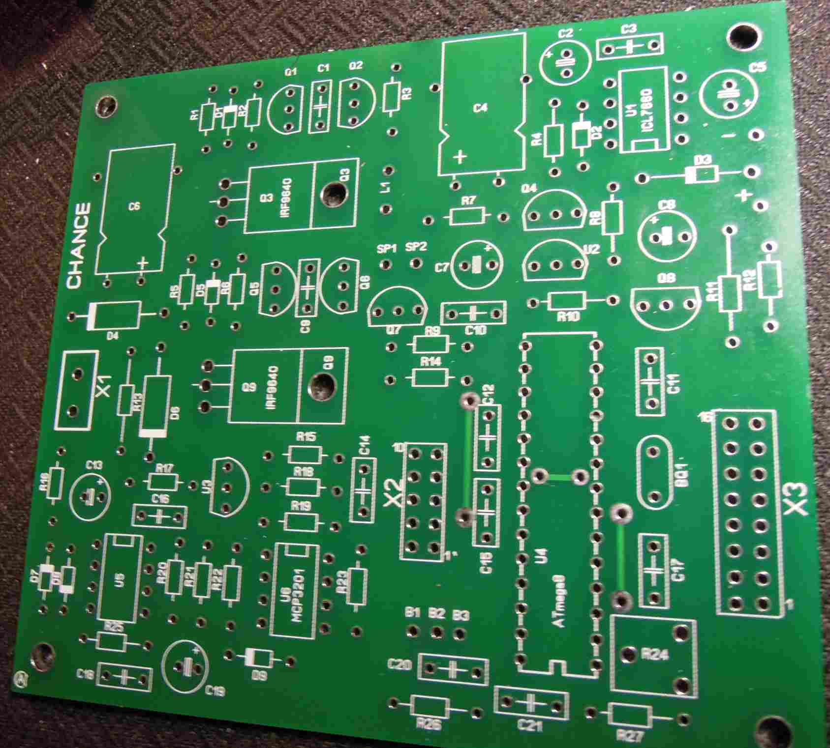

                I recently bought a chance board and wonder if there's a layer missing? It has the back side and just 3 jumpers on the front side.
                Is is a 3 layer board?
                Also were subs for the transistors ever determined? The 2SC945 and A733 are rare birds around here...
                I'm sure this was discussed on the Russian forums but they are tough to read through the translators.
                My hat goes off to folks doing the same with this site!
                I had a look at disassembling the Chance code and it's doable but it runs 60 pages! It might take a while...
                I wonder if we can convince Andy to release the code after all this time. (Mainly to allow substitute parts).
                • #68
                  It looks like you have one of the Silverdog boards. Will check mine against your photos.
                  Dan
                  • #69
                    Yes, your board is a first release SILVERDOG product. It will require the modifications necessary to run the latest Version 1.2.1 firmware. No big deal to do the mods and this is what I am currently using for all my testing reported here. The mods are detailed on Andy's website. This is not a three layer board.
                    It would be great to open up the code and make a few tweaks and I have a few suggestions along those lines if it ever becomes possible. 60 pages of code does not surprise me considering all the features and signal complexities of this detector. Seeing the code would be instructive, especially in the area of how discrimination is implemented, and there a lot of people here to assist in the task.
                    Dan
                    • #70

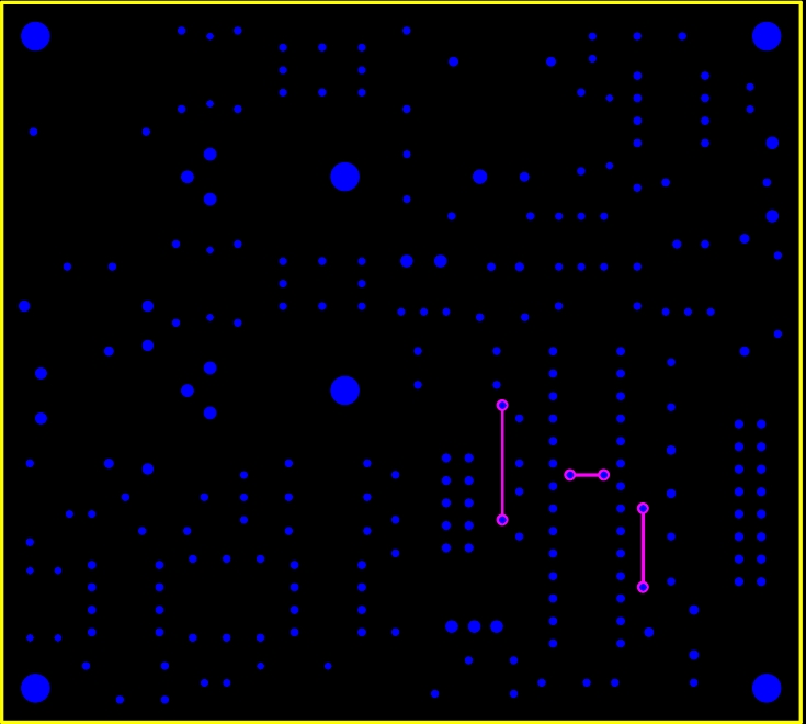

                      Thanks for your help! The mods for the new software aren't a problem. I was refering to #35 in this thread (page 2) where
                      someone said
                      "I have started to solder parts on Chance PCB and have noticed on that PCB just missed whole ground layer on the top.
                      So I will have to make several wire jumpers to ground all components properly. Probably it was one of that epic failure
                      PCB's from the first Chance with mistakes."
                      The PDF from Silverdog shows 3 layers;

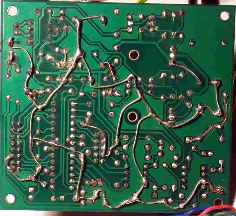

                      I just checked and sure enough I have one of the original boards with the ground plane (2.jpg) missing.
                      It would have been nice to have a corrected one but I can do something like this to fix it;
                      I can see where the screen is written to and places where he talks to the external A/D but
                      to find the disc code will take a bit of study.

                          I did not consider the three top side jumpers as a layer but it looks like that is what is depicted in the jpg. Sorry for the confusion. I believe I got my 2SC945 and A733 transistors from SILVERDOG, have you asked him if he has any?
                          Dan
                          • #73
                            Dan
                            After carefully looking at my Silverdog Release 1 and 2 boards, the jumper positions shown in your 3.jpg pic are actually wires to be installed by the builder and are not printed as a board trace. Does your board actually have the traces visible or if not can they be ohmed out? If they don't ohm out you'll have to put the wire jumpers in. As I recall this was recognized a while back as the reason some constructions did not initially work. I know it is pretty confusing when the documentation shows another layer.
                            My Version 2 board ohms out just fine on the ground planes. Considering both versions are through hole plated boards I'm not sure there is a ground plane problem in either the Version 1 or 2 boards that I have.
                            Dan

                              Good luck in soldering absent ground layer. I did it for my Chance. Pay attention for missed ground layer near pot R24 or you will see nothing on display (as it was with me).
                              Also I think that big solid jumpers I put everywhere to fix ground are good to lower resistance of ground connections and make Chance to work more stable.
                              Properly assembled Chance works perfect.
