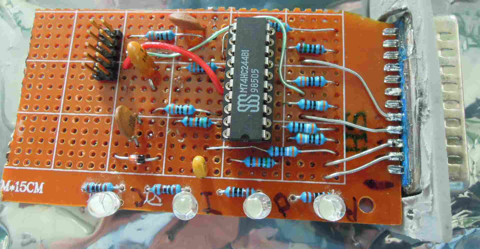

                              • #90
                                Wow $3! How can they do that? It costs more than that for a USB connector here!
                                My homemade one is working! I made it from junkbox parts so it didn't cost me anything.
                                I'm having trouble with a similar one at work, it doesn't work with 3v parts so I hope to
                                mess with this one and come up with a fix for that one. It is the original Kanda one. Here's
                                a picture;
                                The other HC244 was blown I think. They both were sitting in my junkbox for 15 years...
