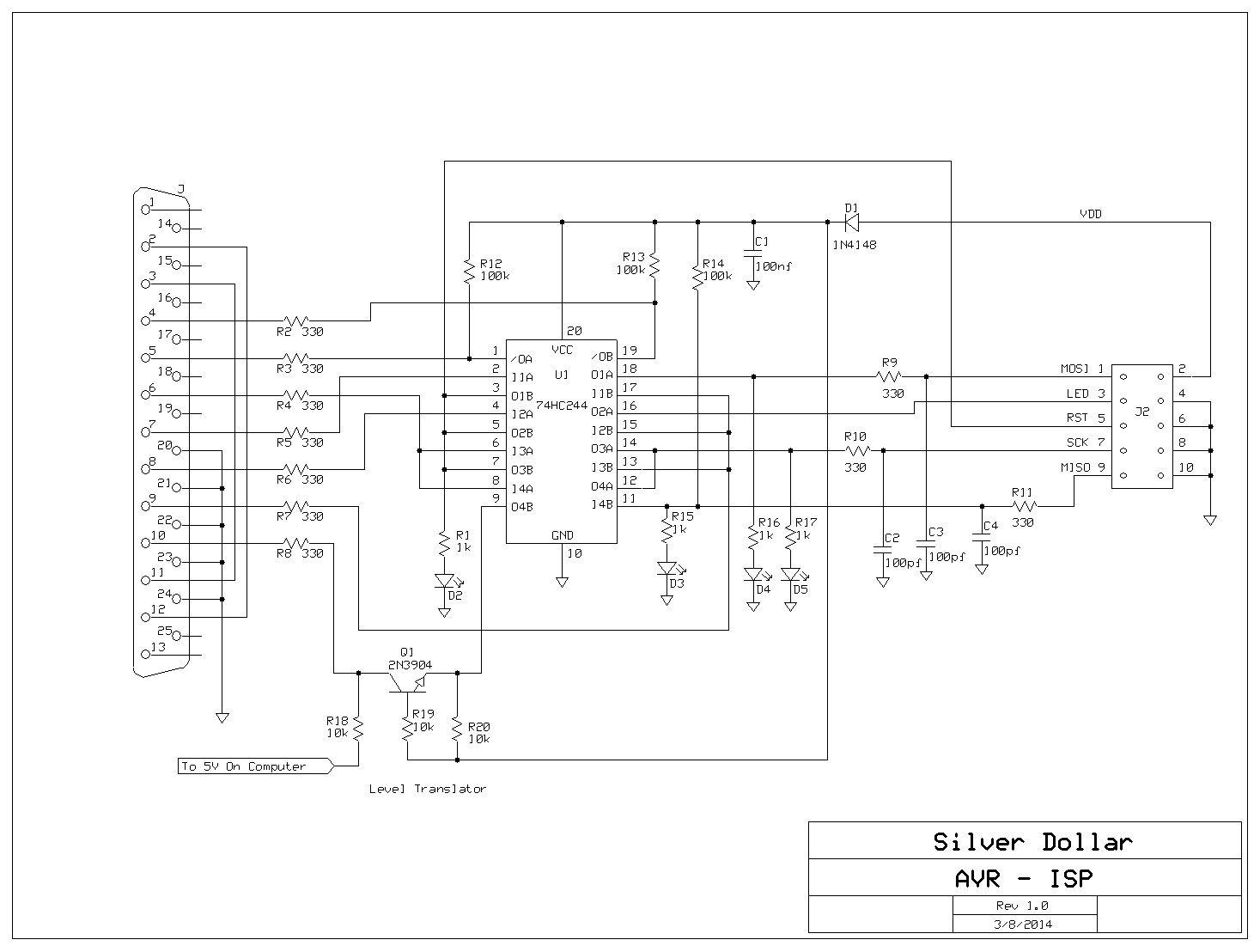

        Here's the schematic to the parallel port programmer;
        The buffer chip runs off the power in the board to be programmed so the problem
        is the MISO signal that is buffered on pin 9 of the chip is a CMOS signal at the voltage of
        the board to be programmed. Normally pin 9 goes to pin10 on the connector through a resistor
        so I made up the level translator using a transistor, the problem is I have to get 5V somewhere
        to make the computer happy. I'm not sure if the programming software keeps any lines high
        that I can use.
        They had trouble with USB programmers at work so have standardized the parallel port type.
        I saw those USB ones and figured they are just a serial emulator but wasn't sure what software to use
        with it. I also have a low budget so free is better than even $3...

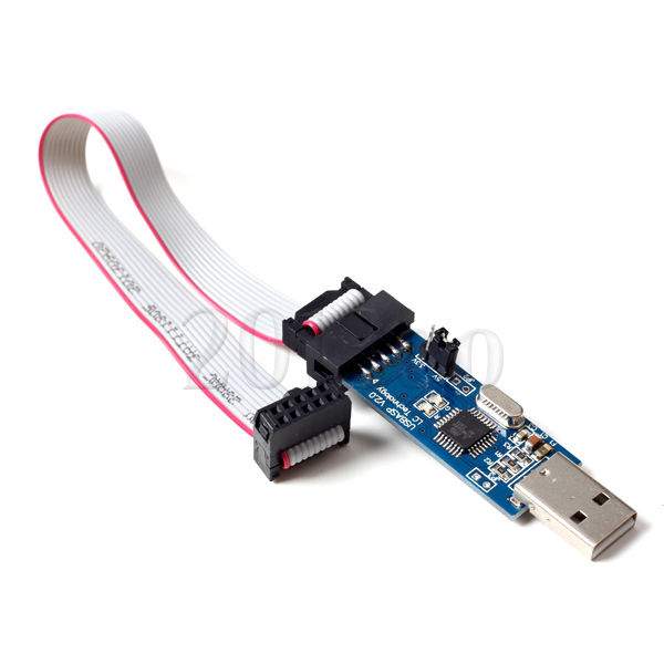

        • #94
          Originally posted by Waikiki_Sweep View Post
          I have used USB programmer for AVR. You can find it on eBay starting $3. Name is USBASP. http://www.ebay.com/sch/i.html?_nkw=USBASP
          Also there is a very simple software to use with it - Khazma AVR programmer. http://khazama.com/project/programmer/
          But please pay attention for fuses because for Khazma checked bits = 1 but on Chance website with Ponyprog screenshot it has checked bits = 0
          So INVERT ALL FUSE BITS or Ooooopppssss.... Atmega8 Bricked.....
          Also write codes first than fuses so if you mess up with fuses you will have at least codes ready to go.
          Usbasp works well with eXtreme Burner-AVR software. Find it here : http://www.fischl.de/usbasp/ . Works fine on Win7. Used it for programming open source stuff on a Turnigy 9x. Also reprogramming my generic Lipo charger. Theres an online fusebit calculator here : http://www.engbedded.com/fusecalc/ . Where you can double check before programming. Important for a nub like me.

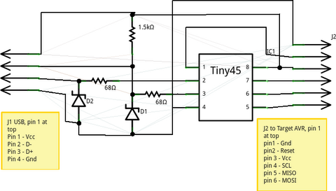

            Also if you like to save $3 you can build your own USB programmer for your AVR microcontrollers using cheap 8 pin Attiny 45 or 85: http://www.simpleavr.com/avr/vusbtiny

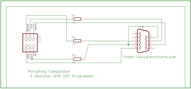

                If your computer in new probably you will see no serial port in it so you need to buy or build USB programmer.
                For older computers with serial port "3 RESISTORS" AVR programmer keeps a record of cheapest of the cheapest : http://www.electroons.com/electroons/programmers.html
