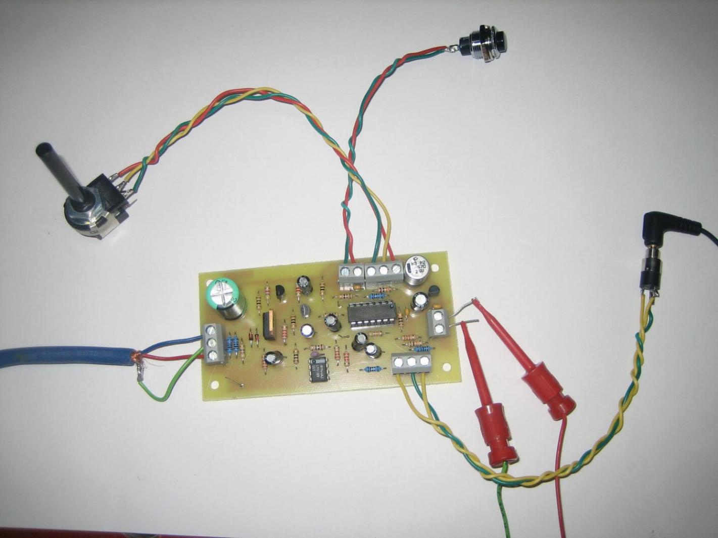

    Pickini V4 is the 4th evolution of the Pickini Pulse Induction detector based on pulse width measurement aka temporal sampling.

    That is why I decided to redesign the V3 completely, including an automated setup for both the DC level of the amplified flyback pulse and the DC slicing level of the internal comparator.
    This requires 2 adjustable voltages: one is the DAC output of the PIC controller and the other is a filtered PWM output with high resolution.

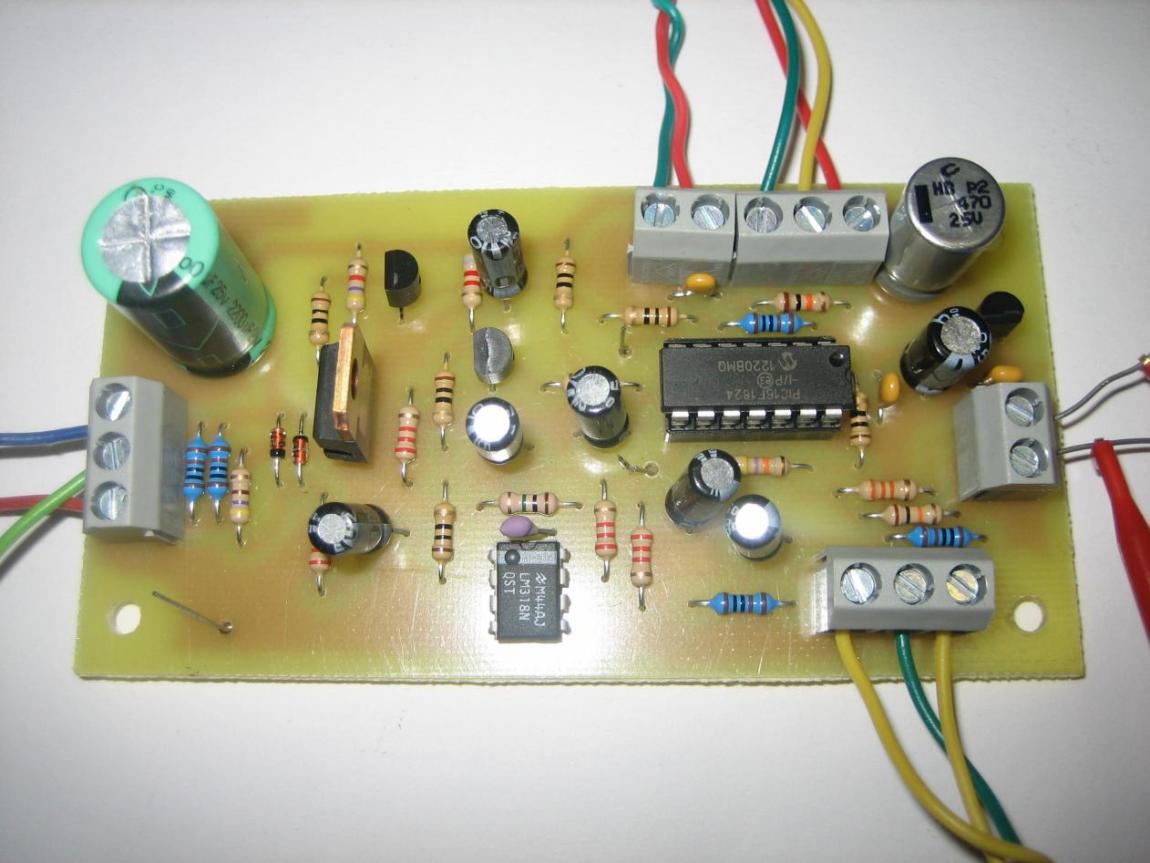

    The PCB size is about the same size of Pickini V1/2.

    I have so far built 2 complete detectors based on V4, field tested them for over a year now and I am quite pleased with them.
    Take the detector outside, hold the coil in the air - away from noise, switch it on and wait for about 20s for the calibration to finish.
    After that, you should have a very sensitive PI detector.
    Enjoy,
    - Bernard

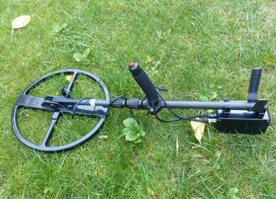

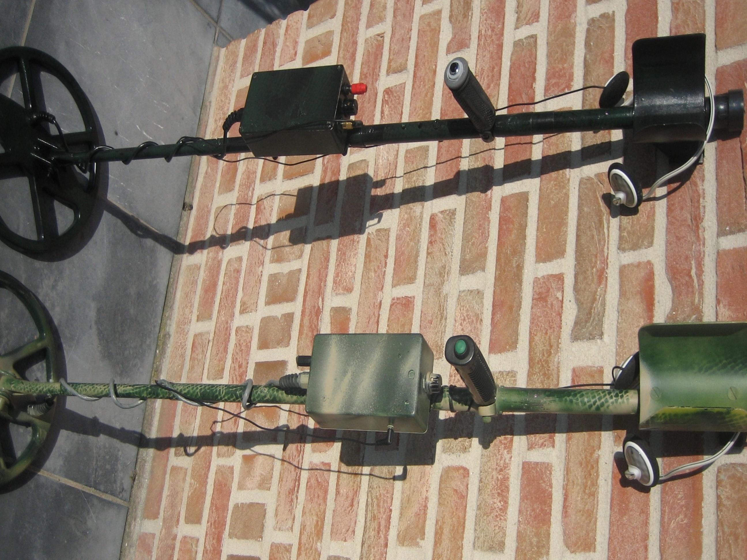

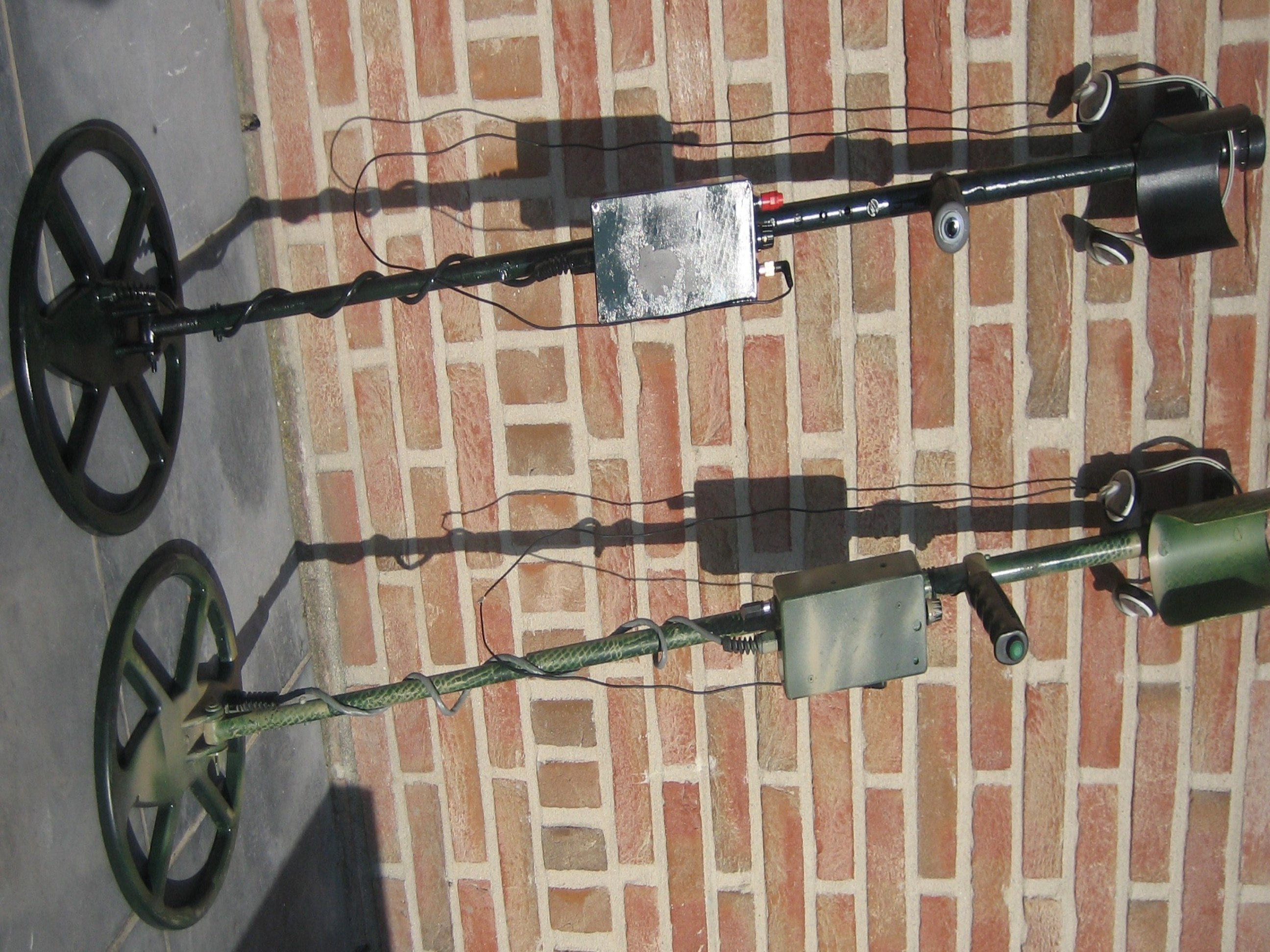

              Pictures of the 2 Pickini v4 builds I tested throughout last winter up to now:

              The pushbutton for pinpointing is located at the top of the handle.
              The coil shells are intended for an induction balanced coil. Here I use a monoloop coil in the outer circle.
              Batteries = 3X LiIon 16350 3.7V are in series - placed inside the upper part of the aluminum stem ( from cheap walking stick ).
              Have fun,
              - Bernard

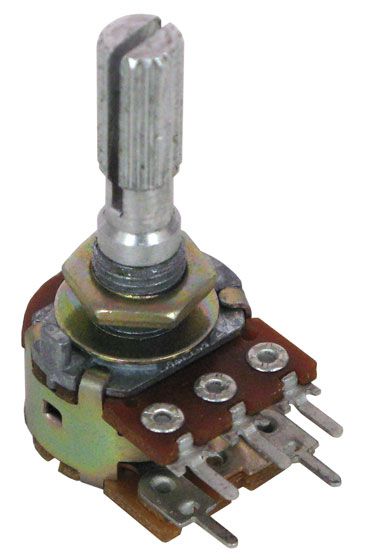

                I cant sée the sensitivity potmeter value .is it the same than v2,v3?

                  Hi Nick,
                  Yes, the sensitivity potmeter is needed to supply a DC voltage 0...5V at the sensitivity ADC input.
                  I use a 4K7 linear potmeter combined with on/off switch.
                  Enjoy,
                  - Bernard
                    Potmeter with on/off switch
                    Sensitivity: 0... 5 V -> 4K7 linear potmeter.
                    Optional: on/off switch:
                      Sensitivity potmeter connection:

                          Thanks for sharing, its look easy, what tools do i need to build this one? Never do pic before.
                            You obviously need the PIC component - 16F1824 - and then something to program it with the hex file.
                            I use a PICKit3 USB programmer.
                            If you don't want to purchase a programmer for just 1 project, you could ask your local component dealer ( where you buy the components ) if he can program the PIC for you.
                            Best regards,
                            - Bernard
