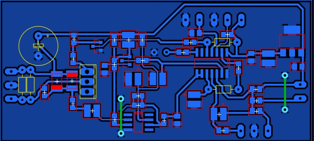

      i ve just finished to draw pickini v4 in smd just for fun if someone want to try it in smd????
      at first sight there s no error but BEWARE!!!!! i made it speedly so!!!!!!!
      i think it maybe be smallest then that
      note: 2 shunts for ground
      have nice day ,here orange wather alert and rainny day
      • Hello Nick,
        crazy thing, really small
              thanks all

                  • @ Nick : nice work , now wait for someone to build it
                    @Qiaozhi: thank you for the link - so there is no native linux version.
                    @Arionas: thanks for showing it.
                    The wire jumper on the left - near the power connector seems to connect 2 ground planes that are already connected ?

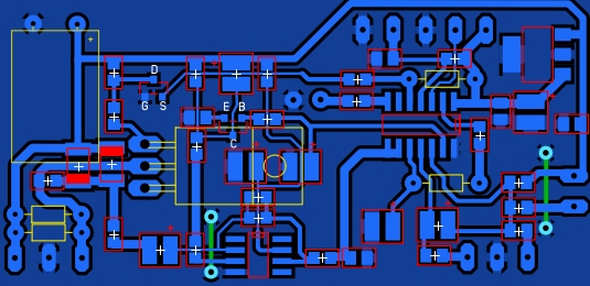

                    • v2 of the pickini v4 smd pcb with corrections
                      hi bernard
                      hi all
                      here is the corrected pcb (i say it wasn t error free!!!) and i find some
                      so i corrected all i saw ,the wrong smd transistor pinout ,some track was a little thick,and i made it a little bit smallest 68X33 mm
                      if someone are interested and see other tell it and i ll correct it
                      thanks

                      • Nice work, Nick
                        How do you plan to program the SMD PIC ?
                        Pre-program it and solder it on the board ? -> impossible to update it afterwards.
                        You could also stuff a small connector to the programming pins so that it can be updated in the field ?
                        Not that any updates are needed of course...
                        With my prototypes, I like to update a lot to try out different things. In that case, an onboard programming connector would be the only solution.
                        • Hello Nick can you name all parts according to shematic? IC1 ,IC2 R1......
                          just to be sure if we get Problems that we discuss over same partnumbers
                          i am sure i make this smd pcb this Weekend, nice dimensions
                          and for professionell production you can Switch all holes to trough hole plating
                          there is no additionel Charge at most producers
                          • hi all
                            hi bernard
                            hi bernt
                            i made some little changes,named components (2k2,1k,4p7) add a pickit connector that can be made by shunt (so you have to delete tracks before) or by double sided pcb,i saw too i ve forgotten the 470µf capacitor near 7805 ( couldn't it be really forgotten ,is it really necessary???),i named output (threshold,pinpoint etc..)
                            bernt beware!!!! i m not sure of the electrolytic capacitor and resistor footprint check them before etching (at first it was just for fun for me!!) i have not the habit with smd component
                            for better understanding about the pcb look this with photo vue tool
                            thanks all
                            i m waiting for your reply
                            • i saw too i ve forgotten the 470µf capacitor near 7805 ( couldn't it be really forgotten ,is it really necessary???)
                              According to the datasheet - http://www.ti.com/lit/ds/symlink/lm78l05.pdf you need 330 µF at the input.
                              There is already the 2200µF directly on the battery input, but not located closely to the 5V regulator.
                              I assume you could safely omit the 470µF or replace it with some SMD smaller capacitor ( 1 - 10 µF )
