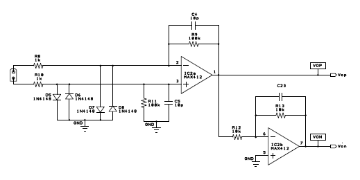

      Hello Bernard,
      What is your opinion on using (temporal sampling) the Microchip(specifically the PIC18F16Q41​) with a bi-polar (H-drive)TX and this RX front end:
      ​​​​​ Click image for larger version  Name:	RX front end.png Views:	0 Size:	14.3 KB ID:	453370
      A microcontroller's internal hardware comparators can only handle positive voltages relative to common ground (0V to (VDD). we will now tap into both internal comparators simultaneously (Comparator 1 for VOP and Comparator 2 for VON) to process the dual-polarity decay tails natively​. Maybe more can be done with this in the software.
      1. During a Positive Pulse Cycle: The coil discharges a standard positive flyback decay tail. Your differential receiver stage processes this, and the signal appears as a positive-going voltage decay curve on the VOP line.
      2. During a Negative Pulse Cycle: The coil collapses in the opposite polarity, creating a negative-going flyback tail. Instead of forcing the microchip to read a negative voltage, your inverter/differential amplifier stage flips this inverted signal upside down, outputting it as a clean, positive-going decay tail on the VON line.
      Also to implement some sort of automatic GEB. Or ground substraction.

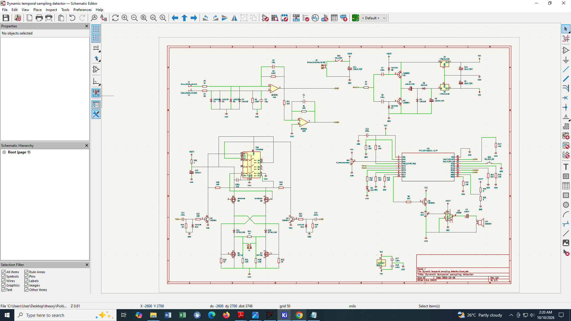

                I did a basic schematic, most of which is taken from well known Bi-Polar PI scheme. This is just for the concept (the schematic is not complete, and is missing some important parts). The initial firmware will be simple just to see if the darn thing will work at all. It belongs in a different thread though.
                Click image for larger version  Name:	dynamic temporal sampling detector.png Views:	0 Size:	166.9 KB ID:	453452
                Thanks.

                    Click image for larger version  Name:	schematic.png Views:	0 Size:	54.1 KB ID:	453472
                    [ATTACH]n453473[/ATTACH]
                    • dbanner
                      Is the polarity of D1/D2 correct ?
                      Q5 gate connection ?
                      Are C13 / C14 needed when TXP and TXN are direct PIC outputs ? and D12 / D13 ?
                      One issue I had with the PIC16F1824 was the pullup resistor at the MCLR pin - pin 4.
                      Together with the pullup I had to add a 100nF to ground.
                      Everything was fine on the test bench, but during field tests the controller would reset when I touched the coil to wet ground/grass. The extra 100nF to ground took care of this issue.
                      No idea if this is also a problem with this newer PIC.
                      Note that you can use pin4 as the pushbutton input. The 100 nF to ground has an extra advantage in taking care of debouncing.
                      Many free pins - maybe add a LED array ?
                      I also did some tests with a 128x64 OLED display connected via I2C to the PIC.
                      A nice feature, but slow - screen update - compared to a direct LED array or parallel character display.
                      And I also had only 2 limited character sets onboard the 16F1824 due to the program memory limitations.
                      Looking forward to see the first results f

                        • In a time-domain pulse induction metal detector, the DAC's job is to generate the precise slicing level reference voltage. This reference voltage acts as a razor-thin tripwire line just above the noise floor. When the high-voltage coil flyback pulse decays and drops below this exact DAC voltage level, the internal comparator trips, allowing the timer to calculate the target pulse width (dt). Here is my understanding of how the code will work: to generate the slicing level:
                          Remember I am using a bi-polar TX drive​
                          DAC Bit Depth: 8-Bit Dual Cores (Precision 256 Steps)(PIC18F16Q41)
                          DAC1 directly to the internal positive input of Comparator 1
                          DAC2 directly to the internal positive input of Comparator 2
                          The slicing voltage stays completely inside the chip. Resolution is 19.53mV per step(5V)
                          The 12-bit ADC fires a rapid, hardware-averaged 16-sample burst reading across the VOP and VON signal paths. This lets the firmware know exactly where the analog baseline is resting during the "quiet" period after the coil flyback and all target eddy currents have decayed completely to zero.
                          Next, the firmware reads the voltage coming from the 10kΩ linear sensitivity potentiometer via the ADC. If the user turns the knob all the way up, it means they want maximum depth, so the slicing level needs to sit as close to the baseline as possible.
                          Now, the code combines these two real-time values:
                          DAC1 slicing level (VOP) = VOP baseline + sensitivity offset
                          DAC2 slicing level (VON) = VON baseline + sensitivity offset
                          VOP slicing level:
                          Real-Time 12-Bit ADC Baseline Capture
                          Math Equation: Baseline + Sensitivity Offset
                          Write Number directly to Register: DAC1CON
                          Internal Silicon Core routes slicing level tripwire to Comparator 1
                          repeat for VON
                          Because this entire calculation and register update takes less than a single microsecond, the firmware does it seamlessly once per pulse cycle (up to 1,000 times a second). If a wave sweeps over the sand or the battery supply dips, the baseline shifts, the ADC catches it instantly, and the DAC dynamically recalculates the new slicing height for the very next pulse. There are absolutely no voltage jumps across external capacitors, meaning zero blind settlement delays and perfect real-time drift immunity!
                          At least in theory!
                          Click image for larger version  Name:	RX front end.png Views:	0 Size:	14.3 KB ID:	453489
                          TRANSMIT CYCLE - NET VOLTAGE AT MCU - ACTIVE INTERNAL COMPARATOR
                          Cycle A (Positive) - VOP is POSITIVE (>0V) - COMPARATOR 1 processes VOP.
                          VON is Negative (<0V) - (Comparator 2 ignores the clipped VON line).
                          Cycle B (Negative) - VOP is Negative (<0V) - (Comparator 1 ignores the clipped VOP line).
                          VON is POSITIVE (>0V) - COMPARATOR 2 processes VON.
                          Also, to run a proper subtractive ground balance loop, the firmware must capture the decay time width (dt) at two distinct signal heights within the exact same pulse window: an Early Sample (t₁) and a Late Sample (t₂)
                          Because the PIC18F16Q41 features twin peripheral sets, the software configures them to act as two independent stopwatches running in parallel.
