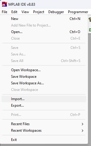

                  • Can you help me please as I am in new territory. I have the V4.2 source file and hex file here at PICKINI PI Detector but they both appear to be text files. How do I get them from the web site and convert them into something my Picket3 can use? Alternatively, if anyone already has these files in a useable format, would you mind sharing?​
                    • Simply with copy and past into a texteditor
                      • MartinB
                        The file format is Intel Hex. This is indeed a text file that can be interterpreted by a programmer that supports this format.
                        Pickit3 can import this file -- eg via MPLab. I still use a very old version in combination with PicKit3.
                        In MPLab: File -> Import -> select the Pickini hex file.

                        • Hi F117 and GeoMax,
                          Thank you both for your assistance. I was really overthinking what turned out to be a very simple process.
