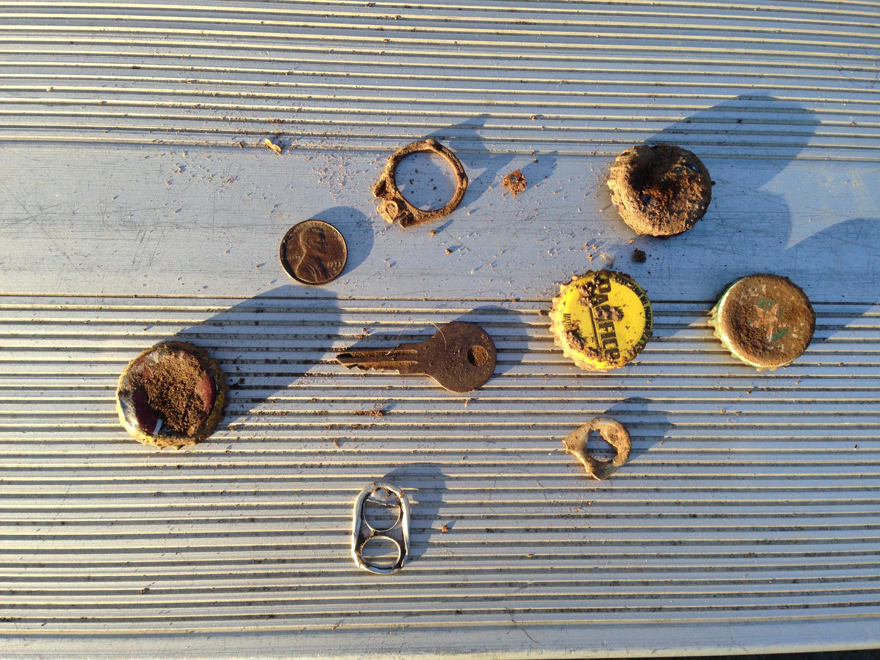

                • Short video of detecting with Pickini 4
                  I went to the park today with my Pickini 4 and spent a short time detecting and digging. My wife made a video of my first find:
                  Here is a photo of the loot I located in about 30 minutes:
                  Nothing very exciting in my finds but I'm very happy with how the detector works and the pinpoint feature is especially helpful.
                  I'm hoping to make it to a more exciting location in the near future.
                  • Nice video . Thanks for sharing it !
                    Even when no treasures are found, at least you get some exercise and fresh air.
                    These are also the typical finds here on the beach. Pickini v4 finds our iron euro-cent coins very attractive...
                    Well, you dug the trash and found some cash, what more can you expect in the park ?
                    Nice move with the pinpoint pushbutton an a very professional looking build
                    Best regards,
                    - Bernard

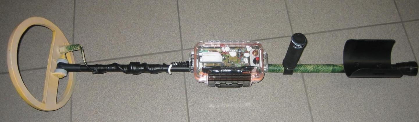

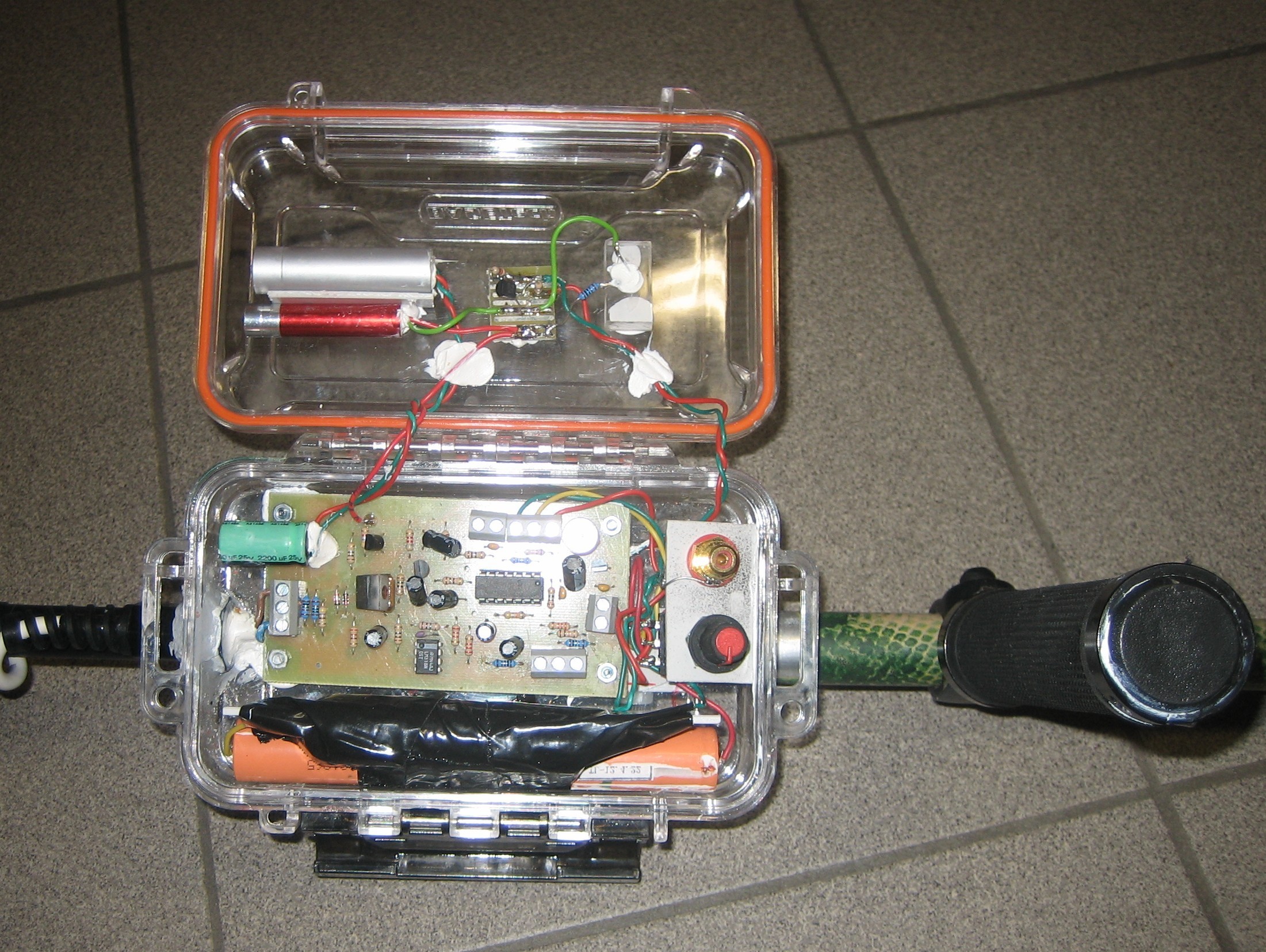

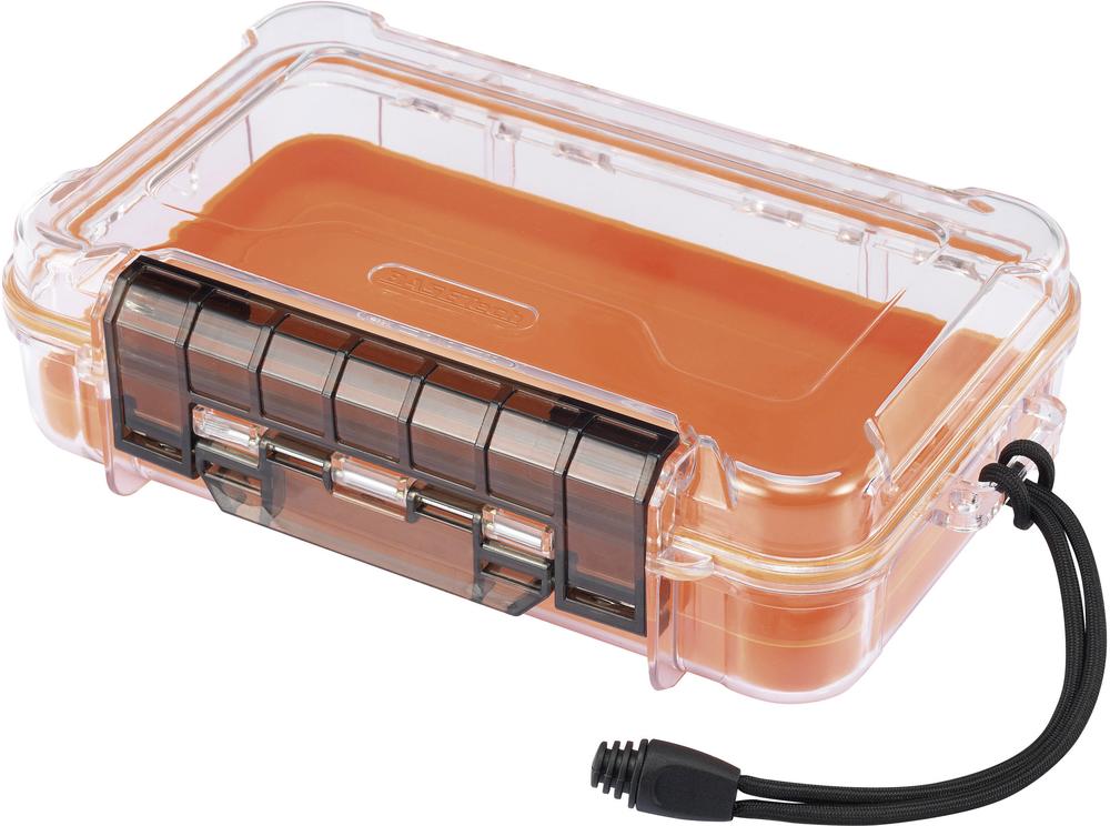

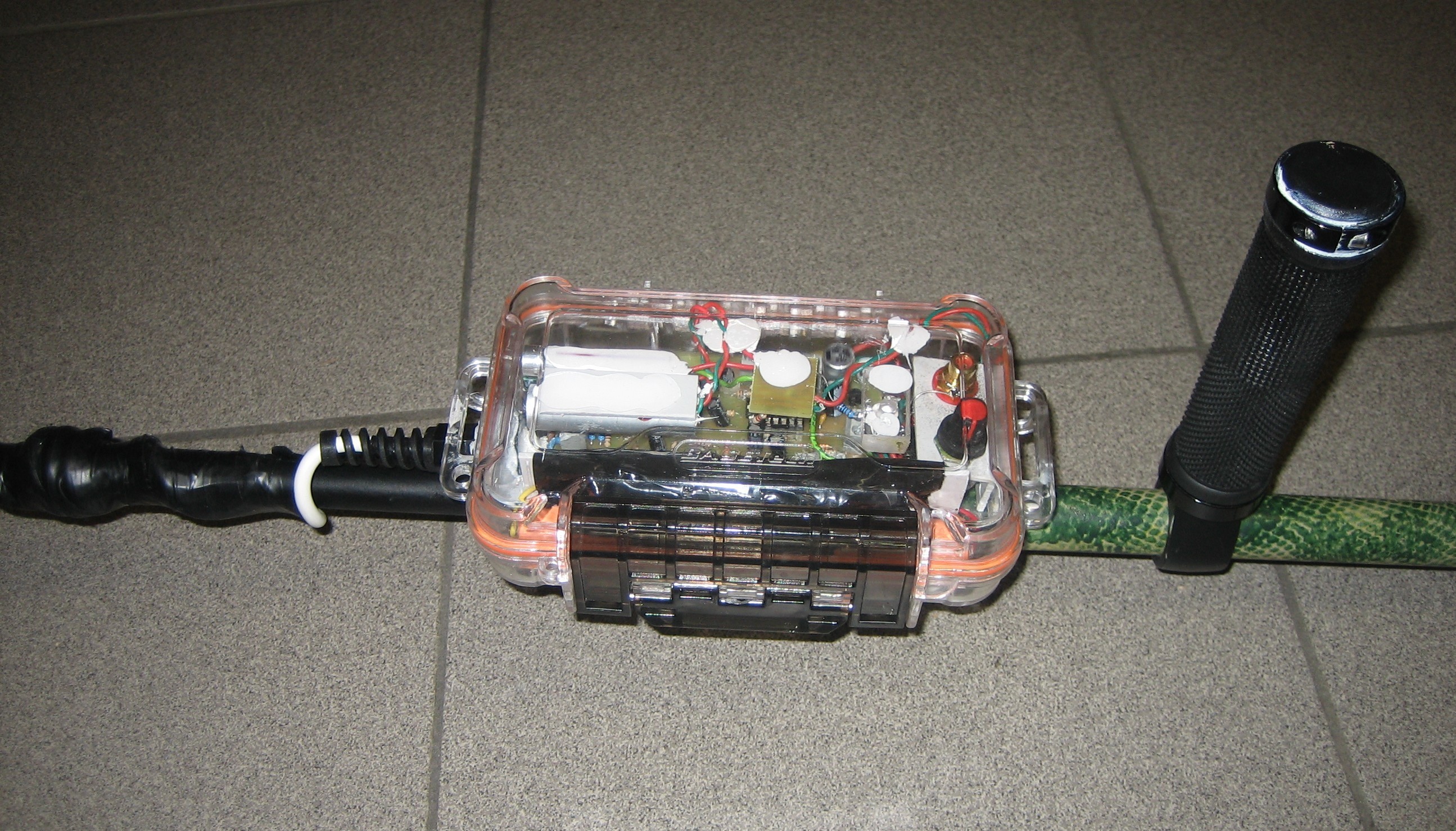

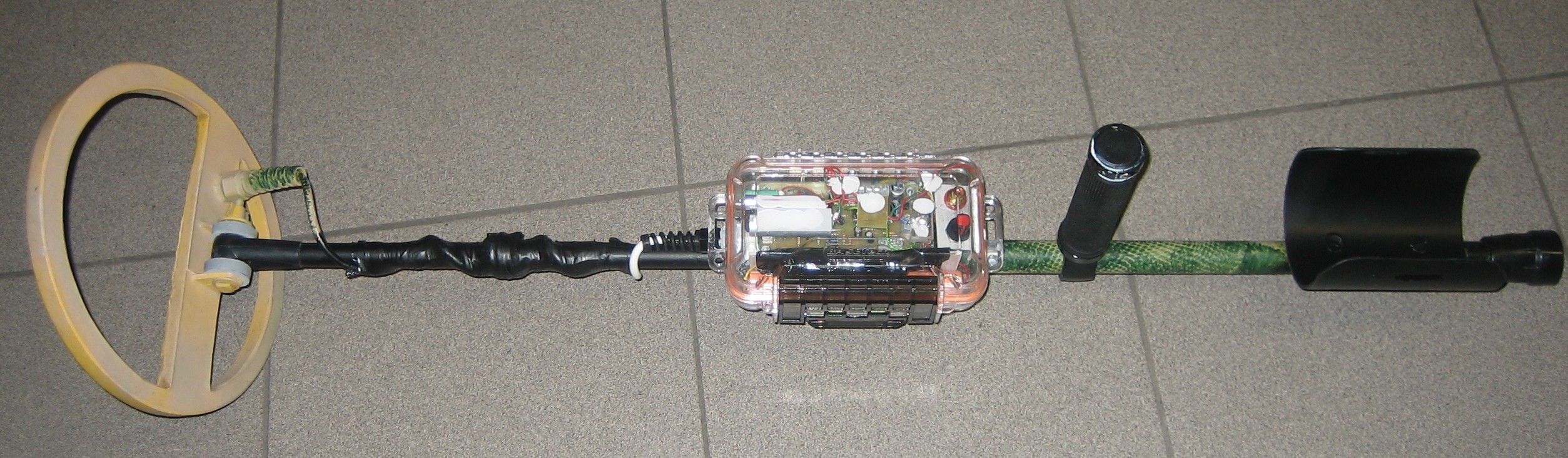

                              • Here are some pictures of my Pickini V4 dive detector.
                                The housing is this one: Basetech 1310189
                                There is only one hole - for the coil cable.
                                You have to open the box to access the on/off / sensitivity potmeter and the cinch battery charger connector.
                                The stem is also shortened to a little more than 1m. Coil is 20 cm.
                                Pin7 of the microcontroller is connected to the breadboard glued in the cover, with 1 transistor that switches on a bright red flashlight pointing to the coil + a hi-bright red LED inside the transparent housing.
                                Next to the red flashlight, there is a white LED flashlight that is continuously on.
                                I will still add a loud buzzer for extra detection indication. All driven by the same BC549 transistor connected to pin 7.
                                Some pictures:
