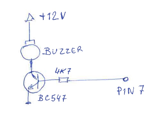

    you can connect a LED directly to pin 7 of the controller. This was added as described in post #291.
    This is a simple on/off detection indicator. You can attach an extra transistor here to drive more powerful LEDs - or a powerful buzzer ( to be heard underwater, even without headphones . When you attach the buzzer to the housing, the noise can be heard underwater).
    A single hi-bright LED can be connected directly to the pin via a 470E resistor.
    - Bernard

    I would appreciate if you could provide further details on this - ie driver transistor circuit and piezo buzzer type.
    I am in the process of modifying my snorkelling Pickini to add audio as I am finding the LED on the housing difficult to watch as well as swinging the coil underwater.

    • Pin 7 of the PIC is a static detection pin: high (5V) = target / low (0V) = no target.
      You can attach a buzzer/beeper with an extra transistor to the 12 V rail or in an identical way to the 5V rail.
      The NPN transistor is not critical.
      The resistor value can be 2K2 ... 10K (or more).
      Something like this:
      I connected a beeper once like this inside the housing for a dive version.
      But when testing it in the 15 m dive tank, it kept beeping from the surface to the bottom because the tank itself is made of steel.
      This was so annoying for other divers in the tank - it was really loud ! - that I removed it again and replaced with a cheap but bright flashlight that is pointed towards the coil through the transparent housing.
      It lights up when a target is detected. Connected in the same way as attached image.

      • Thanks for the info Bernard.
        The circuit diagram is just what I needed - When I get the piezo buzzers I ordered I will check their current draw and find a suitable transistor to handle it.

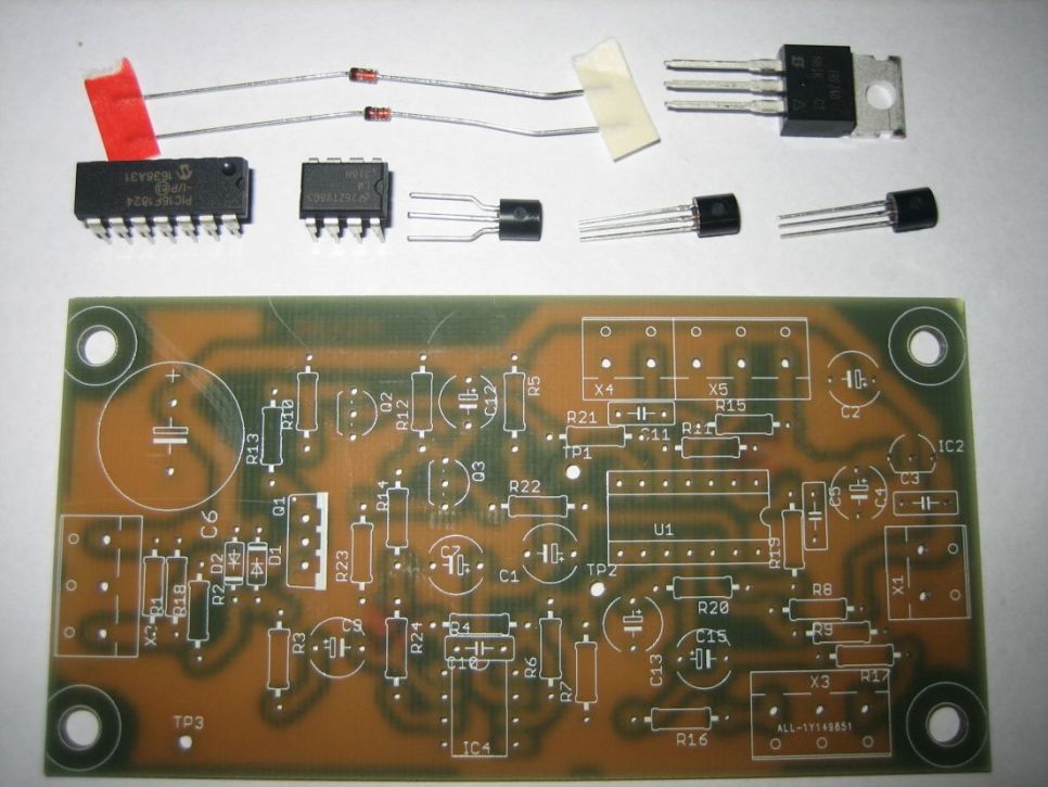

            • PICKINI V4 SHOP
              You can now buy 2 items in the Pickini shop:
              A programmed microcontroller:
              A semi-kit consisting of PCB + all semiconductors, including the programmed microcontroller
              This way, the microcontroller should be available to everyone.
              - Bernard
