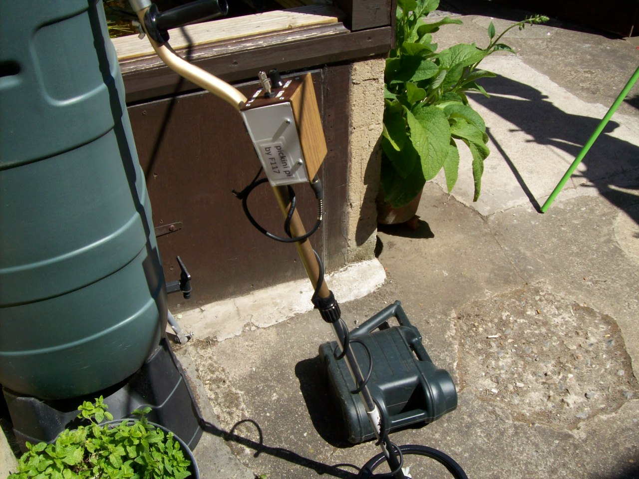

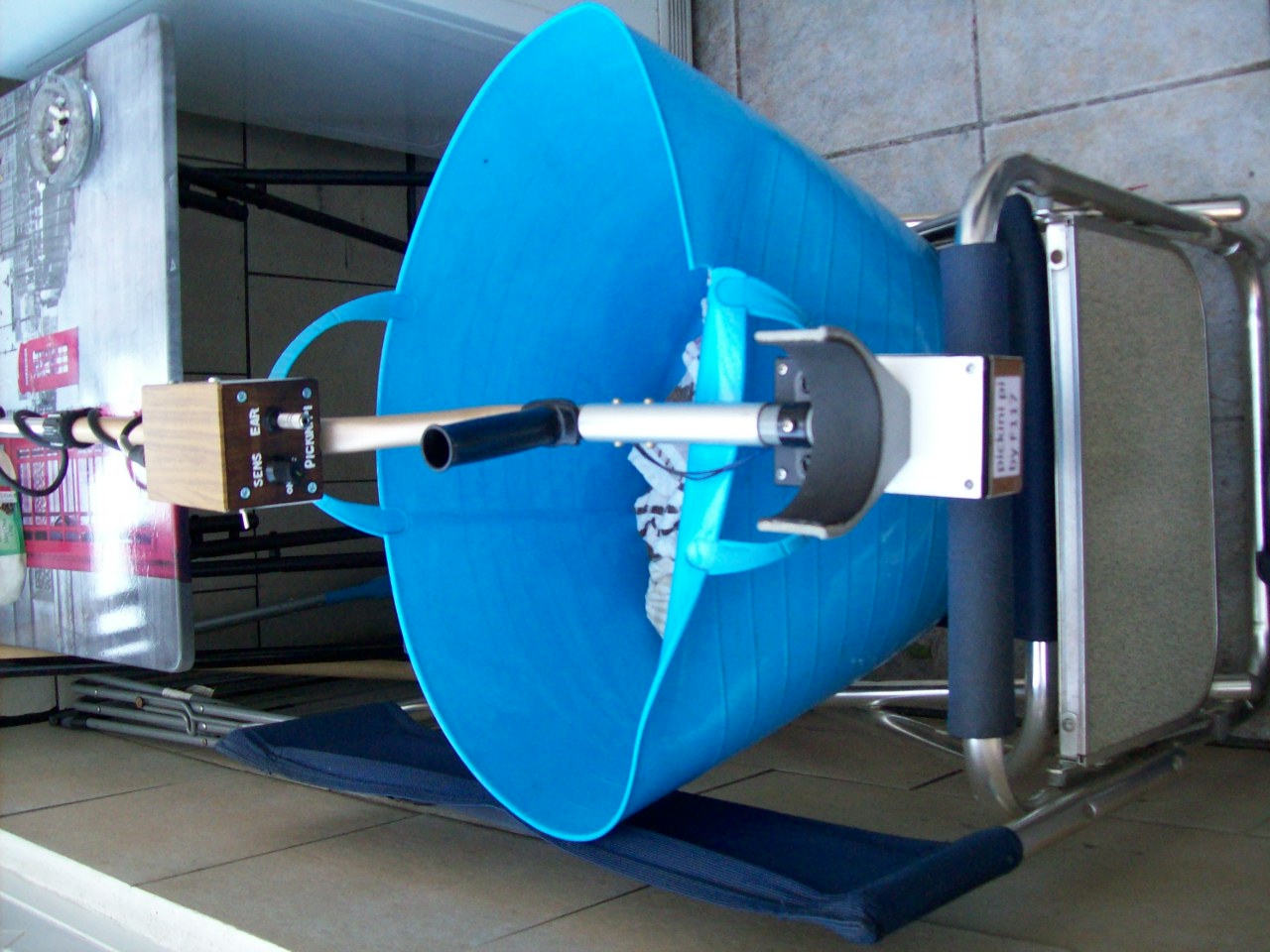

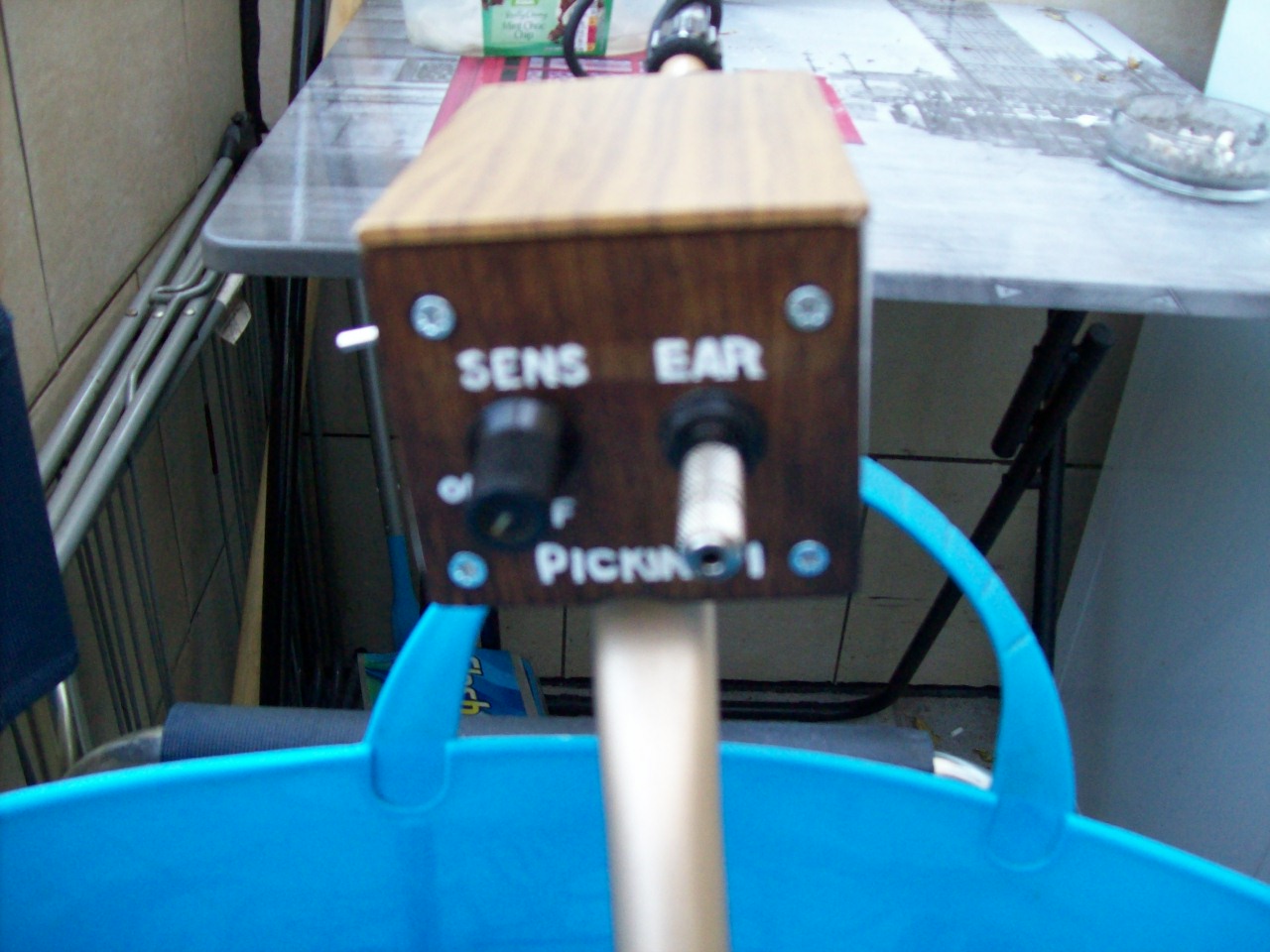

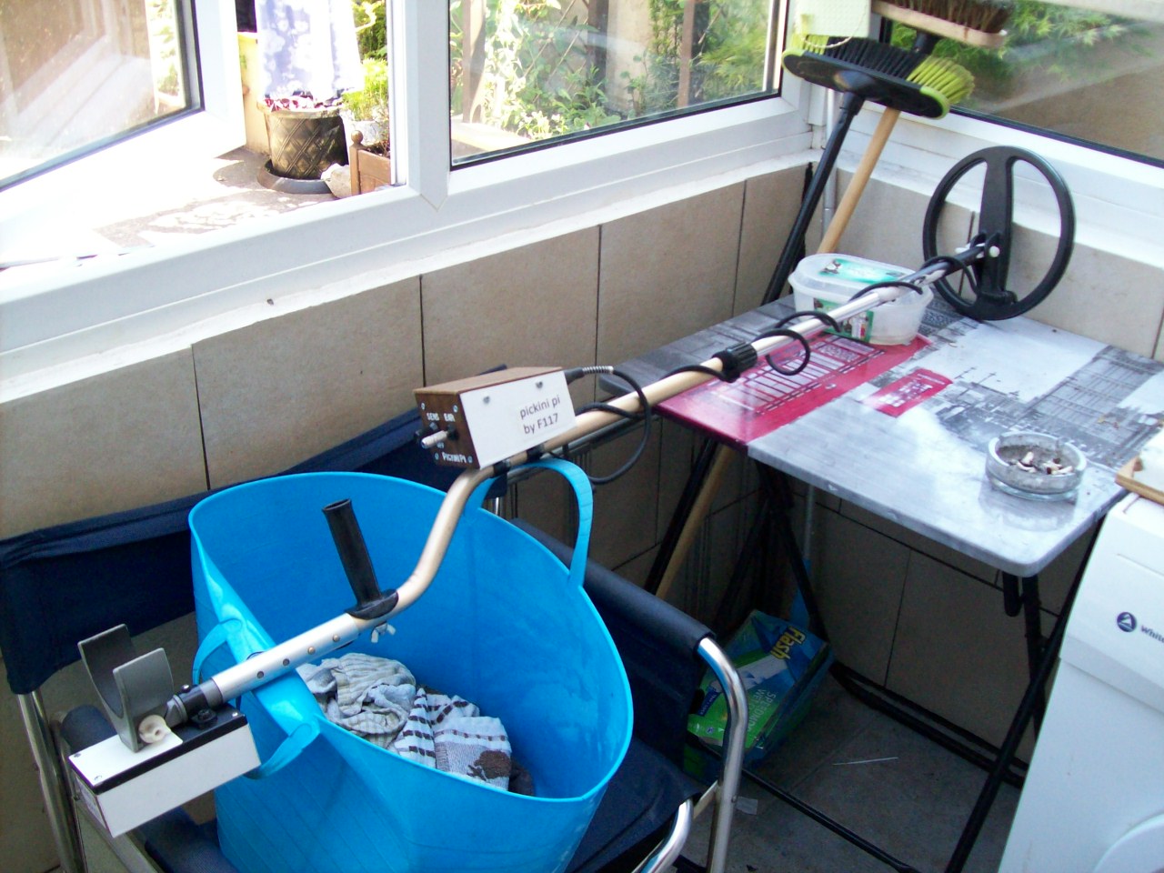

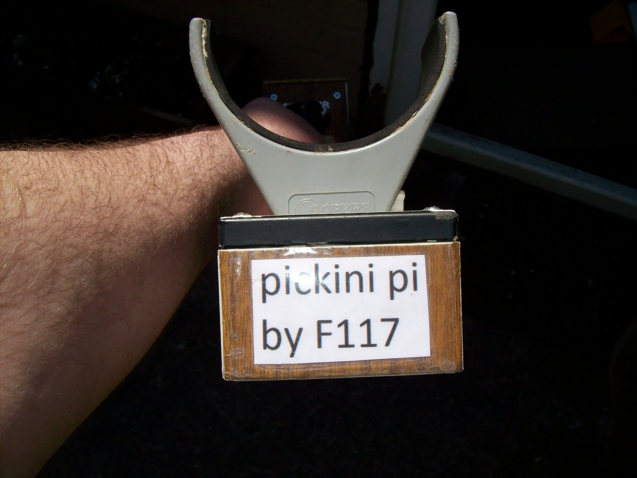

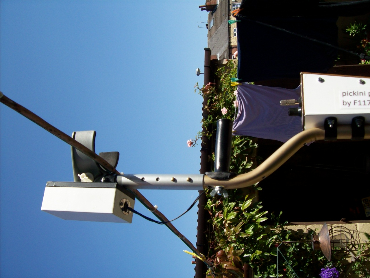

                      • hi bernard, and all, i finally finished my pickini i have been going through my projects finishing them up,
ID:	357827 Click image for larger version
ID:	357828 Click image for larger version
ID:	357829 Click image for larger version
ID:	357830 Click image for larger version
ID:	357831 Click image for larger version
                        so i got there in the end, thanks to bernard, and bruce(6666), for the chips both work great, and thanks to kosacid for the boards.
                        p.s. please ignore the pic below of the grubby mainboard i got in for repair the image made it into the upload by mistake i tried to remove it but it put it beneath.
                        thanks
                        aly.
