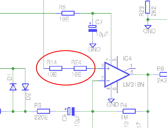

                        • Hello dear F117! I read the whole topic, but did not find the information. My question is --- why is this done? Thanks!
Name:	2020-01-10 00 10 15.jpg
                          • Originally posted by SWL View Post
                            [ATTACH]49112[/ATTACH]
                            Common method when one does not have the R values needed or wished to reduce the number of different values.
                            In this case wanted 20 Ohms but only had 10 Ohm resistor. So simply put two in series.
                            • I realized ... I thought it was a special trick in the scheme)))

                                @FSB
                                I also puzzled over this but came to the conclusion that the extra resistor was used as a jumper for the single sided board layout. There is also a similar arrangement with R14 and R24 going to pin 3 of the opamp.
