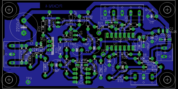

                  • Originally posted by kosacid View Post
                    [ATTACH]44252[/ATTACH]
                    back to building giving the drones a break just need the programmer now
                    Could you please post a copy of the files you sent to have your boards made?
                    • @ Goaty:
                      These are my gerber files:
                      http://users.telenet.be/willaert/MD/.../V4/gerber.zip

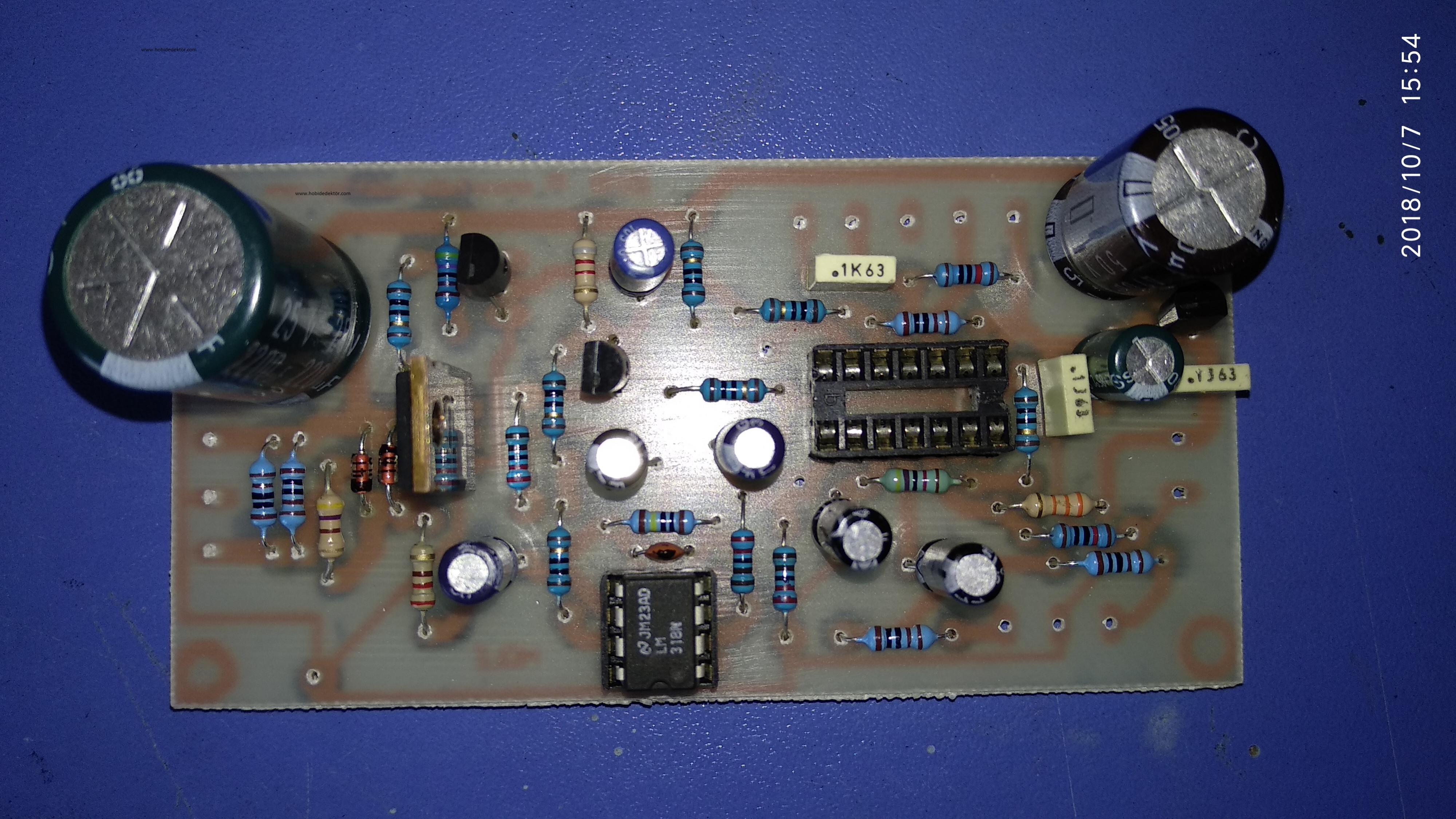

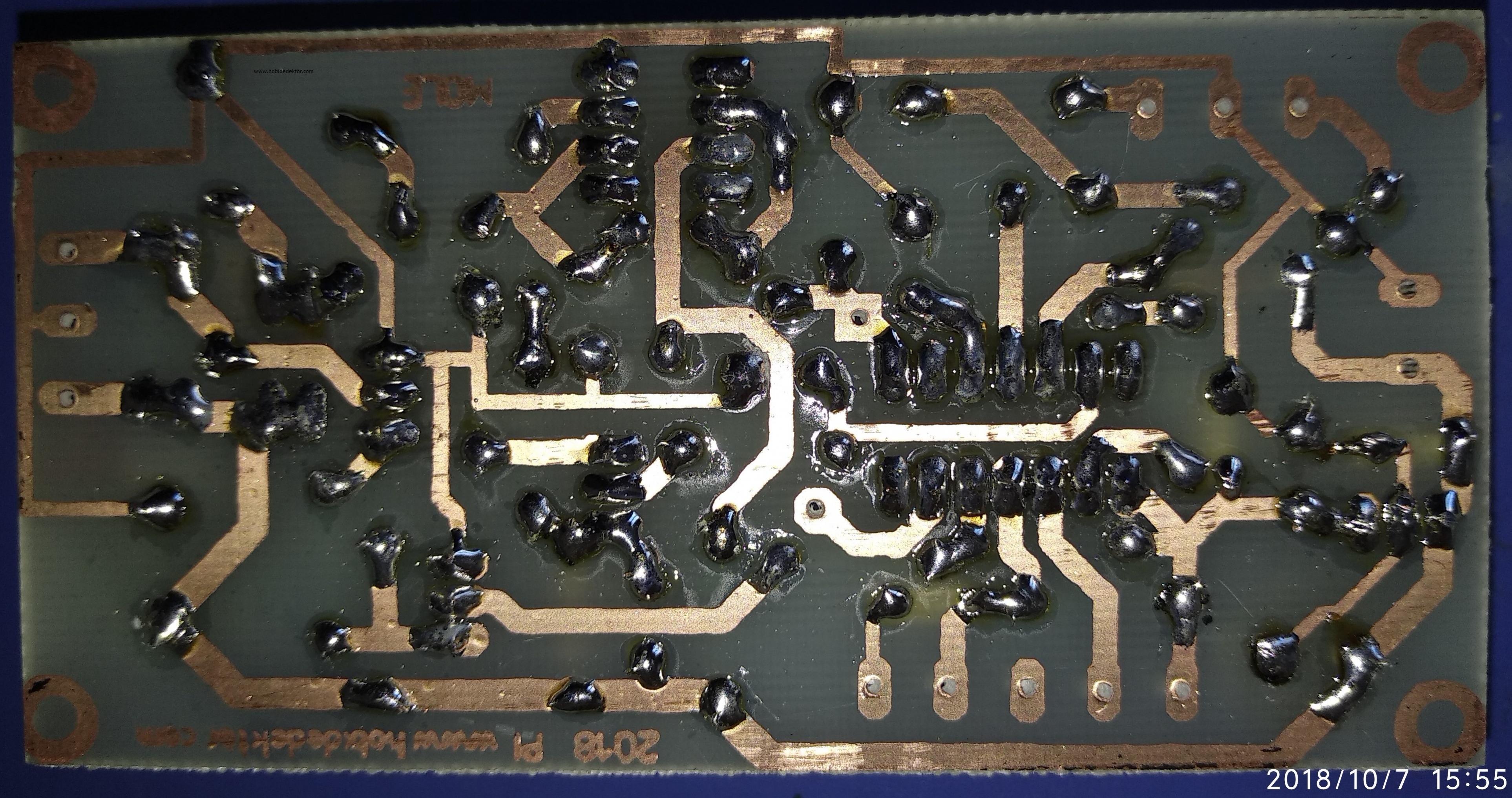

ID:	352299Click image for larger version
                          • @gurdal:
                            The LM318 is upside down.
                            Have a look at the pictures here:
                            http://users.telenet.be/willaert/MD/...ectronics.html
                            Also: pin 8 and 9 of the PCI16F1824 must be shorted !
                            There were some layouts around that had both these mistakes.
                            Therefore: please look at my homepage for reference.
