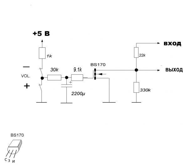

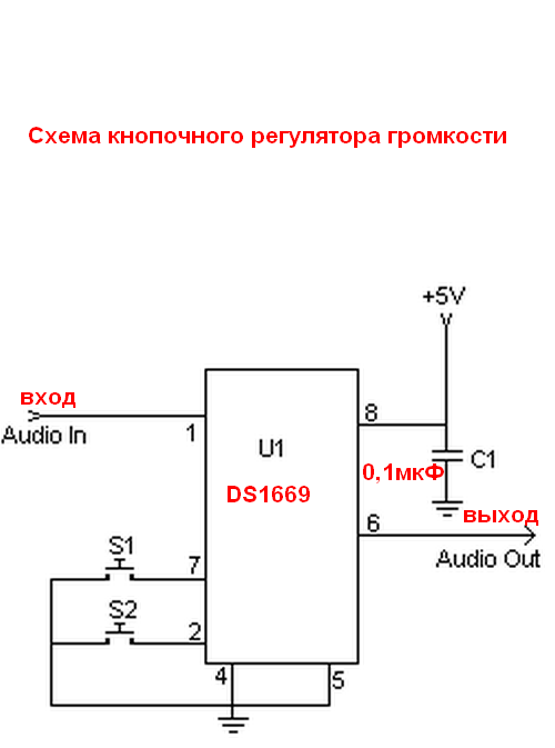

                      • I think that this option of the button regulator can be used instead of a potentiometer. without any unnecessary controllers and chips. although the controller would take up less space 10 times. you need to try everything.
Name:	++????? ?????????? ?????????? ?????????.png
ID:	350081Click image for larger version
                        or Digital potentiometer X9C103S or ds1669

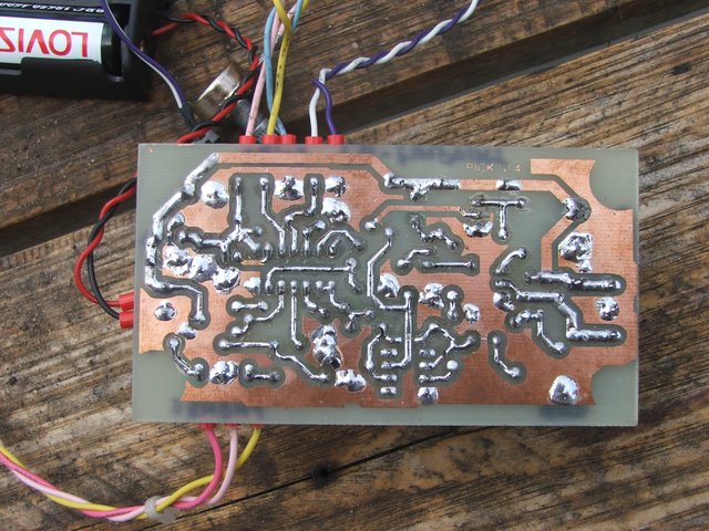

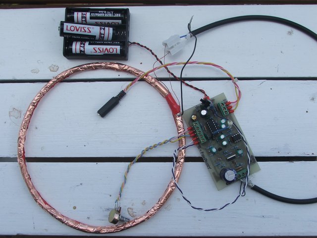

                        • I have just got my Pickini up and running (bare bones only - no case yet) and would like to thank Bernard for the work he has done in designing a great little detector project.
                          In-air tests so far indicate that the depth is good and should be more than adequate for my intended use as a fully waterproof snorkelling detector - the case is a work in progress at the moment.
                          The PC board was homemade using uv dry transfer film and etched with ferric chloride. It turned out pretty well considering I guessed the exposure time using very diffused sunlight and a paper laser print sprayed with coconut oil to make it translucent. Drilling the holes was, as usual, a PITA!!

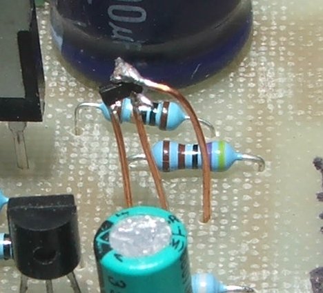

                          The board was populated with a mixture of second-hand capacitors and most of the other components from China which were nearly all checked with a component tester before use - I'm still waiting for the BS170 to come but ended up using a salvaged surface mount version (marked as 702) with 'spider legs' attached. It looks odd but seems to work OK! Also, I used a 2N2222 in place of the BC549
                          Programming the PIC was rather stressful as I had not used the Pickit3 very much, and not for some years, but thanks to all the info here on the forum it was successful first try!
                          The coil is made from enamelled copper wire (recovered from a microwave oven transformer) wound around a flower pot as the former then wrapped with nylon fishing line, paper masking tape, packaging foam strips, pvc electrical tape then copper foil tape as a shield.
                          When first tested the detection distance was woeful until I discovered I had used a 1k resistor instead of a 1m across the LM318 (DUUUH!)
                          Anyway, I am more than happy with the whole thing.
                          Thanks again Bernard!
                          • Sounds great. Any pictures?
                            Like to see DIY with available materials.
                            • "Sounds great. Any pictures?"
                              • Is that a surface mount transistor I see? That's hilarious. Nice job!
