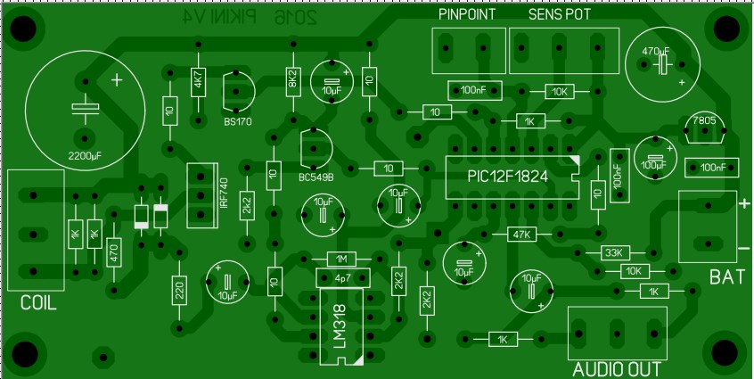

        On the audio, the board has 3 holes (pins for attaching), center one is ground, outer holes go to 1k resistors. How or which way is this connected up, I assume it is for headphone/speaker setup or am I missing something?
        speaker only have 2 wires and same for the headphone plug, so am guessing it is designed to attach speaker to one side and headphone to the other with the middle pin being the common ground for both?
        Any help with that is much appreciated

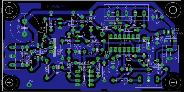

        Originally posted by F117 View Post
        @ geoscash1
        The polarity of the 2 elco's indicated is wrong on your PCB -- as correctly indicated by Arionas.
        Holy crap, that's how they are placed according to the image I downloaded... shoot, I hope those are the only 2 mistakes...
        This is the one I went by since it said V4

        • The LM318 is also upside down..
          This looks like the very first version that Arionas made. There were several improvements since his first post.
          I sometimes wonder why I went through all the trouble of providing a simple, fool-proof design, when the first thing that people do is make their own version of it and then complain it doesn't work.
          Please have a look at the original documentation:

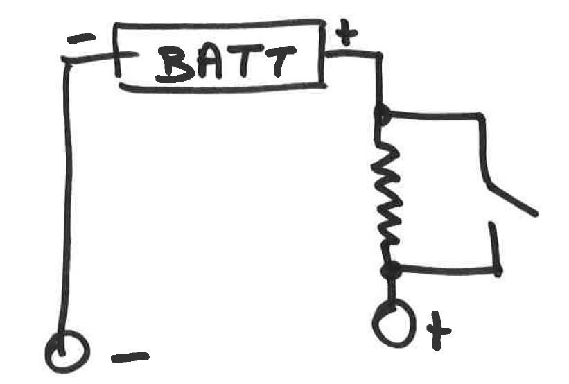

              • I still unable to use lion battery with charger + stepup module, the md is only turn on for half second and off immediately, i should repeat it on and off again to get it work, I think the modules find a tiny short or something and turn off automatically to avoid more damage. Any one have idea to fix this? Btw I use it on barracuda and working normal.
                • Maybe the rush-in current on the 2 elcos on the 12V = 2200 microfarad + 470 microfarad is too large ?
                  Put an NTC thermistor in series ?
                  • I've had this issue with too high capacitance and step up module, as Bernard says it's due to too high capacitance. A quick fix would be adding 10R / 2W resistor after the battery and switch parallel to the resistor.
                    You will then switch on the device as regular, then switch on the new switch (which will short out the resistor). A long term solution would be adding 10R-20R NTC as suggested.
                    XL6009 datasheet suggests soft-start function but I don't think it has one, or it's not functioning properly.

                      • The implementation of a fixed resistor with a switch in parallel is easiest to implement.
                        Making the right choice for an NTC is probably more difficult.
                        Both methods - fixed resistor and NTC - are explained on wikipedia:

                          Like this?
                          • No, like this:
                            Set the switch over the resistor open.
                            Close the normal power switch.
                            Inrush current will be limited by the series resistor.
                            Wait for 3 seconds.
                            Then close the switch over the resistor.

                              • Originally posted by F117 View Post
                                No, like this:
                                [ATTACH]37886[/ATTACH]
                                Wait for 3 seconds.
                                Thanks for the knowledge mr.Bernard, eclipse...
