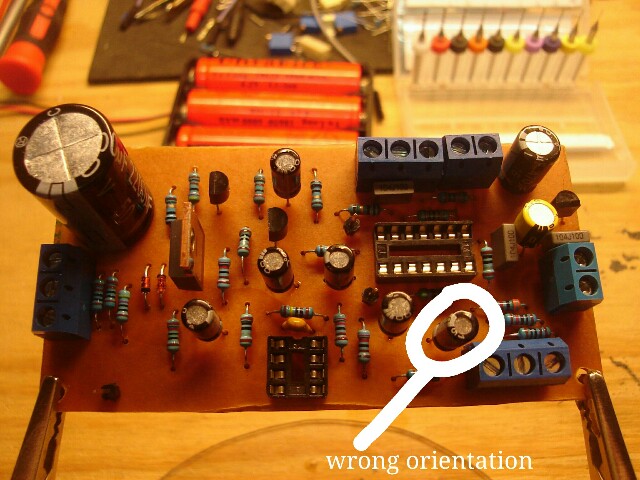

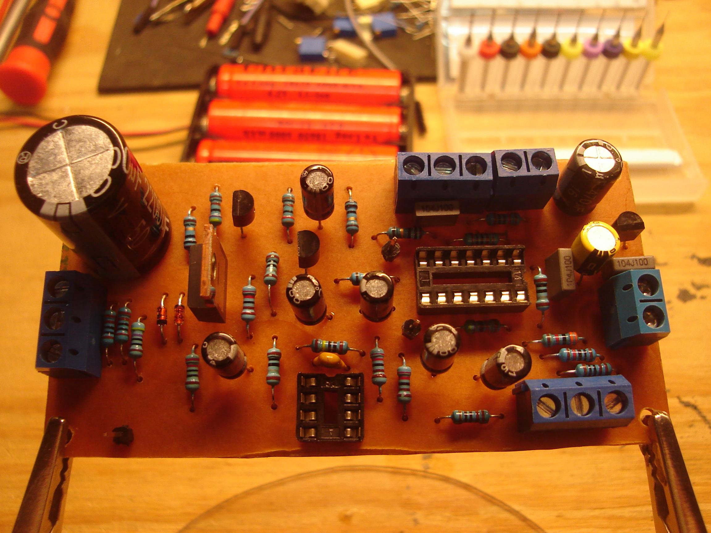

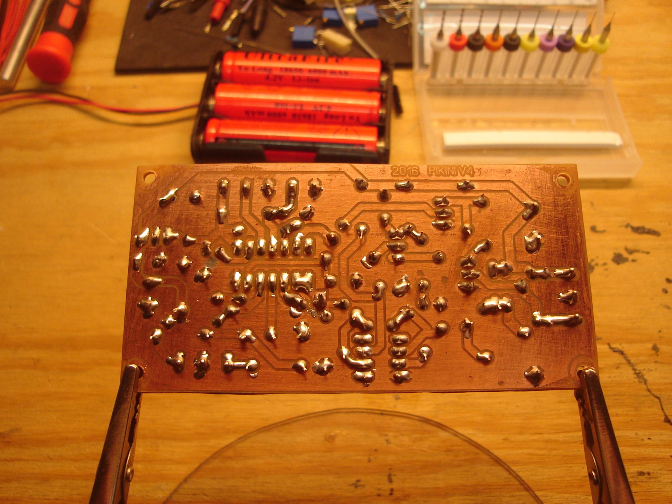

            • Boards ready for pic
              Well, got my board soldered up and ready for the pic. Still waiting to get the pic chips in the mail. Will check or test the 12v and 5v portions of the board and then go from there.
              Question,
              On the audio, the board has 3 holes (pins for attaching), center one is ground, outer holes go to 1k resistors. How or which way is this connected up, I assume it is for headphone/speaker setup or am I missing something?
              speaker only have 2 wires and same for the headphone plug, so am guessing it is designed to attach speaker to one side and headphone to the other with the middle pin being the common ground for both?
              Any help with that is much appreciated
              Geo

              Bottom

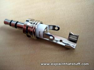

                You can connect a speaker between one of the 1K resistors and ground (left or right to middle pin).
                You can decrease the 1K series resistor to achieve louder sound.
                A typical 3.5 mm headphone jack has 3 connections: L, R and Gnd. They match directly to the 3 pin header on the board.
                Picture of a 3.5 mm jack:
                Have a look at this picture:

                          Which component placement document are you using to place these eltro caps
Name:	My Pickini build top-640x480.jpg
                            • @ geoscash1
                              The polarity of the 2 elco's indicated is wrong on your PCB -- as correctly indicated by Arionas.
