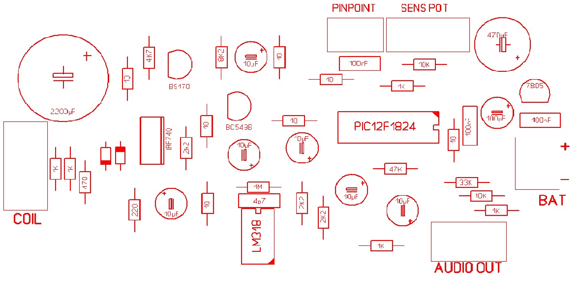

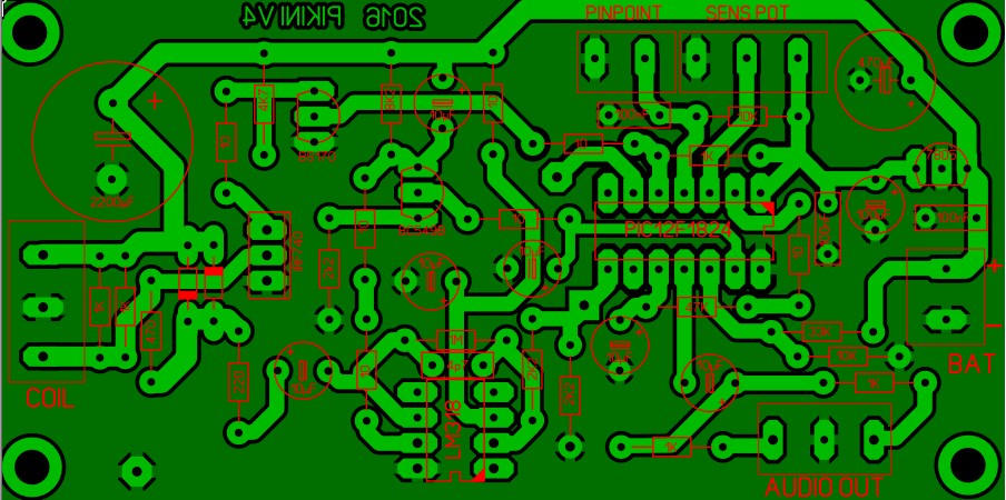

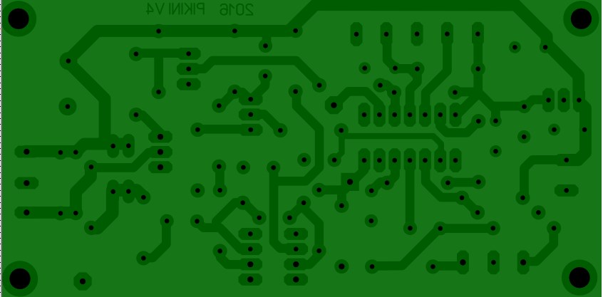

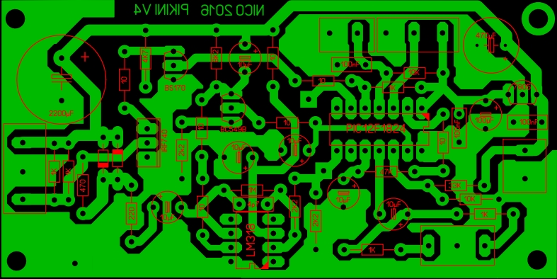

          i join you the .lay file of pickini shorter 50x100mm and a picture of it,it perhaps be smallest but fit well with my 3d printed 3x18650 battery pack.
          i modify it with ground surface and thermal pads i have the same without sprind layout automatic ground surface (ground surface hand made)

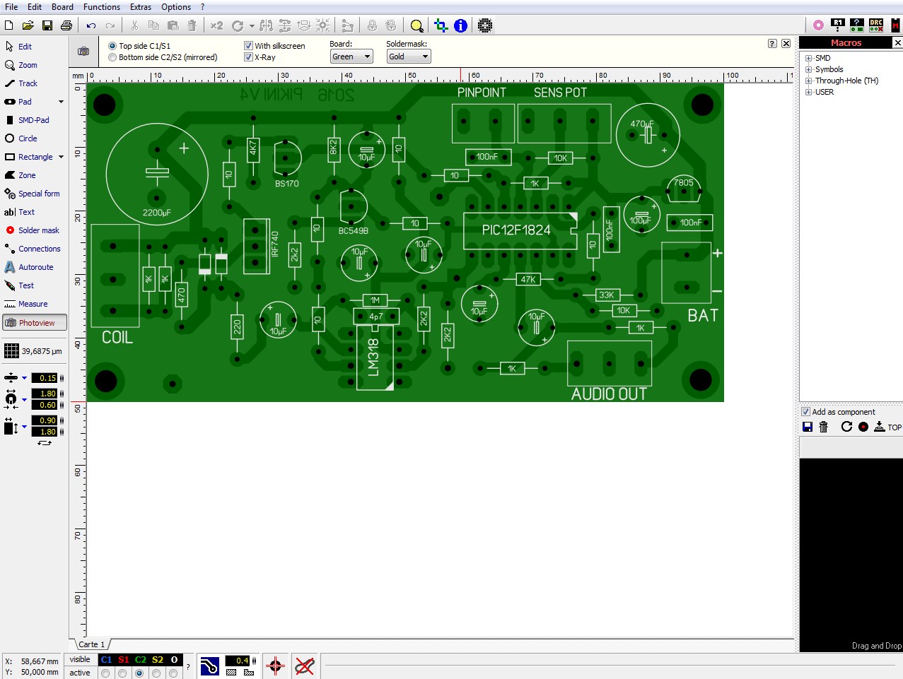

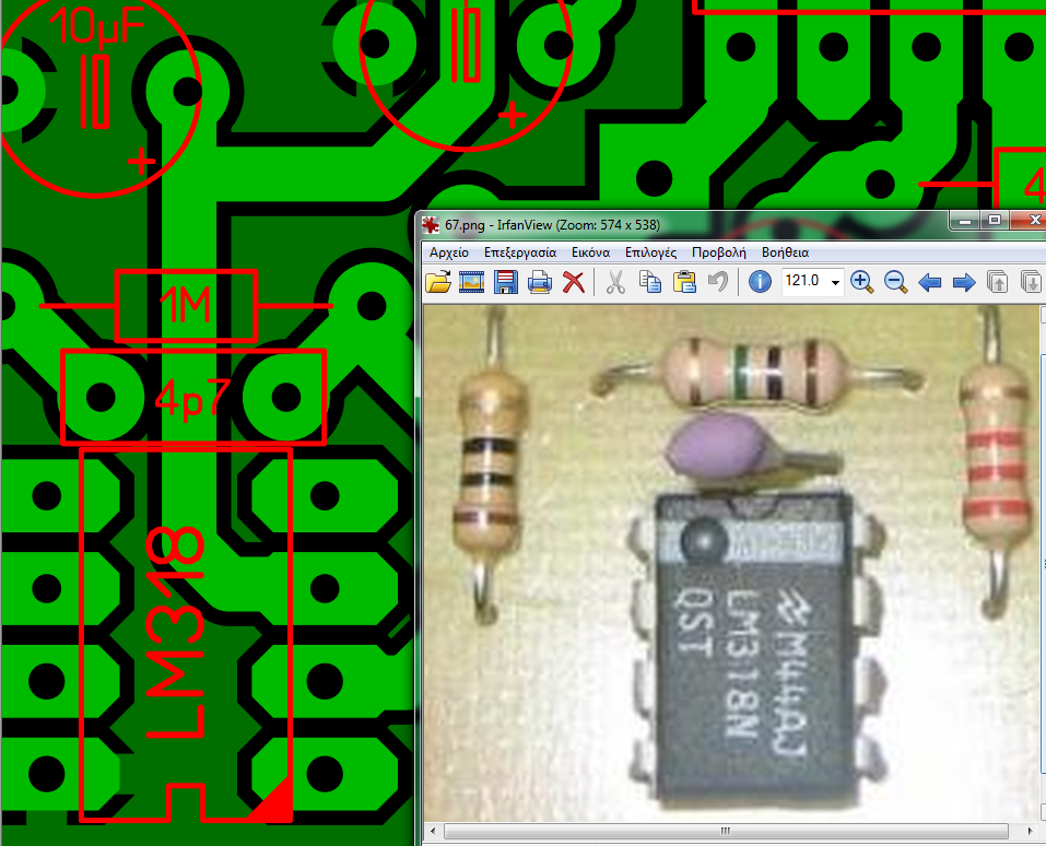

                      @Arionas & Nick Holas:
                      NICE WORK with the smaller footprint PCB
                      1 remark on the PCB component layout of Arionas: screenshot_1.jpg: The symbol of the LM318 is upside down.
                      The layout itself however is OK.
                      Best regards,
                      - Bernard
                        Best regards,
                        - Bernard

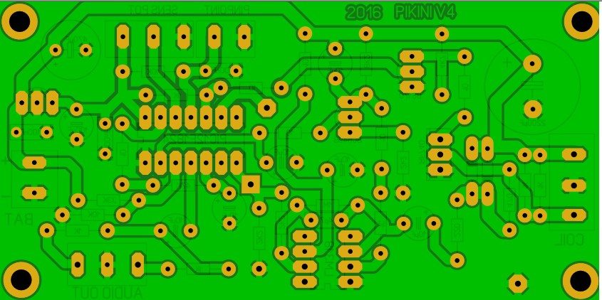

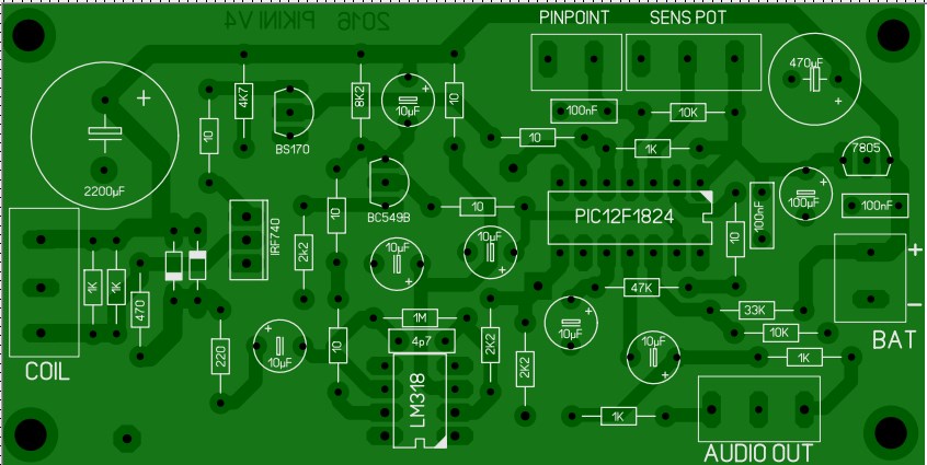

                        Ok My friend ..................Im Sorry..........Now its Ok??????

                        • #42
                          Now it is OK, Arionas.
                          Nice work !
