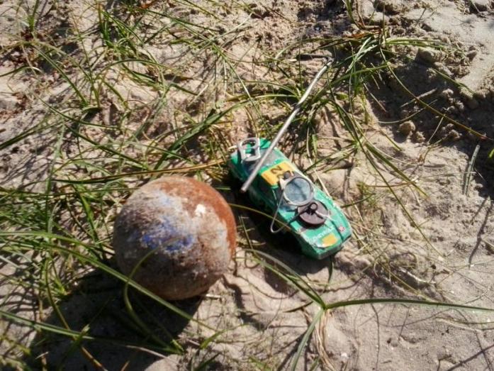

                            Apparently, nobody has made it working so far.
                            In the mean time, feast your eyes on some typical finds from the seaside dunes.
                            At first, I thought I had found a cannonball, but after digging 1m deep, it turned out to be a petanque ball.
                            Next: toy car, pull tab, aluminum French WW2 coin, tent peg,... lots of pieces of barbed wire (WW2 remains).
                            Have fun,
                            - Bernard
