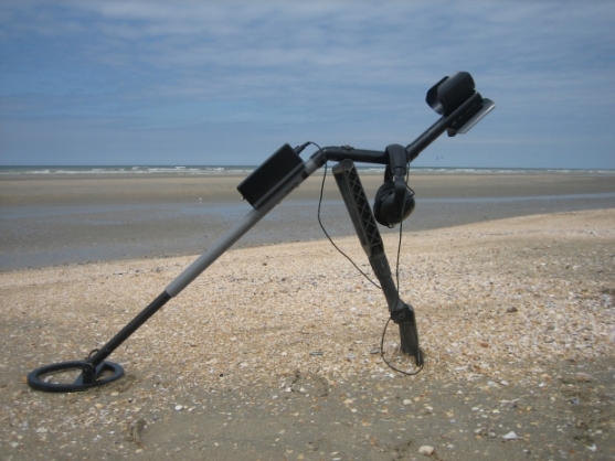

              Nice build. With drain pipes ?
              My first builds were also with drain pipes and 30 degree elbows.
              I then switched to aluminum crutches and a straight (Anderson type? ) shaft. They are less wobbly (? no idea if this word even exists...)

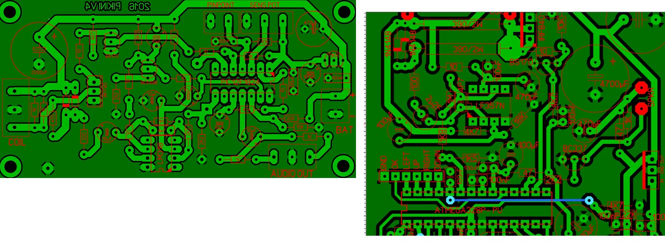

                    • Hello
                      Pickini and Felezjoo looks very similar.
                      • Originally posted by samii View Post
                        Hello
                        [ATTACH]41374[/ATTACH]
                        because it is a pi detector and it is drwed with sprint layout Software
                        but they are not similar

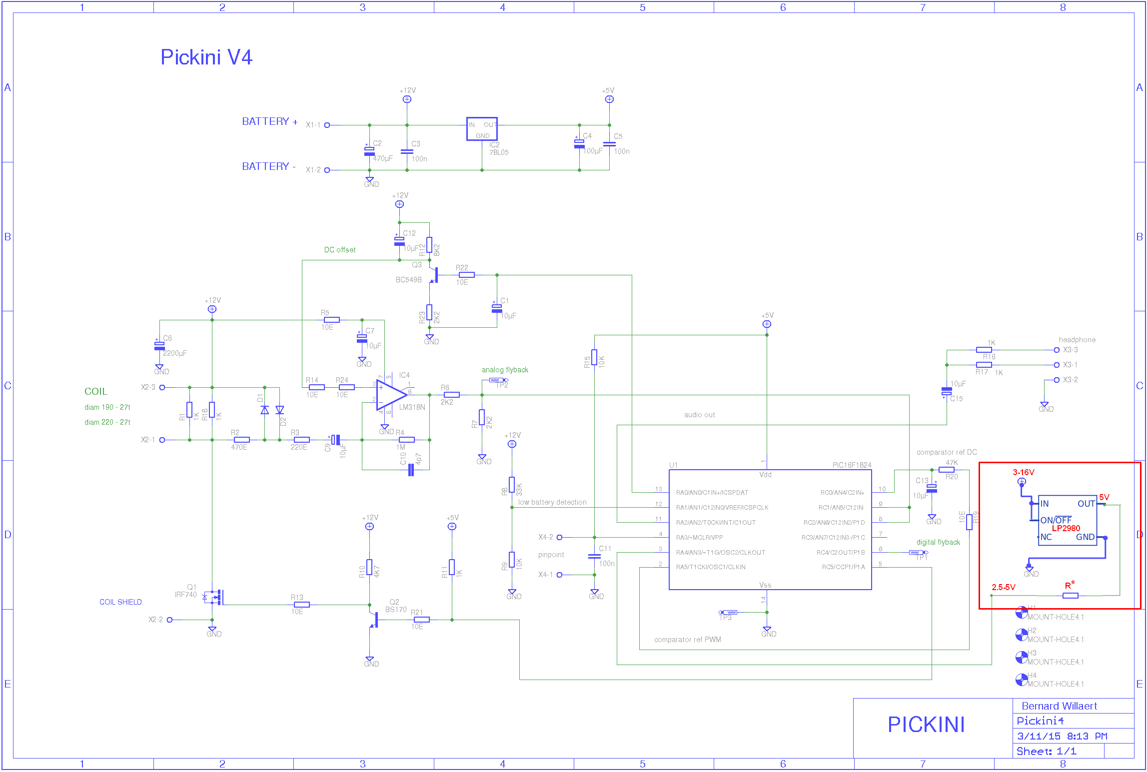

                        • I would like to propose a stabilizer for saturation instead of a potentiometer. since when the voltage is applied to the battery, it is necessary to adjust the sensitivity with a potentiometer. and the stabilizer will give a constant voltage regardless of the battery's discharge, which in turn falls off in the application of the potentiometer. simplifies the design and improves it with a minimum of controls, can be placed without problems in absolutely any body of dust and waterproof maximally. how do you like this option?
                          • The sensitivity potmeter is connected between the stabilized 5V and GND - so it is already independent of battery voltage changes.
                            • then do not see the point in the potentiometer at all. you can set a constant and choose an average depth for the stable operation of the metal detector and not to steam. I wanted it better, but it turned out as always.
