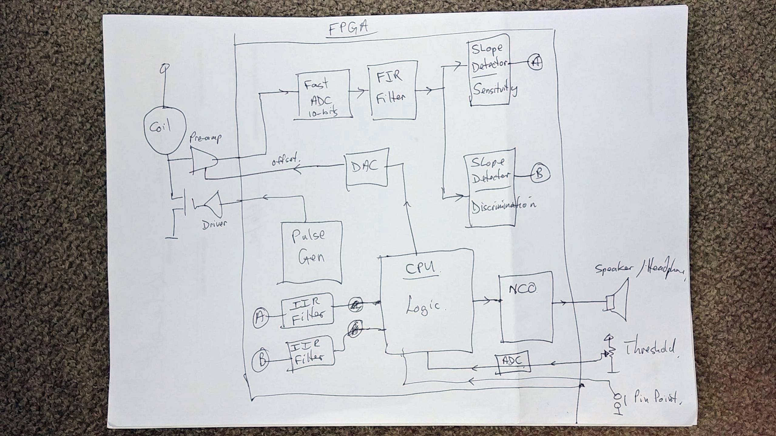

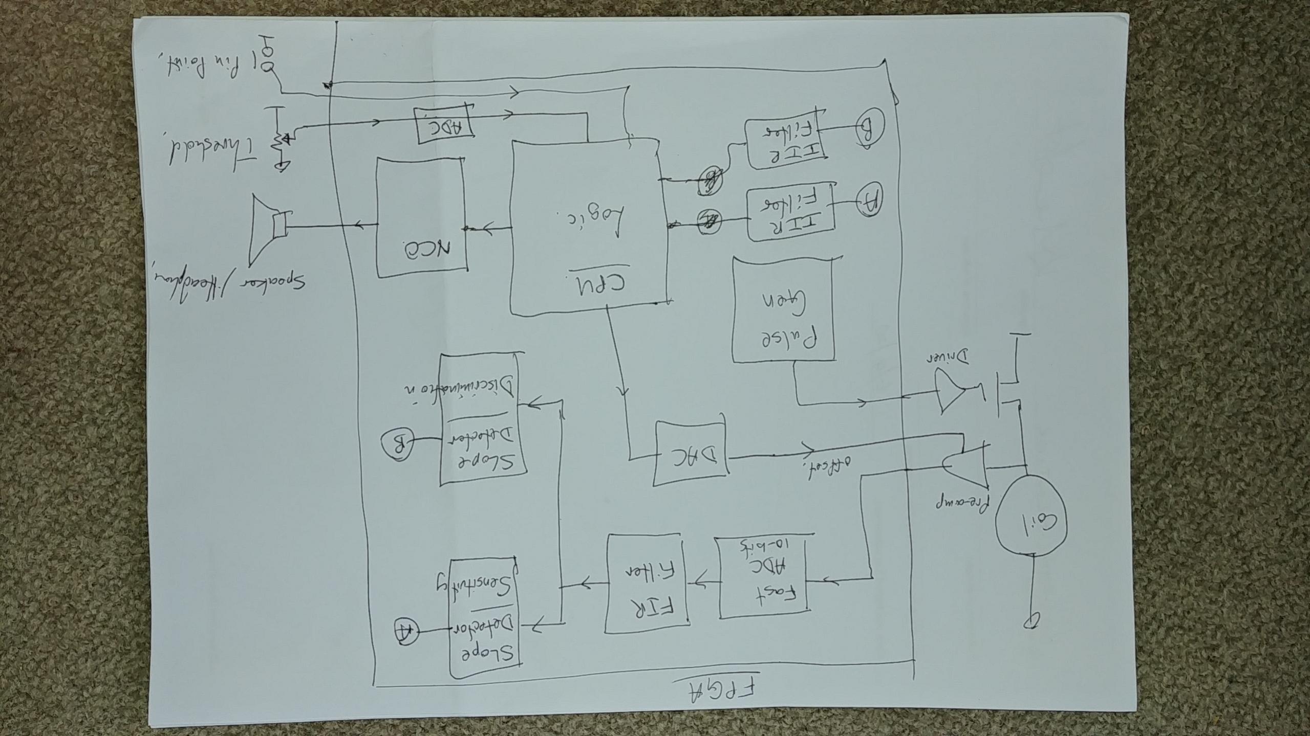

  • ... and here is a rough block-diagram of what I have implemented in the FPGA ..
    .. oops sorry it is upside down

        which fpga do you work with?
        • Originally posted by useus View Post
          Hi, as mentioned earlier, I am using an Lattice ICE40HX8K....so far have only used 35% of the 8k LUT's.
          • Originally posted by SaltyDog View Post
            What I think he means is which specific board, when you google it there lots of different prices and boards
              AH, well I am doing development on the Lattice board, but I intend using the TinyFPGA BX board located here: https://github.com/tinyfpga/TinyFPGA-BX
              The board is only $30
