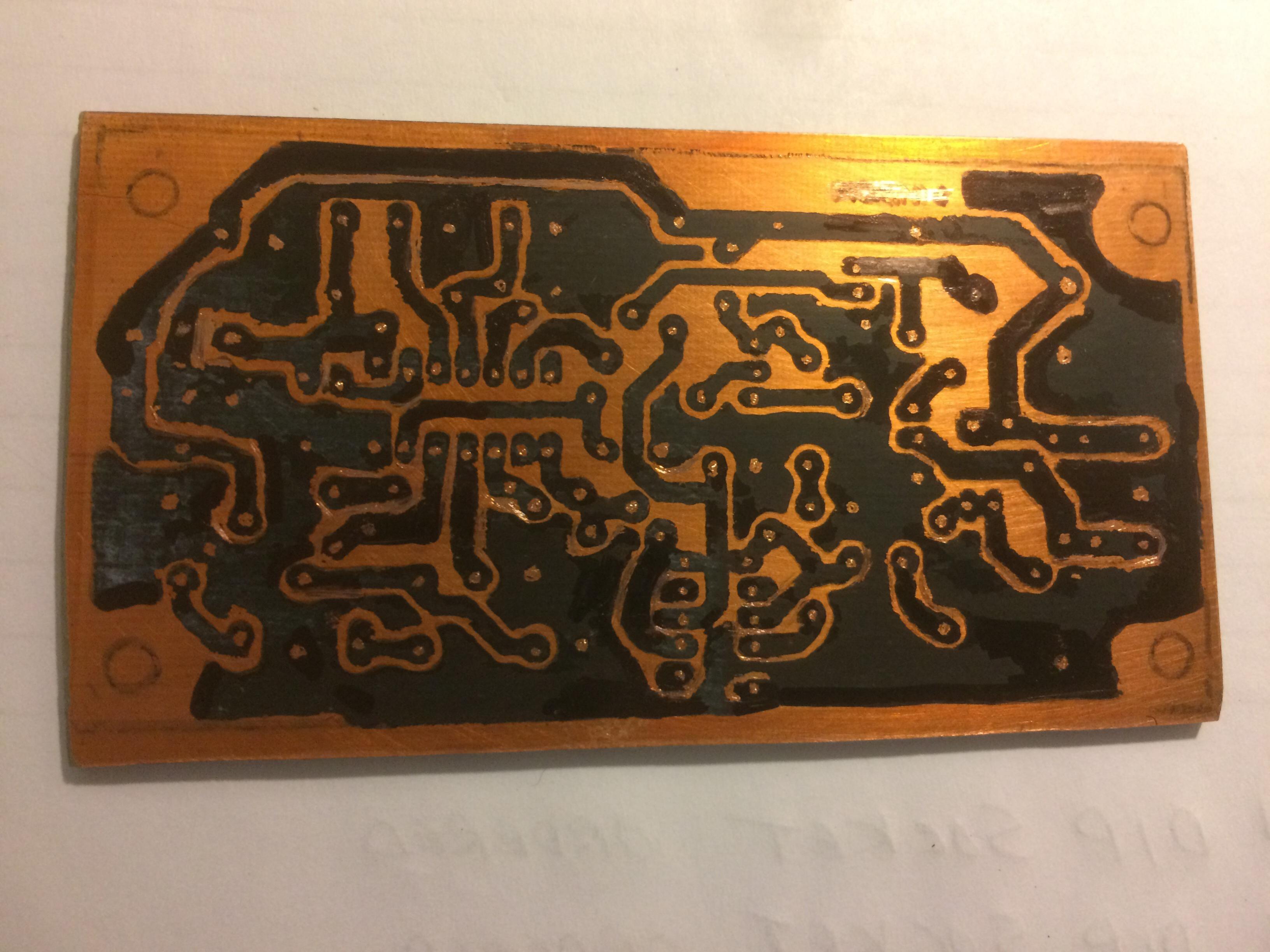

                    • Transferring Circuit Image to PCB
                      I have to say that I'm surprised at how easy it is to transfer images to a PCB. This was my first try using an iron and I think it will be useable after filling in with a Sharpie.
                      I fed a glossy page from a NY Times magazine that we get with the Sunday paper through my laser printer and printed the Pickini pdf file from here: http://www.geotech1.com/forums/attac...4&d=1476693260 I scaled the image at 50% which seems to be about the right size for the DIP adaptor.
                      I "ironed" it for about five minutes on the highest heat setting and then placed the new PCB in some hot water and let it soak for about three minutes. Then I peeled the paper off and finished cleaning it with a toothbrush. After I finish the PCB image, I'm going to try and etch it with vinegar/hydrogen peroxide. So far the cost of this is $0 because I already had the copper.

                      • Morgwnton sir, you may get more greater result with cheap thin photo paper and laser printer, difer toner difer result, just iron for one or two minutes let it cold and peal with water.
                        Sample
                        Here are better pdf ready to print, size A4
                        • Nothing ventured, nothing gained morganton!
                          A couple of considerations- 5 minutes is possibly too long. Once the heat has transferred through to the copper that should be enough-say 30-60 seconds. It does look like the toner has smudged somewhat... I am using toner transfer paper off ebay. I tried with glossy paper, thinking I needed the cheap, floppy catalogue type. It was a disaster. In retrospect, the better quality glossy paper used for tourist brochures etc. may be better, allowing it to be carefully peeled off. Yes, with the catalogue paper I soaked, but in cold water, the delicately brushed it off. But still had some peeling at the edges. I read somewhere the trick (with the thicker glossy) was to place the copper/paper in the freezer for 10 minutes, then carefully peel off. The first step is to get the copper impeccably clean. I use a new green scourer and detergent to remove any oily residue, then the green scourer and rain (or distilled) water.
                          If you are not happy with your transfer result, it can easily be removed with acetone.
                          Also i bought a small drill press for an electric drill. I use .8mm bits for most holes, and 1mm for larger legs, with the PCB on a block of wood. Previously, drilling by hand, I centre-punched the holes, but using the press it was easier not to, as any mis-alignment caused the hole to be drilled totally out of the centre-punch divet.
                          Good luck. I am sure you will perfect it.

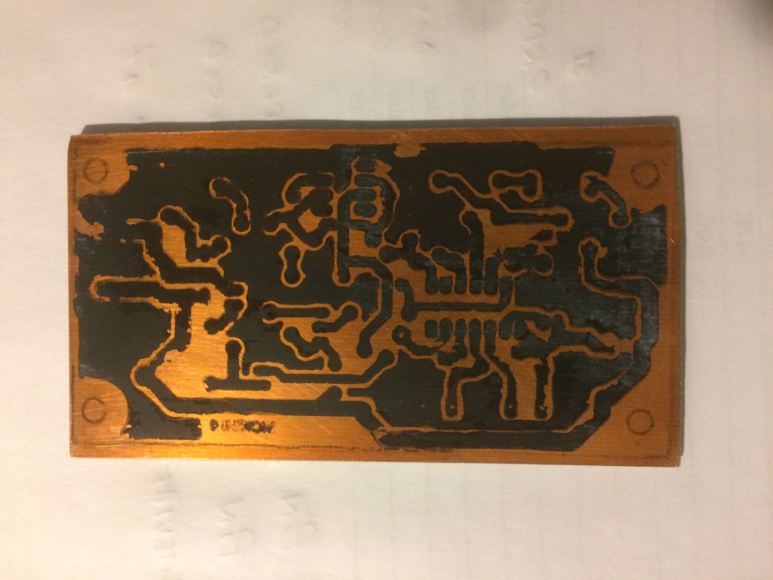

                          • So, I cleaned up the PCB with a Sharpie. I think I will try to etch it. I definitely had to fill in some traces.

                            Thanks Tim. It is certainly a learning process.

                              With a design that small, it must be easier to use stripboard.
                              • For real small designs, just mark the 2.54mm pinholes, then join the dots with the sharpie.
