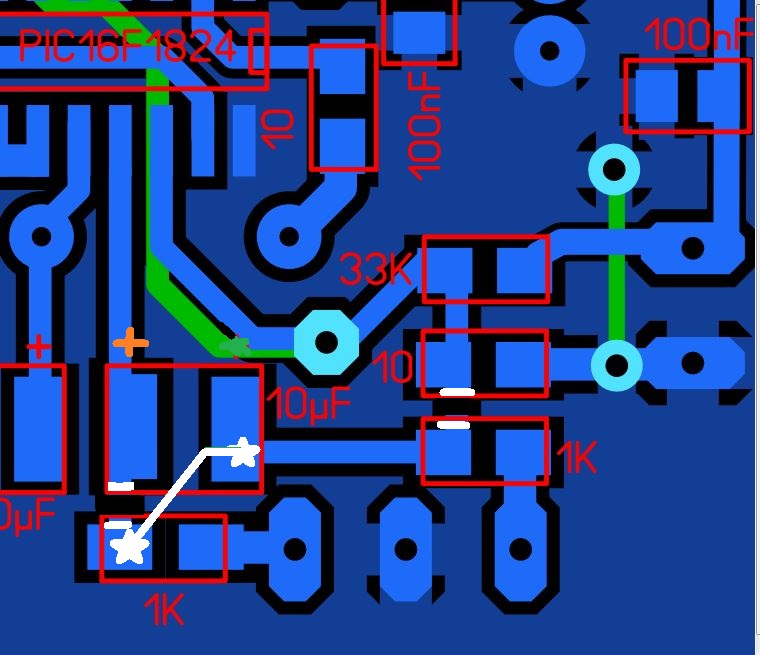

        • Originally posted by nick holas View Post
          hi all
          hi bernard
          i ve made little change to fit the resistor 0805 smd foot print,and adapt condensator foot print too,corrected the pickit header (we will just have to put the pickit on the pcb and burning progr!!!)
          i ve tell to microchip to send me some pic16f1824 smd sample so now i m waiting for and bought some lm318 soic too (but in aliexpress so i have to wait a looooooong time !!!)
          i havent added a 1µf cap near 7805 (will do it soon)
          i have made an excel file of all the component we need to do pikini ,we have just to print it now (i join it with my pcb revision)
          have nice day
          There is something wrong in the SMD-Layout...
          Look the Part for the Speaker (Pic Pin11 - C15 - R16+R17 - Speaker)
          • Yes,
            C15 is installed incorrectly on board. Must be reversed and + be to pin 11 of the processor.

                  Yes you re right c15 is inverted!!!!!!! +to pin 11 of the pic
                  I ve corrected it and i will post the good one soon
                  Have Nice day

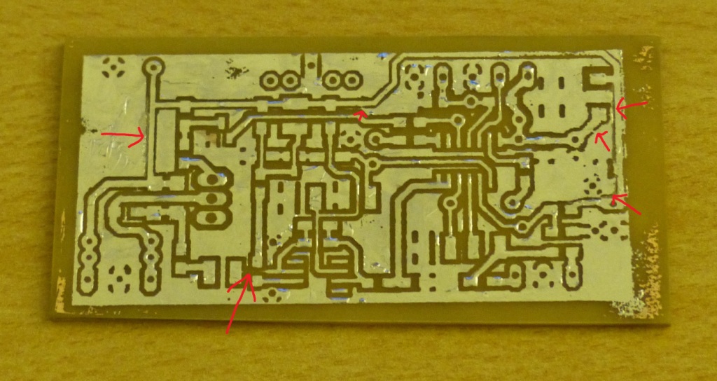

                  • Thats not all (C15 inverted). Lock the Photo, there is another mistake.
                    • corrected again!!!!
                      hi all
                      hi bernard
                      hi wurttemberger
                      thanks for pointing this.i appologize about this.
                      i give you the corrected pcb (c15 and r16,r17)

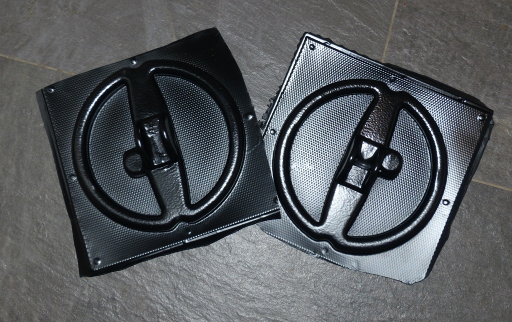

                      • not perfect but better than nothing
                        • hi all
                          hi bernard
                          hi bernte
                          really fresh pcb!!!!!
                          thats fine!!! lays are very small betwen resistor smd pads!!!
                          maybe i could make pcb a little longest to have a better ground plan near regulator
                          i saw a mistake on pickit header,it does not appear??? only ground???
                          i ll done mine with toner transfer method and acid + peroxid + water (good epson toner,not refiled cartridge) i ll print it at work LOL

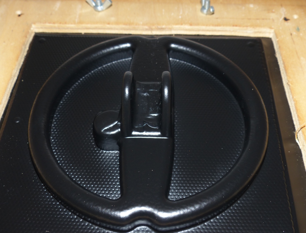

                          the shell are perfect!!! how about thickness?
                          is this vaccum forming??? it look like
                          very good job

                            • @Bernte_one : Very nice coil shells
                              Wish I had the skills / equipment to make these.
                              Best regards,
                              - Bernard
                              • Bernte one,
                                They are very good. I would say even excellent.
                                What material you use. How is it called.
