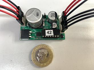

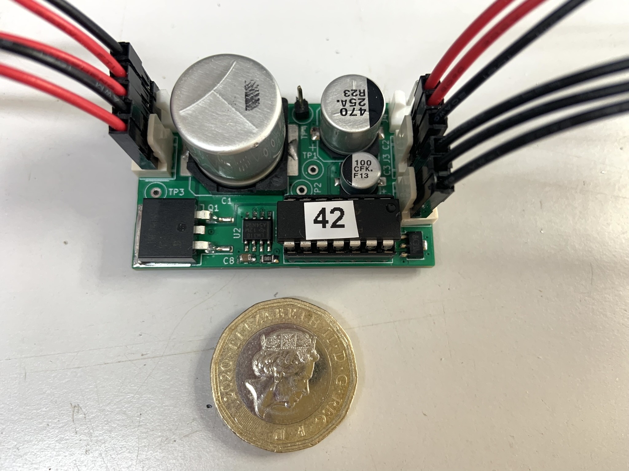

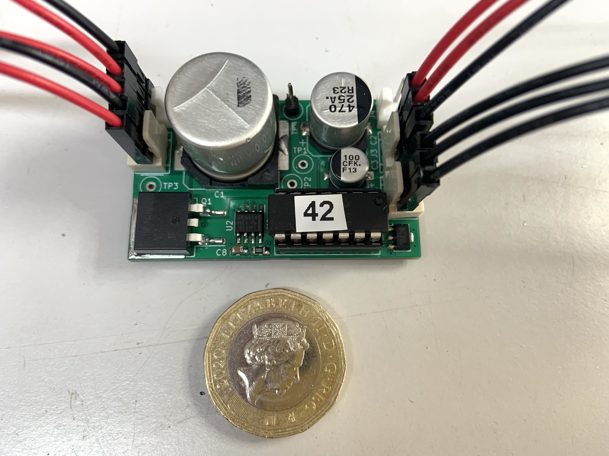

                • More than a year ago I did a tiny SMD version of the board, today I finally got around to building and testing it.
                  It's only 50mm x 30mm.
                  Here it is next to a Pound Coin.
                  Works great with V4.2 of the hex file.
                  Thanks for a great design Bernard.
                  • Nice job! You should put it in a tube and make a walking stick metal detector.

                      Hello, is there any documentation for pcb? Thank you.
                      • Here is the documentation package of the board. The PCB is 4 layers which I had made at JLC PCB for $28 for 5 boards.
                        Please note that the 470 Ohm resistor R4 must be replaced by 2 x 1K 0805 resistors soldered on top of each other as the single 0805 470 R resistor is incapable of handling the power and fails...
                        Pickini_V4_Refactored.zip
                        I also kept the PIC as a DIP device for ease of reprogramming.
                        Kind regards
