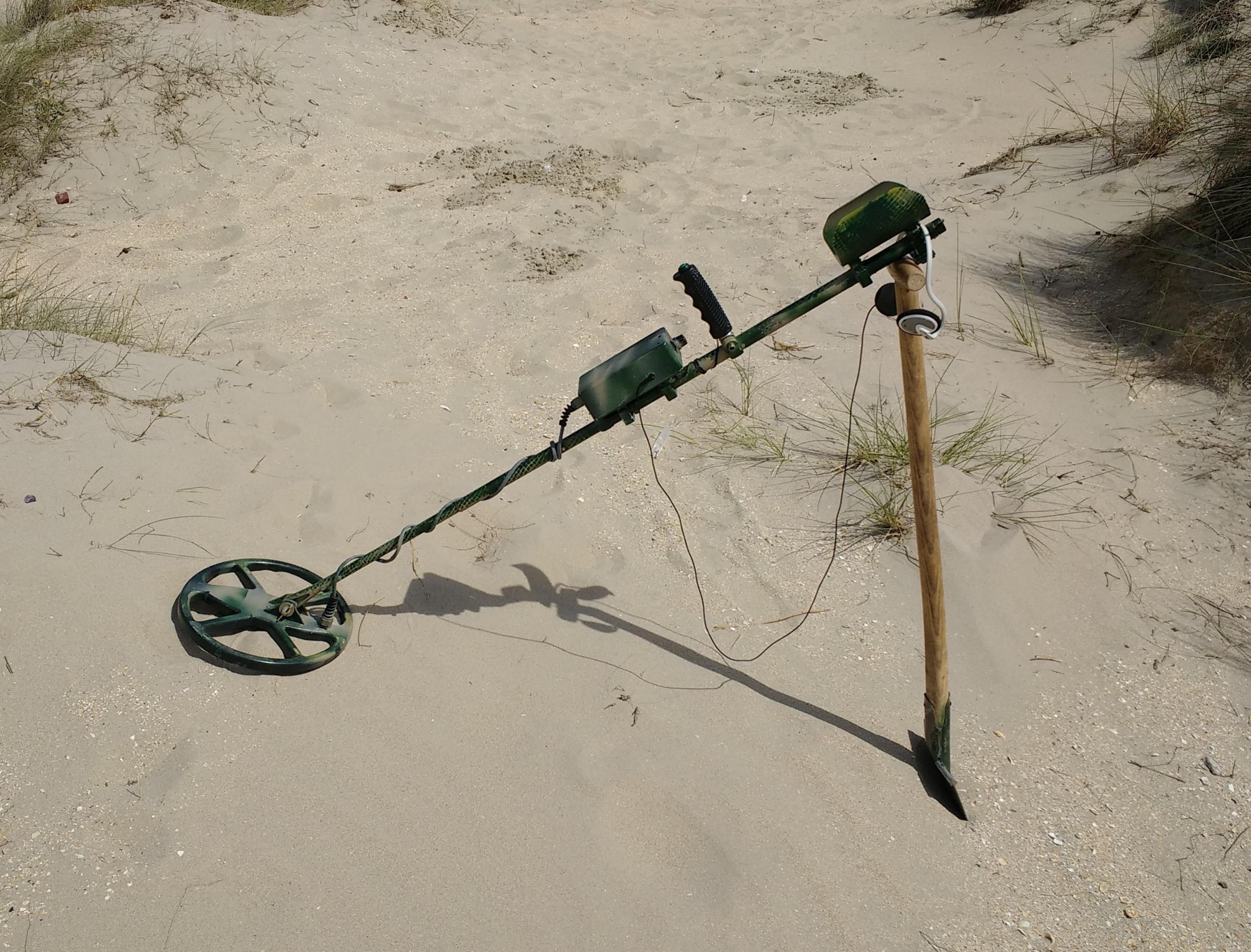

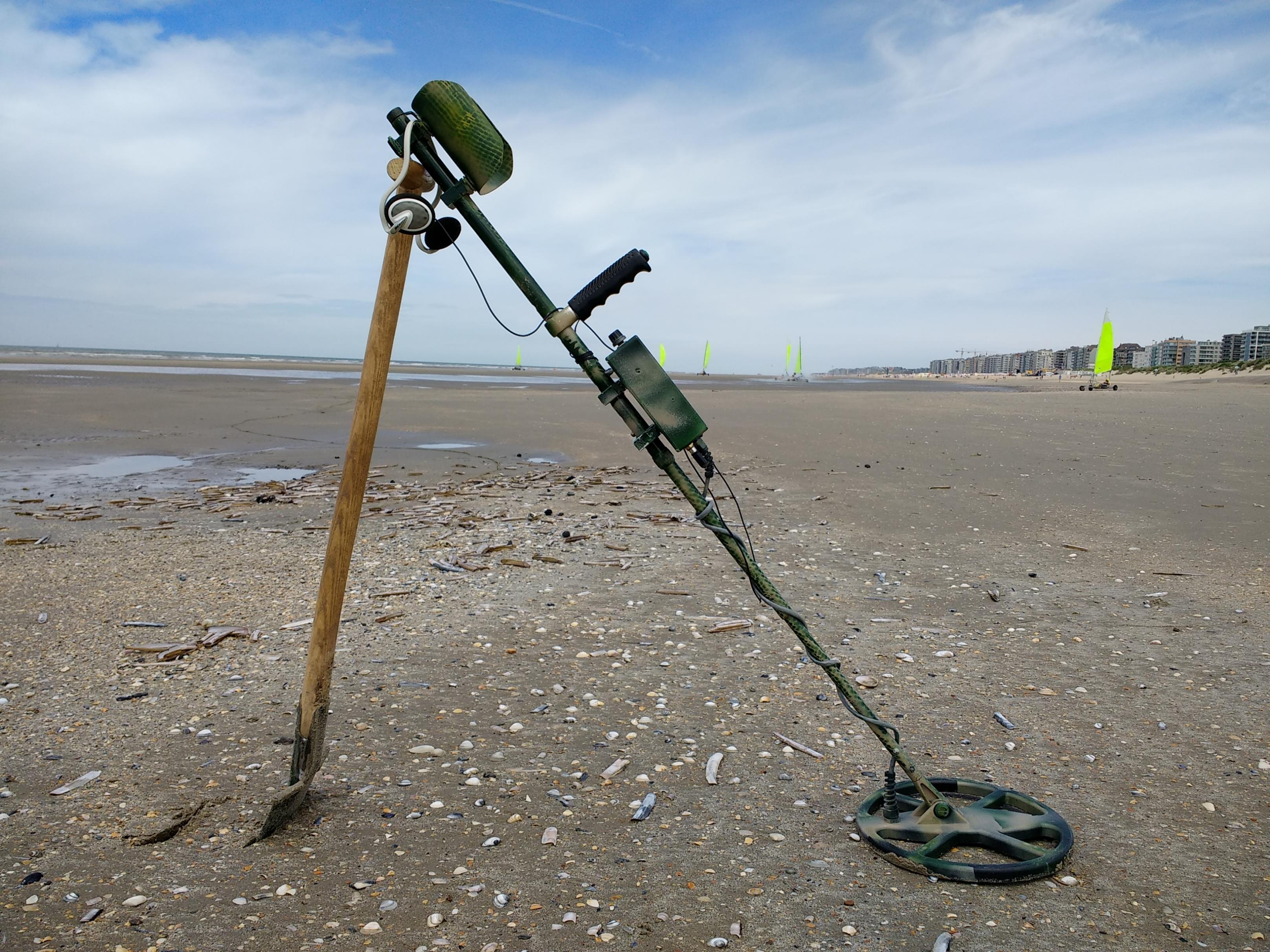

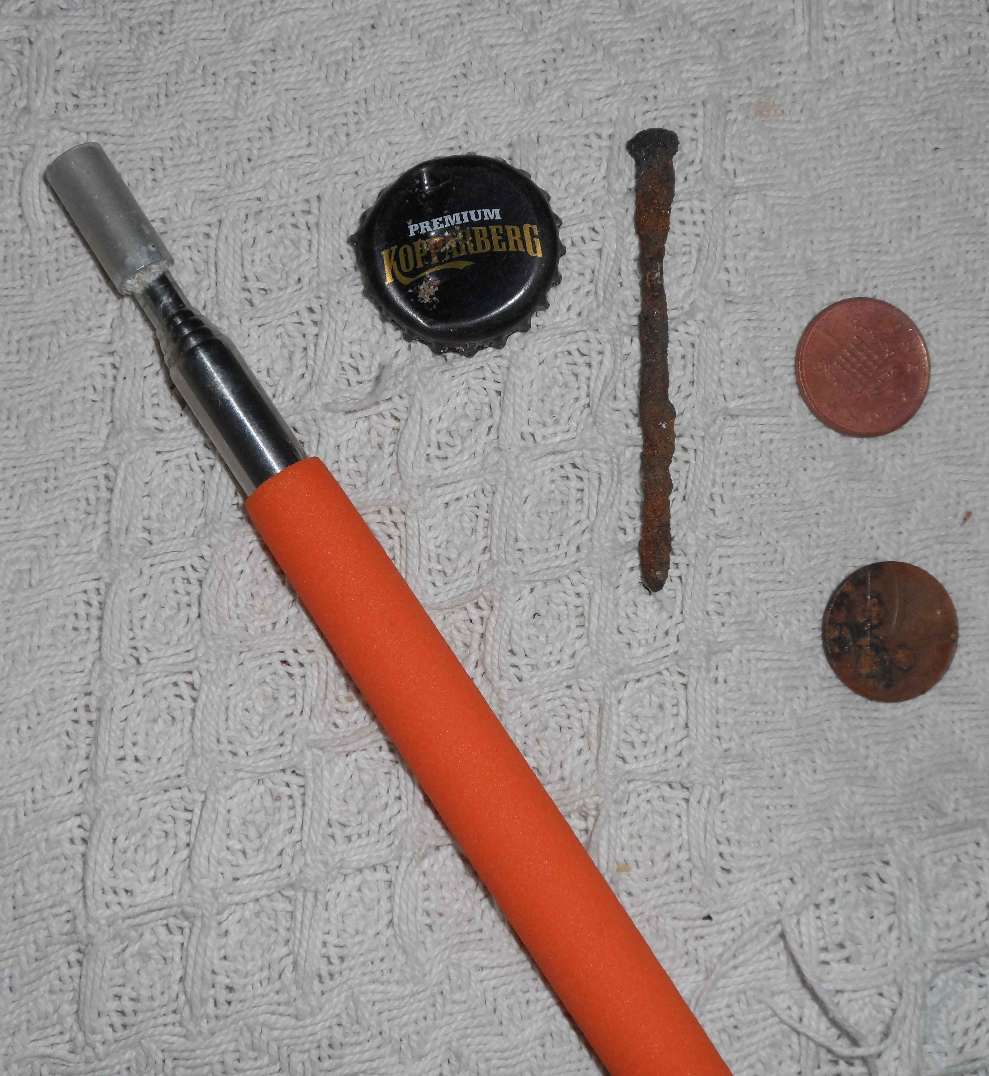

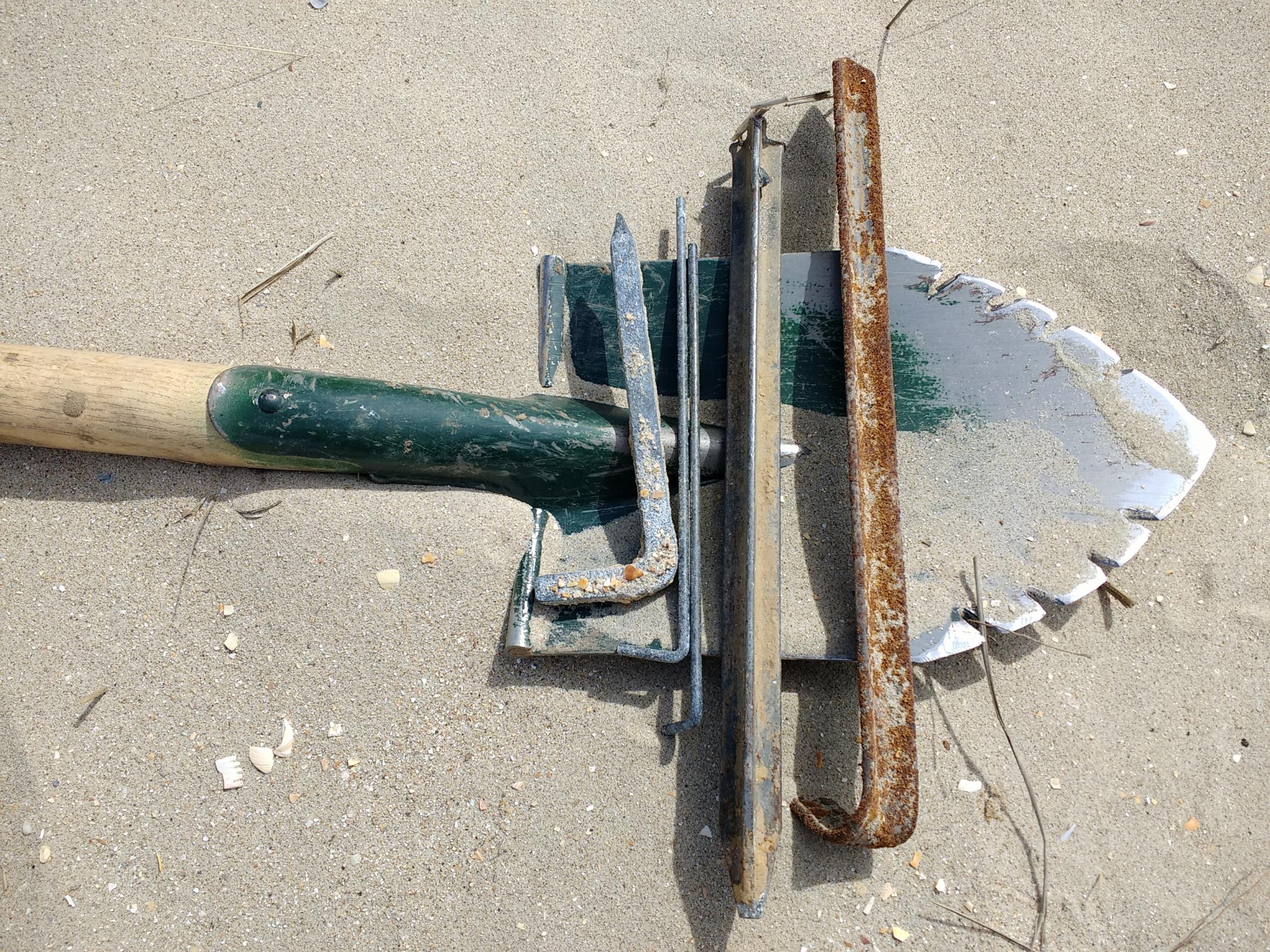

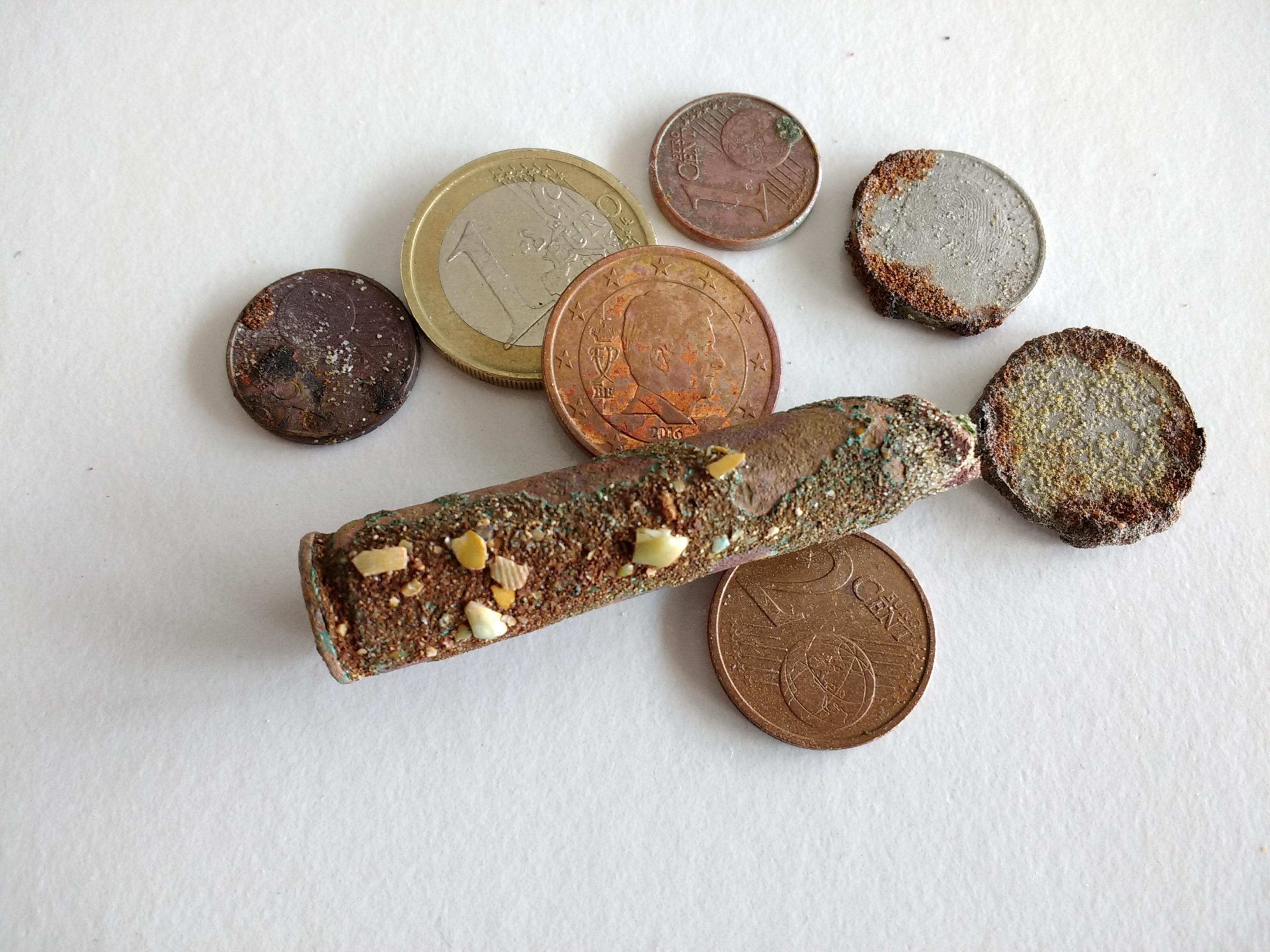

    • Some pictures of a 1 hour beach hunt with Pickini v4 last Saturday, just before the game of Belgium against Tunesia:
      Some old coins, a lot of tent pegs and a ww2 shell case.
      Bottle caps, pull tabs,...
      Unfortunately no golden earrings this time.

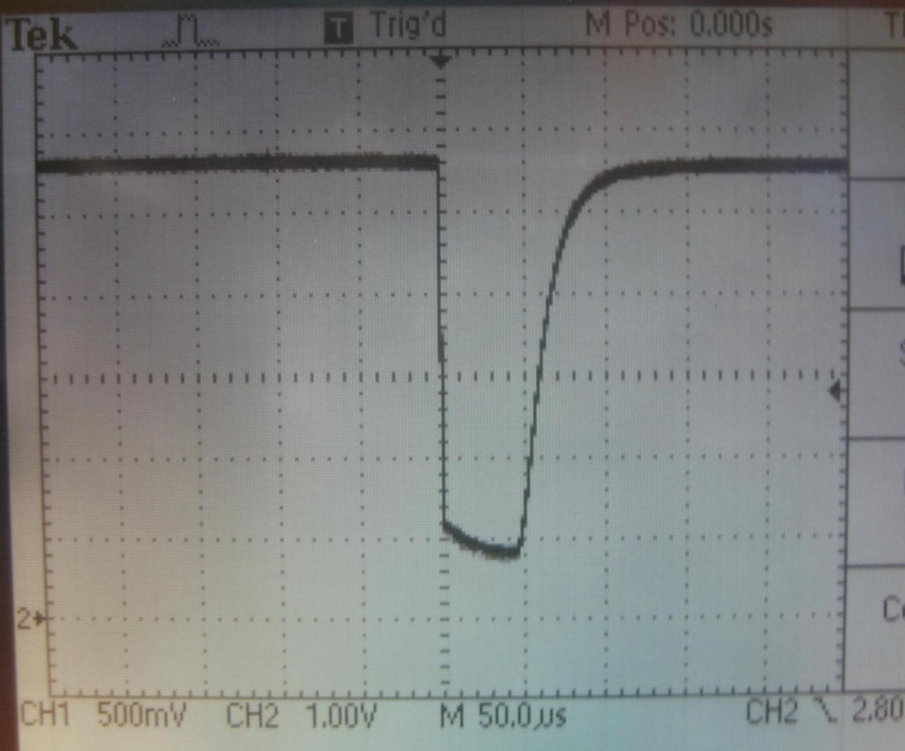

                    • Good Morning Guys,
                      I've built on perfboard a pickini V4, it detects a 2 euro coin at about 11cm in free air with the sensitivity set to maximum.
                      As damping resistor I use five resistor 100 ohm (1W) in series for a total of 500 ohm 5W. The coil is 25cm diameter, 500uH and shielded with aluminium tape.
                      I've measured the DC offset bias and is 11.38V with a Voltage supply of 12.55V is it correct?
                      I've also attached the wave coming out from the op-amp because I don't know if it's correctly dumped
                      Picture:https://ibb.co/nyJb0K
                      Could anyone helps me? It's my first metal detector
                      Thank you so much Riccardo

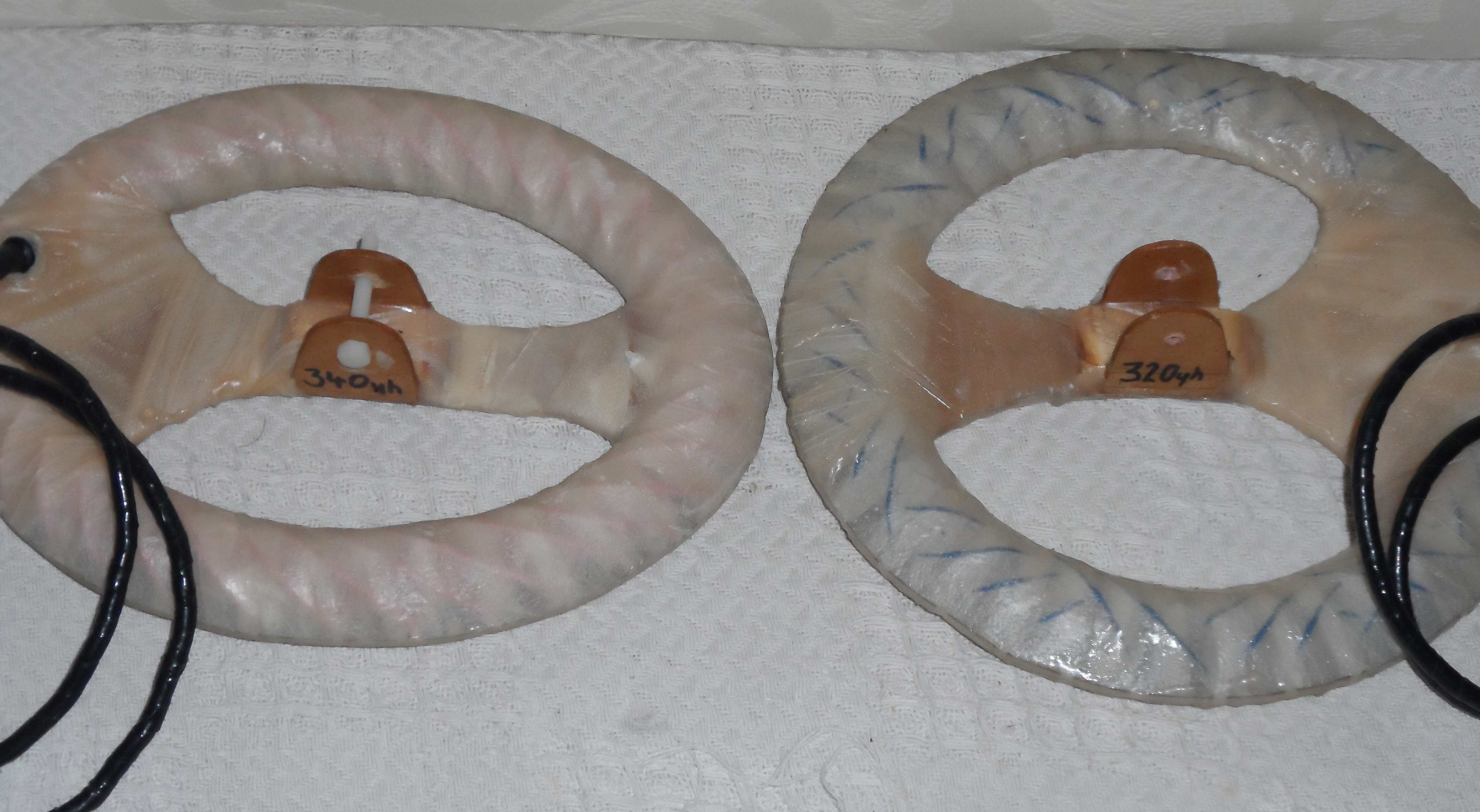

                          • Hiya Rick,,,,I think the two 1k resistors are to do with the Audio section of the detector because I remember others asking Bernard how to raise the volume of the speaker and I think he replied to them telling them to lower the value of these two resistors,,,I know it's somewhere on this thread. The 3dss coil takes quite a while to make as you will need a lot of patience to wind it, but it has the advantage of not needing to add a 'shield',,,I don't know fully how the 'Self shielding' works but I think it has to do with the Geometry of the coil. Basically, you decide what size coil you would like, eg:- 10" Diameter,,,then you cut out a circle of 10" diameter from material such as 'Lexan' or stiff plastic (I use 1/8" thick MDF board) etc,,,You then measure from the outside of the circle 'inwards' about 1 and 3/4" inch and draw another circle. You then divide the outer circle's circumference into 37 segments or increments and 37 segments on th 'Inner' circle's circumference. There is a thread on how to wind the wire on this kind of form in the Coils section of the forum,,look for 'Chance' coil,,,or 'Racetrack' coil,,,but there is quite a lot of information available on the 3dss coil on Geotech. I only use 3dss coils now on all my PI's because they are really fast and don't need the tedious job of shielding etc,,,I'll see if I can find out what I have on them for you and I'll post them for you to download. I would send F117 a private message about trouble you're having with the DC offset,,I'm sure he won't mind helping you cos' he's a great guy. Here's two PDF files with some templates to give you an idea. I'll see what else I can find for you. Marty

                              • The 2 x 1K in parallel over the coil is the damping resistor of 500 ohms. There are 2 resistors of 1K in parallel to reduce the dissipation per resistor. If you use 5X100 ohms in series this should give the same result.
                                You should be able to detect a 2 euro coin at 25-30cm with an 8 to 10 inch coil.
                                The differences will probably relate to the different opamp you used.
                                LM318 is quite common and should be easily obtainable ?
                                BC547 is also very common and is used to set the DC level of the amplified flyback signal.
                                What is the 2N7000 ?
                                The wave form you are showing is not correct. Probably because you did not use the opamp that was designed in.
                                It should look more like this:
