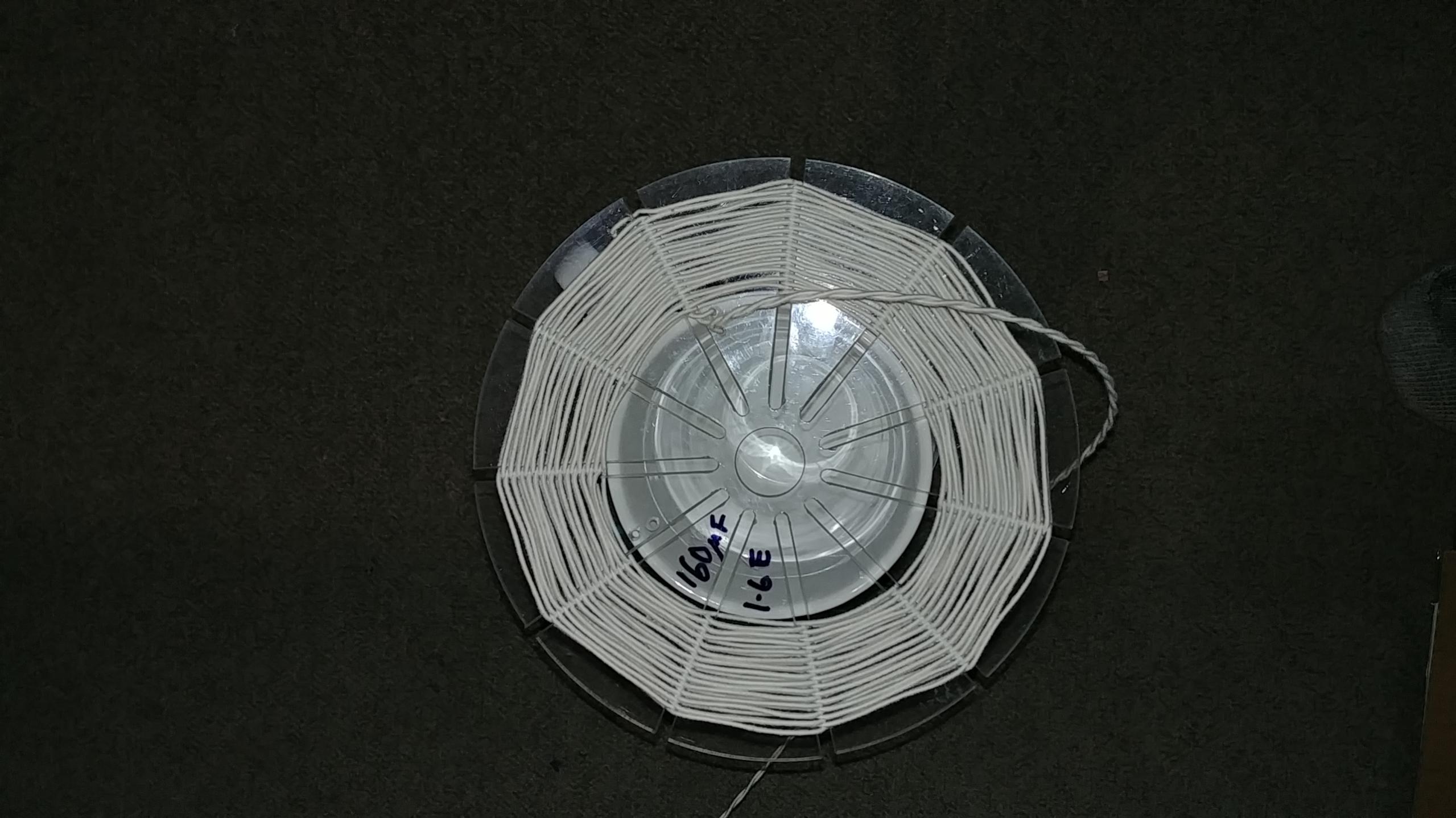

              • As I said, I have a coil that produces a discharge curve in 2us
                What type of coil construction did you make to get that speed ?, thanks.
                  Hi, I built a spider weave coil that is constructed from copper wire (0.5mm) which is cotton covered by 1mm cotton. It is the cotton wire in combo with the spider
                  weave that gives very low capacitance. (I have had a lot of experience building there for high voltage/current Telsa coil applications)
                  The coil is 160uH and 1.6E ...

                  • Originally posted by SaltyDog View Post
                    do you have a link to a supplier?
                    • Originally posted by nickel_n View Post
                      Sorry .. It is a bobbin of wire I have had for some time .... I have no idea when and where I got it ..
                      I suspect I got it when I was working, but now I have been made redundant, no longer have access to corporate emails ..
                      However, if you look for cotton covered copper wire of the dimensions I mentioned you should be all good .. you do need at least 1mm thick cotton ..
                          [ATTACH]49751[/ATTACH]
                          Thanks we used to use it here in Australia back in the 1960-70's , have not seen it for long time.
