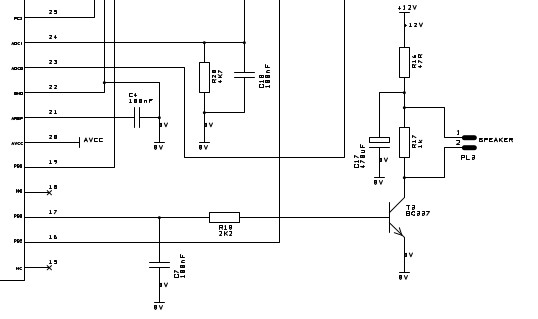

        I want to use 8 ohm speakers in the circuit.
        Can you send me the parts I need to add with a small diagram?
        Best regards
        Gurdal
        • @Gurdal: you can use a generic NPN transistor to drive a speaker, like eg the audio on Felezjoo:

          • thank you very much F117,
            I want to use it with 27cm coil.
            coil thickness and resistance value,
            damping resistor.
            Can I catch the small coin 30 cm with the coil of the diameter I will use?
            thanks a lot
            Gurdal

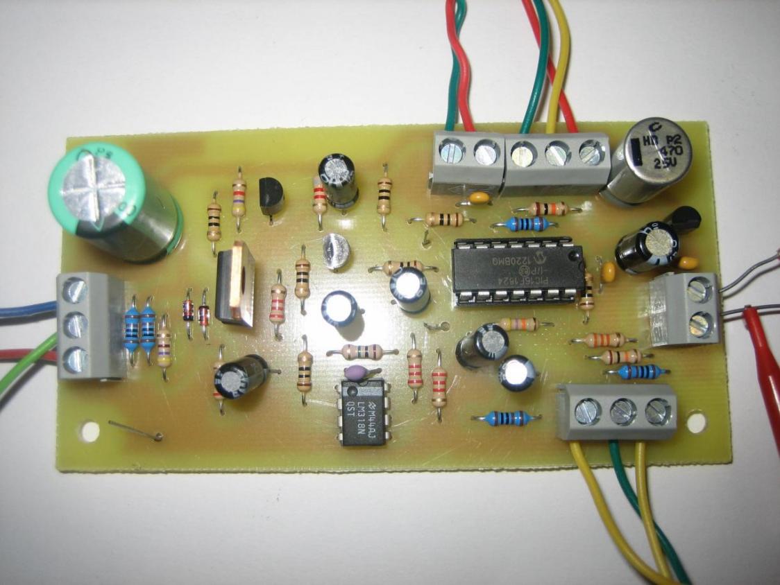

            • Dear F117
              I made a new pcb, I have exactly the same problem ... with LM318 it only detects 3-4cm from the coil at maximum sensitivity
              I am using TL071 or LF356 and performance is good
              Maybe badly programmed pic?
              Cheers
              • - Measure the DC level on the opamp pin 3. When you power the board you should see it change and end up around 7 to 8 V. But you should see it change after power on and remain steady afterward.
                - The same DC variation should be observed after startup on the PIC pin 13 - but between 0-5V and in opposite polarity of pin of the opamp: when you see the voltage on pin 3 go up after startup, you should see the voltage on pin 13 of the PIC go down. This is the automatic offset calibration cycle after startup.
                - Which layout did you use for the PCB?
                - If you use the same coil for testing both PCBs, there may be something wrong with the coil.

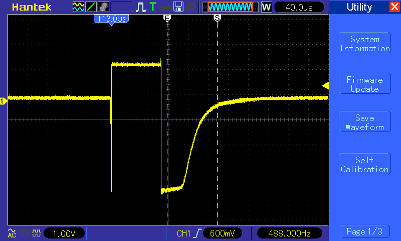

                Can you measure the coil inductance and resistance : 300-500 microHenry and around 1-3 Ohm ?
                Do you have an oscilloscope ?
                On pin 8 and 9 of the PIC you should see this waveform:
                Or maybe a bad batch of LM318 ?
                On this picture, you can see a close-up of the LM318 on one of my early boards - that work fine:
