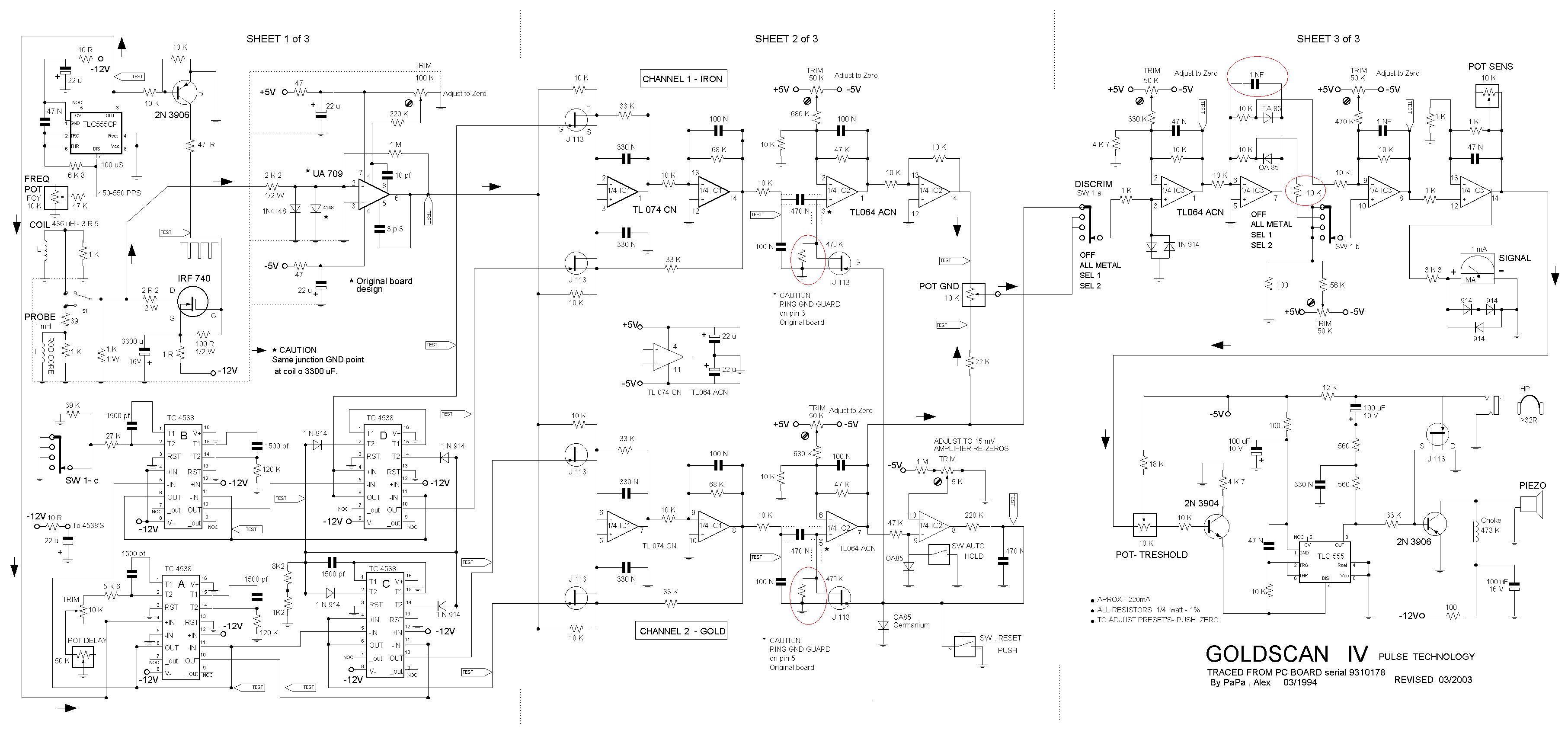

My vote goes to Jose's version of the alexismex schematic for the Goldscan IV. http://www.geotech1.com/forums/attac...4&d=1478109228

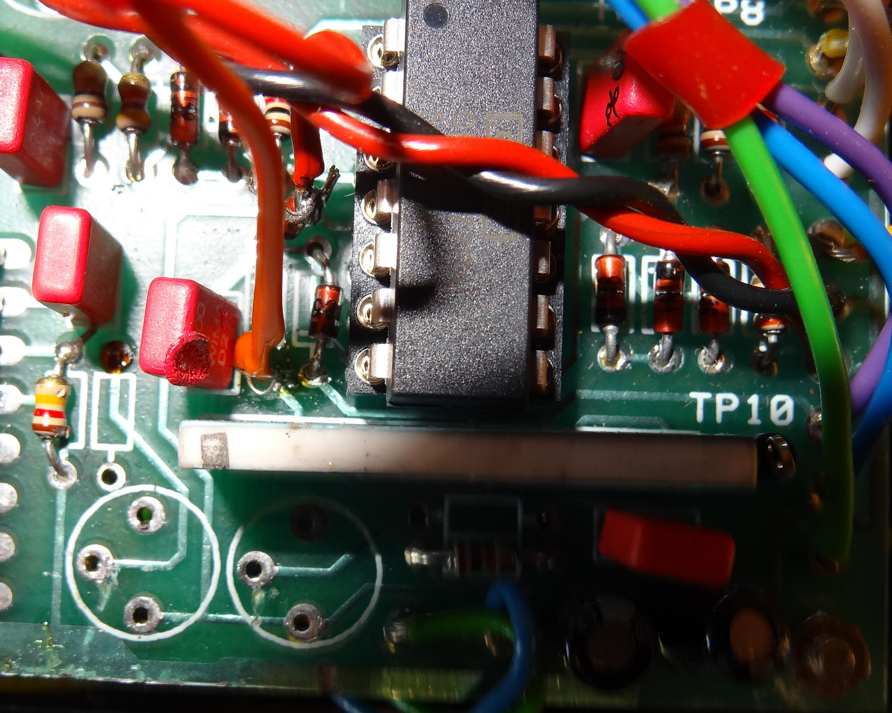

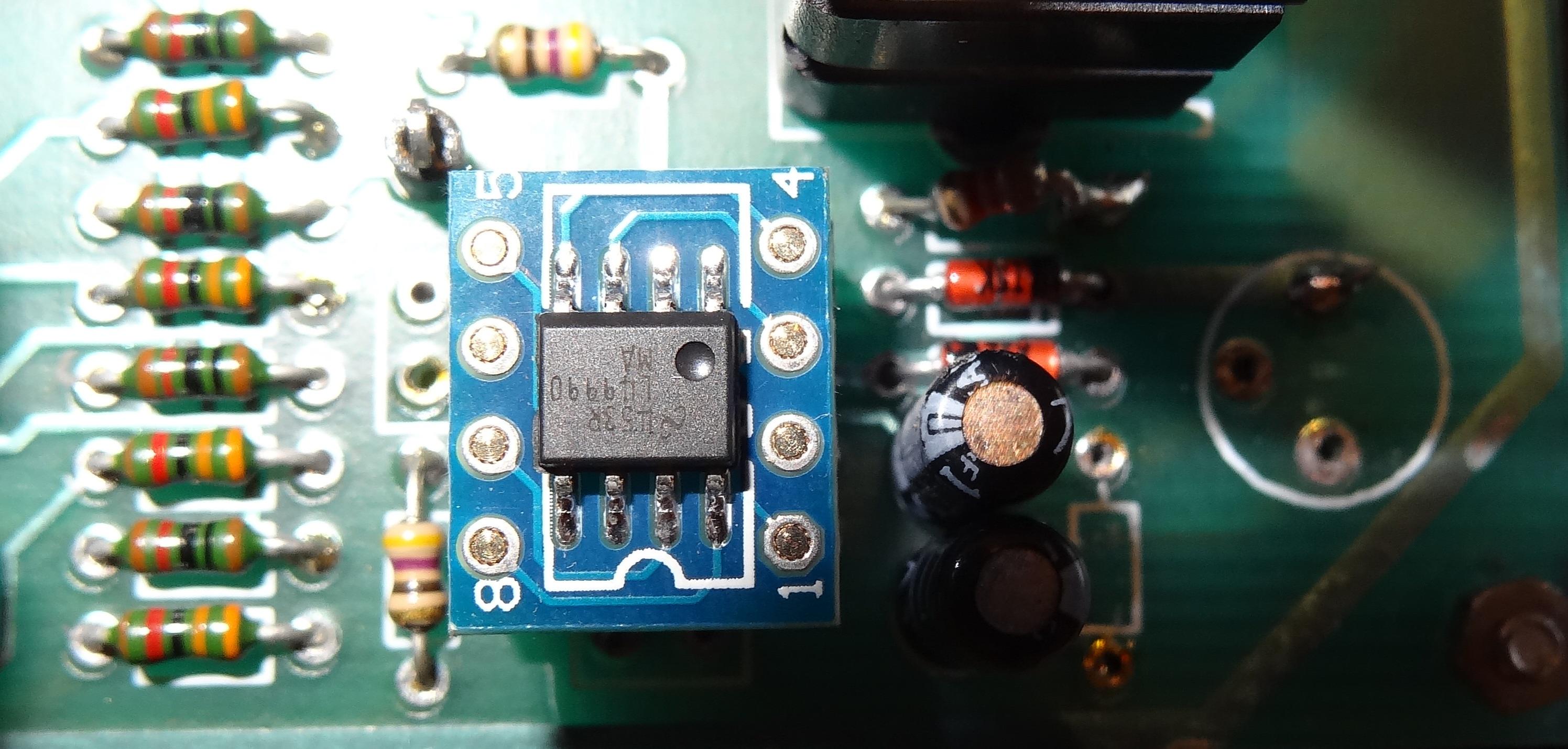

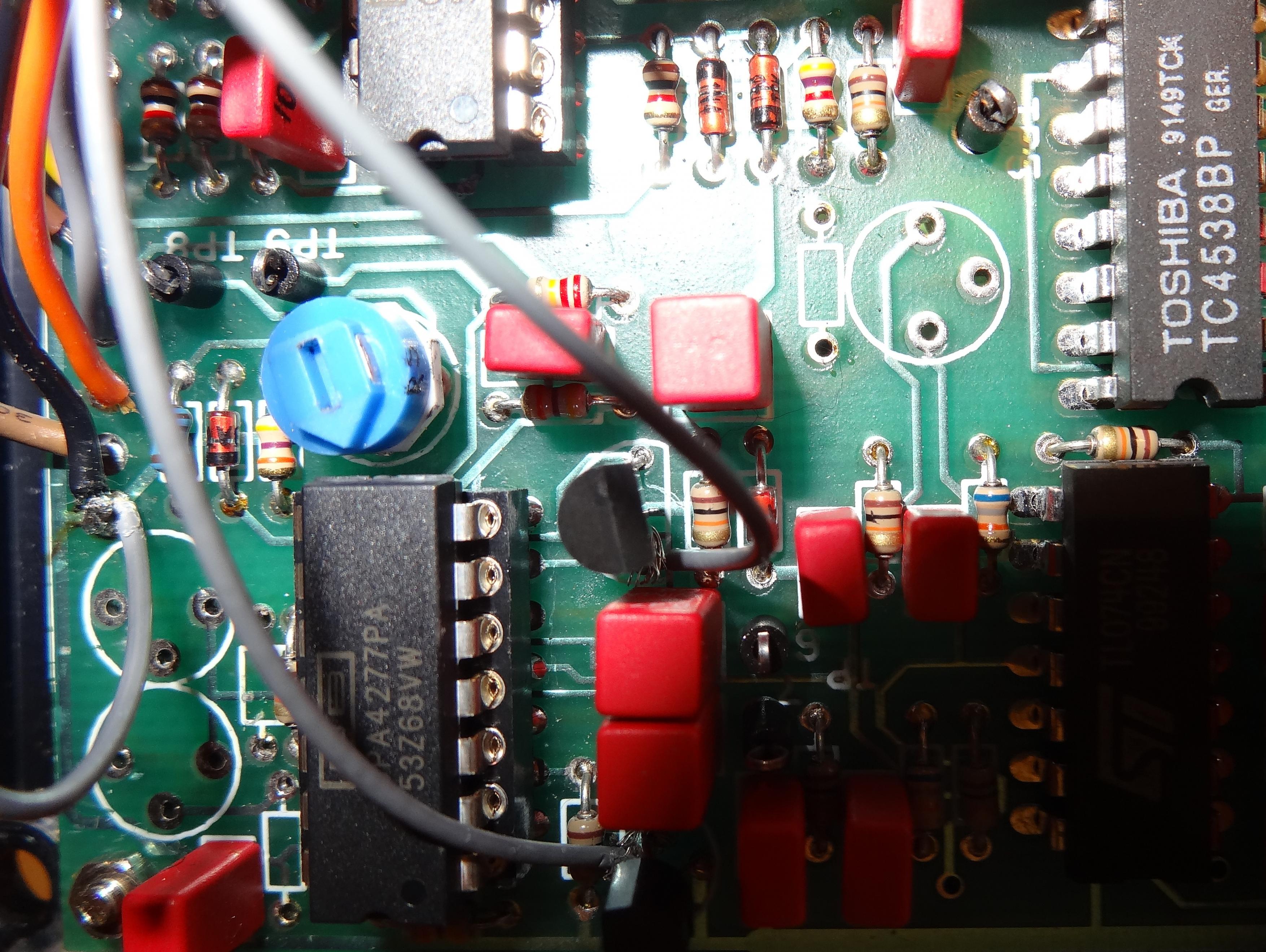

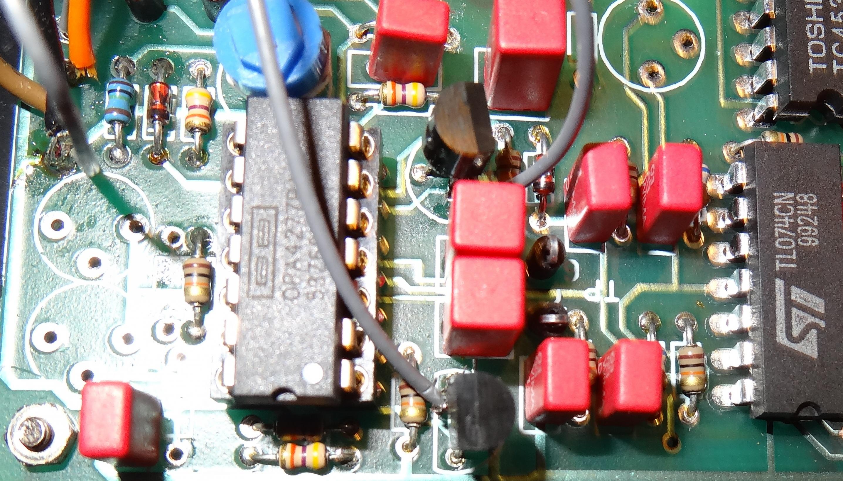

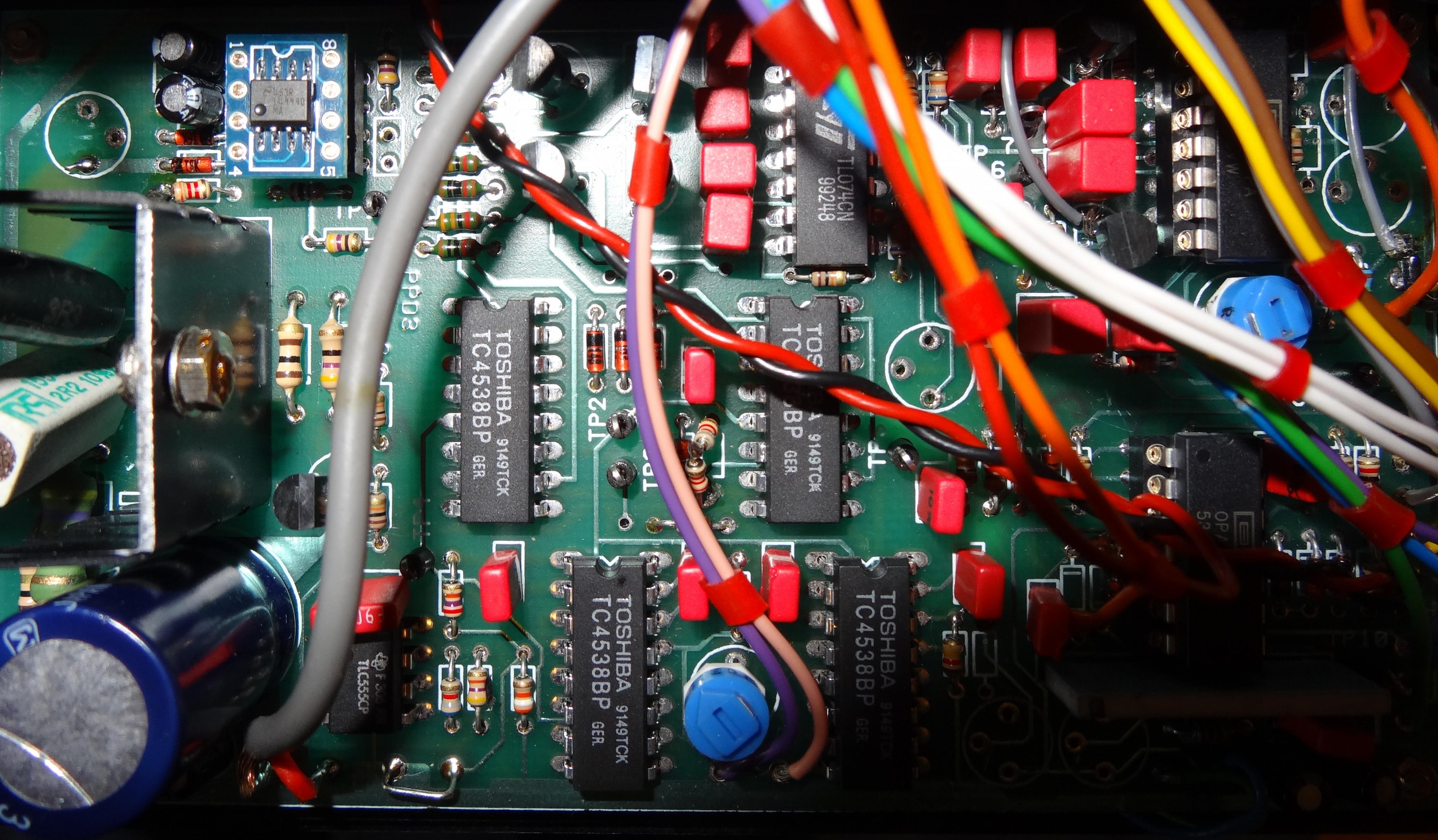

Pictures after modification
Here are some pictures. See how much parts I could remove because of no need for offset the better IC´s.

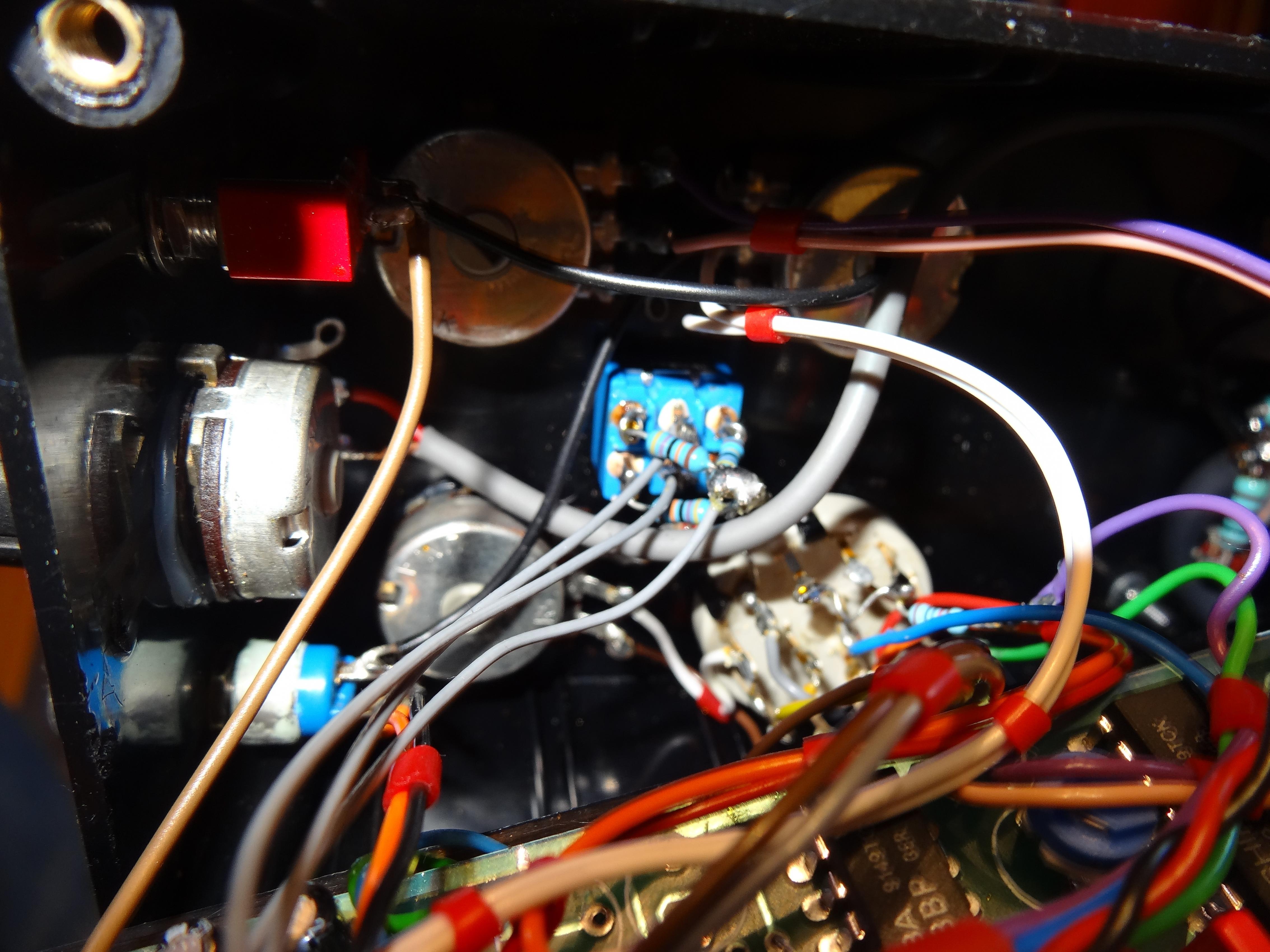

Motion Mod
Additional I have cluged in a switch for the motion-function of the Goldscan (470k Ohm parallel to J113)
It is a double 3-way switch. If you switch right, you have 470 k Ohm, if you switch left you have 4,7 M Ohm parallel to both J113. If you switch to the middle, you are in original non-motion mode.

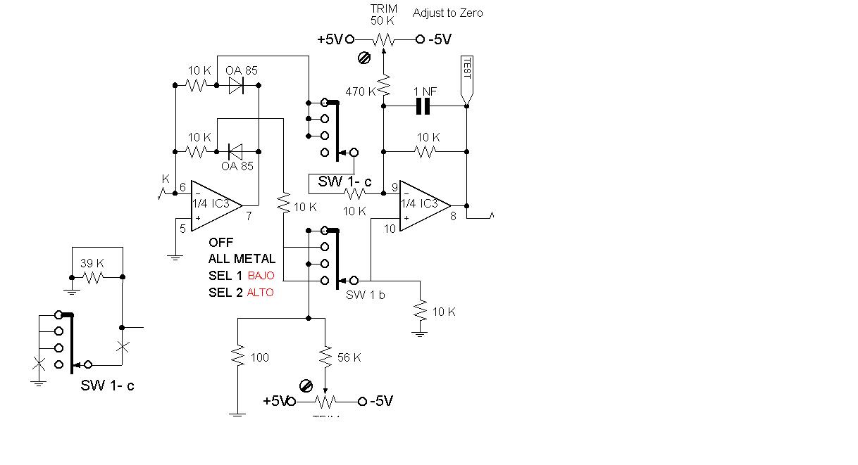

High conducter mode

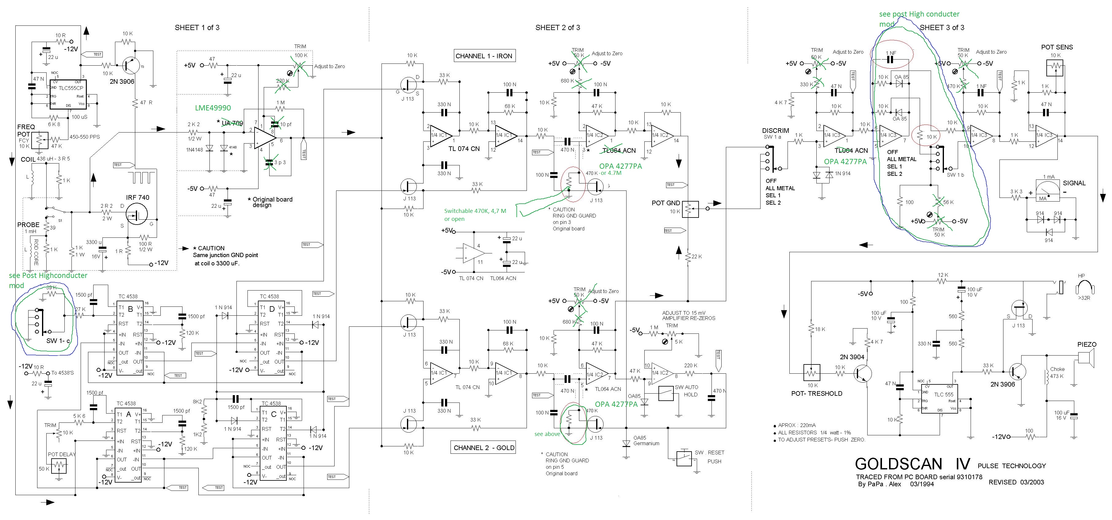

I will do it, wait a bit.Originally posted by Tim View Post
mschmahl, could you possibly upload an original schematic, with the omitted parts crossed out, and replacements marked?
I have also build in a sort of high conducter mode, with help of some ideas from jose.Attached Files
Here is the changed schematic.
One other Idea (not tested) is to make the reset with help of a CD4001 similar to the Goldscan 5. And I would like to have a two-tone signal generator, maybe with help of a CD4046. But than we have to rework a lot of the circuit.Attached Files

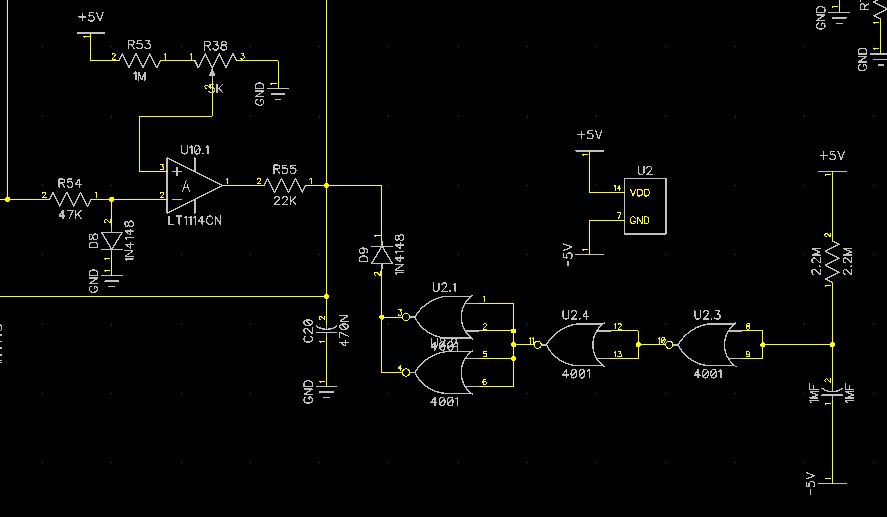

GS5 4001 This scheme works wellOriginally posted by mschmahl View PostHere is the changed schematic.
The published for gold escan 5 at the forum, it did not work for me.
Originally posted by mschmahl View PostHere are some pictures. See how much parts I could remove because of no need for offset the better IC´s.
I think Reg would be very happy to see that you followed his advice. Replacing those opamps with low-offset ones gets rid of so many trimmers and the tedious setup allied to them.
I don't think your motion mod is a cludge. Very neat work all around.
