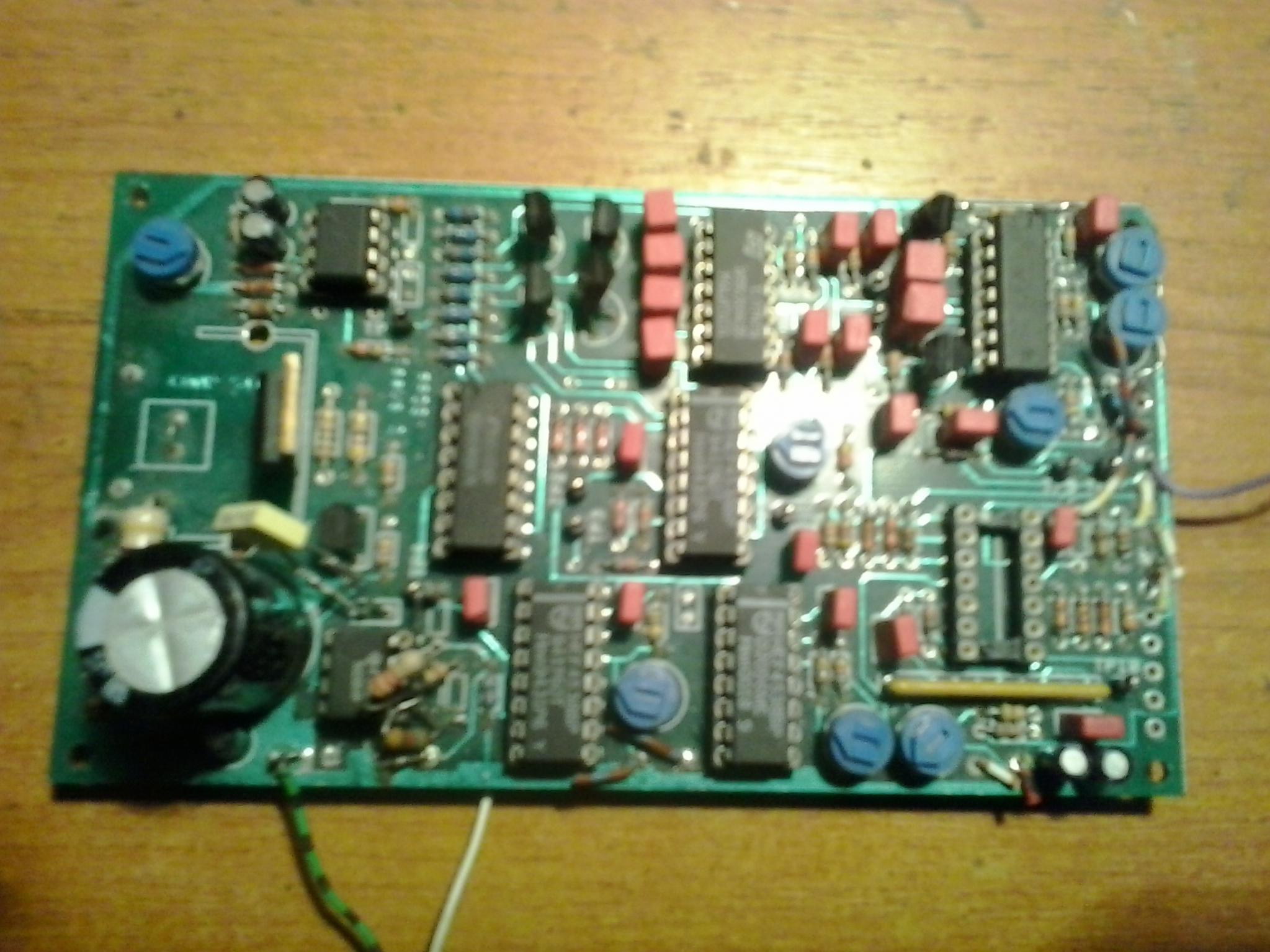

      Thanks for this scheme. The solution on the GS4 is ok if you use the 2x 470k parallel to J113´s. But without the 470k´s it could be an improvement.
      Originally posted by greylourie View Post
      I think Reg would be very happy to see that you followed his advice. Replacing those opamps with low-offset ones gets rid of so many trimmers and the tedious setup allied to them.
      I don't think your motion mod is a cludge. Very neat work all around.
      I think so! Thank´s Reg there are a lot of way´s to make setting up much easier without loosing much depth. With this opamps it should be more possible to build the GS 4 with more success.
      • #48
        Thank you for the details, Michael. I would love to see a video of your detector since you made the opamp upgrades.
        The accupack arrives me. What do you want to see? Disc or different non-motion settings, or anything else?

          I don´t have the 1NF installed that Jose mentioned.
          For using the minelab coil I have increased the frequency and build in a resistor in series to the coil with the existing resistor. So I have a shorter Pulse-on-time and reduced the heat because of the low coil R in the minelab coils.

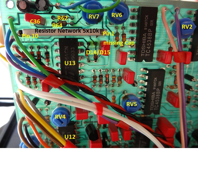

                Jose
                Hi Jose ! 1nf does not exist in the original gs4 scheme .
                • #53
                  Hello Orbit, it was not in schematic. But it was in original design. If you search forums, you can see photos with that 1nF capacitor.
                  http://www.geotech1.com/forums/showt...103#post127103
                  • #54
                    That this capacitor ? This is an original design gs 4 !Click image for larger version

                      • #56
                        That this capacitor ? This is an original design gs 4 ![ATTACH]37699[/ATTACH]
                        Originally posted by Jose View Post
                        Capacitor 1 nF, It was omitted apparently in scheme Papa Alex.
                        Jose
                        Sorry, yes this capacitor is in. I have forgot it. Had a discusion about it some time ago. Here is the picture, it is marked with "Missing cap", the slightly burned red cap.
Name:	DSC01171 klein.jpg
