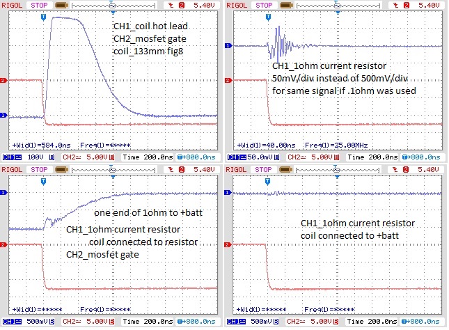

    Still looking at the current waveform by scoping a 0.1ohm resistor in the ground return from the coil, except that the coil is replaced by a 6.6 ohm resistor (3x 2R2), with the coax still in circuit. All the hash has disappeared and we have a clean couple of cycles of decaying ringing. Next is for the resistor to be straight on the board i.e. no coax. Still a ring but all decayed before 1uS. I measured the coax with the resistor termination and it gives a reading of 0.475uH which together with a capacitance of about 80pF may account for the extended ringing in the first plot. Perhaps my wrap around shielding contributes some additional ringing frequency that explains the additional 'noise' on yesterday's plot.
    [ATTACH]54465[/ATTACH] [ATTACH]54466[/ATTACH]

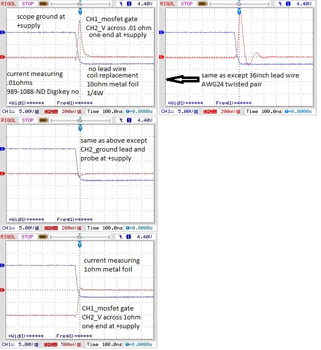

    Wondering if you could try a couple things the next time you are testing. Repeat of the tests with coil and 6.6ohm resistor you have done + repeat tests with scope ground lead and scope probe connected to same point(ground side of .1ohm resistor. I get the high frequency both cases with coil connected, wondering if you do or is my scope the problem. Need to get a .1ohm resistor and try with a resistor replacing the coil. I have been using twisted pair instead of coax so I need to try coax also to compare UCC27518 with what you are using.
      Hi Eric
      Tried test with what I have. Wasn't expecting the high current reading with the .01ohm resistor, calculates over 60A peak at turn off. Reads about 10mV(1A)when Tx on. Need a better current measuring resistor or something else causing the problem?

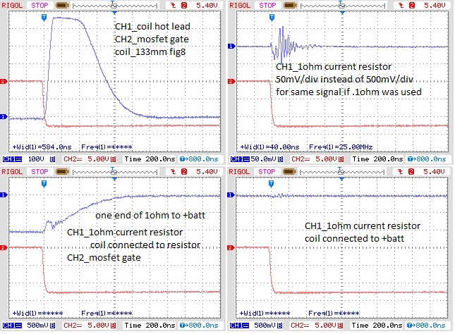

        Hi Green, I tried what you suggested and there is no difference in the ringing. I have tried shielded and unshielded coils and no difference. The flyback is 750V and is not avalanching. Spec gives 850V for Vdss. Scoping the gate shows a very similar ringing waveform to that on the 0.1ohm resistor, so maybe that is the cause. Further investigation needed as to why this is happening. The drive to the capacitor coupling is a TLC555. I tried an LMC555 and the result was the same. If I can find one, I will try a bipolar 555 and see if that makes a difference. The other thing to look at is whether a suitable zener in series with the gate/source diode will improve things. this will increase the hold off volts at the expense of drive volts as per the Texas paper. From the Mosfet spec I have about 3V in hand to do this. I can also try using direct coupling without the RC arrangement.
        This is really fine tuning things though. Even with the ringing it appears I could sample at 2uS but my present Rx will only let me sample at 5.5uS. I'm thinking of trying a series blocking circuit so that there are no large transients saturating the preamp.

          Thanks, What do you mean by no difference?
          I get an oscillation signal on the scope when I connect scope probe to scope ground lead and touch probe to +battery(noise signal). About 100mV p-p, with .1ohm resistor 1A p-p. To repeat your test with my Tx circuit I would have to eliminate the noise signal first and purchase a .1ohm resistor. Which I would try if the result would be different than doing the test with a 1ohm resistor which I have. Does anyone think result would be different? Think decay signal looks like it should with very little oscillation. Small drop in current while charging capacitance like I see with spice.
          Maybe to eliminate noise. Solder scope lead coax direct to .1ohm resistor?
          scope ground leads were connected to +batt
          MUR460 diode between mosfet and coil

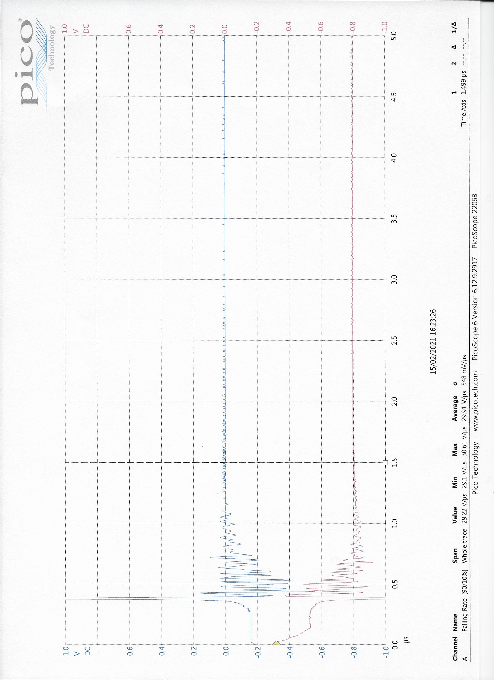

            I always use 0.1 ohm because the coil current is not materially affected and 1A gives 100mV. My coils are usually 5ohms or 3ohms depending on which wire I use. By no difference, I meant that the amplitude, duration and frequency of the ringing was not discernably different. Attached is a plot of the voltage across the 0.1 resistor in blue and the gate switchoff edge of the TLC555 as trigger and the ringing seen in red. Click image for larger version
ID:	359168. Which one causes the other?

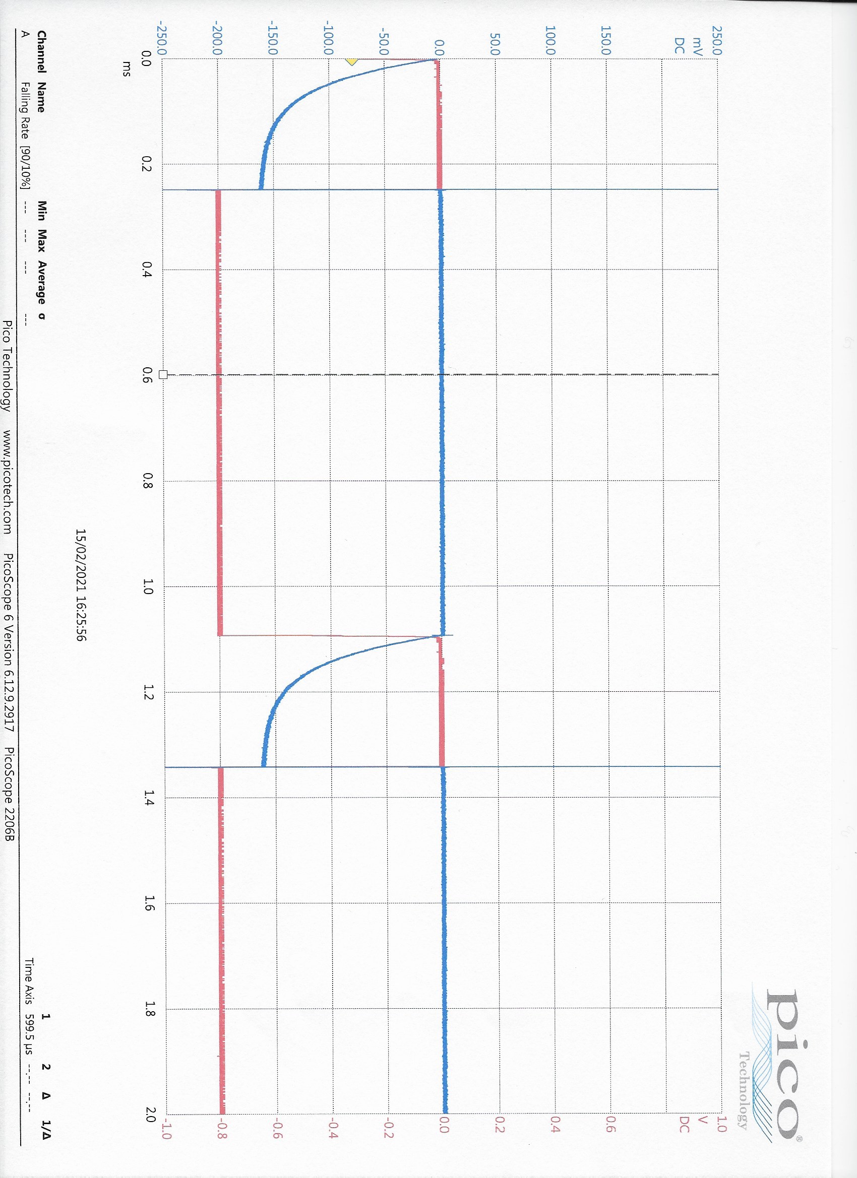

            The next plot shows on a slower timebase, two successive 250uS Tx pulses, peaking at about 1.6A in blue. The red waveform is the 8V drive pulses on the gate drive. Click image for larger version

              The ground lead on the scope can add ringing and other noise. This video demonstrates the problem. The second video shows a nice solution for the type of testing you guys are doing.
              https://www.youtube.com/watch?v=zodp..._channel=w2aew
              https://www.youtube.com/watch?v=-4q8..._channel=w2aew

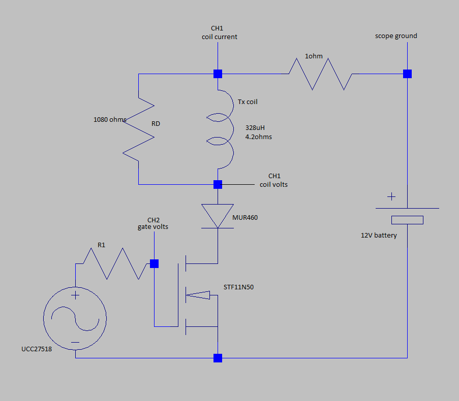

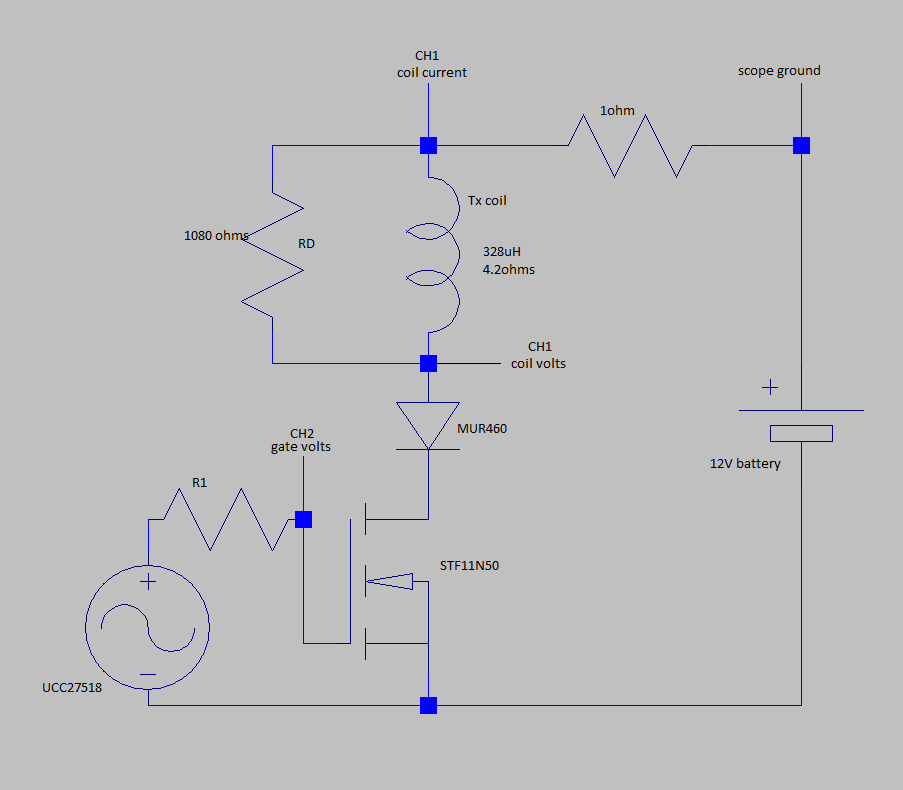

                        Still trying to understand how to determine required gate resistor. Including a schematic(mosfet driver4) of my test(mosfet driver3). Only mention of gate resistor I found in the UCC27518 literature The 2.4x overdrive capability provides an extra margin against part-to-part variations in the QGD parameter of the power MOSFET, along with additional flexibility to insert external gate resistors and fine tune the switching speed for efficiency versus EMI optimizations. However, in practical designs the parasitic trace inductance in the gate drive circuit of the PCB will have a definitive role to play on the power MOSFET switching speed. The effect of this trace inductance is to limit the dI/dt of the output current pulse of the gate driver. R1 my test is a piece of AWG30 wire about 1/2 inch long. What should I want the scoped decay curve to look like? What would you suggest for a value for R1 to try?
                        Forgot to include a 1u capacitor on pin 5 UCC27518 on the schematic. When looking in Digikey for information on STF11N50 I see it's obsolete, any suggestions for a replacement?
                          1_ I can't recognize any bad behavior with your decay curve, so not really sure to be honest.
                          2_for 11N50 for the worst case minimum is 32 ohms and for typical it's 20 ohms
                          maybe try 27 ohms
                          3_I found these for replacement with even better rise and Fall time, take a look
                          2SK3468
                          2SK3695
                          13N50 (not as good and it needs a bit more current than your driver can supply)

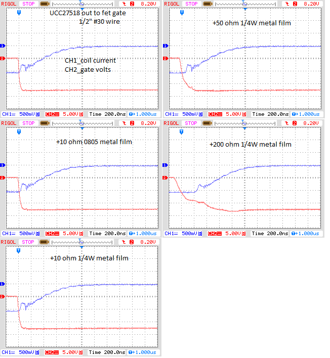

                            Was trying another test when Mr.Jaick replied. Tried different resistors(1/4W are thru hole, leads cut short)in series with wire between UCC27518 out and mosfet gate. Could try some different values if I have them.
                            Added coil volts with 200 ohm in series. Not seeing much difference with added gate resistance except for delay.

                            • #44
                              good test green
                              so i think it's safe to say the problem is not the gate ringing
                              maybe some sort of complex impedance happening at the first turn on moment in that RLC rabbit hole(coil, damping, diode and mosfet capacitance, connections and packages,....)
                              by the way why your gate voltage on the scope is reverse?
                              it's an N mosfet and current starts when gate voltage falls in your pics, why is that?

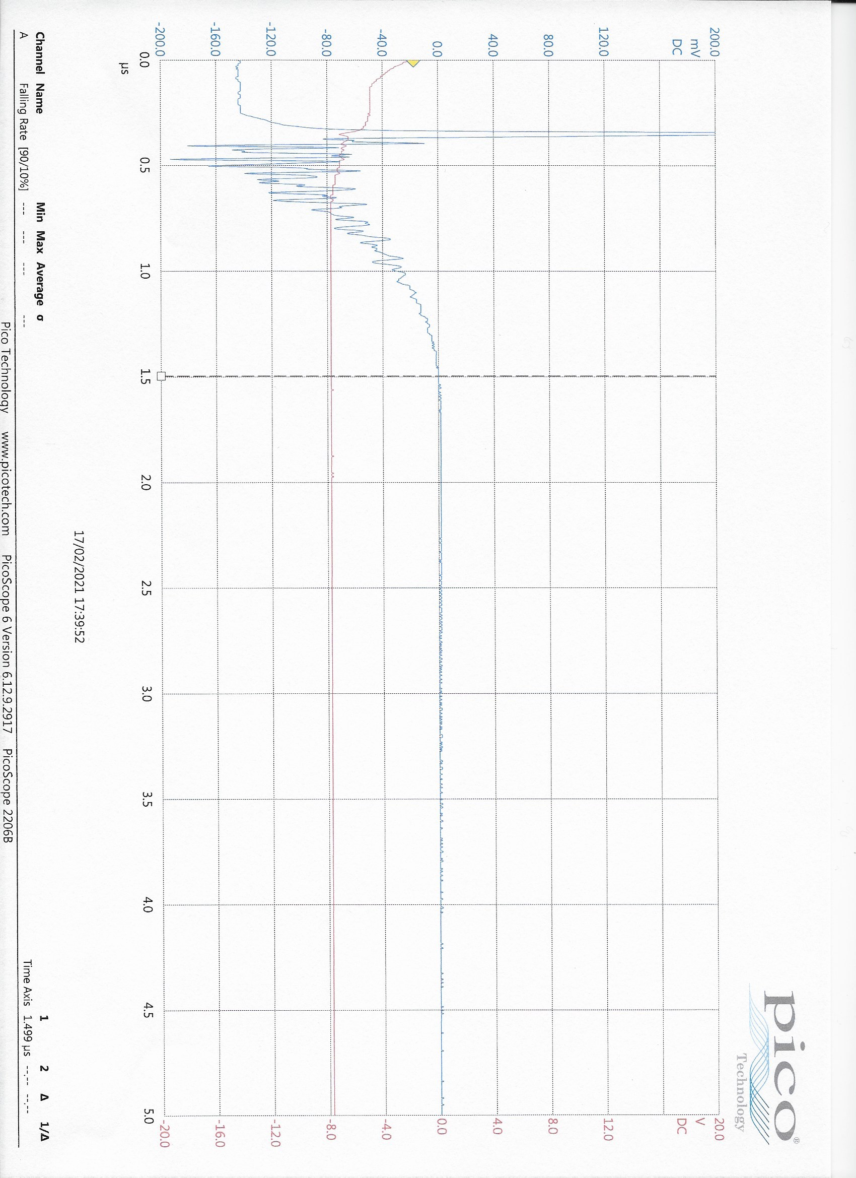

                                I made a fitting for the scope probe exactly as portrayed in the YouTube video that Altra recommended in post 36. This was directly across the 0.1 ohm resistor.
                                The TLC timer already had a 22uF tantalum bead across the pins to the 8V supply, but I added a 4.7uF thin film ceramic capacitor. The ringing on the tail of the switchoff edge of the drive pulse seems much less.
                                Ringing still apparent on the switchoff of the Mosfet as seen using the better probe connection, but does seem less.The large initial ring seems to coincide with the flyback peak at 0.4uS
                                I think I am going to accept the result as all seems clean after 1.5 - 2.0uS and I don't need to sample that early anyway. Instead I am going to look into ways of eliminating the slow recovery characteristics of the preamp.
                                One thing I might quickly look at is the same Mosfet but driven by a complementary emitter follower drive.
