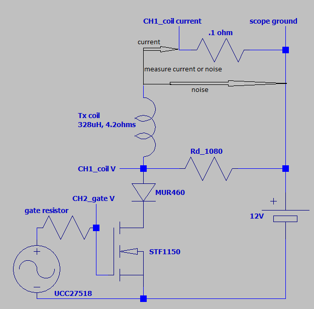

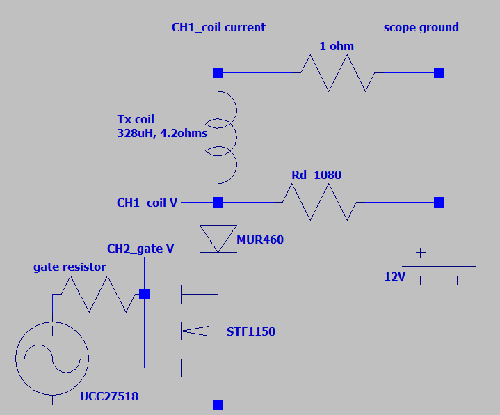

        • #49
          I see I put Rd across the coil instead of across the coil and the 1ohm resistor in schematic(mosfet driver4). New schematic(mosfet driver4a)
          • #50

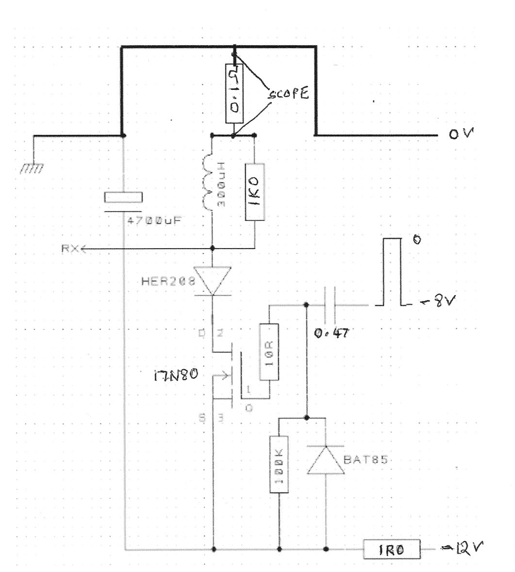

            This is the arrangement that I use. Click image for larger version
            The 300uH coil is of course shunted by its own self capacitance and the capacitance of the coax cable. My coil plus cable resistance is at the moment 5.6 ohms.
            Eric.
            • #51
              This is the arrangement that I use. [ATTACH]54502[/ATTACH]
              Eric.
              Hi Eric
              See your schematic has same error as my(mosfet driver4). Rd across coil not across coil and current resistor. Shouldn't show any Rd current if Rd is just across the coil. I had it across both when I did the test, just drew it wrong in the schematic.
              Couldn't convince my self what was right so a did a test with Rd both places. Need to play some more now that I see oscillation when Rd just across coil. Doesn't show decay current so I'm not sure it matters.

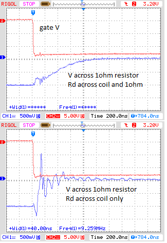

              • #52
                Hi Eric

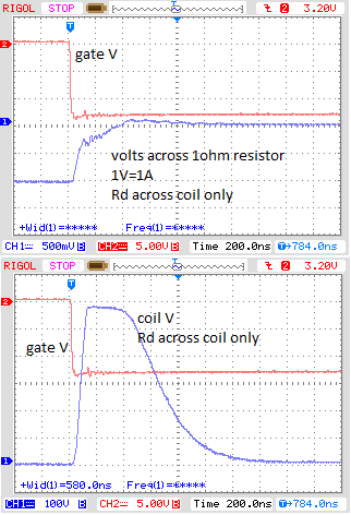

                Another try with Rd across coil only. Looks better, Rd clips on and I think wasn't making good connection last try #7.
                • #53
                  Hi Green, I always have used the circuit as in your 'Mosfet driver 4' and a 0.1 ohm resistor so that the coil current is substantially the same as without it. I can then see the coil current growth in the inductance; whether it is reaching its resistive maximum or still limited by the inductive growth; or in other cases how long it is flat topped. Rarely do I look at the fall time in detail, and particularly where the drive and current is approaching zero.
                  When trying to maximise the switchoff rate and reduce delay times, this area is more important and any spurious ringing should be investigated. I had this problem once in an industrial PI detector which failed an official emc test. it was tracked down to a long trace on the pcb from the pulse generator to the Mosfet. The high frequency ringing was also being radiated by the search coil. The layout was changed, the trace made as short as possible, and the detector then passed the test. On the pcb I have now, the trace to the Mosfet gate is about 10mm.
                  I have another pcb, identical to the one I have been using for these tests except that it has the complementary emitter follower drive. I will do the same tests on that one to see what the switchoff looks like. I have also arranged it so that I can plug in different Mosfets to compare.
                  On your coil voltage plot, it looks from the flat top, that your device is going into the avalanche condition.
                  Eric.
                  • #54
                    Tried again this morning. Appears oscillation(mosfet driver7)was caused by a bad scope ground connection not Rd connection. Tried with both CH1 and CH2 ground leads connected to +battery and with only CH1 or CH2 ground lead connected. Doesn't look good with just one connected. Would probably be better if ground leads were shorter.
                    Hi Eric, looks like we replied at the same time. My circuit does avalanche. With a fast coil it's going to avalanche or I need to use snubber. Haven't seen a difference in operation avalanche or snubbed. Probably need to snub if peak current is high, above 2A? Is your picture reply #45 Tx off? Where was Rd located reply #45?
                    Think it might be better to put Rd to +battery not across coil. With Rd across coil, volts across current resistor charging includes current thru Rd and coil(not a big error). Discharging, volts across current resistor only during avalanche. Rd across coil and current resistor, volts across current is correct for coil current charging or discharging.

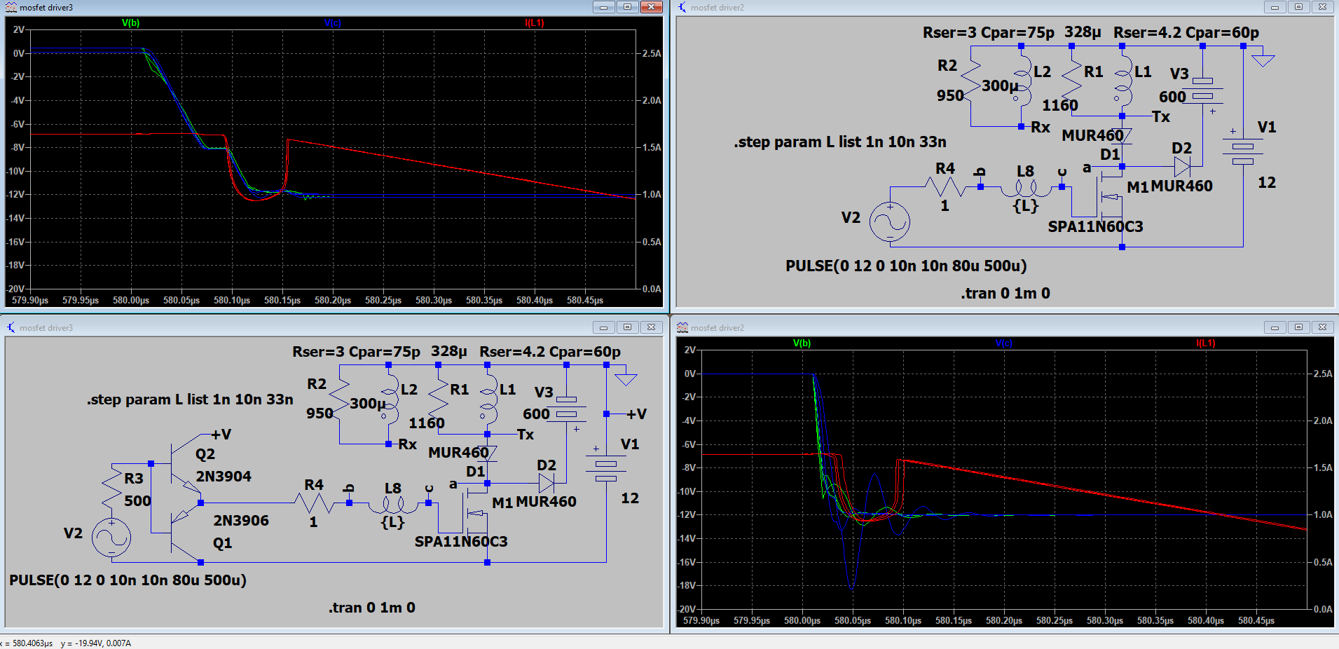

                              • #60
                                Tried stacked transistor drive in spice. Looks like it might work driven with a 555 oscillator at Tx supply. I need 5V logic command, probably stay with UCC27518 until I know more.
                                I see the circuit is in reply11, probably where I saw it.
