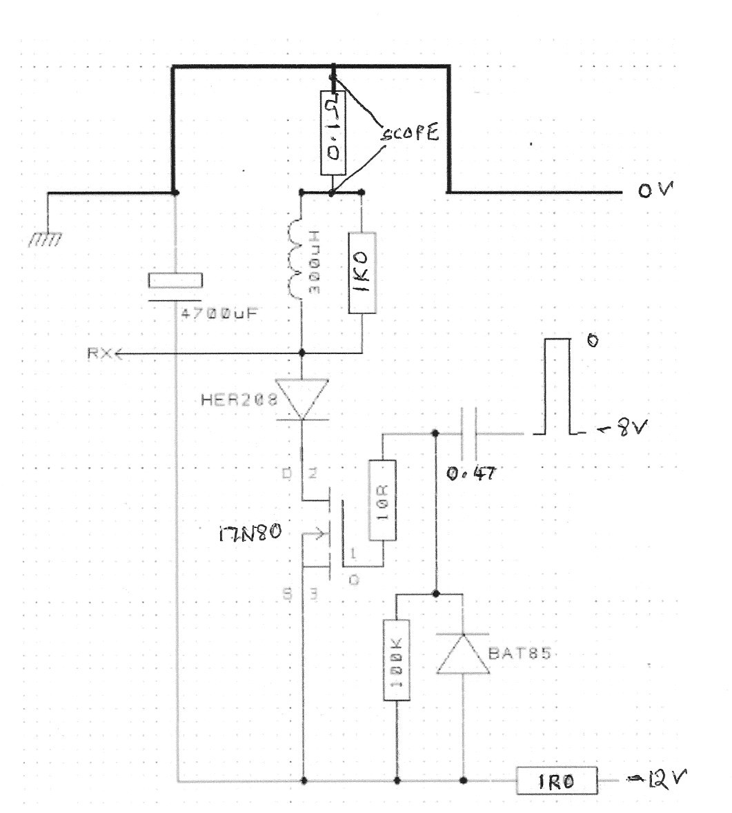

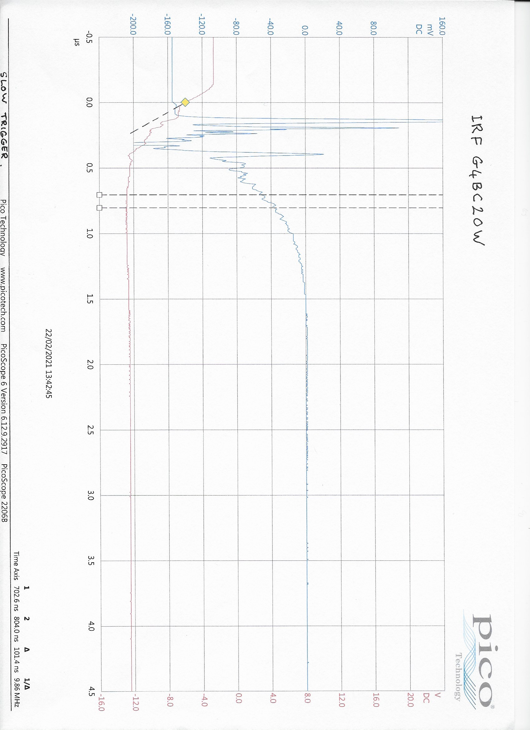

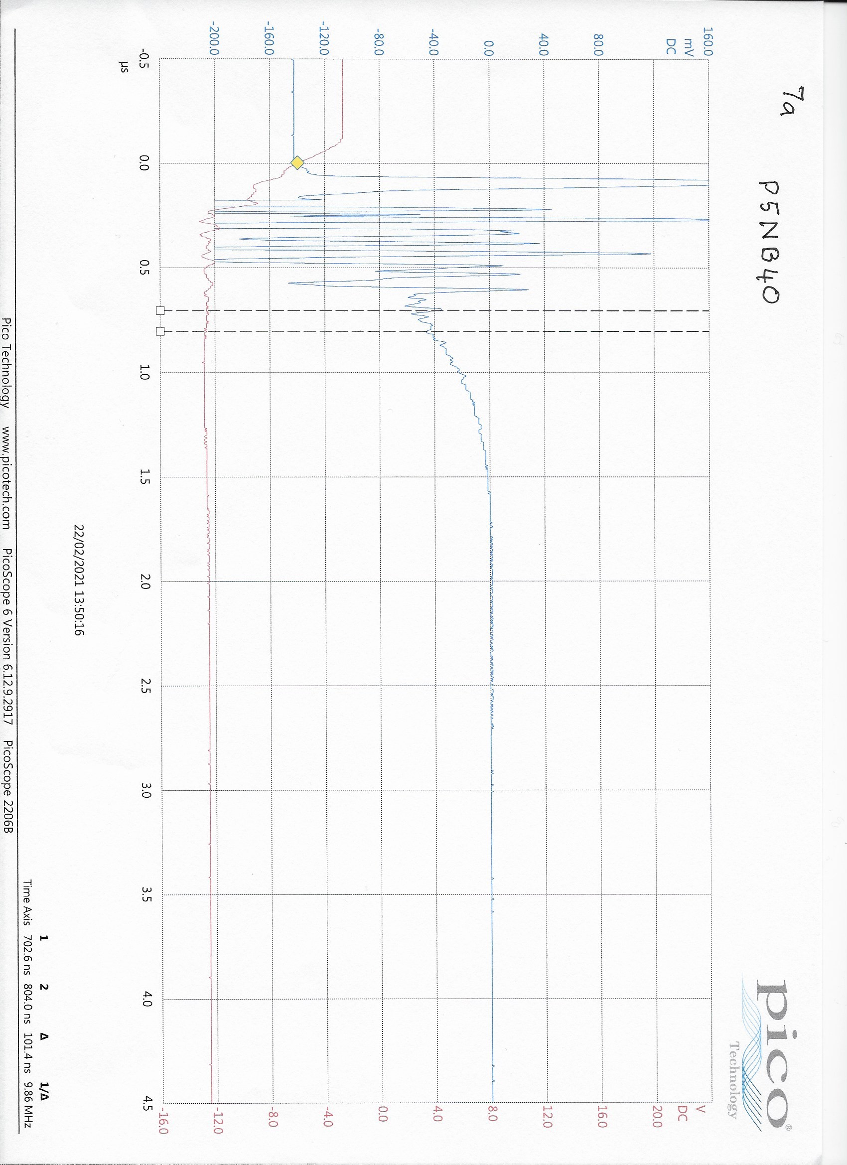

      I have now tested 12 different Mosfets in the test jig with scope connections as per Altra's video (2). Every Mosfet type gives a different result for the ringing and switchoff time, with the SPP17N80 not being the best. Maybe the typical input capacitance of 2350pf has something to do with it. The best of the twelve Mosfets was a P5NB40 with only 400-550pF of input capacitance. The tradeoff is the higher Rds-On of 1.5 ohms. The last device tested was an IRF G4BC20W which turned out to be an IGBT. I didn't know I had one of these, but the late Reg Sniff sent be a number of devices to test a few years ago and this was one of them. It gave the cleanest switch off of them all, settling down at 1.5uS, as did the P5NB40. Most of the others only settled at 2.0 - 2.5uS
      First plot is the P5NB40 and the second G4BC20W. The yellow square indicates the trigger setting on the falling edge, with the dashed line showing the pulse with the test device removed. I have now speeded up the drive fall time to 50nS but little change in overall waveforms. The cursors were set on an earlier plot to measure the ringing frequency, which is in excess of 10mHz, so it is not the coil/cable, which is about 1.0 mHz.

      • #63
        [ATTACH]54527[/ATTACH] [ATTACH]54528[/ATTACH]
        Eric.
        Your recordings show a reverse current spike of over 1.6A at start of turn off. Is current actually reversing or what is causing the reversal?
        • #64
          That spike corresponds to the flyback voltage which is of reverse polarity.

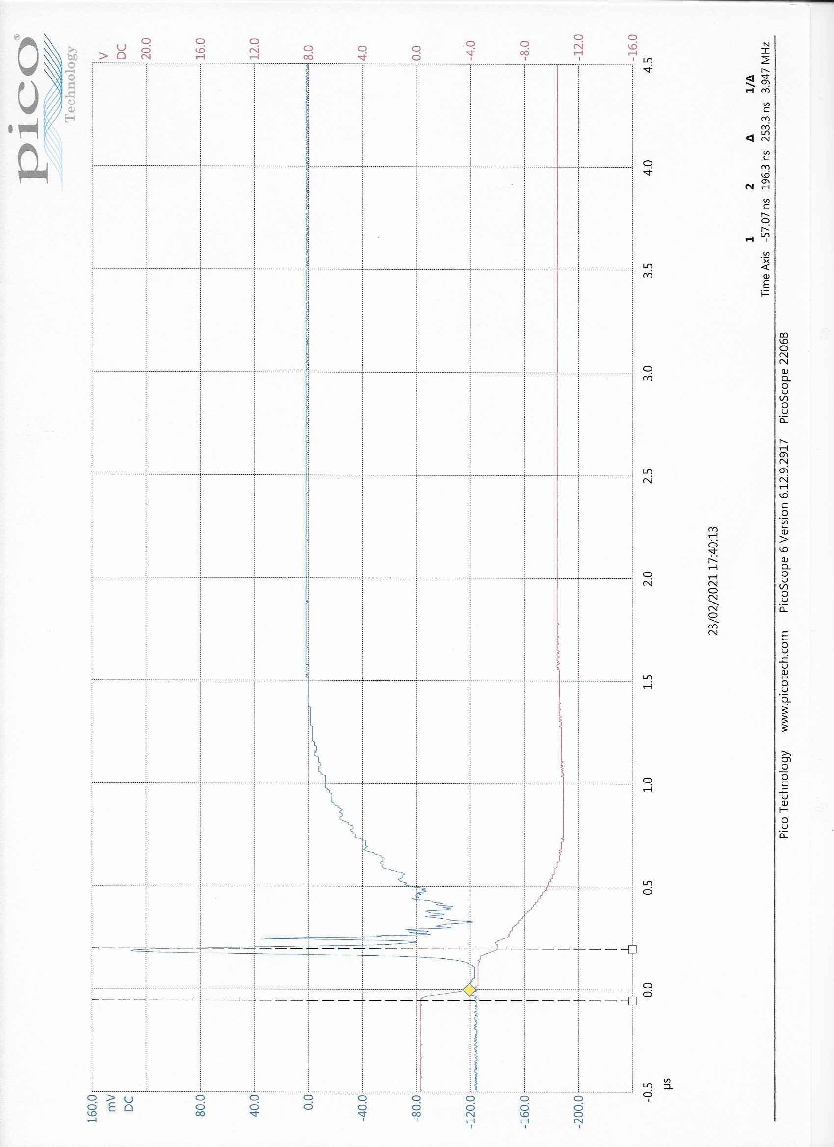

          • #65
            I'm gradually cleaning up the switchoff ringing as this plot shows. It is still the IGBT in the test jig and some ringing disappeared when I switched to a battery instead of the bench power supply. It cleaned up a bit more with a 4.7uF thin film ceramic capacitor across the supply to the drive circuit. The big spike is due to the back emf from the coil at the point on the downward slope of the drive pulse where the IGBT switches off. I suspect that some remaining ringing maybe due to the plug in method of holding the device with its full lead length, rather than cut off as it would be in a through hole pcb.
            Eric.

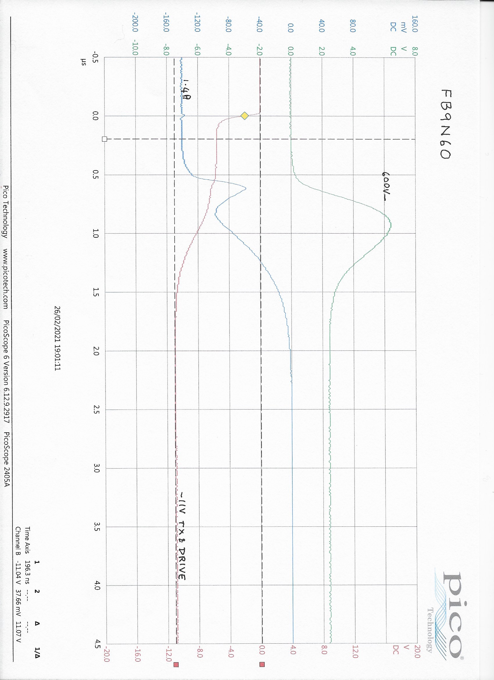

            • #66

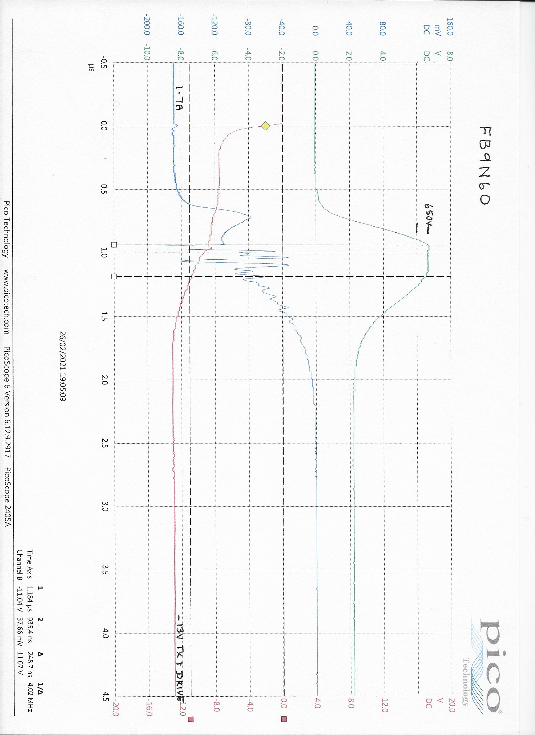

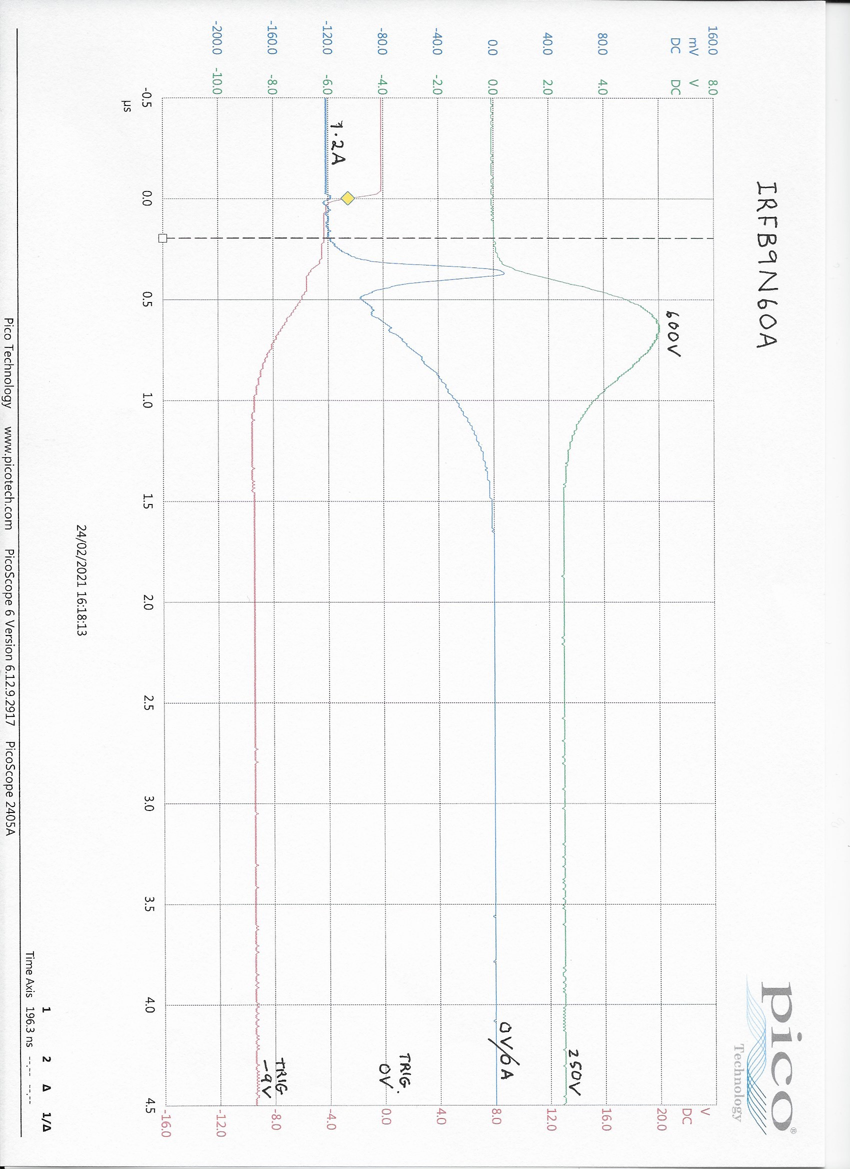

              Attached is the cleanest plot yet. This is for a IRFB9N60 Mosfet, which I had not tried previously. Click image for larger version
ID:	359238. Also, I thought that I had better check my previous statement that the short positive going spike after the switchoff was caused by the flyback emf. Employing three channels, so that he flyback voltage is displayed: now I am not so sure. The peak of 600V is offset a bit later in time than the short peak. In actuality the Mosfet switches off from the 1.2A level and slightly overshooting the 0V line, then appears to switch on again peaking at 0.9A and decaying to zero in the next microsecond. The measurement of the 600V was at the junction of the HER208 diode and the Mosfet drain. It decays to a level of 250V, dropping only slowly before the next Tx pulse. This reverse biases the diode to give minimum capacitance as seen by the coil.
              The supply voltage used was from a 11.1V Li-ion battery pack. Switching to my bench psu gave the same result, but, and this seems important, when I increased the voltage to 12V, a lot of ringing appeared. I then noticed that the Mosfet device was then in avalanche mode. Increasing to 15V and it was much worse. So, at the moment, the moral appears to be - avoid the avalanche situation. Also having too much drive voltage to the gate also induces ringing. I now have an adjustment to vary the gate drive amplitude so that I can go from just conducting plus 2V to make sure I have full conduction.
              Finding the best Mosfet for a fast switchoff seems anything but easy. However, what I have now seems to have settled down for times >1.5uS. Next job is a fast preamp.
              Eric.

                Hi Eric, still trying to understand how you read non avalanche current with Rd connected across the coil. https://www.geotech1.com/forums/atta...2&d=1613682600 Then I saw the line to Rx. Maybe you are measuring the current thru Rin and avalanche current not current thru Rd?
                • #68
                  Non avalanche current. Wasn't thinking about current flow thru series diode when coil volts was increasing at turn off, charging drain to source capacitance?
