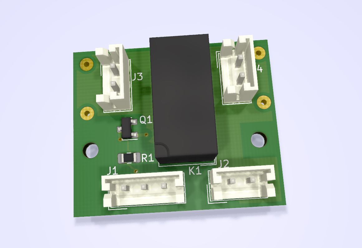

      • Here is the modified Probe_Switch Pcb KiCad layout JL.
        Probe_switch_2.zip
        J4 would not be loaded, rather tinned copper wire from 5 pin connector to J4 pads
        Also the 5 pin connectors will be mounted to a panel that will be held in place with 2 diagonal placed screws. I will do this tomorrow.
        If the Probe_switch board is mounted elsewhere, we have 2 x mounting holes.

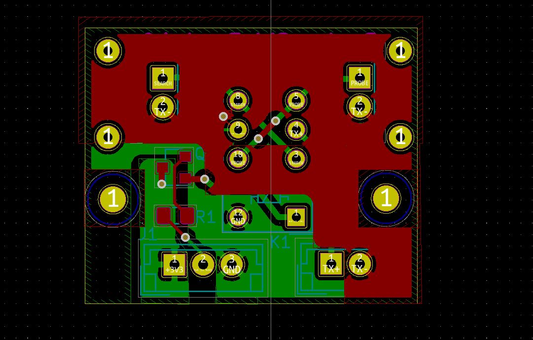

        • Updated PCB to extend rear ground plane and added isolated solder pads for fixing tin copper wire to pins on 5 pin coil/probe connector for stability.
          Needs a sanity check and if all Ok and you are happy with it JL, I will place an order.
          Probe_switch_3.zip

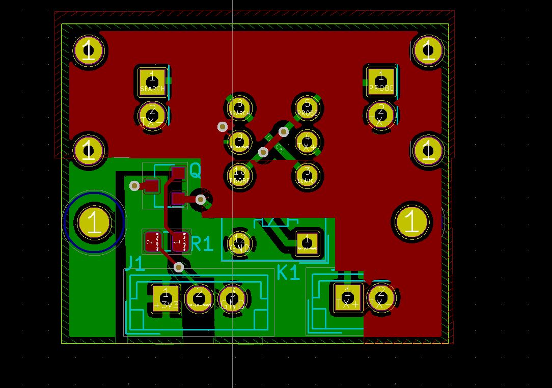

            Will the filled areas (especially the top side) pose a problem for the mounting screws? Otherwise, I see nothing wrong.
            On the FPGA side, I have confirmed that the CIC sample filter is not functioning... no signals... as if it is not being clocked. For the life of me, I cannot find anything wrong. The sim works perfectly. Tomorrow, I will rebuild the TX_RX ip from scratch and see if it clears up.
            • Probe Switch
              Good point, with a 3D printed case, no, however with a metal case, yes.
              I have modified the board to have screw head clearance top and bottom.
              Probe_switch_4.zip

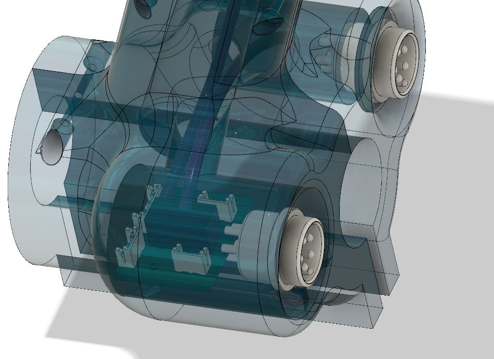

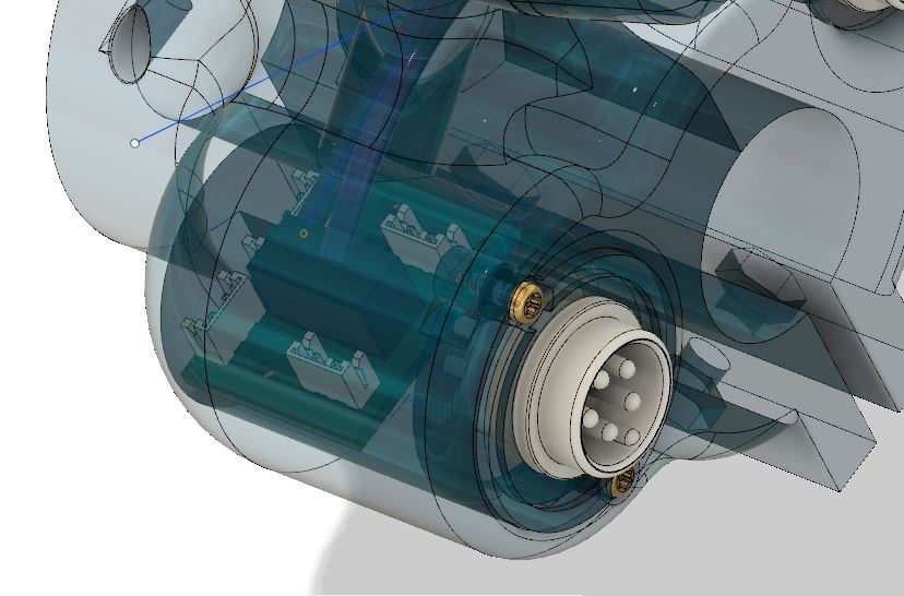

              • Originally posted by Mdtoday View Post
                Also the 5 pin connectors will be mounted to a panel that will be held in place with 2 diagonal placed screws. I will do this tomorrow..
                Here is the Coil / probe connector bay panel.
Name:	Coil_Probe_5 pin panel_1.JPG
                It is a slip fit with 2 retaining screws and a recess for soft O ring.
                I will finish off the other side in next day or so, then put it aside and concentrate on loading and testing the power module circuit and other assemblies, then come back to to the enclosure (s) with fresh eyes and double check, then do the first of the prints, for the whole assembly..few hours in this lot...

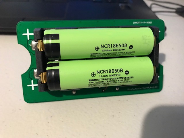

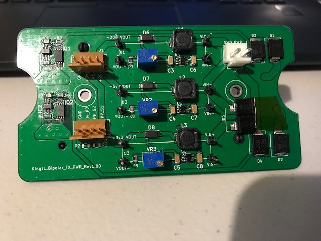

                    I have built a couple of versions of the power supply boards, one with MT6308 modules, the other with same parts as the modules discretely loaded on the board.
                    The good news is that all of the protection circuit works up to 2.5Amps, reverse polarity,UV,Short,Ov etc all good.
                    The bad news is that I missed a net from wiper to pot CCW which prevented output adjustment...added short link on pots , all good. see updated schematic--- KingJL_Power Module_rev1_20.pdf
                    The other main issue is one of noise and voltage regulation at load.
                    Both MT3608 modules and on board circuit exhibit the same problem at lower input voltages ~3-4v.
                    No load ripple is horrendous. I was expecting 40, 50 maybe 70 or 80 perhaps even 100 or so at load but none of the outputs were less than 230mV PP no load.
                    Replacing all caps with ones I know are low ESR reduced it to 180-200 but still quite bad.
                    On the regulation side and running from LIo batteries, the 20v output, the highest current I could get without dropping the output voltage more than 300mV was 50mA.
                    The 3v3 output modules had 2 standard diode in series to its input to drop the voltage low enough (2.9v) to get the boost required.
                    Unloaded regulation was fine, loaded with 75mA the output dropped to 2v.
                    The 5v output faired much much better, with 3.2v input and loaded to 800mA, the output voltage dropped to 4.95v, still not good but better.
                    All tests were repeated with both bench power supplies and Lion batteries as well as bypassing the protection circuit to confirm it was not the source of the problem.
                    Modules were also tested individually on the bench with resistive loads , same results.
                    Now I know I can improve the layout, tighten things up, thicken tracks etc, that will help but either I have dodgy components on 6 boards (discrete and purchased modules) or these things are highly over-rated current wise.
                    The 3v3 output would be best achieved I think, by using the module to step up from the 3-4.2v input to 5v where they are more stable and then using a LDO 3v3 linear regulator. LT have devices I use quite often which would do the job.
                    Of course, its entirely possible I have missed something obvious as I have only spent a couple of hours testing today so will have another look over the weekend.
                    • Actually, the obvious thing was sitting down reading the specs of the MT3608, at low input voltages like 3v efficiency is more like 80%
                      The board designs have to be a whole lot tighter to have any chance to get near their specs and realistically, perhaps 800mA-1 Amp are more reliable limits.

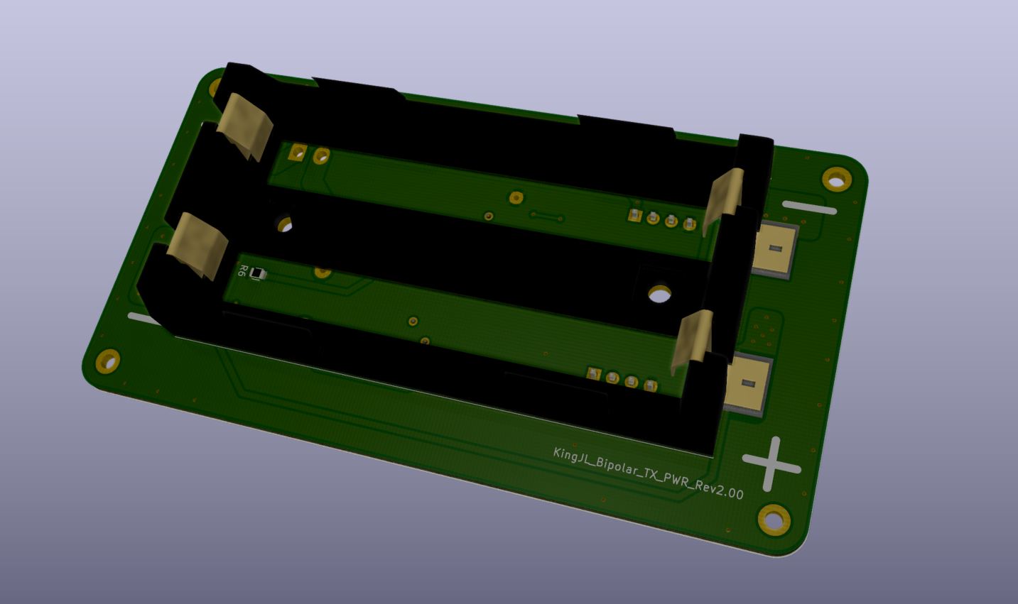

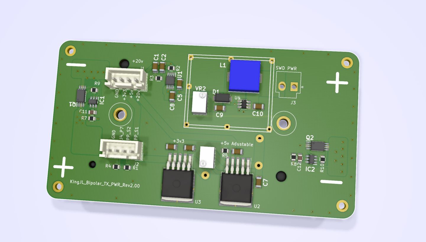

                              • I have been busy with testing the power supplies and redesigning the power board for lower noise.
                                The MT2608 modules have a less than optimum layout, so I have reduced the switching current paths to minimum with an on board circuit and dropped the option for modules
                                Here is the latest schematic. KingJL_PWR_Rev2_00.pdf, I have used low noise LDO regulators LT1963AEQ which are me-too type available from LT, TI and 2 other manufacturers.
Name:	KingJL_Power board_Rev2.JPG
ID:	354820 still some tidy up to do and then sanity check
ID:	354821 Enlarged the pads on the battery holder footprint as I had to trim the SMD tags on the actual holder to fit Rev1.00 board. Added 4 mounting holes and removed cut-outs on board sides.
                                The batteries are now back in series and using 2 LDO linears for 3v3 fixed and 4.5-5v adjustable supplies. JL, I have stock I can send with the boards and will also load some boards some for you too.
                                Ill do some more work tomorrow and post Kicad files, then order boards after sanity checks.
                                The switch mode has provision for shield which helps with radiated noise. The TPS7A49 works well as the post regulator for the switcher and is optimised for High PSRR up to about 400kHz, the MT3608 is 1.2MHz and while the test board showed a huge reduction in output noise and PS ripple,it may not be so on the finished board, it should be , but we will see.
