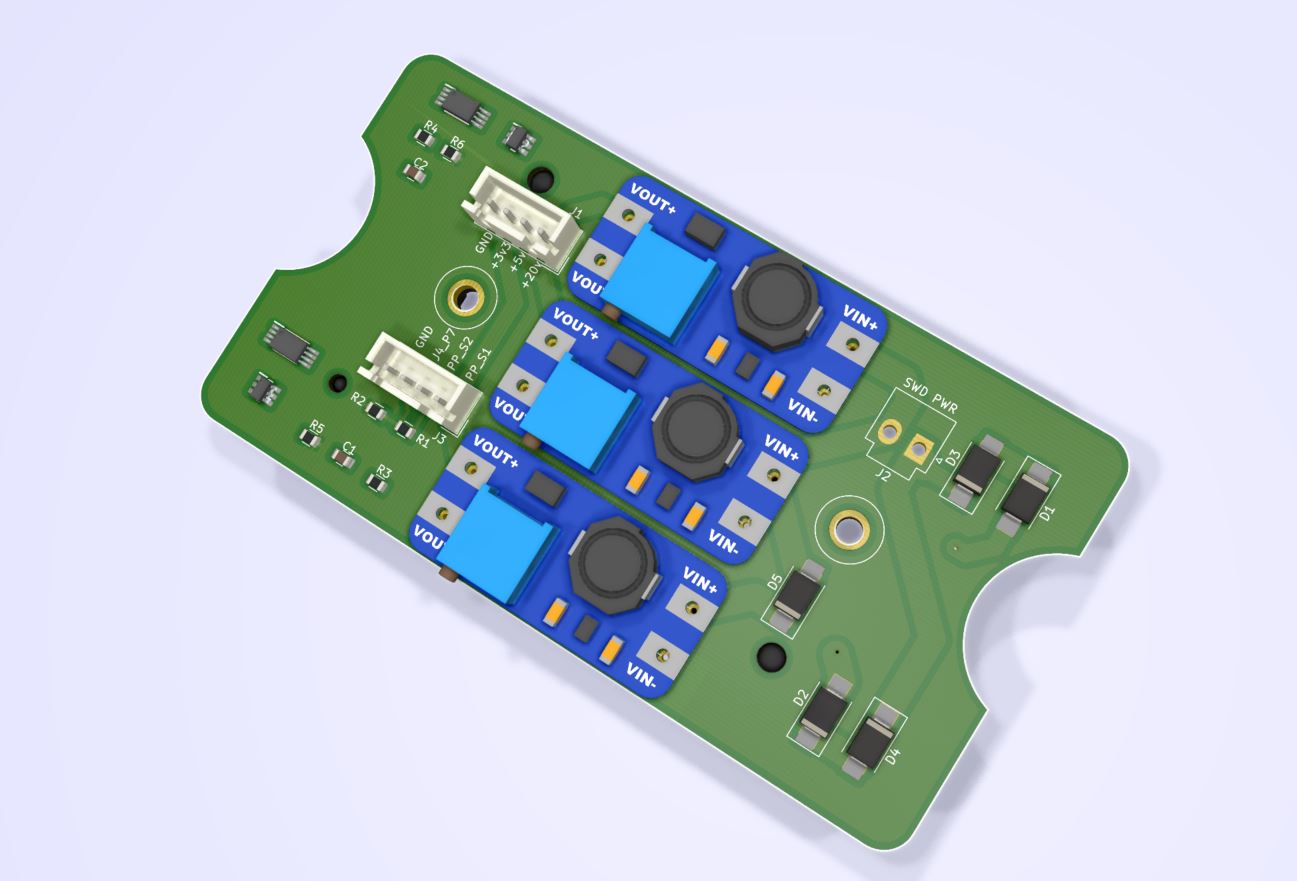

        Here is the general layout for added protection circuit Click image for larger version
Name:	KingJL_Power Module_Bat Protection1.JPG
ID:	354729 hopefully shows up.

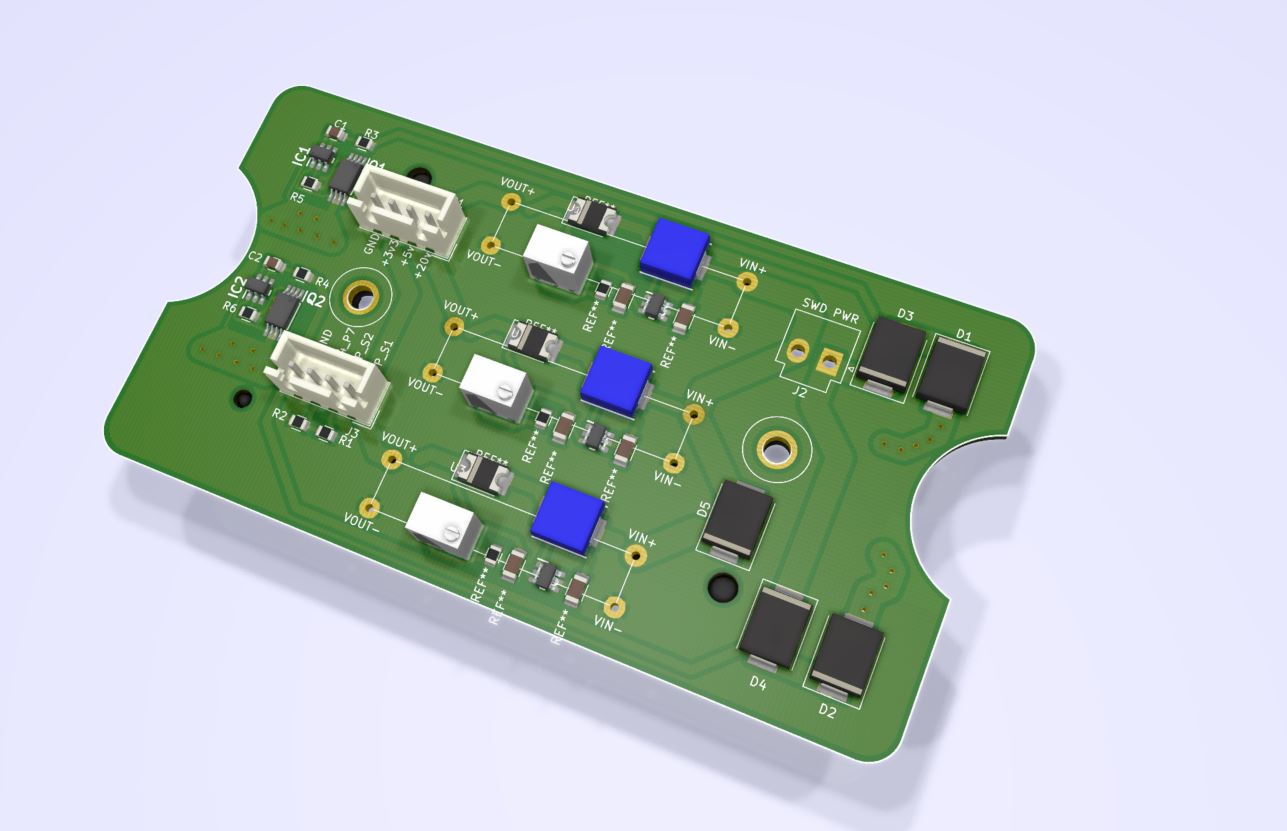

        • I have added an option to the power board to mount either MT3608 modules or mounting the same circuit idea directly on the board.
          There were 2 reasons for this, one was to allow for easy preset of the output voltages with vertical mount trimpots, the other was the delivery time 3>6weeks for the modules and the cost here in Australia from local sellers has been rising.
          With plenty of space on the PCB, I thought it was worth it and the actual low cost of parts from LCSC made it more so.
          • Here is the latest schematic version of the Power/Bat protection PCB (untested..still waiting on parts and modules)
            KingJL_PWR_RevB.pdf
            I will post the final Kicad files once all is tested and confirmed working ok.

              I have used the MT3608 modules in my latest Magnetic Viscosity Meter and encountered a couple of problems. Yes, it is boost only and can only be set to higher voltages than the input. My first problem was noise, both radiated and conducted. The conducted noise was reduced to an acceptable level by adding 10uF ceramic through hole capacitors across input and output pads. There are supposedly 22uF already on the board, but I found on a couple of boards they were only 10uF so it is worth checking. Radiated noise comes from the inductor on the module and I had to put the whole module in a small metal screening box to prevent this. Noise levels appear to depend on the amount of boost required and I ended up with a 11.1V three cell Li-ion battery back by Ansmann and boost up to 15V which the TX on the MVM requires. Other lower voltages are obtained from linear regulators. I blew a couple of MT3608's by having it charge a TX reservoir capacitor on switch on, so be careful in this area.
              Battery protection is important as I found out the hard way. Inadvertently leaving the MVM on caused unrecoverable death to a couple of earlier single cell versions. As the input voltage falls the module attempts the keep the output voltage constant, hence more and more current is drawn from the battery, hastening its demise. The built in protection on the Ansmann pack just switches the battery out of circuit when the voltage falls to around 2.9V per cell as well as protecting from overcharge current.
              Great work on this project between the two of you.
              Eric.
                I have used the MT3608 modules in my latest Magnetic Viscosity Meter and encountered a couple of problems. Yes, it is boost only and can only be set to higher voltages than the input. My first problem was noise, both radiated and conducted. The conducted noise was reduced to an acceptable level by adding 10uF ceramic through hole capacitors across input and output pads. There are supposedly 22uF already on the board, but I found on a couple of boards they were only 10uF so it is worth checking. Radiated noise comes from the inductor on the module and I had to put the whole module in a small metal screening box to prevent this. Noise levels appear to depend on the amount of boost required and I ended up with a 11.1V three cell Li-ion battery back by Ansmann and boost up to 15V which the TX on the MVM requires. Other lower voltages are obtained from linear regulators. I blew a couple of MT3608's by having it charge a TX reservoir capacitor on switch on, so be careful in this area...
                Eric, I remembered your experience with the '3608. I included a lm317 current limiter circuit in the source path of the 5V (where there is a 4700uF resevoir). Thank you for your comments. BTW, I have been ordering enough parts to populate 2 sets of boards. I owe you so much for the opportunity to study and learn from the Vallon.

                  I received the relays today. I will provide the dimensions and maybe a prelim schematic for the probe relay circuit. I do not know where we are going to put it. It will involve the relay, 9 connections (3.3v, GND, control line from PMOD, and 2 connections each for probe, search coil, TX board). It also has minimal circuitry consisting of damp resistor for the unused coil, current limit resistor for Pmod input, and 2n3904 relay control transistor.
                    Yes, thanks for the input on JL's project Eric and good points, perhaps we can change the inductor footprint on the on board circuits to a shielded version which is what I generally use and add some touch points for a tin shield on top side ground plane just in case.
                    nickle spray on the internal inside wall between battery bay and main electronics enclosure would help too.
                    I will be able to test the whole power module including battery protection sometime this week.
                    Cheers
                    Mdtoday
                      Excellent, perhaps, we can include that on the power board as an option and still do a separate small board, this would probably depend on coil wire separation from switch-mode supplies.
                      If on its own Pcb, it could be mounted on rear main electronics wall.

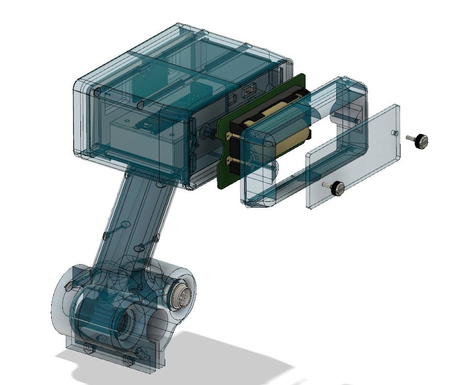

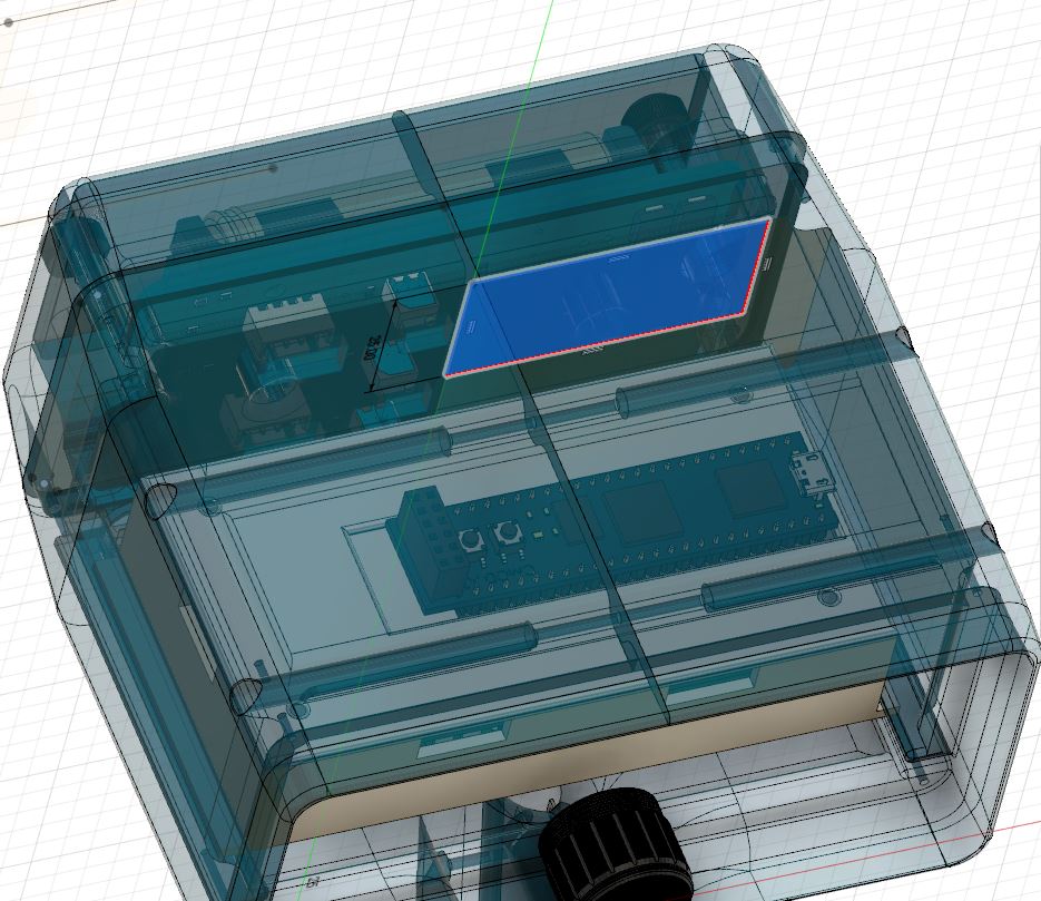

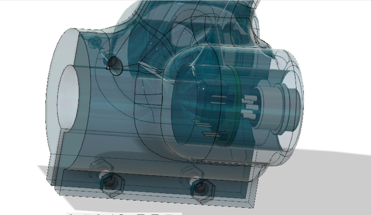

                      • I have modified the rear of the main enclosure to allow for better access and assembly of the power/battery module.
                        Prior to this change, the power module needed to be installed before the 2 halves of the enclosure were screwed together, not a good solution, if repairs were needed.
Name:	KingJL_Main enclosure_Bat_Rear1.JPG
                        Also JL, there is room for another PCB 25 x 50mm in this area Click image for larger version
ID:	354741 and I am fairly certain there is room on the power module to mount same components as an option.

                            • Originally posted by Mdtoday View Post
                              Ok, Thanks JL, I'll take a look at those files and see how we go.

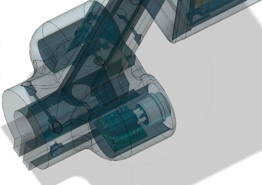

                              JL, I have come up with 2 position options for your probe switch circuit.
                              I modified your original to add 2 mounting holes and another round version which is mounted in the search coil/probe connector bay.
ID:	354754 Click image for larger version
                              Will do some more work later tonight.
                                [ATTACH]47244[/ATTACH] [ATTACH]47245[/ATTACH]

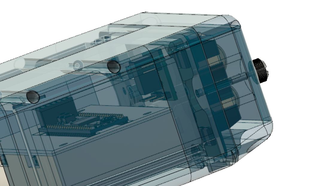

                                Thinking on this more, with a little more modification to your original Probe switch layout JL, we can use 1 version to fit both areas outlined in last post.
                                May change standard header with JST latching type if they fit height-wise, existing header will still fit if preferred.
