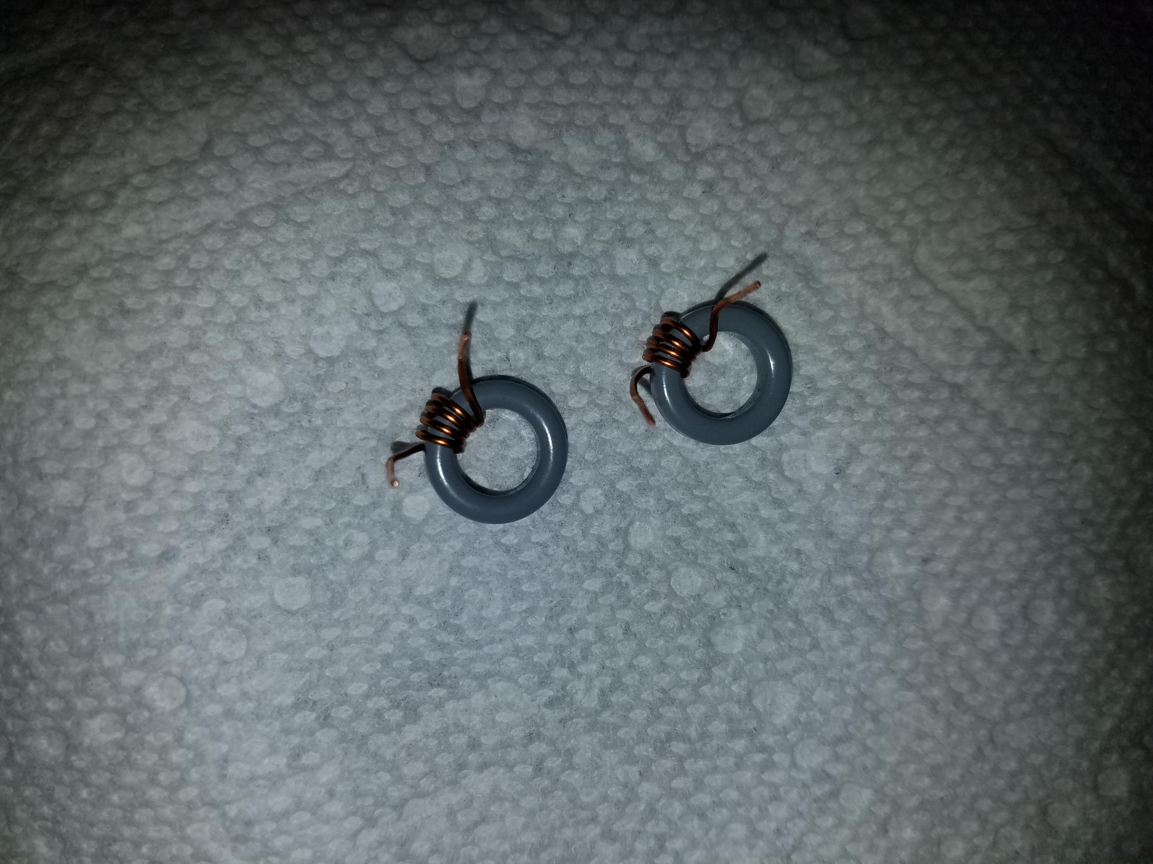

      • Toroid Ferrite Core
        I recevied various cores that I ordered to find one suitable for the Bipolar_PI. I had ordered 24mm and 22mm of J type ferrite (ui=5000), and 12.7mm of type W (ui=10000). The 24mm and 22 mm cores are too large to fit on the current footprint of the Bipolar_PI PCB. However the 12.7mm is the perfect size, both in diameter and height. Five turns on these cores calculates to 68uH which is the target range I was looking for. At a 4:1 secondary to primary ratio, a secondary of 20 turns = ~1100uH. With the new core, the secondary damping resistor ( R24, R30, R34, R39 ) should now be 810 ohm (vs. the current 1.5K). The charge holding resistor ( R25, R31, R35, R40 ) should now be 10 Meg ohm. The charge holding capacitor ( C29, C32, C35, C3 ) should now be 4n7 or 5n6.
        I am going to wrap the primaries with AWG 22 tonight and check the inductance. I am waiting on a shipment of AWG 28 enameled magnet wire to wrap the secondaries.

              JL, thanks for sourcing a standardize core.
              After following your's and MdToday's toroid experiments. I realized something was wrong with my thinking. The following is based on the cheap common mode chokes from ebay. First problem, I had my scope grounded to virtual ground. This was superimposing a 5v logic signal on to the floating GS signal. Once I put the scope ground on the source and the probe on the gate, I got a nice signal. Second problem, my mosfets have a max GS voltage of 20V, so the 4:1 ratio was too hot. Fortunately none of them were damaged. Out of four working Tx boards, one was perfect. It generated the highest current and voltage. I measured the GS voltage on each driver, all were about 10V. The toroids on the good pcb had a ratio of 2:1, 14t secondary and 7t primary. I had tried the 2:1 ratio multiple times with poor results. So I unsoldered all the toroids and measured the secondary all measured below 1900uH. Then I measured the 30 unused chokes that I have. These ranged from 1750uh to 2600uh. Out of these I selected 4 chokes with the lowest inductance. Winding 7t of 24 awg and leaving one of the original 14t windings. Next these were installed on one of poorly working Tx boards. The new toroids restored Tx operation to full output. Also the series resistors on the primary were changed to zero ohms. The core that were replaced had inductance's in the 2400uh range.
              Not sure what to conclude? But am confident now that a GS voltage of 10v to 12v is more than ample. It appears that the higher inductance cores impede the 2us on/off pulse and degrade the TX output. Maybe some of this information will help. Thanks for sharing your work!
                ... But am confident now that a GS voltage of 10v to 12v is more than ample.
                I usually shoot for 15V-16V
                Yes, if the primary inductance is too high, the short duration pulse (1.5 usec in my case) does not achieve optimum voltage (or more importantly, current). For a 1.5 usec triggering pulse, about 64-68 uH primary seems optimum. Also with a 64-68 uH primary, the resitors in the primary driving path can be increased back to 1 ohm, achieving a little faster charge current. With the common mode choke that were have been using, anything below 100 uH on the primary was difficult to get with any kind of accuracy. And with the extremely high permeability and such small dimensions, these common mode choke cores could have core saturation issues.

                      I agree, the current cores tested show a lot of variation. With 18 turns secondary, 4 on the primary I was measuring 720-1200uH/ 24-48uH respectively with same winding method, so a better quality, specified component will help a great deal.

                        Your average readings are about half of what I been measuring.
                        I bought 60 chokes from the same seller. Claimed 1.2mH, the ones received are mostly in the 2400uH range (14t). I assume my cores are completely different than the ones you guys have. I use an Extech LCR meter model 380193 which I trust. What can you expect for 10/$1.33 free shipping. Anyway I will be following to see if you two can get repeatable results with spec'd cores.

                          Yes, purchased mine from Ebay seller, they were worth a shot, think I paid more like $6 for 10 but tha'ts the Aus$. Measurements taken with Keysight U1733C and DER DE-5000 both within in a few uH of each other.

                              • Originally posted by Mdtoday View Post
                                There is an Ebay seller in the US as well, I'll keep searching, something will pop up.
                                How many are you interested in? Ebay is where I got mine. Just wound 2 with primaries. The primaries were about 4 3/4 turns... My BM4070 measures at 70uH and 80uH... I will live with that variance.
